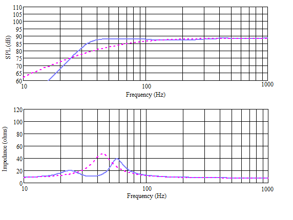

I'm also more thinking about a TQWT for this driver, preferable with a front port. But i can't find the info about it. All sites here mentioned in various tread end up on 404 errors. Is there a way to calculate it outside Hornresp (wich i can't get working like it should on my pc) to do the calculations?

Ive always used this one by John Rutter based on D B Weems work. It will get you in the park, but was informed there are more accurate ways to model one these days.

Ah, the ML-Voigt (I tend to use TQWT to refer to the opposite of what most people mean by it). Frankly, there is no real acoustic advantage to the tapered design over an untapered MLTL in this particular case: I simply did it for people who wanted the aesthetics of the tall, triangular Voigt. If you just want a rectangular box, I suggest you build an MLTL. You won't lose or gain anything noteworthy. For reference, it's a maximally flat alignment (well, almost, I couldn't quite bring myself to it, so it's a bit better damped around tuning). Stated Fb is conservative, it's actually about 36Hz, but I prefer to understate to give a little tolerance.
The Rutter based spreadsheet is basically of little value, keying axial length off Fs, terminus CSA from 2.5Sd, with no account made for driver Qt, Vas, nor is the effect of throat CSA on line taper, vent length and Fp accounted for. If you want a better starting point & don't want to spend some time learning the baseline physics, use Martin's alignment tables to give you some starting values, which will be much more usable in the majority of conditions, or empirically design in Hornrsp etc.
I found those, but i don't understand it. I know the basic principles of a TL, but he makes it so difficult that for an non-electronic engineer it hard to understand. He also uses expressions that i don't now (wat so and sl?) without any explenation. Is there no "TL for dummy's" manual somewhere?

As Dave notes, they're technically speaking [single] tapped, mass loaded horns. A pipe that expands toward the terminus is technically a horn: it just doesn't happen to be impedance matched down to its QW cutoff frequency. The driver is tapped into the expansion path at a given distance from the throat (thus 'tapped'; by contrast a Danley Sound Labs box is a double-tapped horn, as the driver excites the horn at two physically different positions along its expansion path). The terminus has a ducted vent of smaller cross section, the air mass in which is the 'mass loading' part.
