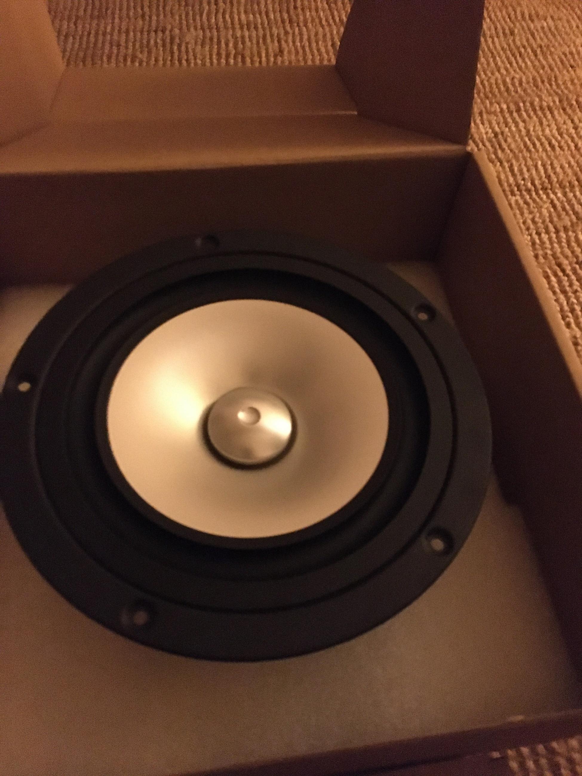

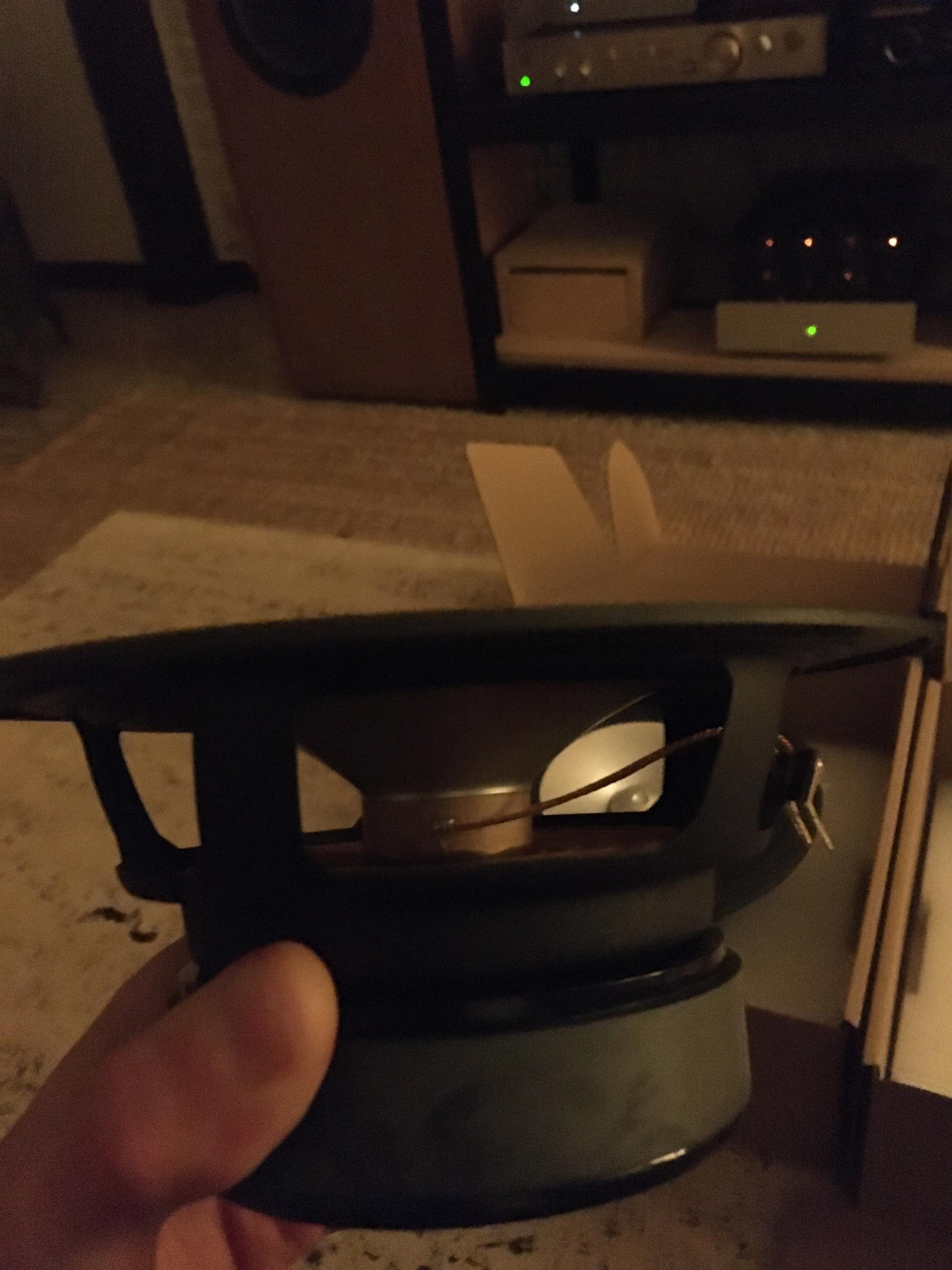

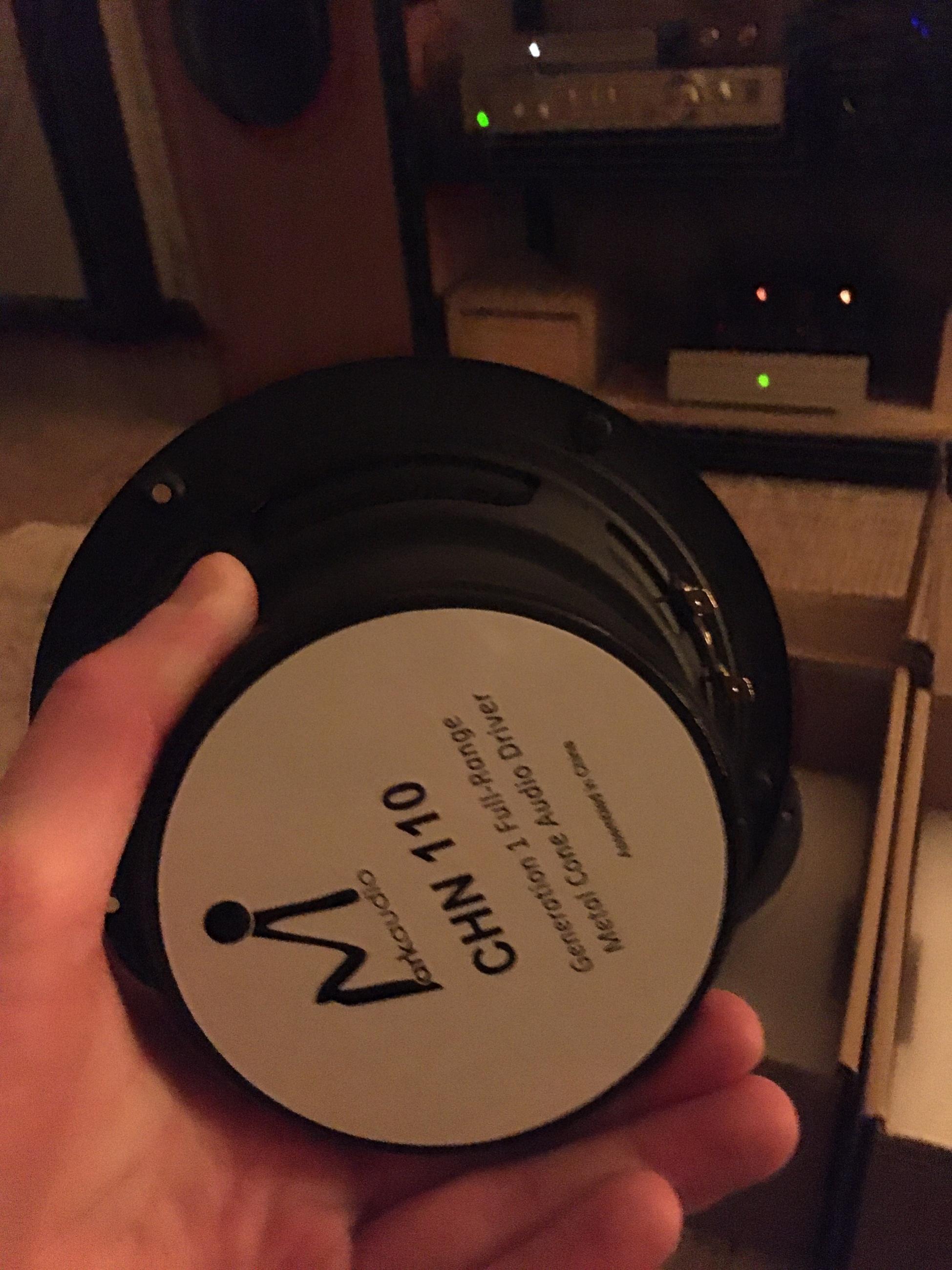

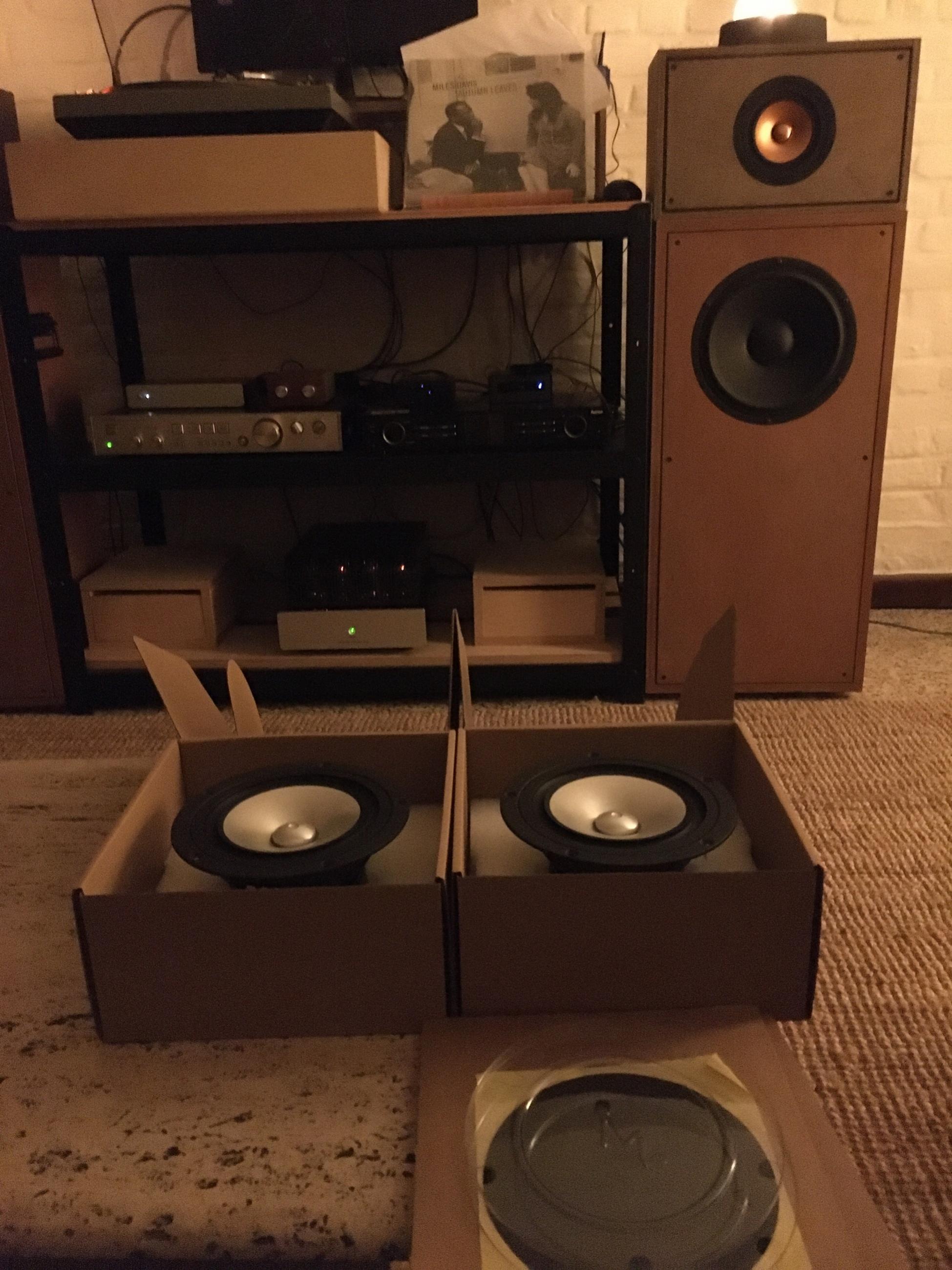

Well, i was looking at the 40L vented i said. FH XL are to big for my use. I'm more looking for sometihing i can put agains the wall so a standmount ported cabinet is now the plan and the sims are good to the mid 30's, even on rather high volume (louder than i play). They will probally be used in my tech-lab upstairs with an old Marantz 1050 (25w) amp that is in repair now...
I did receive them today btw and they do look good. Now i need to try to find wood in this new covid lockdown since today in Belgium to make the cabinets...
