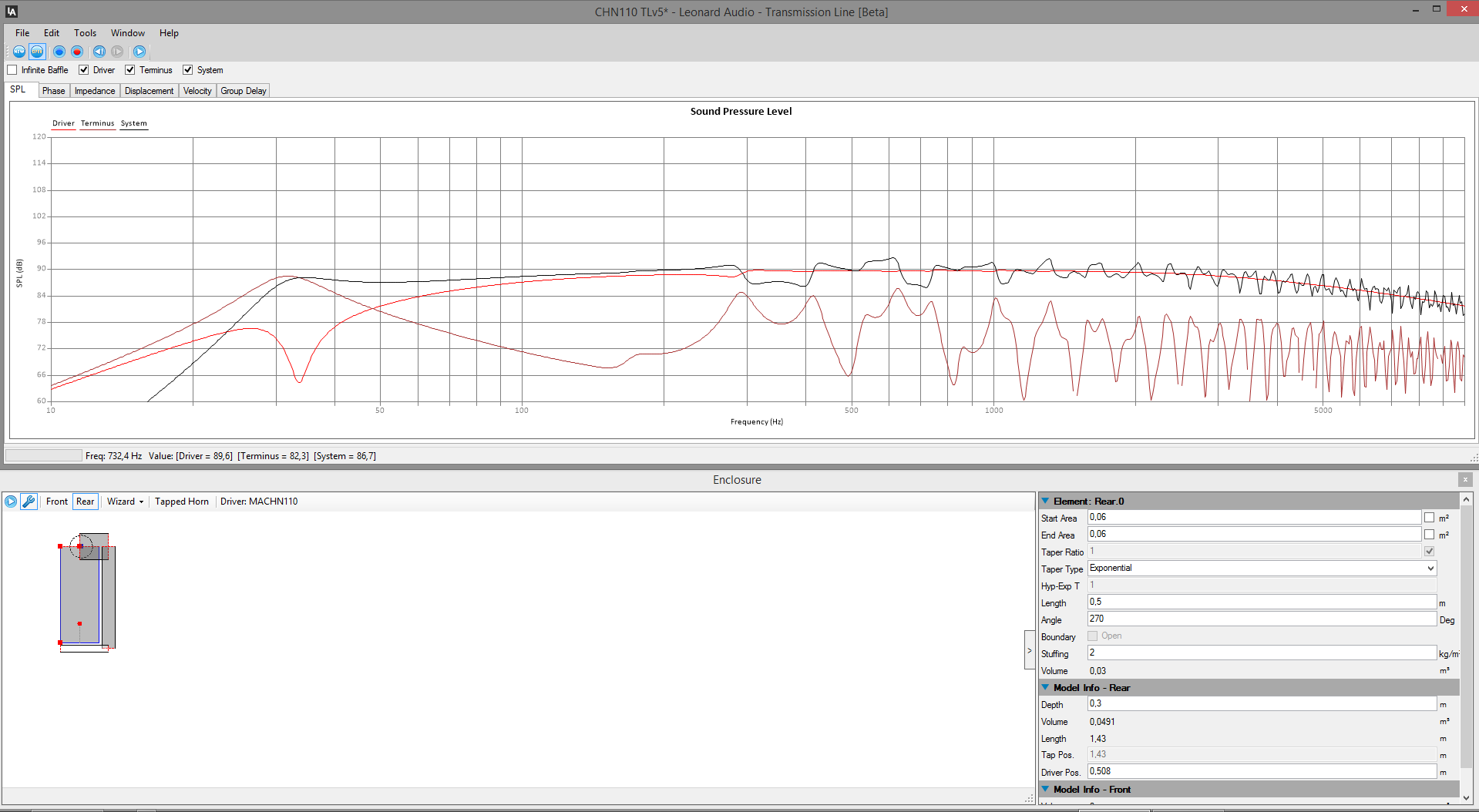

Back on topic, After reading the papers from Martin King for the first round, i tried to sim a TL with this CHN110 driver in Transmission Line from Leonard Audio and seems to get it easely to 25Hz in a 215cm long TL with a restricted end. I don't know how trustworthy this software is, but i can't get any result at all in Hornresp (mainly because it's a program that i can't learn it seems) and that mathcad file from Martin King that everybody refers to is nowhere to be found...
I don't know if you consider this a good result.
Not bad; for whatever it's worth I'd suggest looking at slightly higher tuning; as is you're looking at some losses above Fb which may rob some energy in this region, although it will likely give the driver some loading protection. You may find it easier to shift to a full MLTL or tapered (contracting) line, which should allow you the kind of tuning you want in a slightly shorter pipe; that should also help attenuate some of the unwanted higher harmonics.
Thanks Scott for your tips, i took in mind what you said and made a new version, and it already looks a lot better. Less resonance and a smaller (so cheaper) box for only a slightly higher tuning (more in the region i was aiming for wich is 30Hz). I reduced the last two sections in size and shortened the path to 1.43m. Maybe i do a testbuild for this in mdf. I'm far out of my confort zone with TL's so no birch ply builds yet, but the final version will be birch ply for sure.

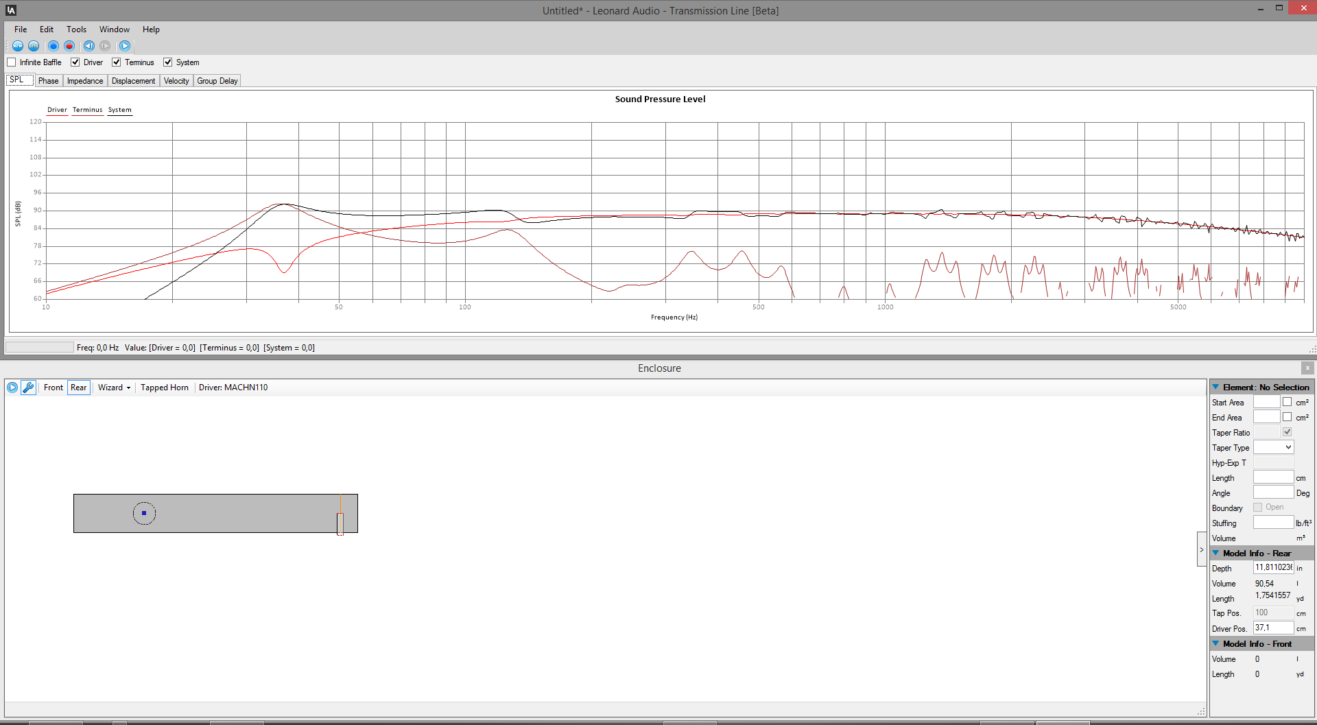

You might want to have a look at something like this (quick back-of-envelope calculation only, not a refined design -I haven't had chance to model it): 50in length, 10:1 taper, throat = 125in^2, terminus 12.5in^2. Zd = 5in. Lag the first 1/2 of pipe with 1in OC-703, SAE-F10 wool felt or equivalent. This is assuming 1/2ohm series R for typical wire, connection resistance. Fb should be 30Hz or thereabouts, probably with a very lightly damped rather than max-flat alignment.
I don't think that works, tuning is to high and the resonance is a lot more. At least not with this tool of which I found out people used it with success (which does not tell everything I know). I'm still studying the math also, because I like to know that. But it's not easy matter for someone who did not study math enough at school.

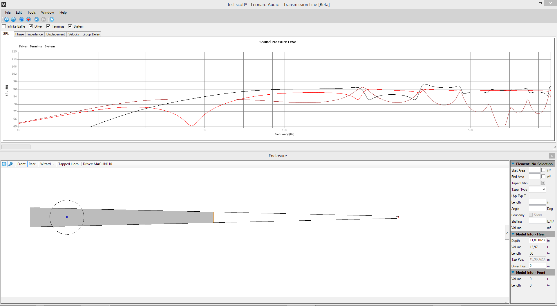

But this is the response i got, or you calculated wrong, or i did not understand your instructions...
thanks btw for all the effort you put in my questions.
It looks OK to me (attached), so you're doing something wrong somewhere. From a quick look, you seem to have a Vb of only 13.97 litres which is far smaller than specified; this pipe should be closer to 55 litres (think a box 10in wide internal, 12 1/2in deep at the throat, 1 1/4in deep at the terminus, 50in total length, driver tapped into the pipe 5in from the throat).
If you want advice, realistically I think you're pitching for a tuning frequency a little lower than this unit will do with optimal performance. This tapered pipe should be reasonable, but I'd be inclined to review the objectives a little and perhaps modify the approach. Not necessarily massively, but a slightly more conservative tuning may work out better in the long run. If you want to push the driver as low as possible, I suggest you look at a pipe horn (like the BIB, which don't look pretty on a sim but work much better in practice) but be careful with the volume knob as the price will be power handling.

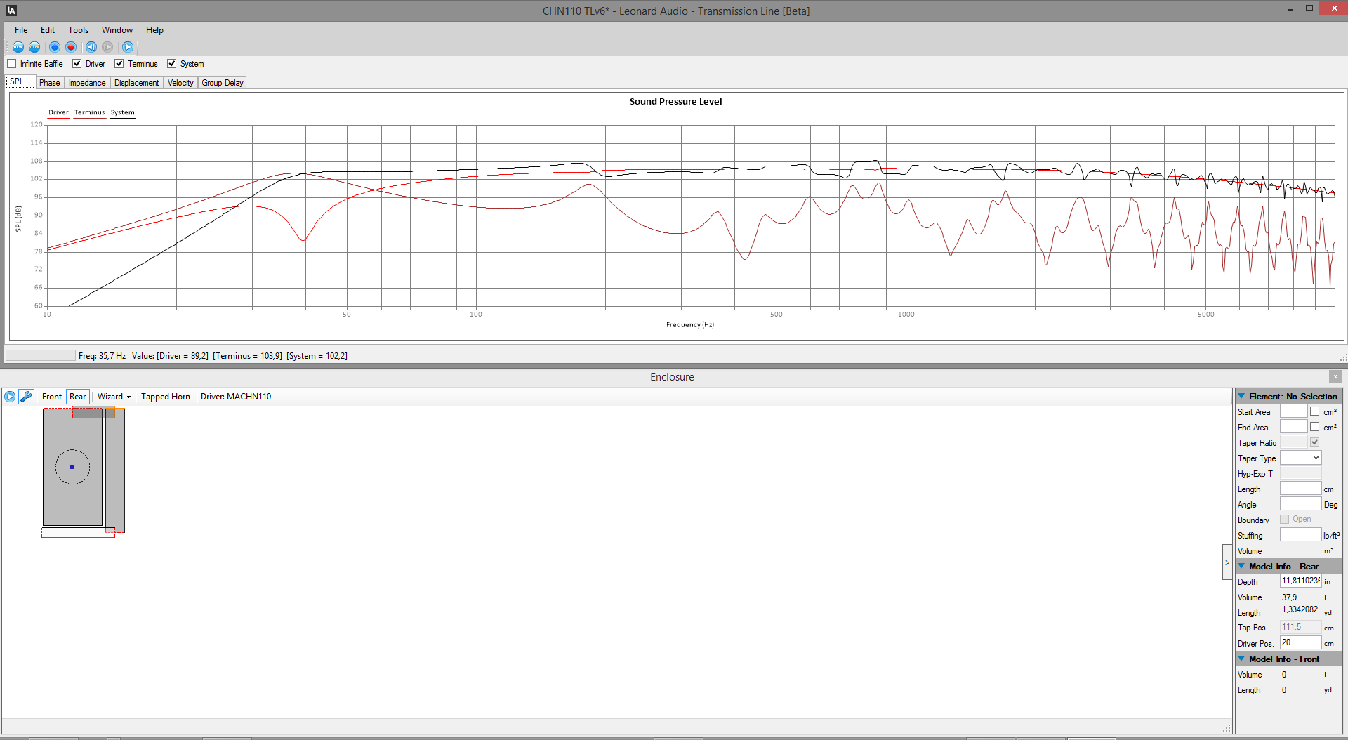

I did do a similar design like before after your remark, but now more arround 40hz tuned. I also checked xmax limits this time (wich i did not watch before) and you're right, i was pushing it beyond it's limits of excursion.
This is tuned much higher, somewhere between 35 and 40 hz (depending on how you count it) and is a more realistic design i think. I'm now off to bed (it's 00h30 over here in Belgium), but tomorrow i'll try to sim this setup again in hornresp if I manage to find how...

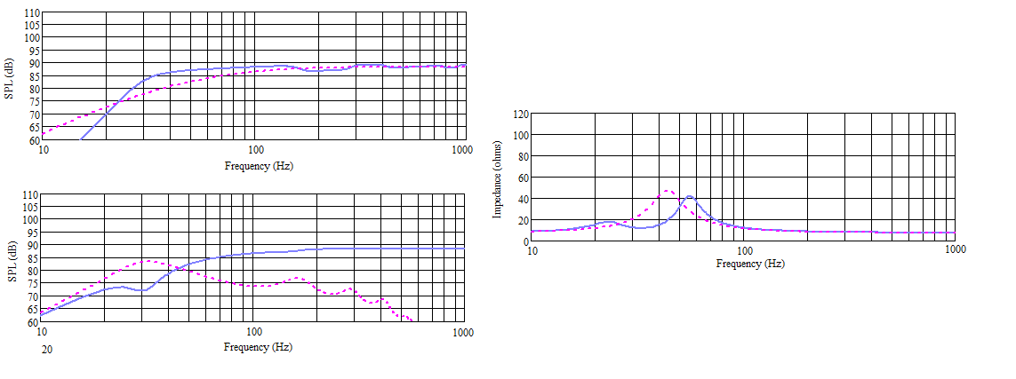

Actually you got me thinking, and i tried to sim your design (recreating it in my software) with very good results. Thank you for that i learned a lot with this example. I think I understand now this kind of design (but not the details yet). I'll study further on this...
A touch under-damped in your sim as you haven't added any damping. It's deliberately a near maximally-flat alignment when trimmed out as designed so does not have any peaking at Fb. The generalarities look correct though.

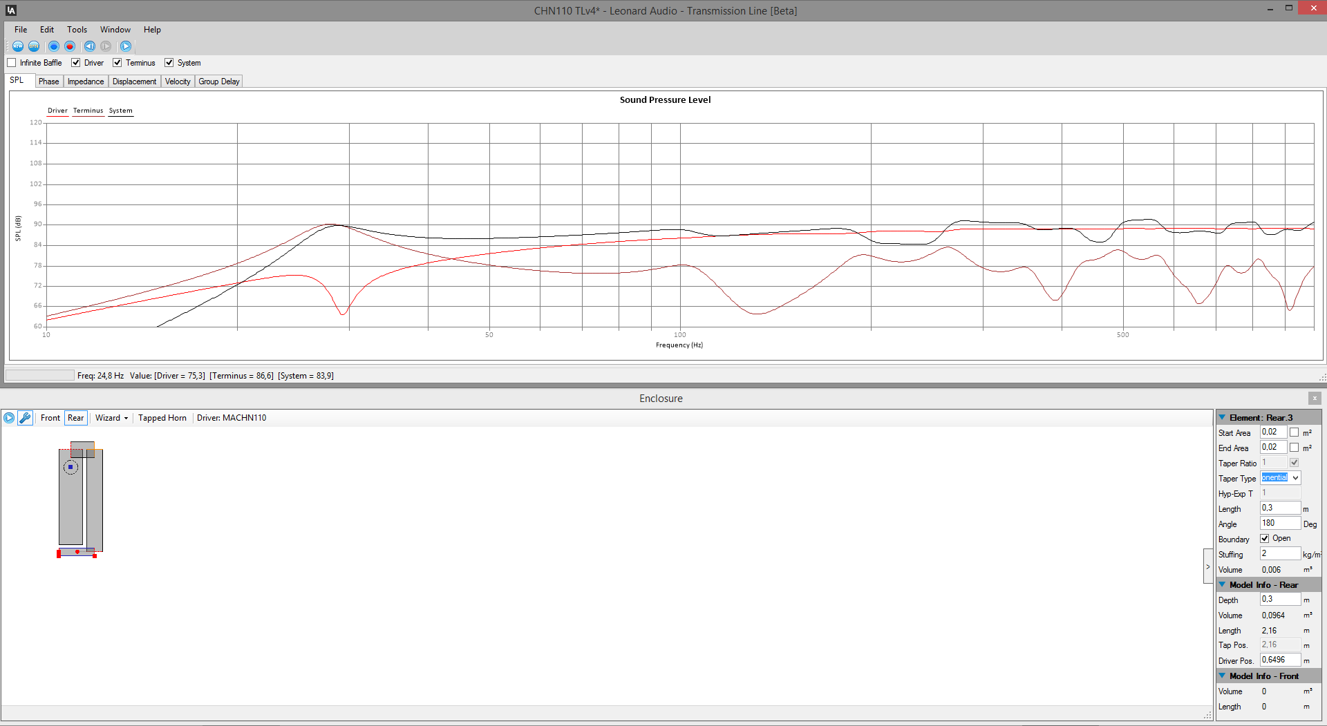

I did a lot of sims with all the good info you gave me and have more or less a design ready that i think may work. I learned a lot while doing that and the papers or Martin King start to make more sense to me...
But in the sims it ask damping over the whole lengt of 2 to 4kg/m³. you only damp the upper part, but when i try to sim that i have a lot more resonances. Can you explain how that works in yours?
I've red a lot about that damping and i see all kind of methods, but there is no clear winner or explenation why. I see from filling the upper half to 3/4 with fiberglas, to stuffing the whole pipe with loose whool or polyfill. That part is still very confusing for me.
I can still go both ways in my design (Someone is drawing it for me now, i can't work with cad). My design is a straight pipe 20cm wide, 30cm and 118cm long with bracing (pointed vertically). Driver is centered at 35cm from top and port is a slot (i don't like those plastic things) of 4x20cm and 8.8cm long, on the front with the bottom of the port at 8cm from the bottom of the cabinet. I'll publish plans when i have them (but that can take time, my cad-drawer does that also in free time).
