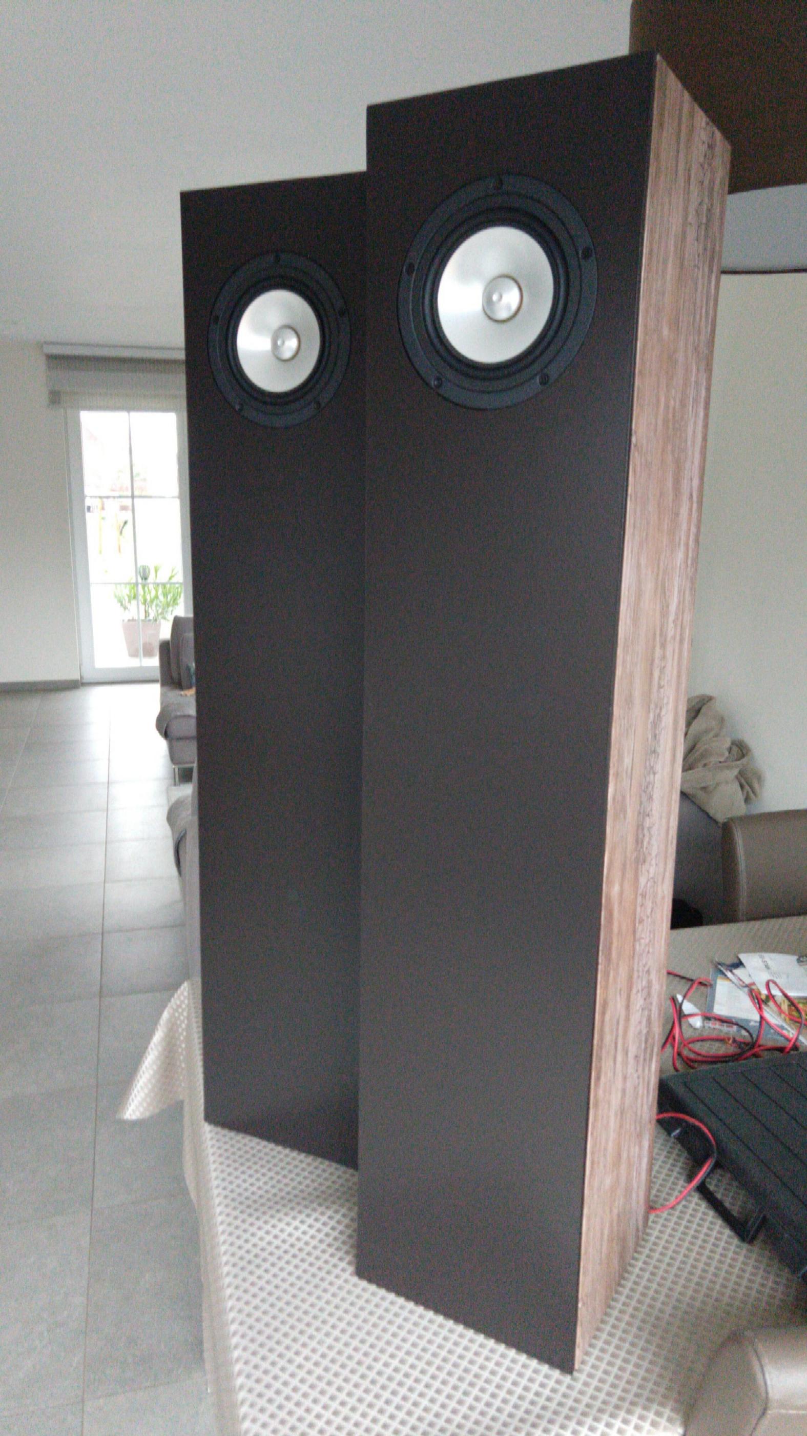

Hi all, I am new on this forum. And very new in speaker design. I just took my first steps in building a T-line enclosure with these CHN-110 drivers. I must say that I am a bit disappointed with the result. The bass they produce is ok but the mids are thin and highs are not existing. I build these without any adjustments (filtering). Pretty sure it is my lack of knowledge.
The enclosure is 107 cm (h) x 23 (w) x 22 (d) (outside size) and calculated with
HiFi Loudspeaker Design
Should I make this a two-way with tweeter or make other adjustments ?

thanks zman01 for your quick reply. I wil try your suggestion but I guess I first have to let them play for a couple of days to see if that makes a difference. The highs are there but it seems i am missing the top. Maybe I have to get used to not having a separate dedicated tweeter. I will see in a couple of days.
Thanks you.
Did you run in the drivers? they need a long run in as they are metal cone. In the beginning they do sound very bad, but after 40-50h they start to sound good and after double that they sound real good. This is mentioned in the documentation of Mark Audio.
Your case is also a bit small i think, mine is 126x24x34cm with a front port. And your driver is way to close to the top for this alignment.
Did you add damping? A T-line need damping. In mine i lined both top halves of the sides with 6cm thick rockwool sono, in a pillowslip to avoid that the fibers come out.
My TL does have a very good tonal balance i have to say. It sounds very balanced and flat for a fullrange speaker.
thanks waxx. No, I did not run them in. I did not know that was necessary (as an engine) but will do that before getting to conclusions. Yes I used damping but maybe add some more. I can't change to positioning of the driver anymore without rebuilding everything.
I am running them now for a couple of hours and I have the impression they start to sound better (or am I getting used to it ?). It looks as if they sound more open (don't know the right expression for this).
There was a paper in my box for that that told me that. And that is general known that metal cones need to loosen up before they work like they should. Mark Fenlon also mentioned that in the past often when he was still active on the forum (search it, i'm on my phone) and it's confirmed by many who use his drivers.

All drivers need to break in Matt.
jan,
1/ the box calculator you used has a VERY little chance of yielding a decent TL. The only thing about that page is the nice Atkinson Line [a flawed line, but pretty] i did in the early days.
2/ as waxx points out, the driver needs break-in. Strarting at a low level with music and slowly increase levels over the 1st 100 hrs or so.
3/ there is a good chance you may need to recycle box #1. Examples of known good boxes are the Pensil, Joan (anf FHXL althou it is a bit small), i expect waxx’s ML-TL works well and Scott has done a number of designs i have yet to draw yet (sometimes he is like a fire hose).
