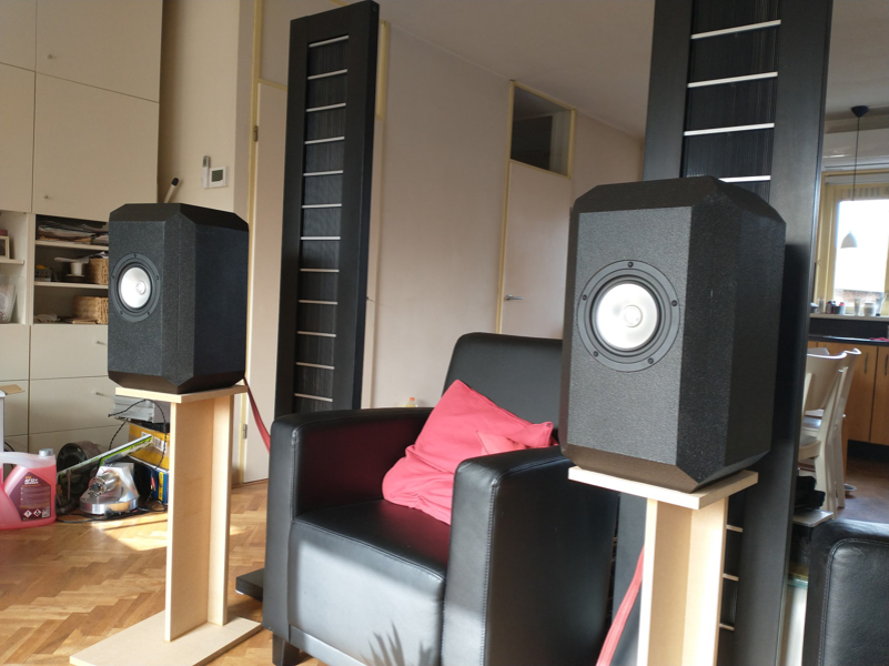

I wanted to build one of the examples from the original datasheet, the Pactolus. It is designed in 18 mm MDF. As an experiment I did build a extra strong version. I used 38 mm MDF and managed to ad two struts (is this the right word ?) After glueing it al together I chamfered all corners at 45 degrees (50 x 50 mm). I'm listening now for a month and I'm surprised by the sound quality.

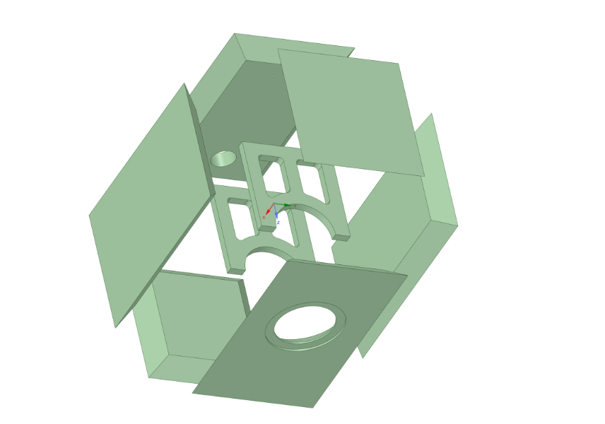

Here is what I made to reinforce the construction :
Which of the reflexes is it, i have to do proper drawings of those.
Braces should be oriented such that the subpanels created by the brace should have higher (and different from each other) than the panel they are bracing.
Given that general rule your braces should be vertical not horizontal, a cross if the box is large enuff. Avoid a solid panel parallel to the baffle behind the driver.
Note that quality 15m mplywood will handily outperform 18m mMDF, and 25m better than 38m MDF. With proper bracing, 18m play should smoke the 38mm MDF. MDF is a poor material for building loudspeakers.

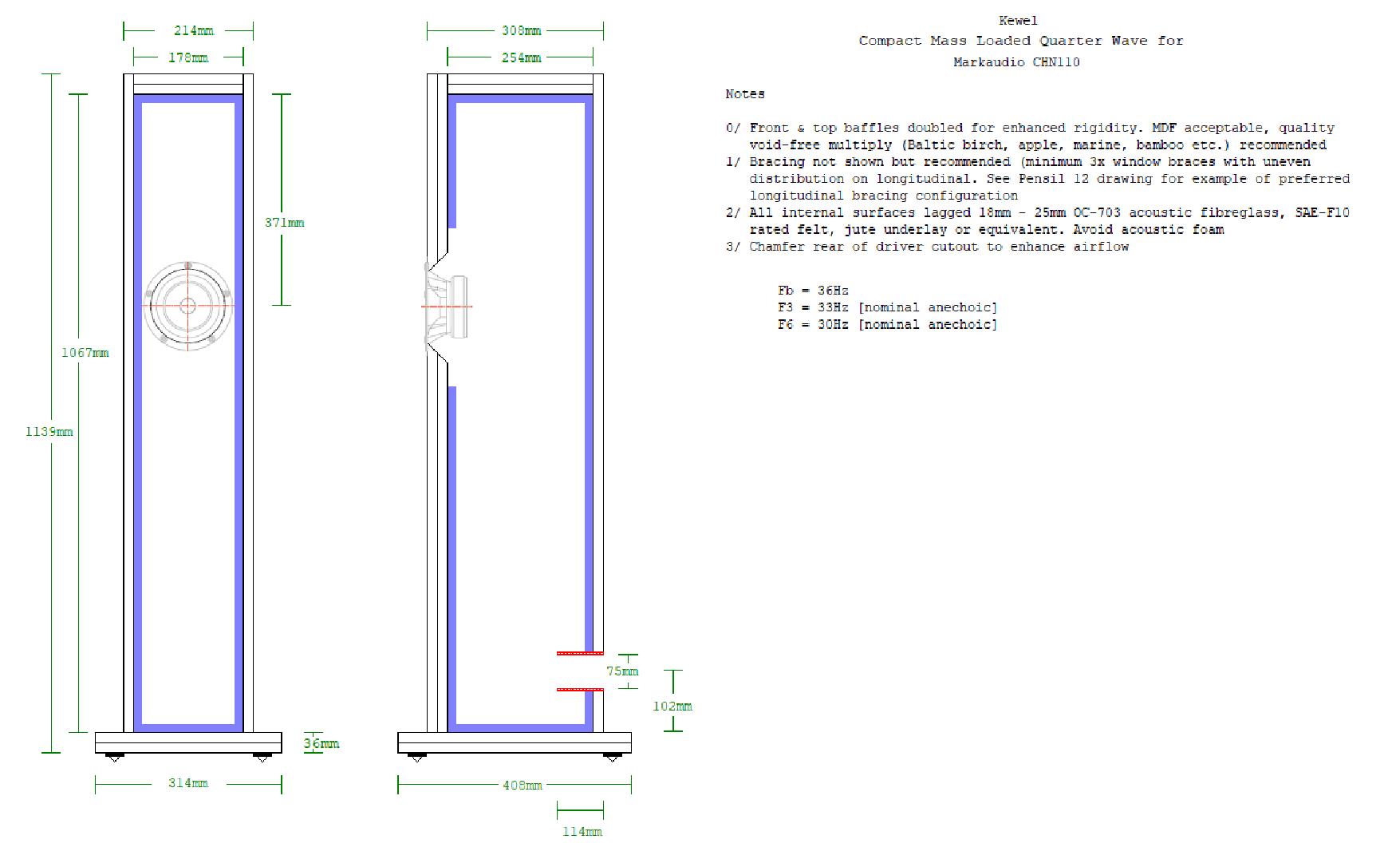

No, that is way to small for this. It need double that size. And better find a woodworker to do the wood if you can't than to use this driver in a non-fitting cabinet. Port length depends on the volume and the specs of the driver and the tuning frequency, so no prefab number. There is an aperiodic tuned plan for this driver altough that is small, but it's 18L (0.64cuft), not 0.56cuft) and that works only with high impendance output amps.

It could be made to work, but about twice as big is closer to optimal.
It also looks to be a poorly designed box (brace ryns the wrong way) and MDF (not good speaker building material IMO).
Contact Bob Berner, he could probably do you a proper flat-pak. I expect that the box he has in his library for the SEAS A26 could be tweaked to work ewith the CHN110.
