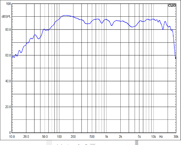

It is not that the highs are missing, but is not bright enough.
Thanks for your reply.
hi waxx, no I did not run it outside the box, nor did I measured it. I do not have the equipment to do so. The only thing I did was running a herz steptest found on youtube. That seemed ok to me. No filters or crossover used, just connected straight to the amp.
Probably best thing to do is to let them run in for a while and see if anything improves.
Well, you said your hearing is going back, that may be the reason. These speakers are rather neutral. If you want bright drivers to compensate for your loss of hearing, you need to try other drivers. Fostex is very bright, Mark Audio Alpair metal cones (like the 7.3 or the 10.3) are also brighter, but not as bright as many fostex drivers are. The CHN110 is not as you can see on the response graph published (and Mark Audio is rather accurate on that).
If it wasn't for Covid, i would say, pass by and come listen (i live about an hour and a half from you and i speak Dutch altough i'm living in Wallonia). I have both the Alpair 10.3 and the CHN110 at home, and the Alpair 10.3 unfiltered is much brigher, without being sharp.

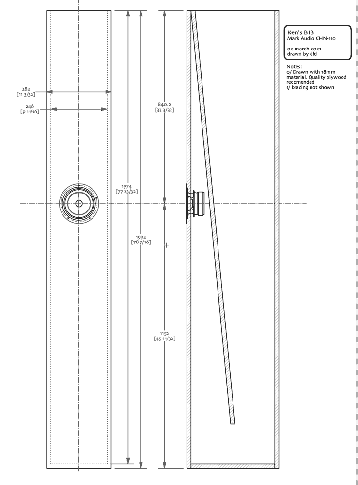

I know this is a somewhat old thread but I'm bringing it back to life to ask a question about an enclosure which hasn't been discussed. Has anyone thought about putting the '110 in a BIB? I put the numbers in the BIB spread sheet and from what I see, they look reasonable. The internal calculations were: Line length = 152.45 in., Depth = 13.70 in., Width = 9.69 in. This gave an Corrected internal height of 77.70 in. The room I'm going to be putting these in is on the smallish side but they can go into the corners of the shorter dimension. The ceiling height is probably 99 in. (normal 8ft. 3 in.). I assume bass will be adequate or will this be "Bass, Bass, All Over The Place Bass"?
I know several of you on this thread are familiar with the BIB (Yes, I read the whole thread! And have forgotten some of it.) so I would really appreciate your thoughts.
Thanks for any insights any of you might have.
Ken
Reactions: Ivo
Dave, thanks for the response. Zd is 33.08. With an external height of 78.41, this puts the driver a little over 45 in. from the floor. My seated ear height is 40 in. Will this difference sound like a lack of HF or is the dispersion enough that it won't matter?
Ken
The boxes for CHN110 will be MUCH larger than for the P11.
I expect that 25-35 Hz F10 is doable with this driver in the right horn or TL.
Optimal reflex seems to 20-30 litres and can reach low 30s-40s F10. Low 40s-50s F6.
Based on reflex sims it gets to within 5 Hz of the A12pw.
dave
