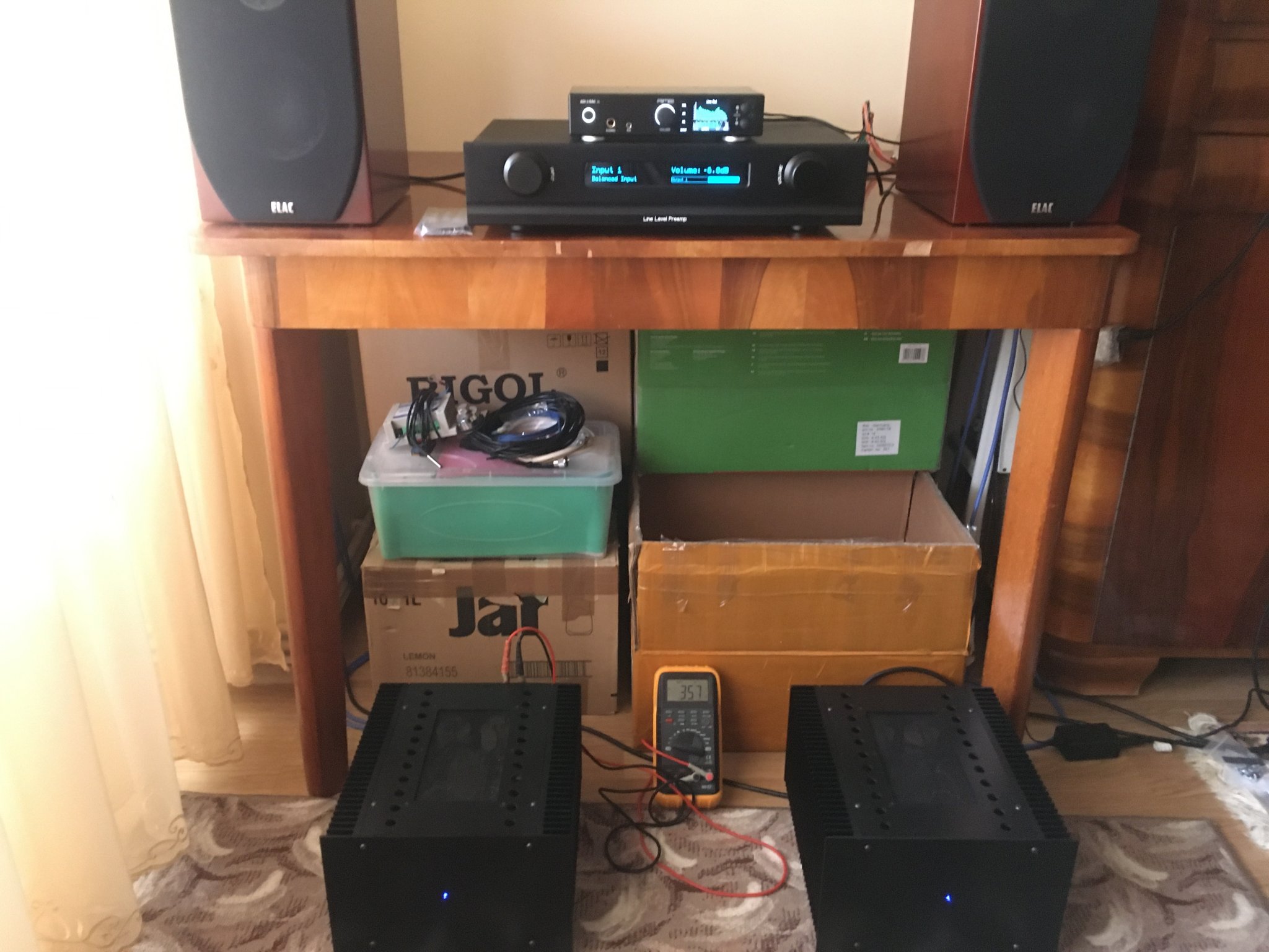

As promised a while ago here’s a short video(and a photo) of my temporary setup shaking my cage at half a watt…

Hi schultzsch,
your movie is very impressive 👏 and your equipment looks and sounds great. Could you tell us what is the pre with the spectrum analyzer on the top or is this a diy project? 🙂

Yesterday I had the chance to put a few watts on the speakers through the boo and iron pre😎
The iron pre could give another 5db of gain but didn’t reach the maximum level with it yet(the volume was set at 0db and max is 5db).
I forgot to measure(wass too caught up with the music) but I guess there were ~5W. Even if on the fft at this levels the thd of boo is pretty high the sound is terrific.
Later I will try different mosfets on the outputs for much lower thd just to make an idea of the difference between low and high thd.

.......but I guess there were ~5W. Even if on the fft at this levels the thd of boo is pretty high .......
how's that?
as far I know it, bridged SL OS is having pretty low THD
something is fishy with your measurements
speaking of Boo itself - roughly, you can expect double or even triple of what you get in sims, depending of models used
which is still damn low
just checked - for 8Vpp, I'm getting 3 zeros after, with Cordel mosfet models
edit- that was with 1A8 Iq pper phase (sum 3A6 for channel)
checked with 1A Iq per phase, 2A channel - it's 0.001
if you're having sum Iq of 1A, well ...... build some other amp in that case 🙂
sim for 0A5 per phase, sum 1A, THD is 0.0043

Did you simulated like this?On the positive phase I went with 240 and on the negative with 150.
