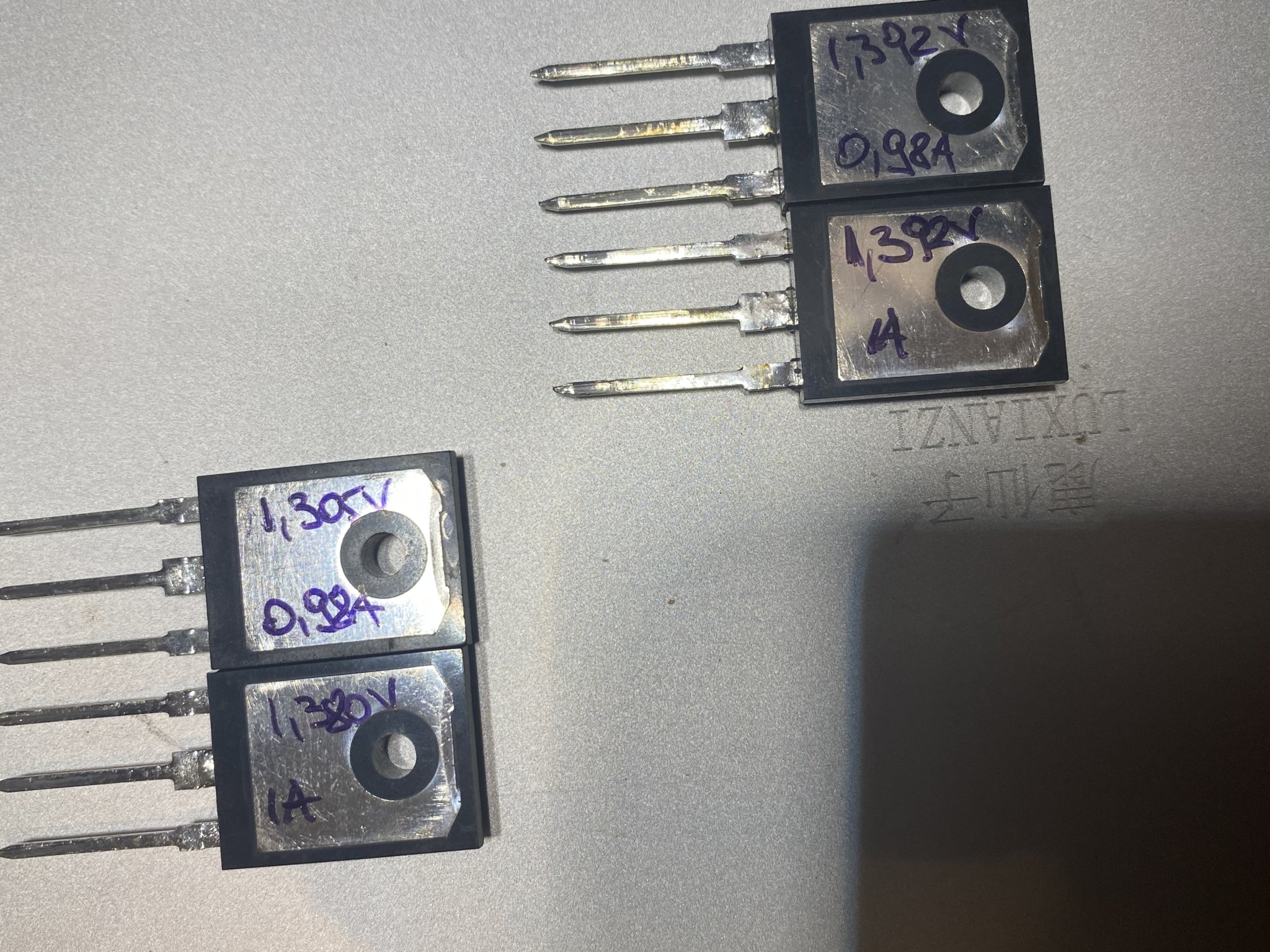

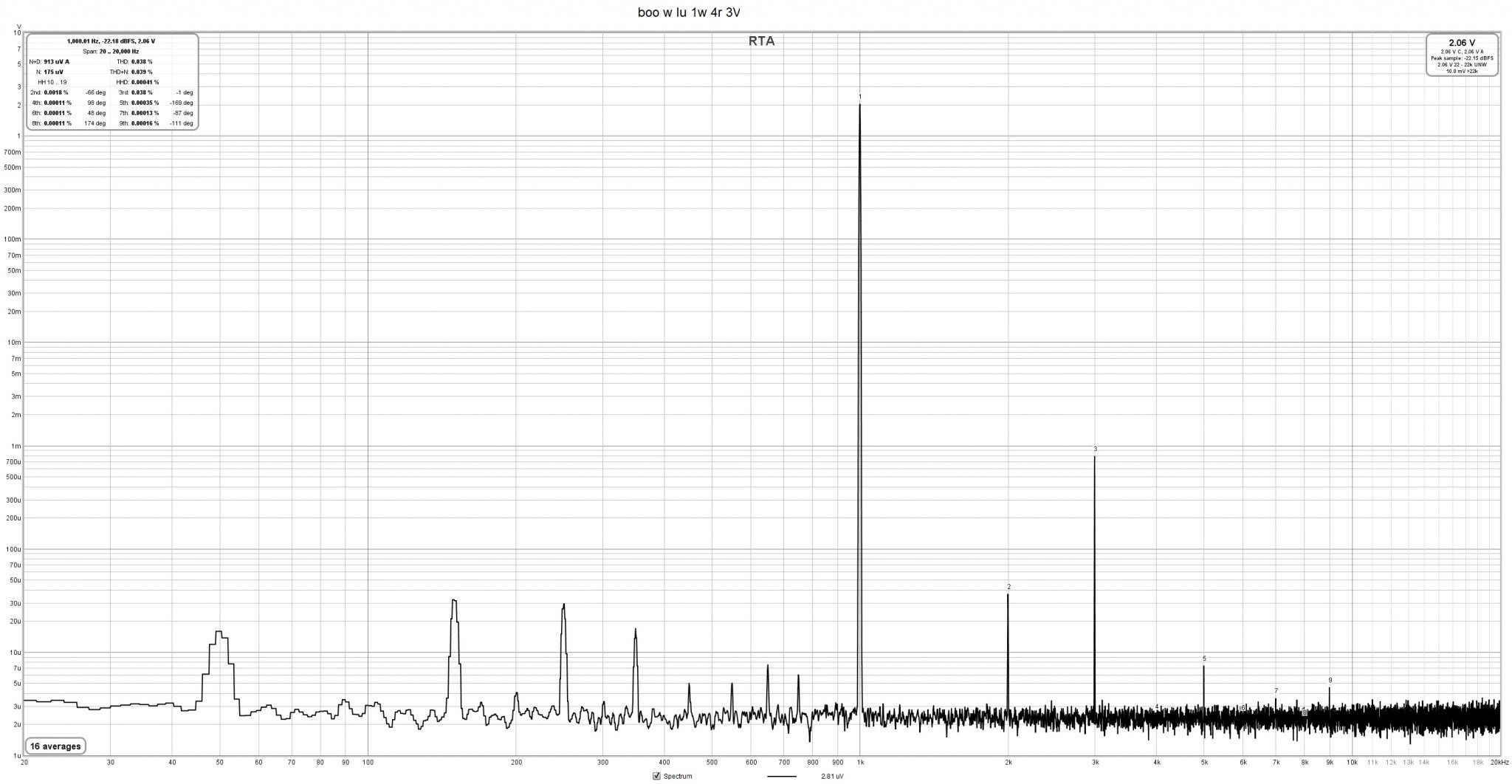

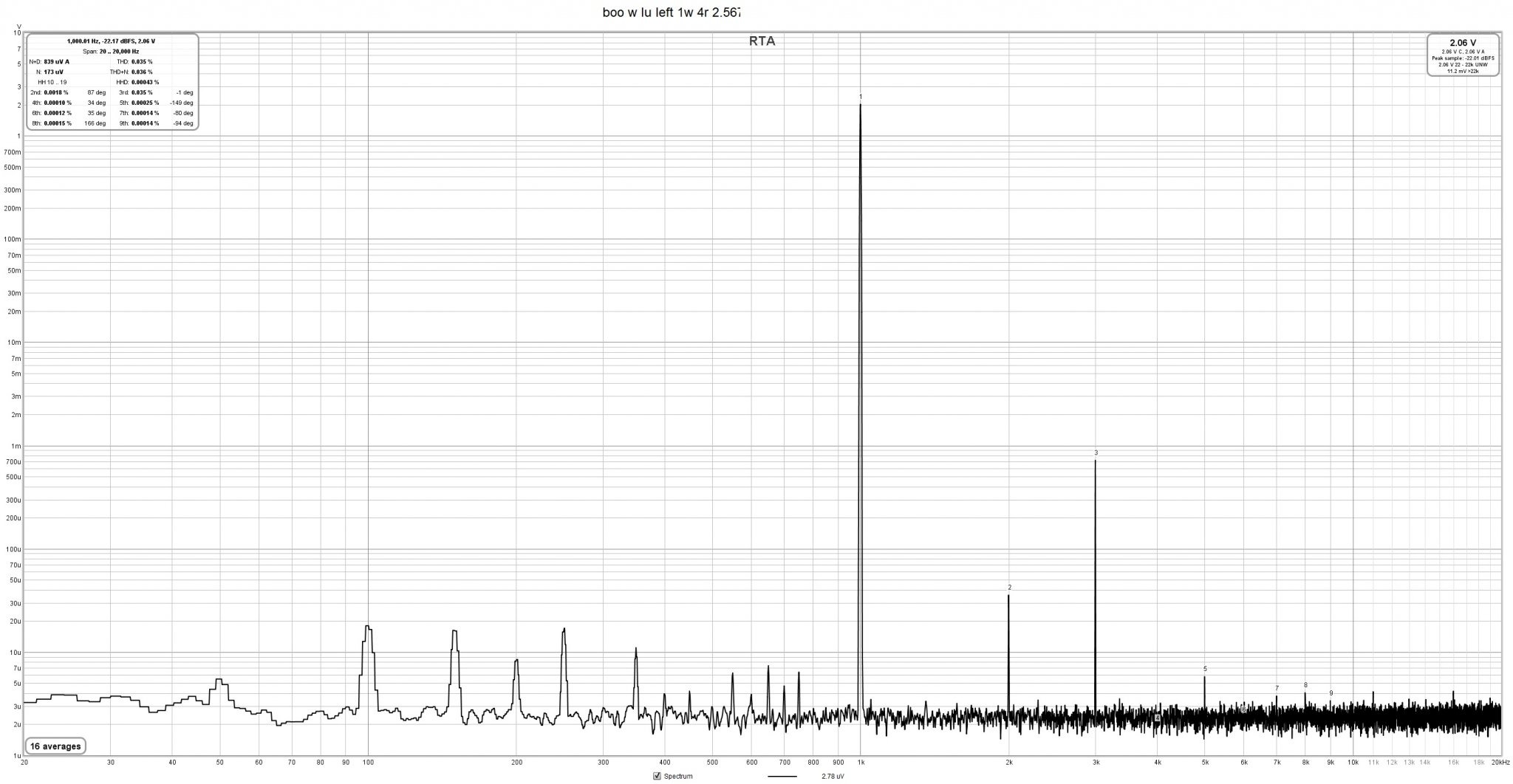

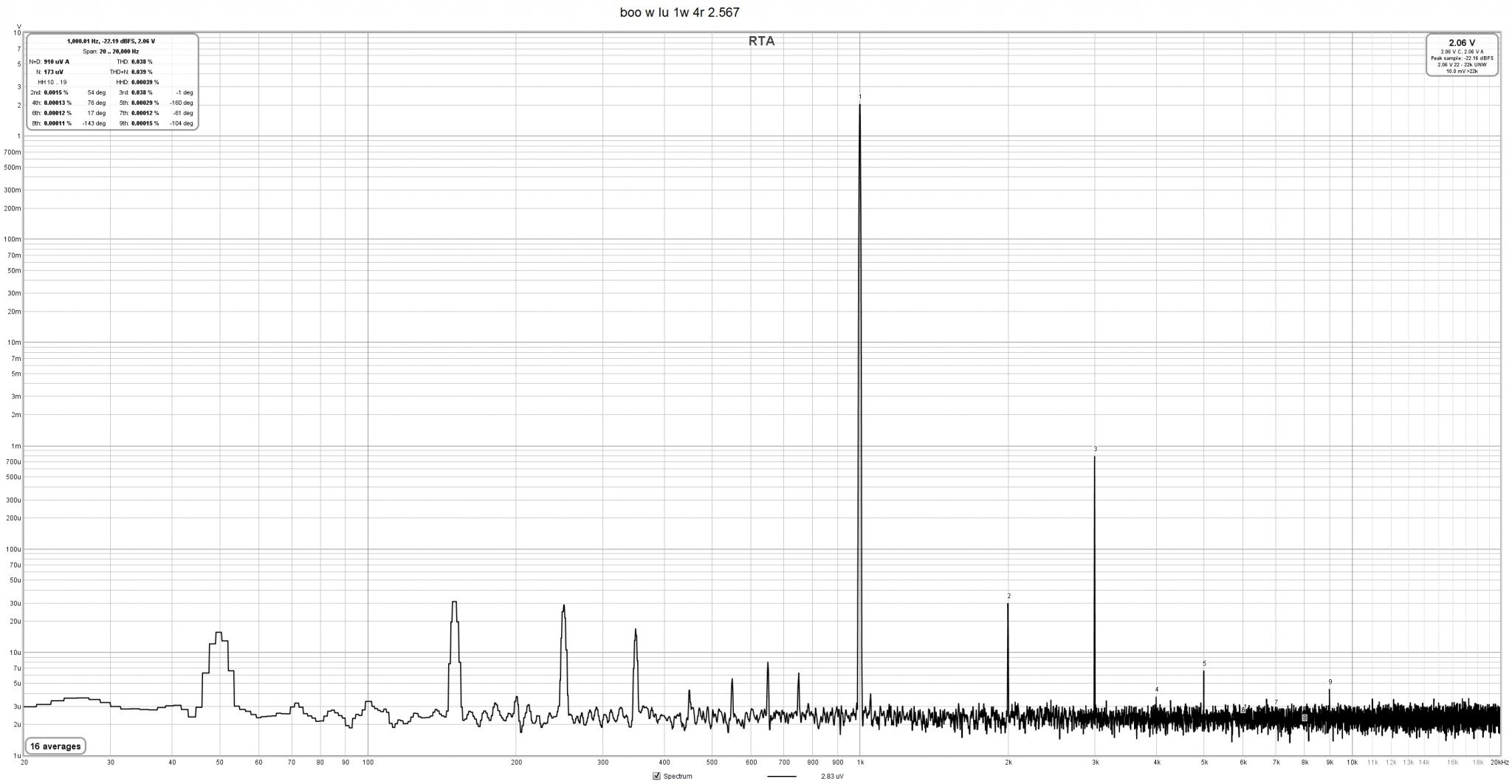

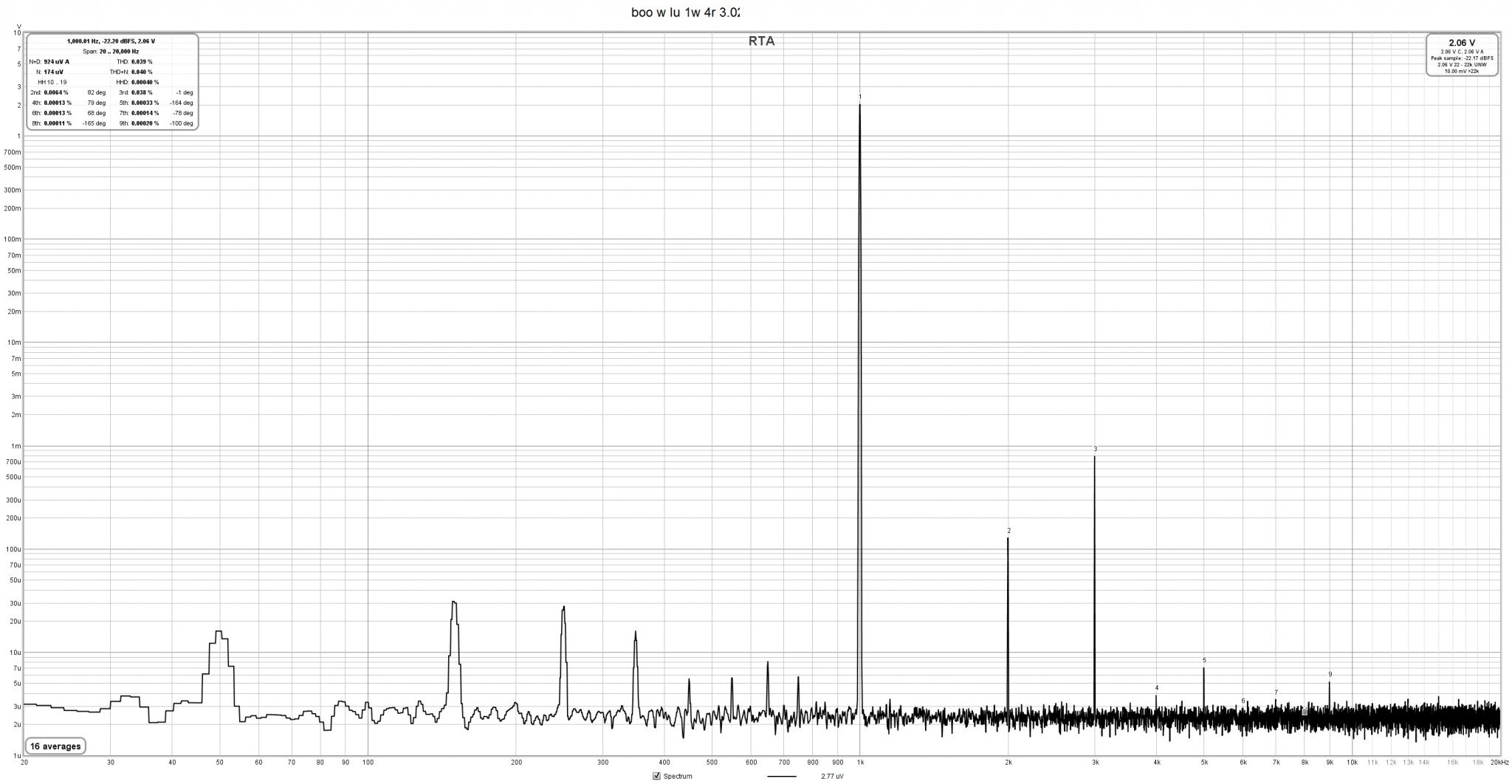

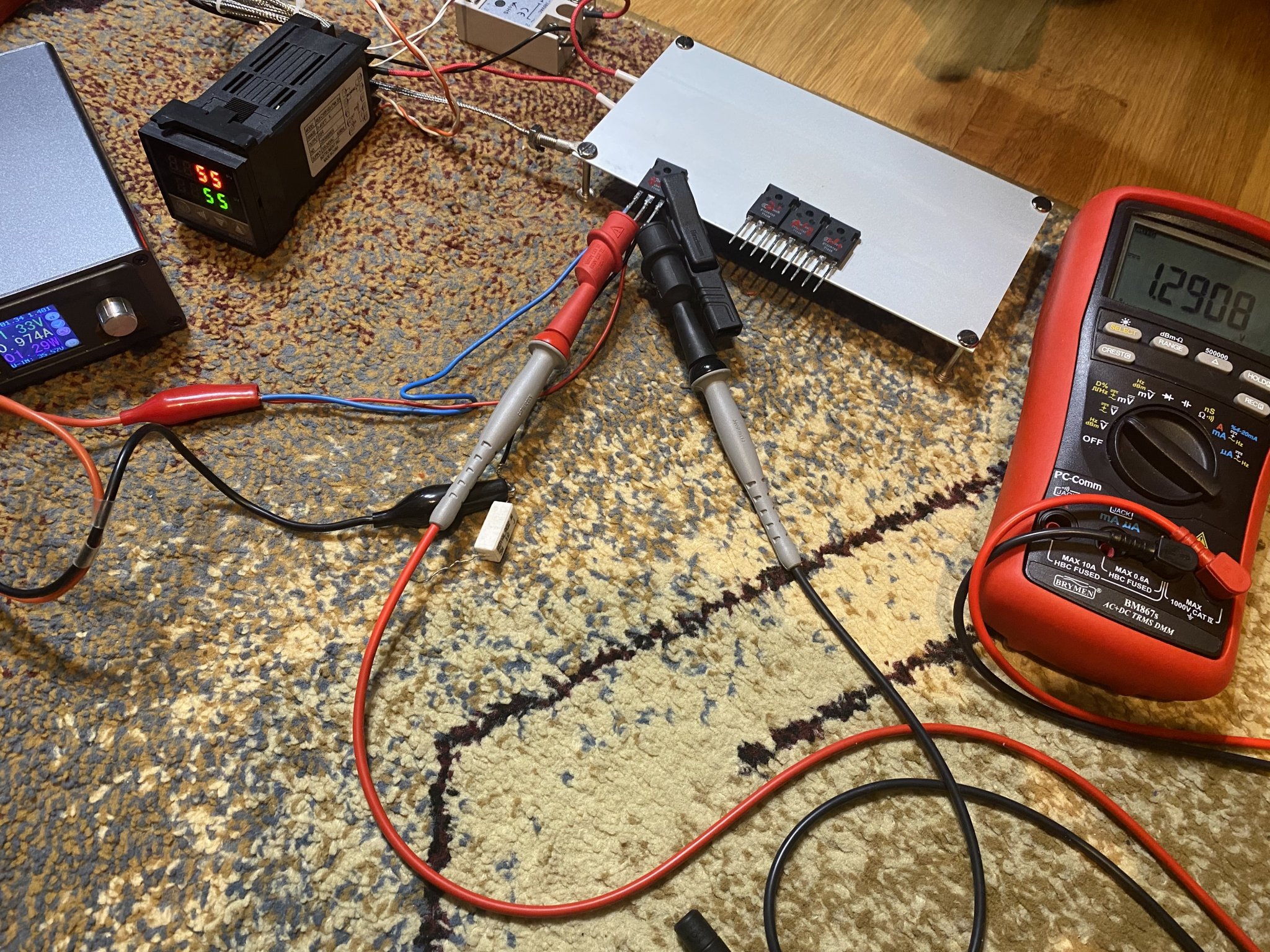

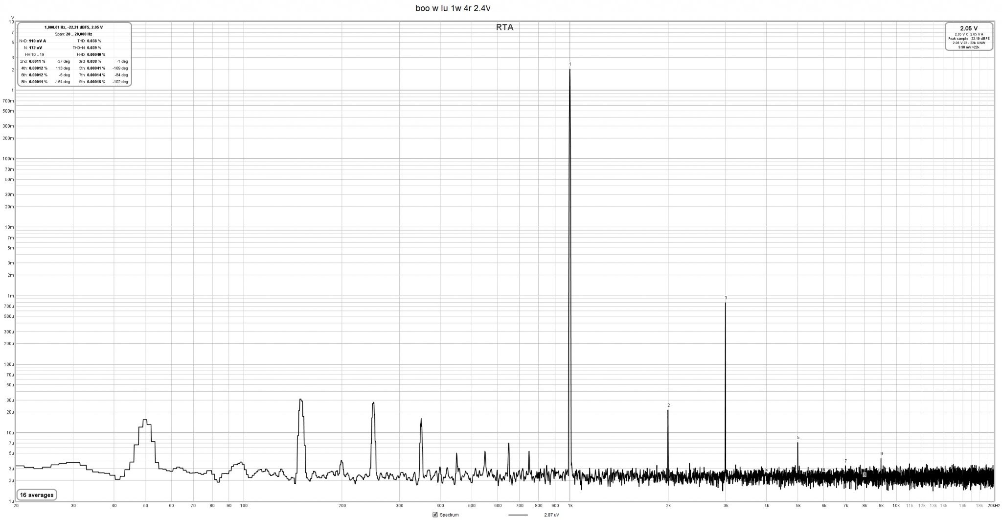

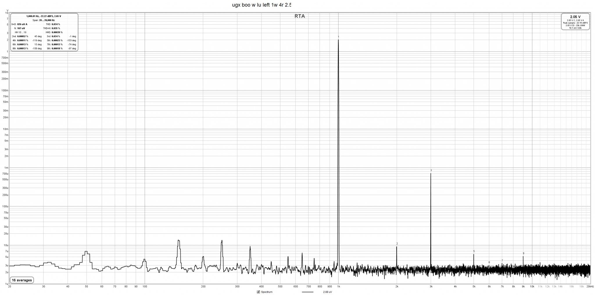

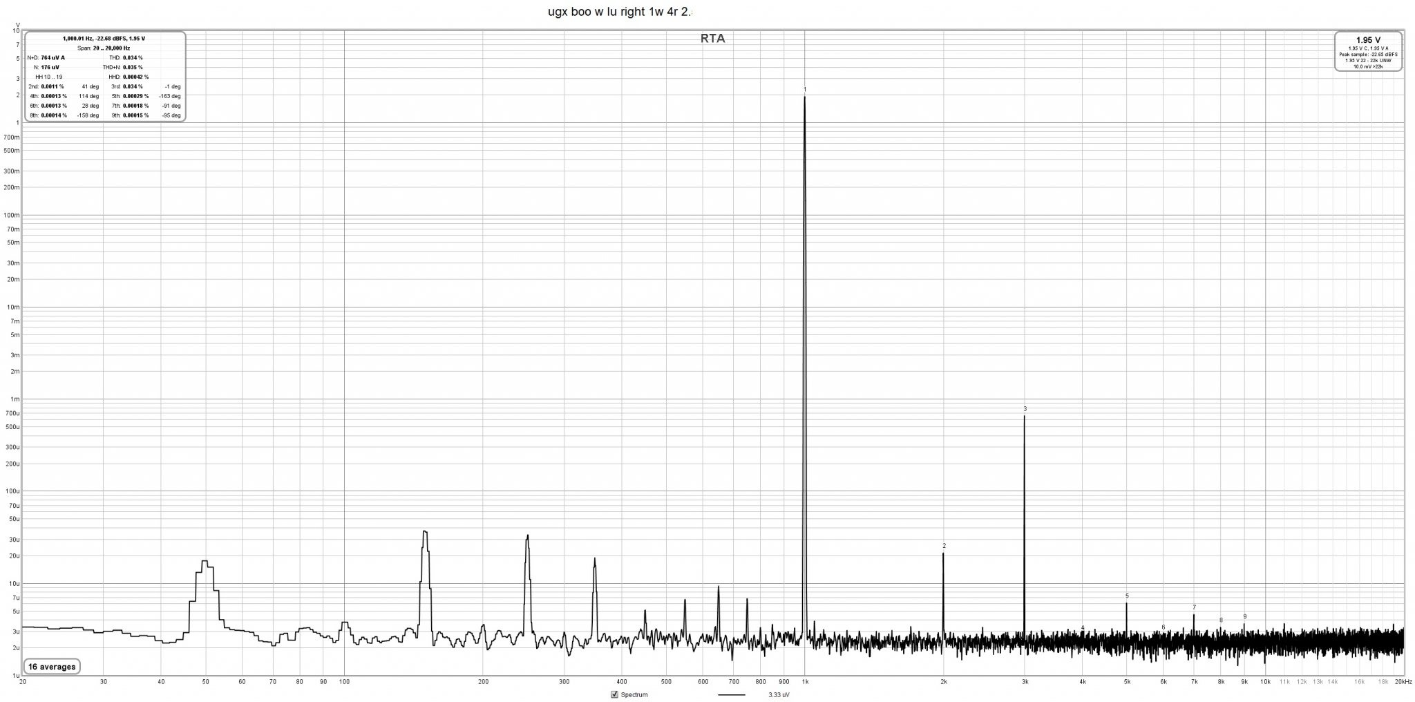

As you can see in the 2 attachments the Vds of the LUs is a bit different from one channel to the other to get same levels of 2nd hd, the jfets were matched.
I didn't set for the lowest 2nd.
One thing that it`s obvious is the 3rd hd that is close to 6x higher than the mosfet version. What can be done about this?
One more thing to mention is that I get 40+ watts and not 100+ like I said yesterday, I biased at 1a the fets like it was before.
simple as ....... Lu is having much lesser THD, because of so much higher xconductance
so, resulting symmetry of entire shebang is so much higher
thus nulling of even harmonics is so much higher
as seen from previous iteration, sole way to get evens is to decrease level of symmetry ....

I wondered how could I decrease the 3rd hd. Is there any way?
Yes, I tried that already but can't increase 2nd more than 3rd.sole way to get evens is to decrease level of symmetry ....
you can't do nothing, everything you have is pretty much as given
symmetry between OS parts is what dictates odds and THD level in general
symmetry between phases is what dictates evens and THD level in general
what you can try is varying drive to one of phases
though, remember, from very moment of choosing bridged OS configuration, you did chose dominating THD Spectra
how much you can alter that, as always, is dictated by several factors and finding right measure of compromises is entirely up to your taste

When I decrease the ccs current of only one half the 3rd hd decreases by close to 0.7x . One ccs is set for only 6ma.
If I set the ccs on both phases to only 6ma the 3rd goes 3x lower.
If I increase the ccs current the 3rd gets higher.
What would be the minimum current at which the jfet can be driven without frequency penalties?
yes, you must take care of few things
to maintain symmetry of Ugs voltages (lower mosfet and upper mosfet level shifter), if you vary level shifter Iq, then you must accordingly vary value of level shifting resistor, to maintain OS Iq
in short, keeping said Ugs-es in ballpark, keeping OS Iq in ballpark, only then you can compare overall performance
with CMirrors in biasing mechanism, symmetry of Ugs-es isn't anymore important to ensure minimal sliding of DC OFfset (as it was with resistors to rails and opto between gates, previous biasing arrangement) but it is important to ensure symmetrical clipping

I rushed with the post and noticed after about the bias being responsible.
So if I keep the OS bias the same and the said Ugs-es in ballpark seems that the only thing to lower the 3rd is increasing the bias.
Now I am convinced.you can't do nothing, everything you have is pretty much as given
Today I increased the bias which lowered the 3rd like in the sim and at this point I could set for 2nd predominant which I also did but to be honest I like the 3rd too so I set for maximum symmetry between the phases of each amp and put the top covers on.
Now I can compare the type of sound that I have now with what I had for many years in the past which was exactly the opposite.
What I noticed was also that certain tracks go well with 2nd and others with 3rd.
