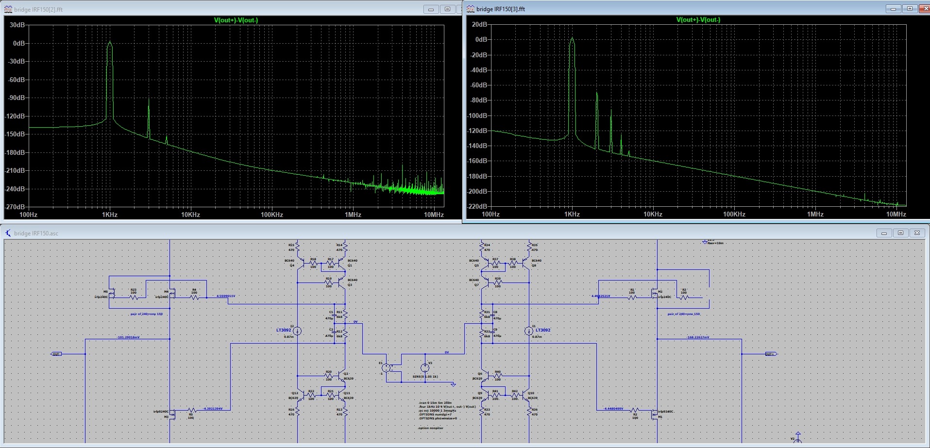

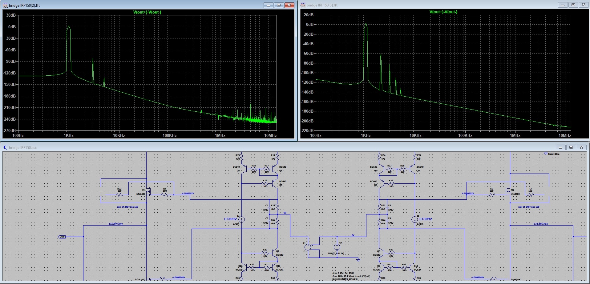

On the left fft the result is like yours, on the right is like I have it(240 on +phase, 150 on -phase).
if you have it as that - IRFP150 on neg phase and IRFP240 on positive phase, with (measly) sum Iq 1A, 2nd is dominant and pretty high
and it is not unreal to expect 0.1% THD@1W that way
pretty much all is important do you like sound or not ....... and it is nice you can alter it for your liking
though, whichever approach you take - symmetry, or spiled syummetry, with proper Iq, THD is going to be lower
personally, I wouldn't go bellow 2A sum channel Iq, but that's your amp......

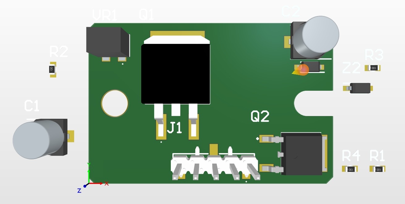

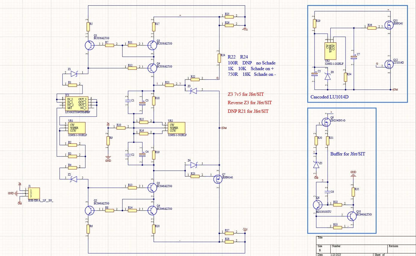

The story goes on!
Because I like the sound I hear with the actual mosfet combo I use, I want to try the LU1014 and see how it sounds.
The alu pcb idea in post #193 seems not good for a long capacitor life(thx to ZM advice from another thread) so I went ahead and modified the errors I had in r0 and added also the cascode for the jfet.
The LU1014 I have are from Nelson stash and are already on aluminium pcbs from the same gb with the jfets.
Will be ordering the pcbs the next days, till then I am open to suggestions if any.

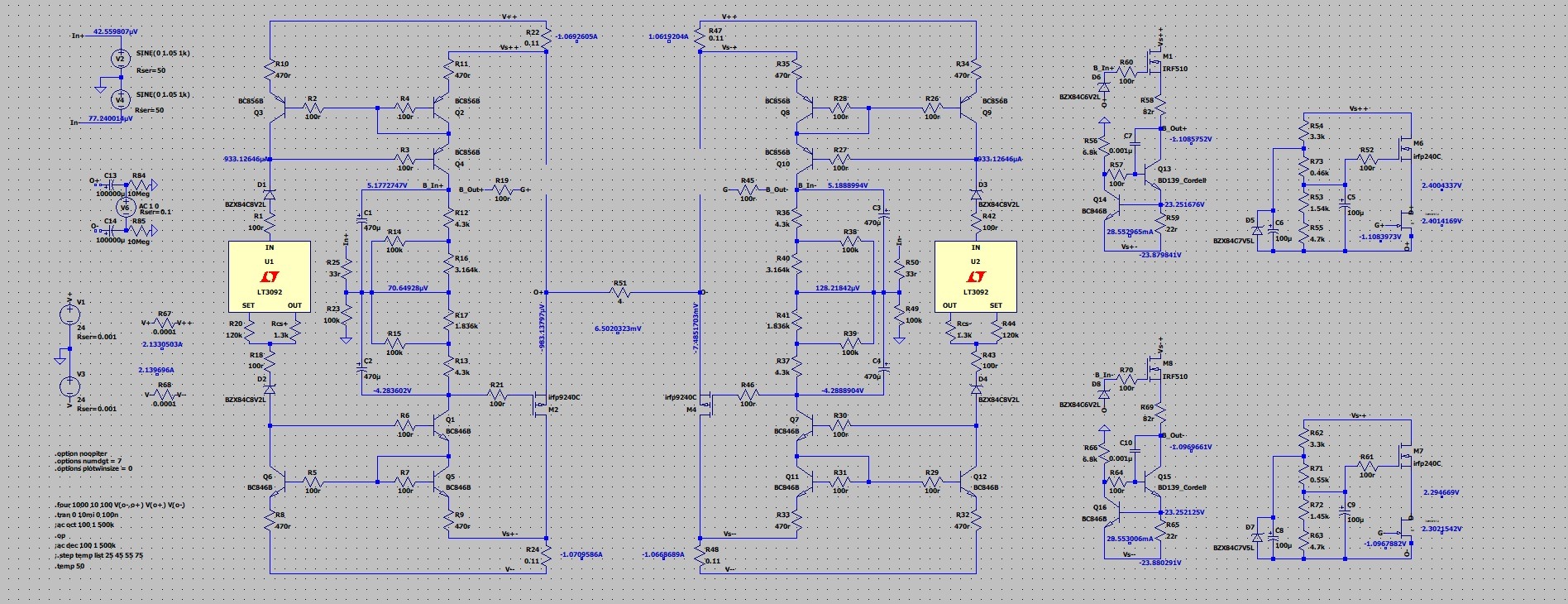

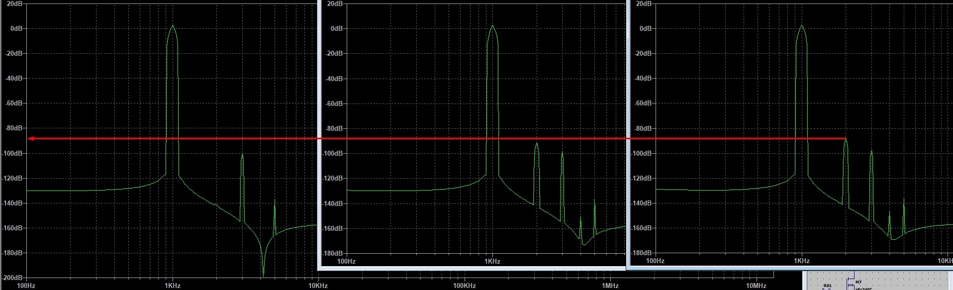

Yesterday I found a spice model for lu1014 and this encouraged me to go ahead and simulate the circuit.
First thing that I discovered is that with dn2540 it’s difficult to set the absolute offset to 0v, you have to modify some resistors(the 4.3k ones that are used to set the DC offset)on the input side of the amp to have a big ratio between them.
Instead if using the irf510 it works with the standard 4.3k resistors and 5k pot.
Now to introduce some 2nd hd all you need to do is play with the vds of lu1014.
I am attaching a screenshot with the lu vds set for the lowest thd and higher thd levels.
Seems a lot of fun ahead:santa:
