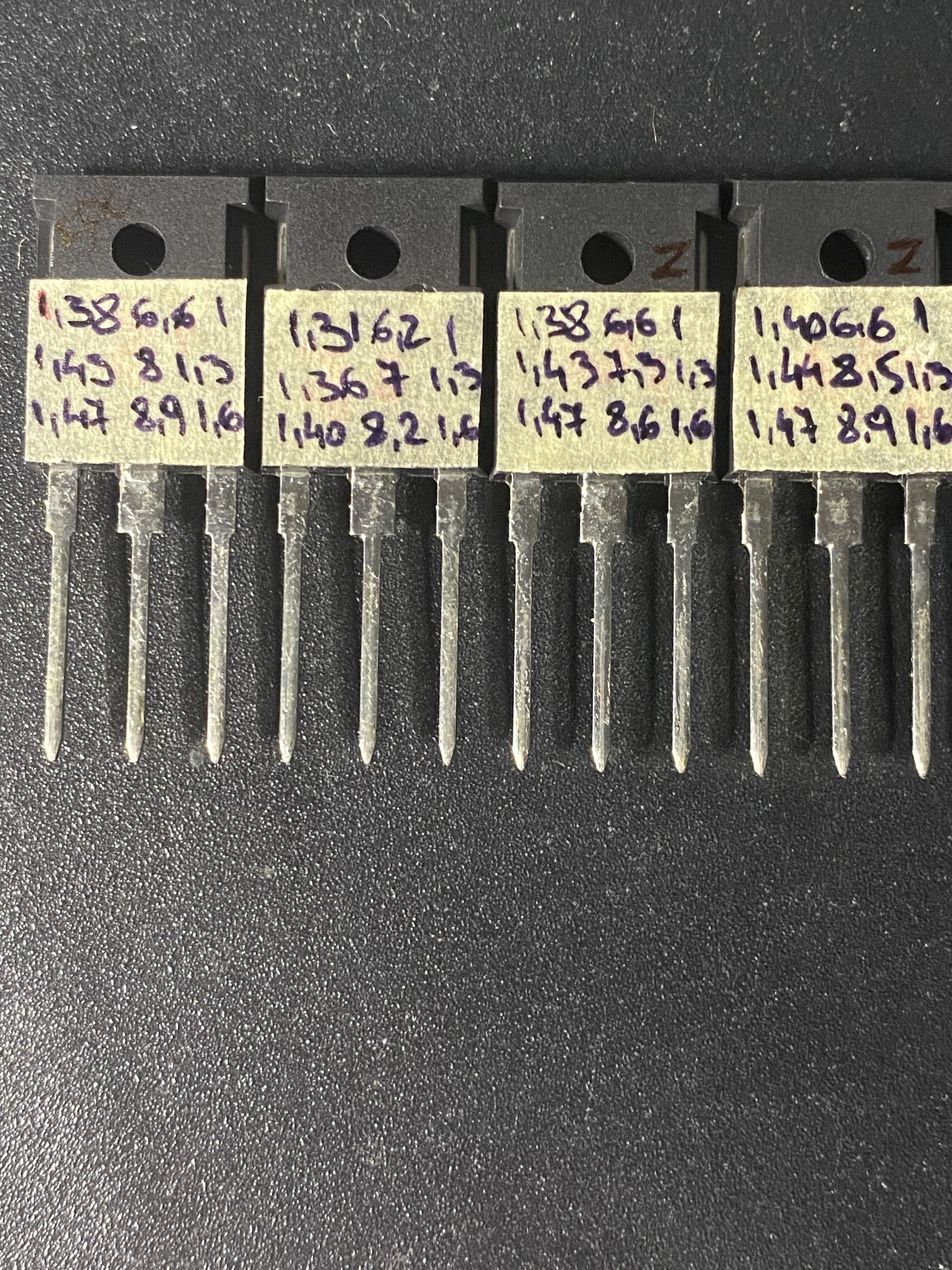

I have 3pcs that are very close matches but the 4th is a bit away at 75mV vgs difference.
Looking around I seen the f6 circuit that adjusts easily the vgs of the sjeps, I could use the good matches on the bottom where is more criticat to have them matched and on the upper position the mismatched ones.
75mV is practically nothing
and - for F6, if you're opting for symmetry, upper half is of same importance as lower half
though, if opting/thinking about symmetry, only way to get that is having parts matched by xconductance..... Ugs not being exactly measure of dynamic behavior of part
though--though - who cares about symmetry :rofl:

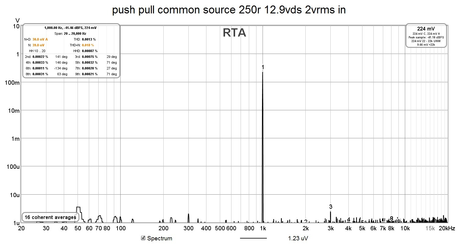

It took me a few days to measure these.
In the note I have written the vgs, gm and id on each line.
70mv vgs difference is not much when driven from common source at 16ma and 250r drain resistor, just a few ohms. So now I understand why you said that 70mV it’s not much, for that low rd variation the common source doesn’t change much it’s thd.
Discovering how to measure the gm I started first with other parts like the small k170/j74 that I need for a future blowtorch preamp.
It was a nice experiment to see how low thd I could get for a simple push pull common drain/source by tweaking the gm, even 10x lower.
So I learned a new lesson, my semis have to be close in spec to the ones in the original schematic if I want to get same results or I have to adjust the schematic to my semis. Simple as that but it worths it.
I had a lot of fun these days :Popworm:

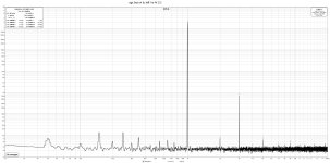

so, just write some factual comparison, between cascoded LU and SJEP, in place of upper OS part
say, THD numbers and then say something about listening differences, if you had enough time to catch that
I mean - easier to write these numbers than for us to compare graphs .........
do not forget to note exact Iq for said measurements
edit: still at first morning coffee, now I see that I have no slightest clue what you did show on graphs
:rofl:
maybe I'll catch that later

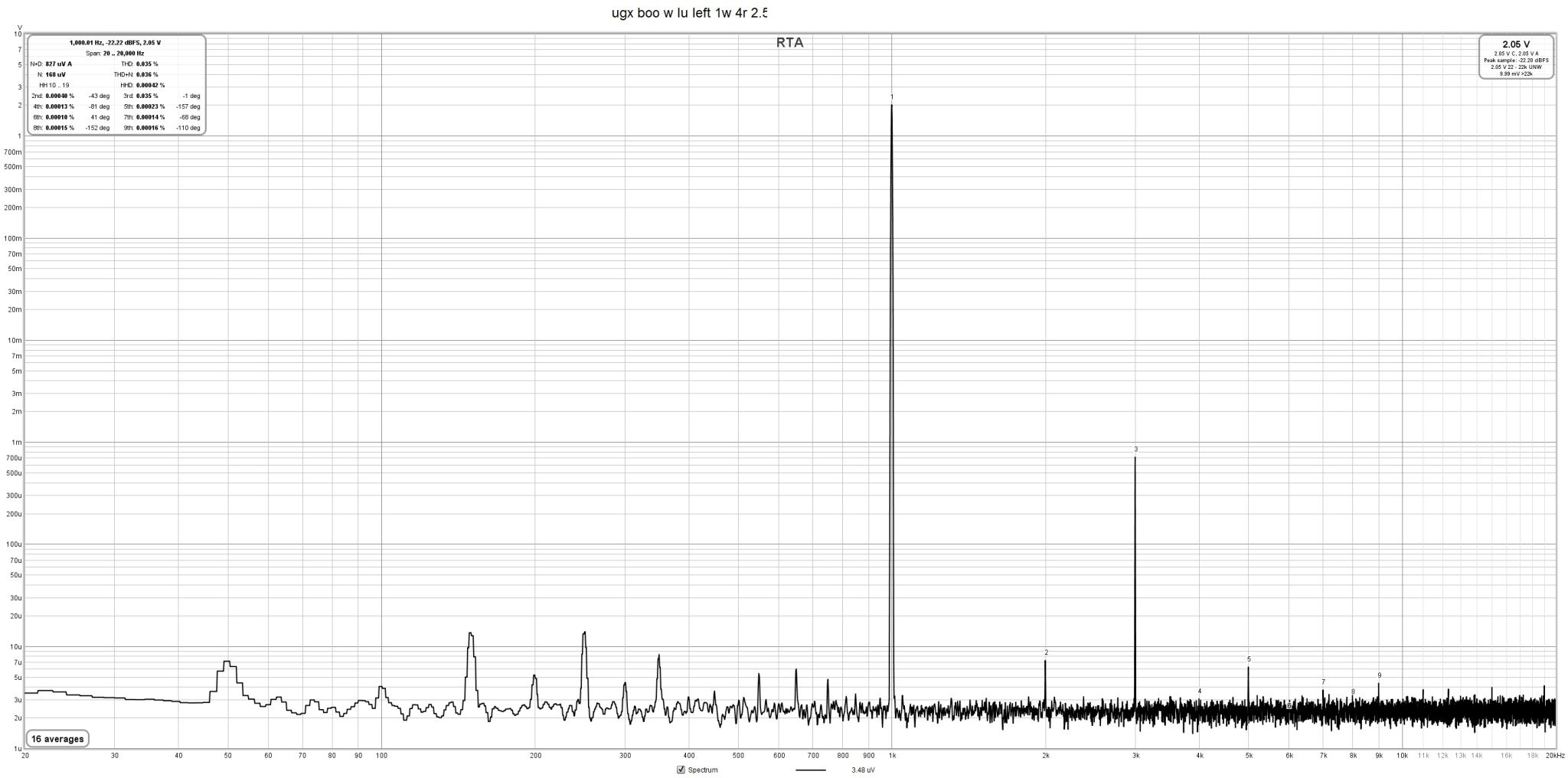

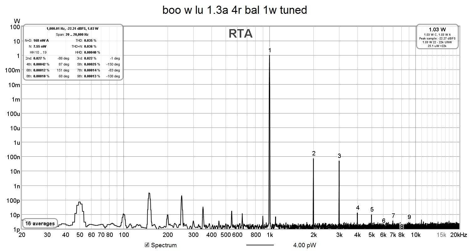

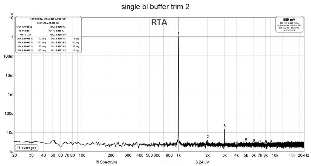

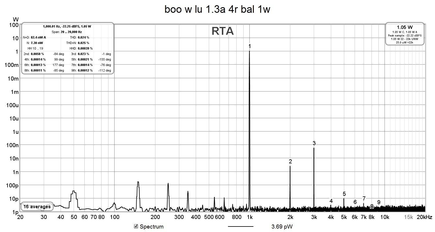

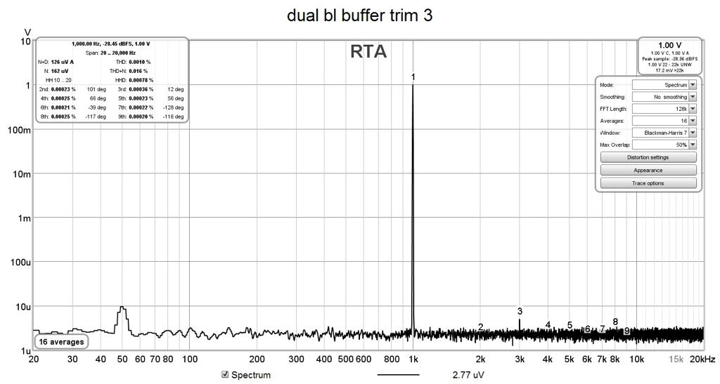

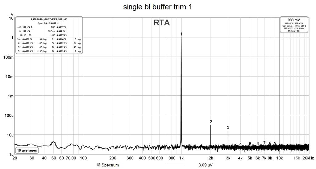

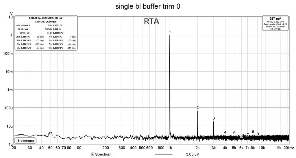

Since you asked.. the boo does a little better.
First thd was like in the first attachment, 1a bias.
I increased a bit the current through the os from 1a to 1.3a which lowered the 3rd with 50%, this was a good start to try again to tweak the second.
Because I can’t create enough mismatch by altering the vds of the LUs I can’t set to have the 2nd 2x the 3rd so I went for the 2nd 1/2 of the 3rd.I could adjust the polarity so I went for negative.
I didn’t do a screenshot for the config I chosen.
If I go for 1.6a bias I can play better with this mismatch because the 3rd will be lower and maybe there I get the chance to get what I want.
If until now it was fun to solder… now I discovered that it‘s more fun to tweak 😁

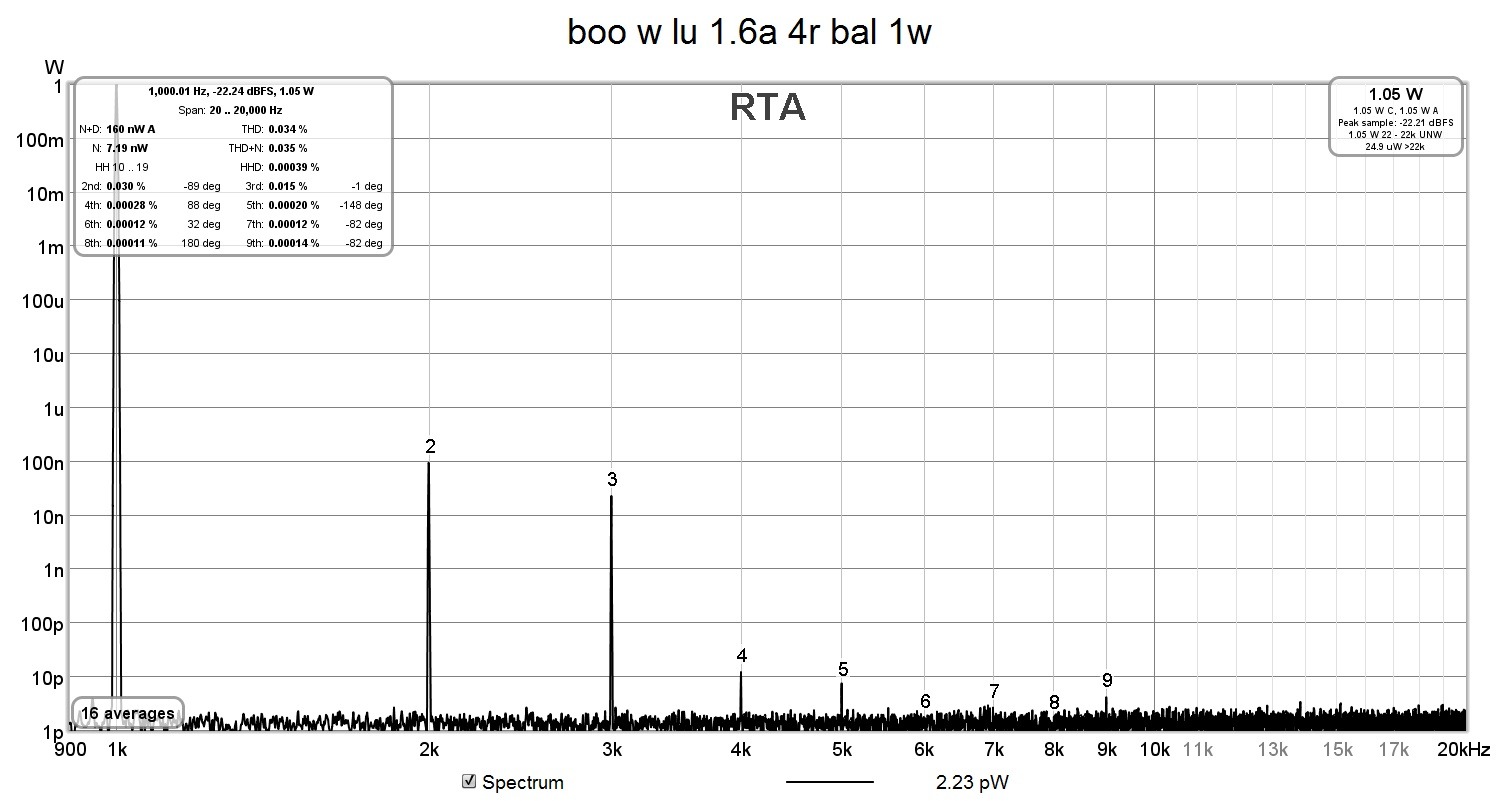

In both gm is implied…so what I seen interesting on the small one I tried to apply on the bigger one 😁
Now I raised the bias to 1.6a and adjusted everything accordingly :Popworm:
I will try to get same thd numbers but at a lower OS bias and adjusting other things.

Today I noticed one interesting thing.
When I built the mosfet version of boo I did 2 measurements at 1W and 1khz. One was with the speaker(as load) that has 7-8ohms at 1khz and the other one with a 4ohm resistive load. The 3rd with the speaker was 6x lower than with the resistive load.
Obviously when I built the boo with lu I measured again the thd at 1W/1khz but this time only into the resistive load and compared the result to the mosfet version which was using the speaker as load.
Actually both the lu version and the mosfet version have the same level of 3rd into my resistive load.
