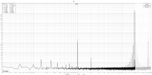

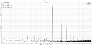

In post 109 I shown the thd at 190hz and 1khz for the output stage at ~2v(1w) into my speakers. I used balanced signal from my preamp.
In one test I used Iron Pre and in the other a balanced ba3 front end, I can swap the gain pcbs in my preamp.
In post 120 I did the ffts to see the thd of the preamp at 1khz only, first attachment is IP second is bba3.

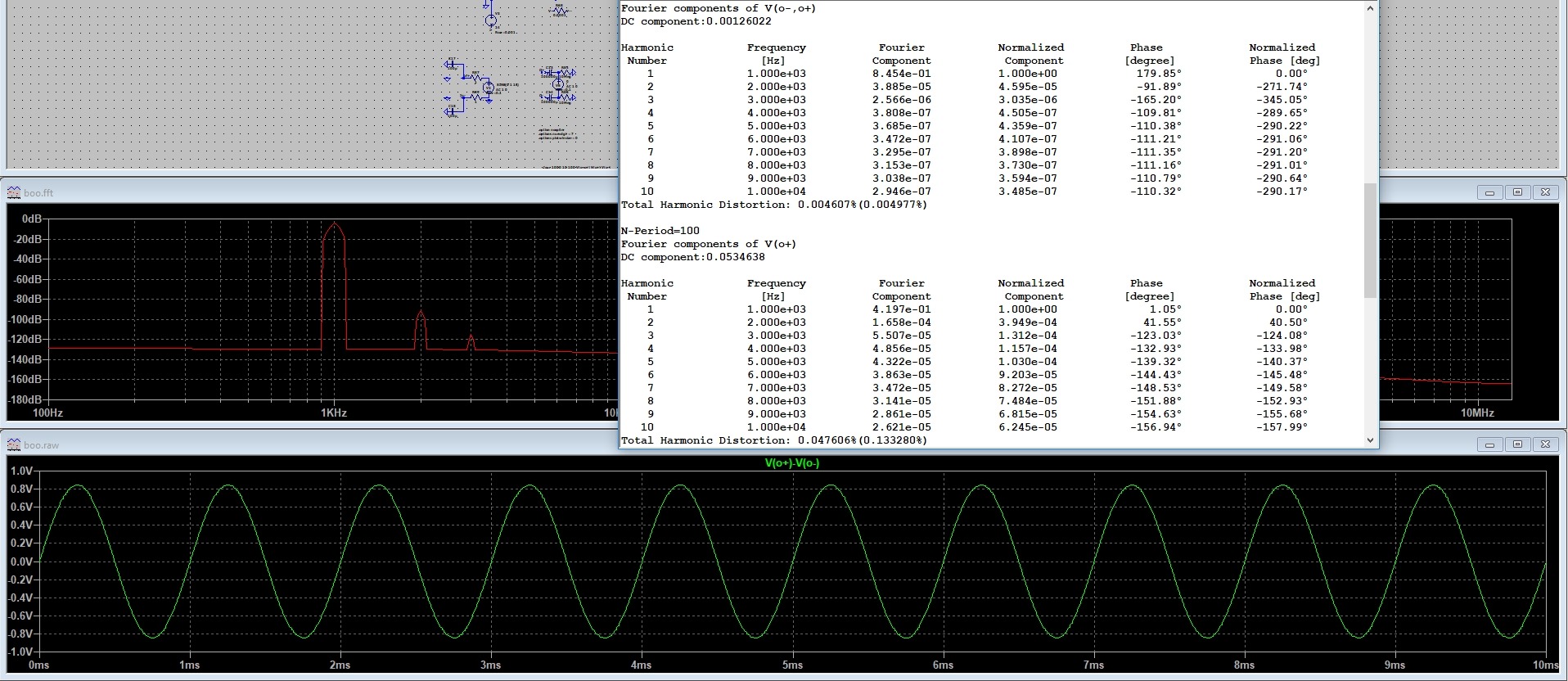

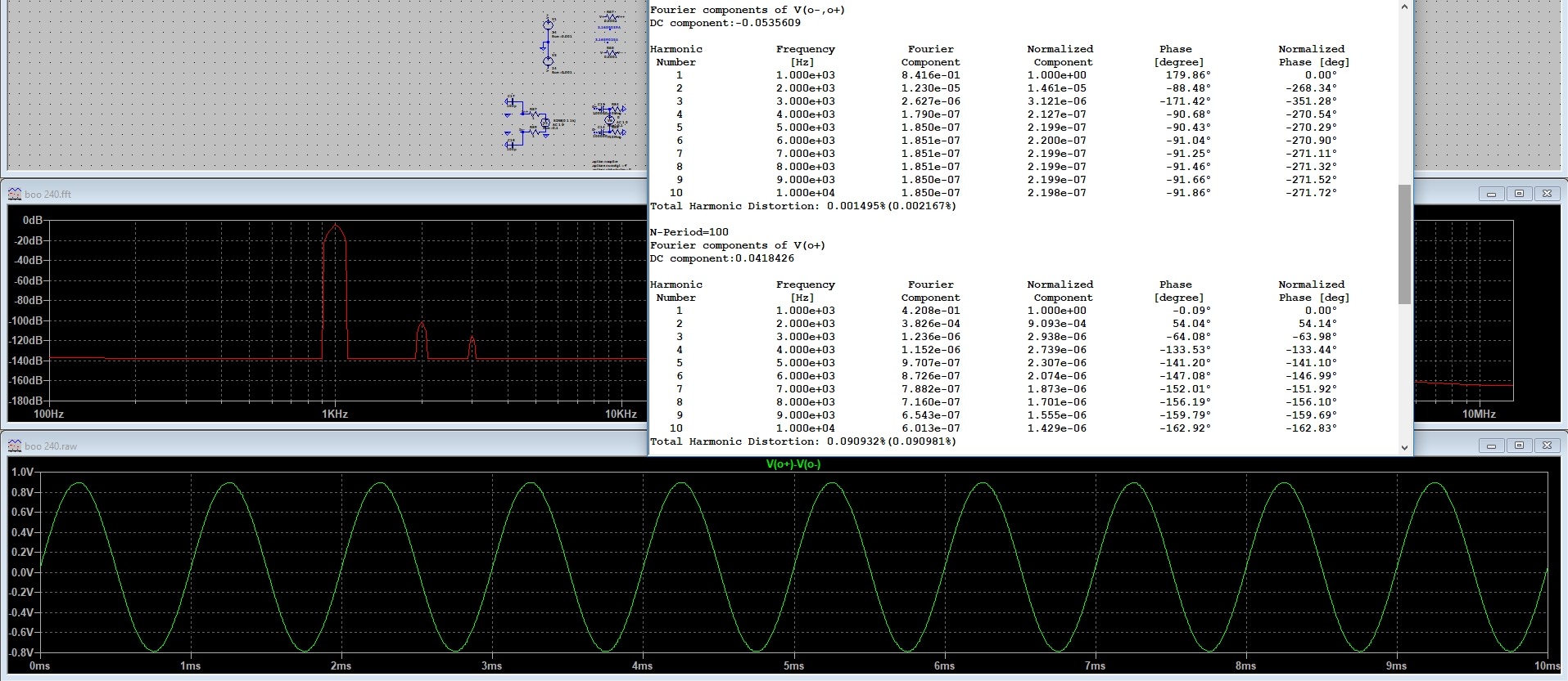

edit: what's real difference of using IRFP150 instead of IRFP240 - you can first predict using sim, and after that with actual change in am itself - making measurements of both iterations
in general, when speaking of non bridged stages - if you place part with higher xconductance in lower rail, there is increase of 2nd, negative
if you place part with higher xconductance in upper rail, there is increase of 2nd, positive
same way - if you place part with decreased xconductance (bleak lateral ...... or SIT :rofl: or Schaded mosfet) in upper rail, increase of 2nd, negative
if you place part with decreased xconductance in lower rail (bleak lateral of Schaded mosfet), increase of 2nd positive
now, what is happening in bridged configuration - match of several factors, FE included, and no use of too much predictions in general, better to work on particular case and voice it according to one's wishes
use 1Khz as reference
I used 190hz to have a reference at the minimum load the amp will see.
My amp is situated in this category but has the part with the higher transconductance in the negative phase. Is it correct to say that the 2nd of the entire amp is negative?
Looking also in the simulation I see that by connecting the irfp150 like I have it now(on the neg phase) I get 3x higher thd than with the irfp240.
The simulations for both of the above combinations show negative numbers for the phase of the harmonics.
If the thd is lower with irfp240 and also the negative 2nd is predominant I guess I could go with this one or my understanding of the sims and entire thing is wrong?

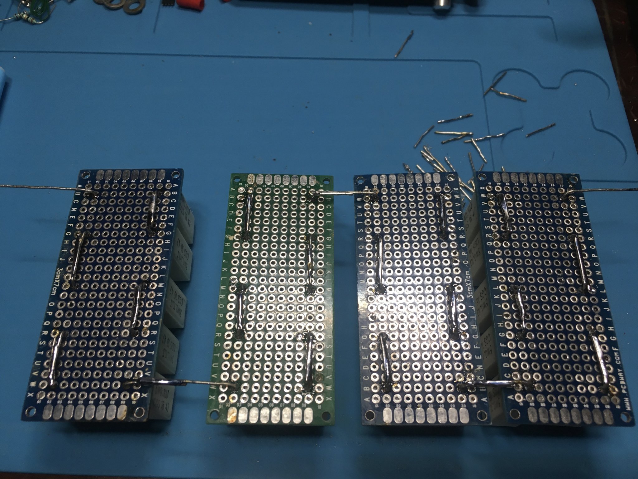

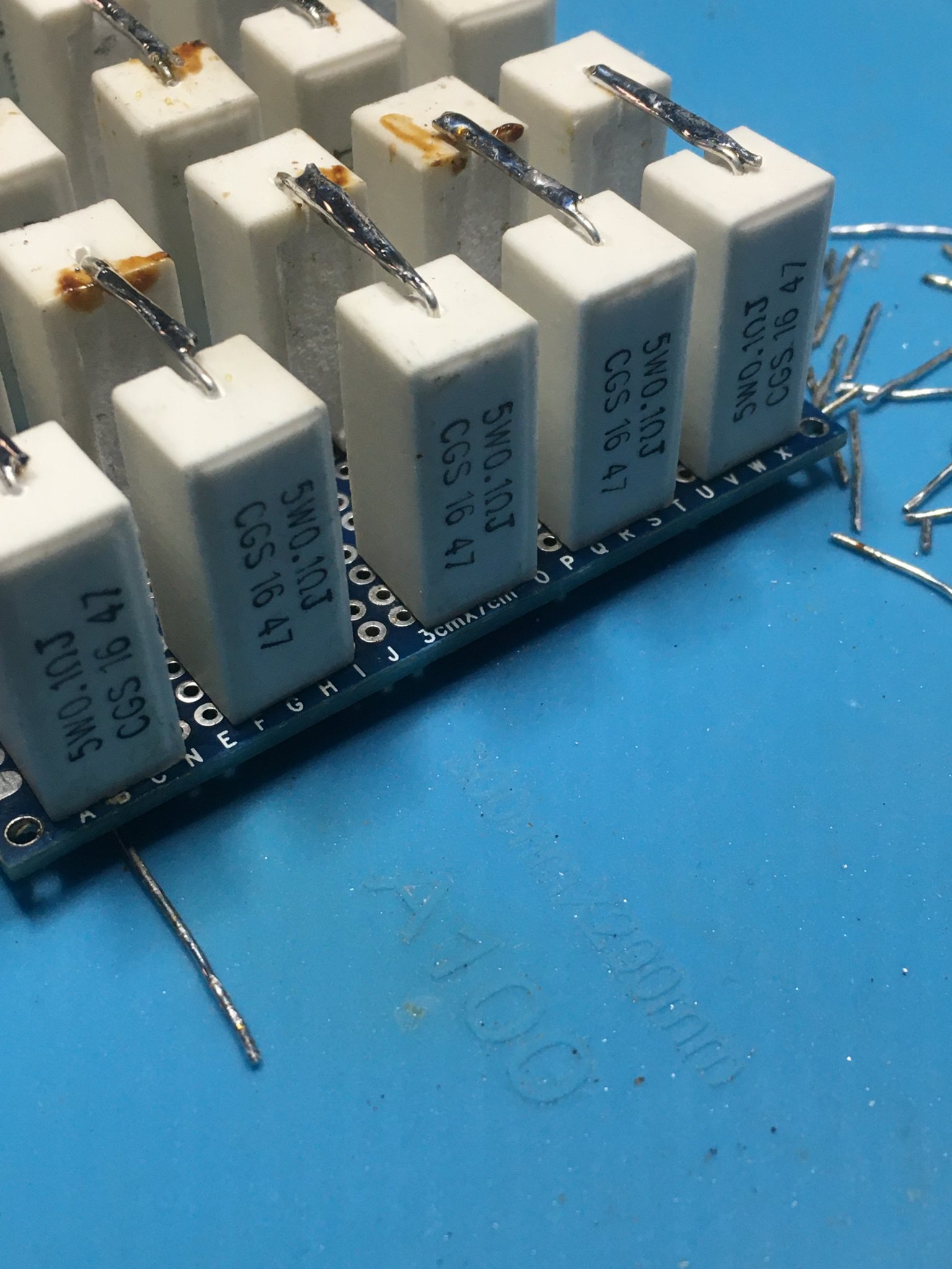

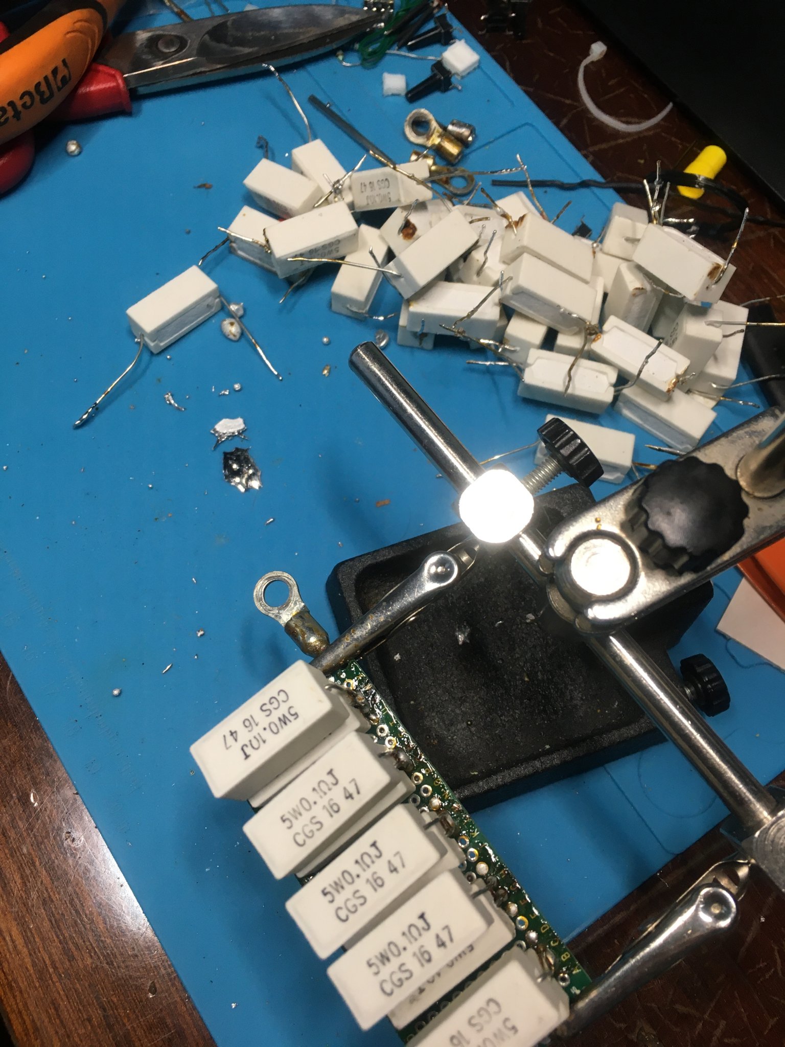

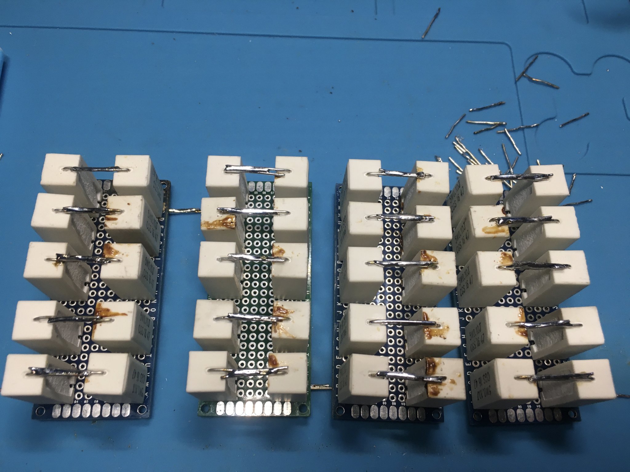

Yesterday night I disassembled a few current sensing resistors that I had around. I got a few 0.1r wirewound resistors which I will use to build a dummy load(3.5-4r) and most probable I will use some also in the power supplies to adjust the crc filters which will become rcrc.
edit: added the screenshots for the 2 simulations, 1st is with irfp150 and second with irfp240

I just finished soldering my dummy load. I have also fine tuning between 3.5-4ohm 😎

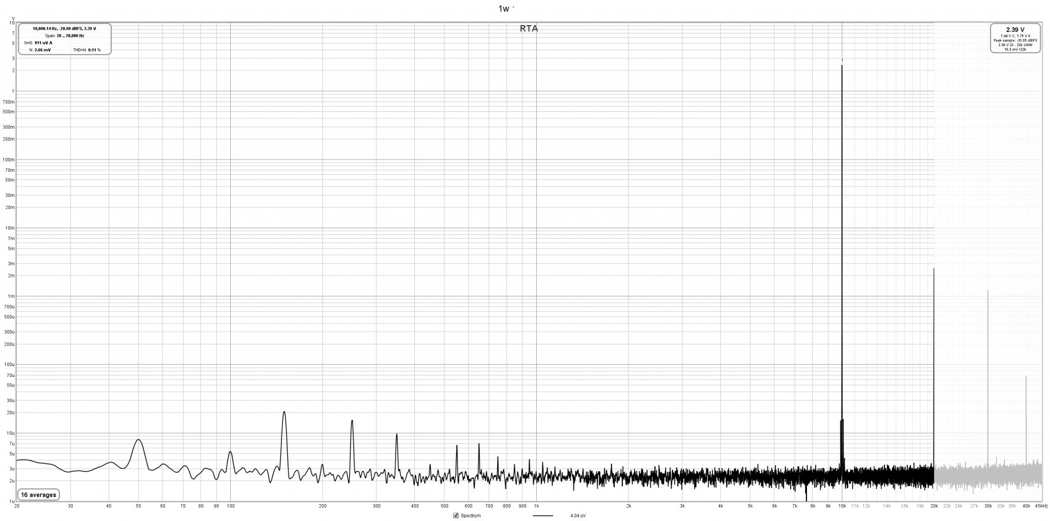

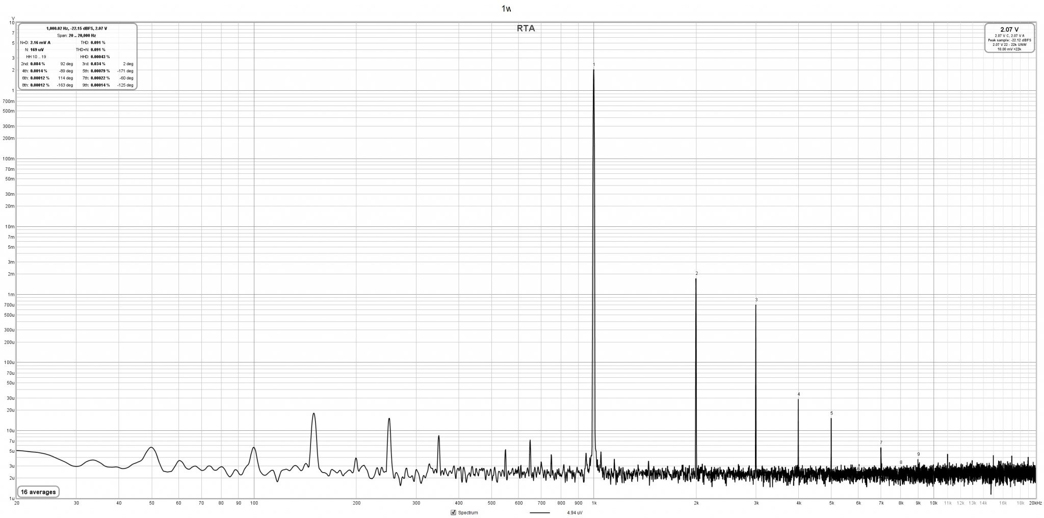

I connected the 4 ohm load to the amp. It warms up a bit at 10w dissipation.
I can get ~12w @ 1% thd, the screenshot went bad so I need to repeat the test.
The attached one is for 1w

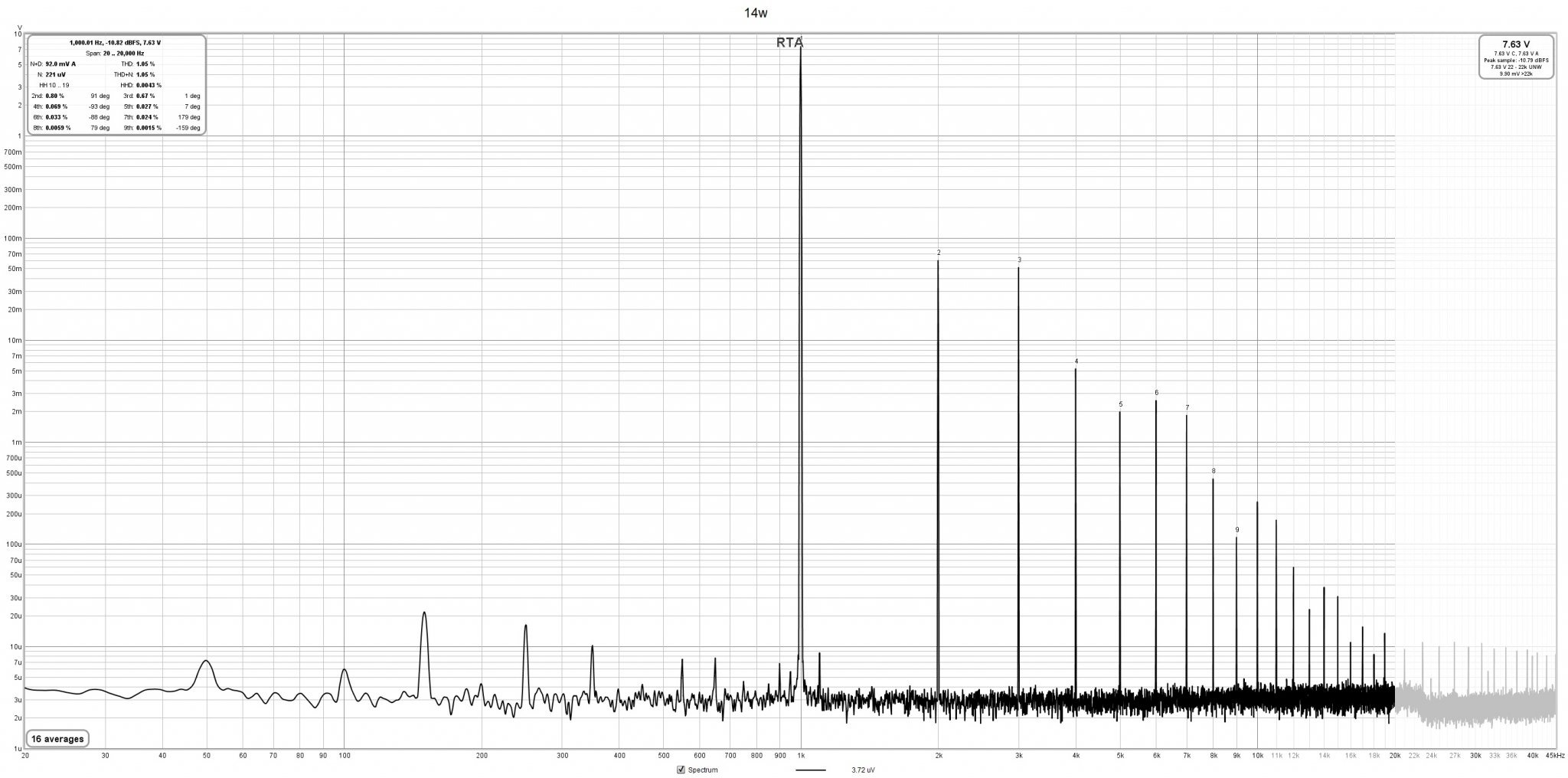

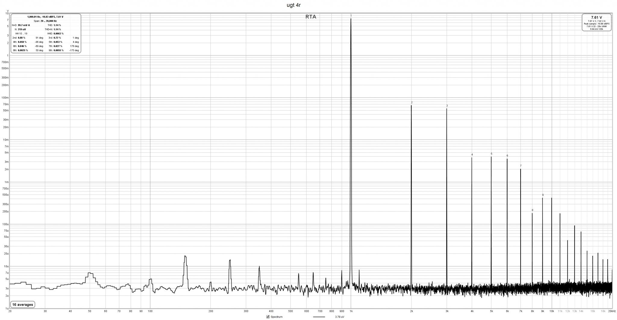

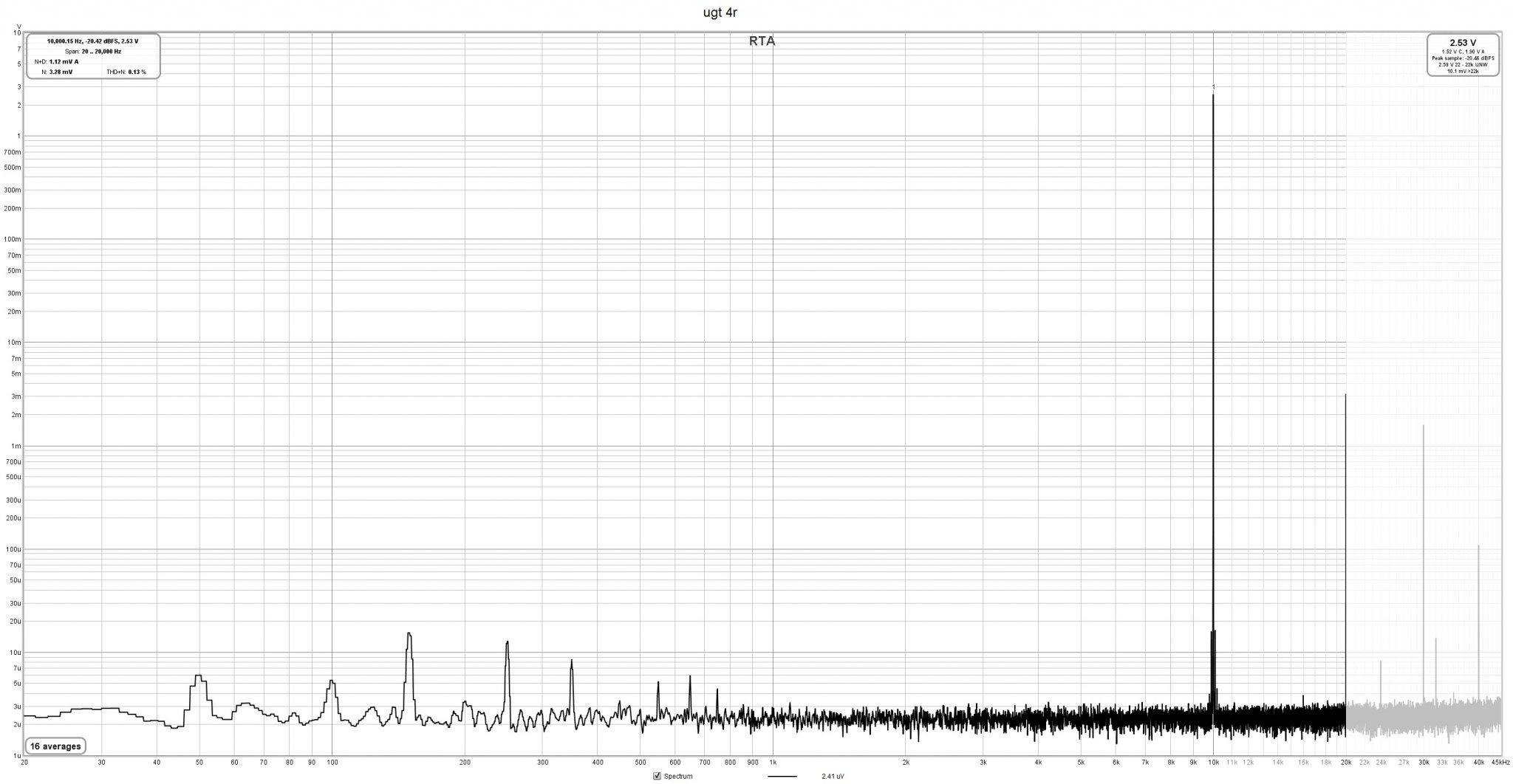

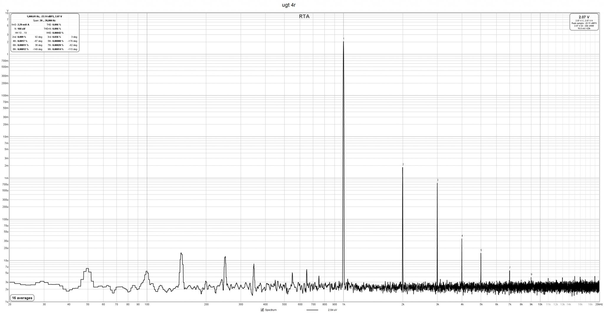

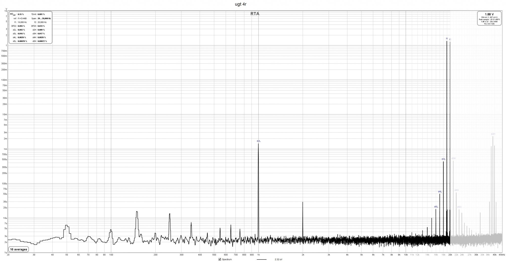

Today I replaced the bba3 gain stage(actually it is a muscle bba3, it has buffers on the input and output and also global feedback) in my preamp with Iron Pre(also a muscle version with the output buffered) and repeated the measurements I did yesterday.
1st screenshot is the thd @ 1w/1k, 2nd is the thd @ 1w/10k, 3rd is the thd @ 14w/1k, 4th is the imd @ 1w/19&20k.
Not much difference between one gain stage and the other.
Searching a bit in the old folders on my pc I found that the the aleph(heavily biased(1.6a/mosfet) as I had it) did 1% thd into 4ohm at the same 7.6Vrms as boo does, only that boo is doing it this with close to half of the aleph bias. Nice! and thanks again ZM
