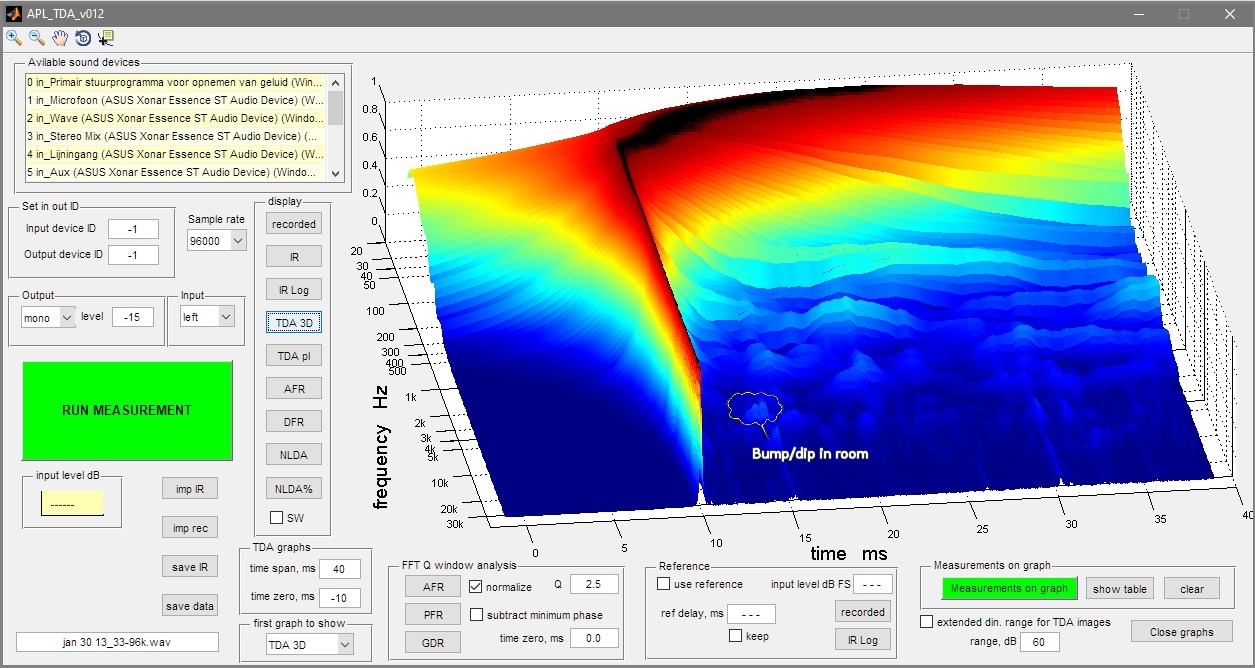

I got myself an update of APL_TDA to be able to see some things more clearly.

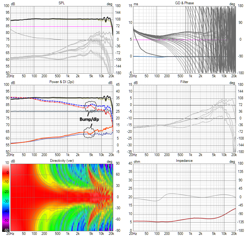

If you look at the Vituixcad predictions of my modded line arrays, you'll notice that drop in the DI at 4-5 KHz, or at the upper side, a bump in the power response:

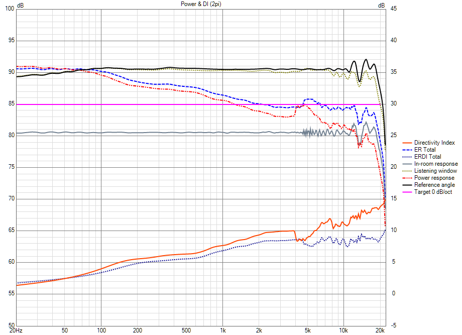

A close-up of the DI/Power response:
The horizontal coverage is pretty even and smooth, no doubt those devil's horns seen in the vertical Directivity plot are the reason for that bump/dip.
As the rest of the vertical behavior is quite clean (an understatement), this anomaly can really stand out. What it does in listening is making some 'esses' stand out. It may also throw off a guitar solo at times. The more the room is taken out of the equation, the more every wart that's left is going to stand out, that much has become clear to me.

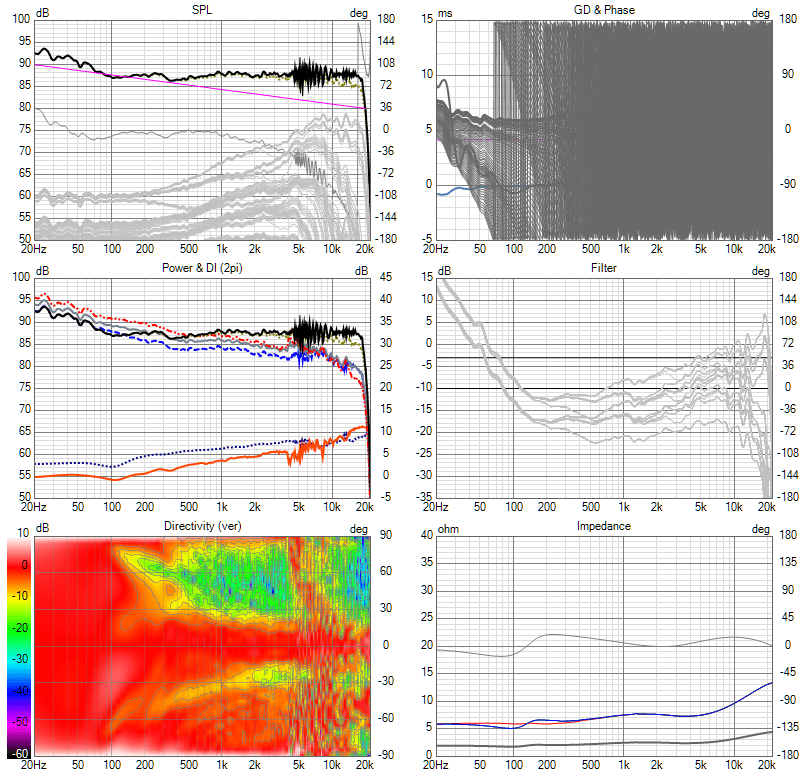

I did already make a virtual plot of the array with it's floor and ceiling effects... by making virtual copies of the array 'above' the ceiling and 'under' the floor. That way I could save an IR that includes all these effects, what it looks like is this:
The general shape of the vertical Directivity stays quite similar, but it's a bit hard to find out it's "real life" effect in the room. There's a wide comb effect caused by those horns somewhere between 4 and about 9 KHz. But how do we find it in the room? Well, I already knew the answer to that one, as I did find it earlier on with my unshaded arrays; in a plot made with APL_TDA!
Let's see how it looks as measured in my renovated room with the frequency shaded arrays:
So how much of an annoyance is it? Not that much, really. I can EQ it out (as the frequency at which it happens stays constant, only the timing of that disturbance changes somewhat, relative to where you are in the room) with a pretty steep Q of 8 and about -2.2 dB. The noticeable "esses" are gone, no freaky 'stand out notes' left in guitar parts. To be completely honest, I think I'm the only one that ever noticed it. Probably triggered by my knowledge of the dip/peak in the DI/Power response .
The main thing this new session solved for me was that I already had a broader EQ dip that was shaped much like the peak in the Vituixcad power response prediction, but somehow it still felt a bit "off" to me. A run with APL_TDA solved it for me by showing it's only quite a narrow peak around 5 KHz instead of that much more broad region starting at 4 Khz seen in the Power response predictions. One can also see that the current reflective peak off of the floor/ceiling is somewhat les pronounced than the earlier measurements of the unshaded array showed. The rest of the in-room effects are similar enough though, and most probably caused by the vertical planes like walls/furniture etc.
Another (small) thing to notice in the APL_TDA graph: I can still win a bit of timing by adjusting the phase on the subwoofers. APL_TDA remains my favorite program to show these details in timing/frequency more clearly. Be aware that we are looking at a Stereo in-room measurement that has been processed and normalized to make these tiny details stand out.
Now I have to find the time to play with APL's real time analyzer .

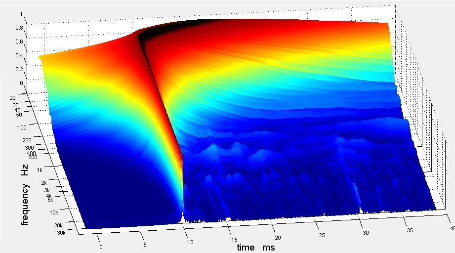

Just a simple phase tweak should have it looking like this:
Following the minimum phase shape of the array + subwoofer's bandpass.
I don't expect it to sound way different in this case, but for peace of mind .
