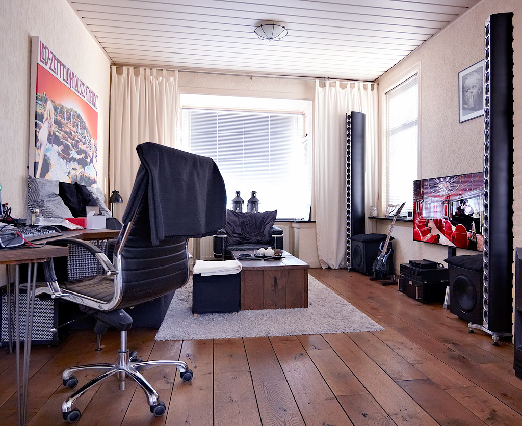

The total array design on the left and the final outcome of this project on the right:
(not too far off I presume)

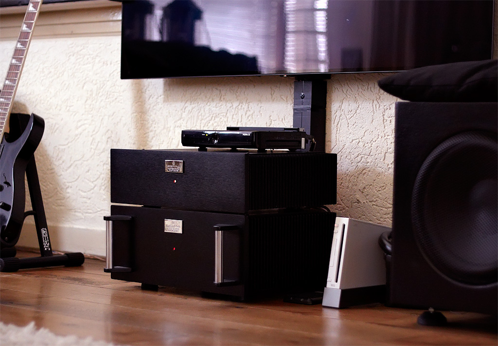

A Picture with the new DIY Scan Speak 30W/4558T00 subs added:
811714d1580045572-towers-25-driver-range-line-array-subinroom-jpg
The actual subwoofer build is scattered all over the thread, but here are some links:

And the new Fetzilla ambient amplifier that followed shortly after that:
