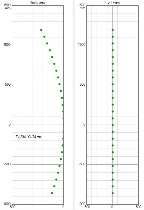

Focused array:
Listener is on this side <---

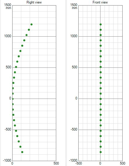

The CBT array;
Listener is on this side (again) <---
It had me confused the first time I tried these curved arrays in Vituixcad. So the listener actually is on the negative side (see -500 in focused array, "0" is center of baffle at listening height in all cases).

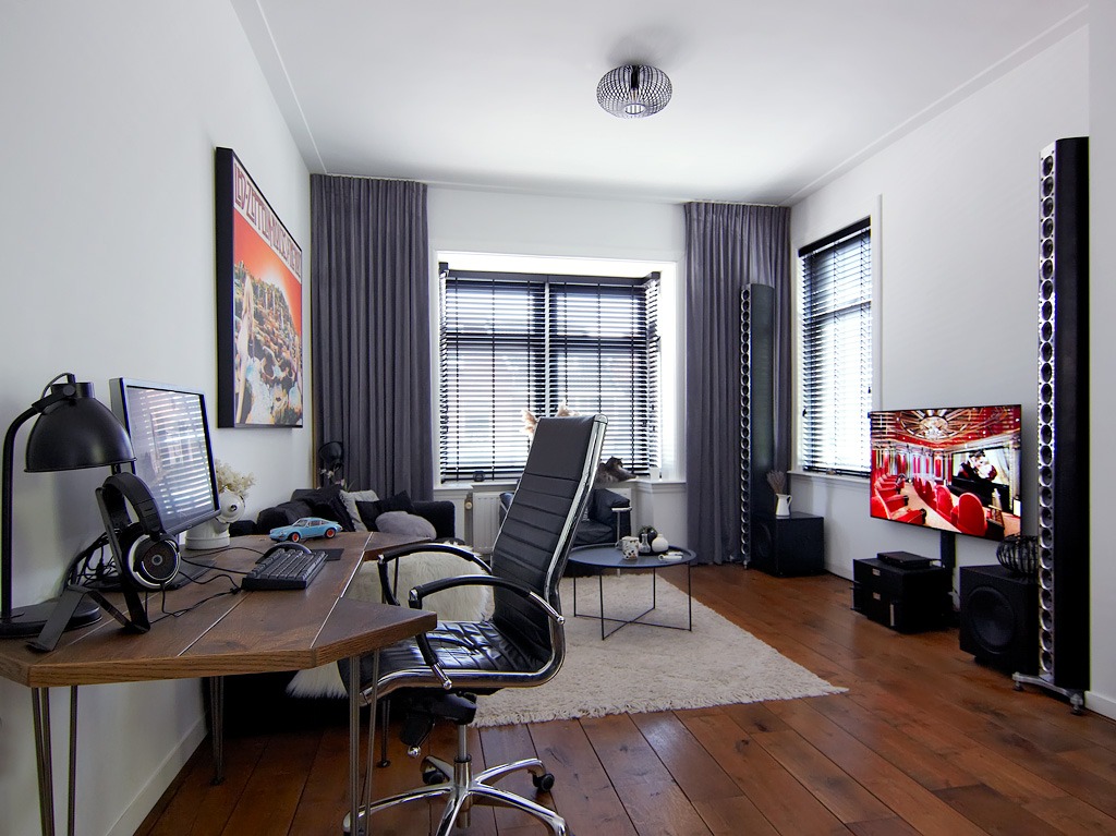

Forget about the speakers those are some beautiful wide plank wood floors!!!!!After riding along on a few different line array threads I figured this project deserved it's own thread.

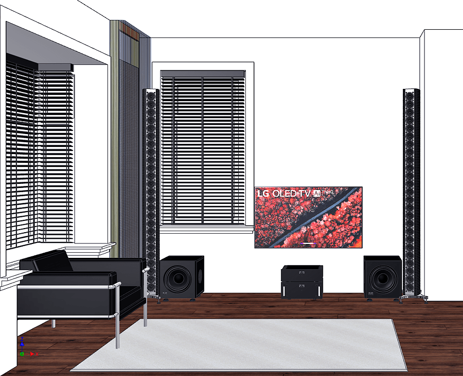

I wanted to get new speakers for my living room for a while but could not quite find something I liked.
The speakers I have right now are just too big to use in a proper setup. In a domestic setting with a girlfriend and a 7 year old son there's just not much room to place anything. After surfing the net in search for an answer I stumbled over several line array's.
Now that was something I thought had potential! Way lower floor space needed than my current speakers with 15" woofers.
So the idea was born to build line array's using 25 full range drivers in each array, long enough to somewhat be floor to ceiling.
Next problem, what should it look like? And what materials to use? I remember seeing a DIY thread with a translam construction. That idea was very appealing to me. You can make it any shape you want on the outside and the inner walls can be used to benefit the design.
I started up my favorite 3D program and started sketching. Pretty soon I had some ideas about the outer and inner shape. Here's a much later version to give an idea:
I wanted a round outer shape, round corners to help reduce diffraction. On the inside I choose a wavy shape to hopefully aid in scattering/diffusing the back wave and making the walls uneven in thickness. That last feature should help reduce resonances of the enclosure.
Also obvious are the braces, making it a potentially very stiff enclosure.
The total array design on the left and the final outcome of this project on the right:
(not too far off I presume)
