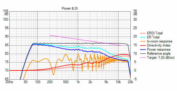

On the subject of averaging, lets look at the difference between a single driver and a filtered array at the listening spot with floor and ceiling reflections included (no side wall reflections in this one):
The orange line is the in-room prediction
If you ask me, that's where that magic in the midrange comes from...

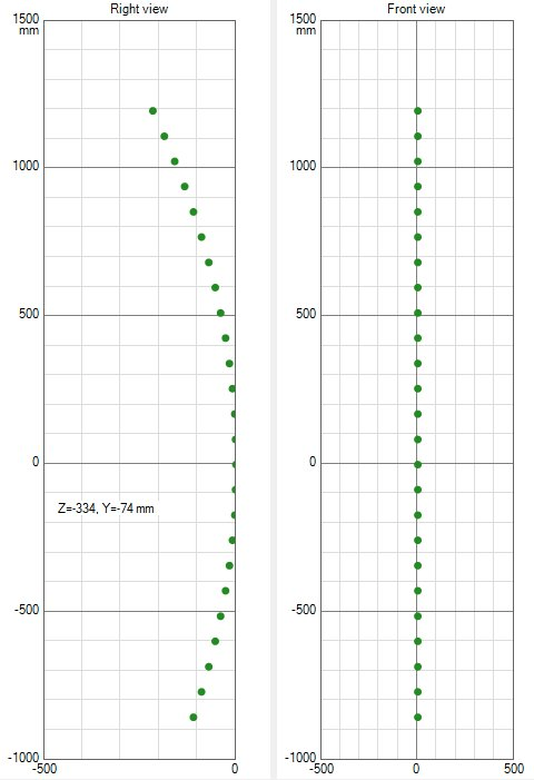

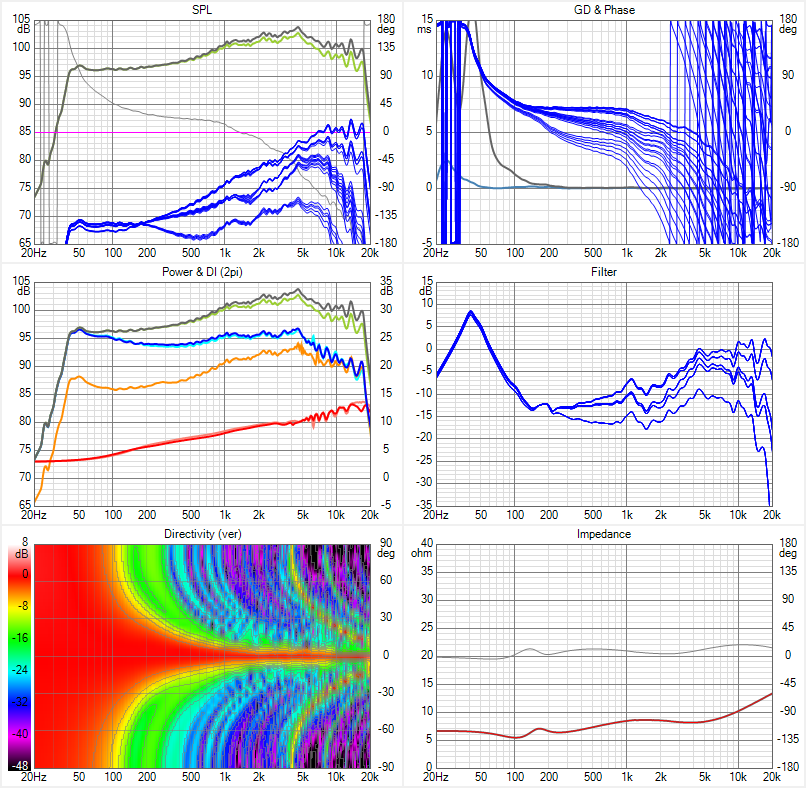

I remember experimenting/simulating both focused and CBT arrays myself, based upon my TC9 driver size:

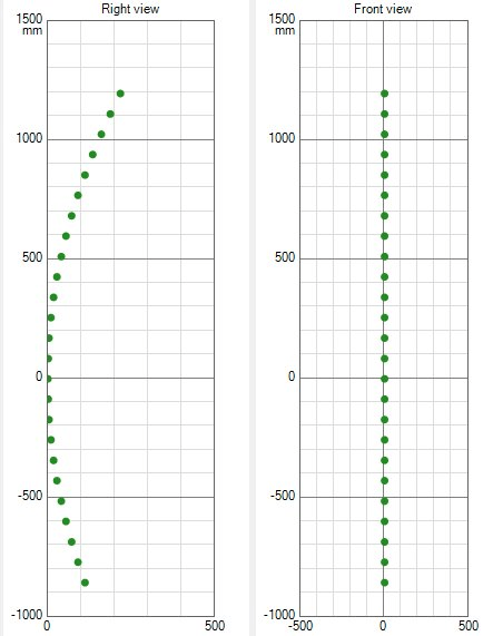

A focused array:
Driver configuration:

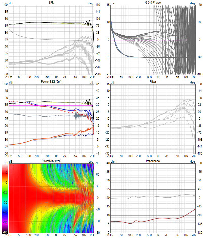

And the CBT array:

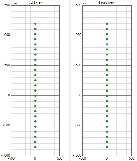

Comparing to my straight but shaded array:
These were quick and raw tests, well, except for the straight array as I invested quite a bit of time in that one . Don't look/stare at the frequency curve, pretend they are all straight, that's a matter of re-doing the EQ. Just look at the vertical coverage. Of special interest is the red DI line in the left middle graphs. All of them do pretty good in that regard. Mostly due to driver size (3.5" driver directivity + enclosure shape)
I ran these as kind of a sanity test, to decide if the filtered array I came up with was something to go for or not.
Clear to see the superiority of the focused array, if you can live with a super narrow vertical sweet-spot. And I do mean super narrow, almost laser beam like.
The CBT array as simulated here shows the widest vertical bundling. But it can't avoid comb filtering on the top end with a driver the size of a Vifa TC9 FD18-08. As I started with this driver size and did not consider starting over. Originally I chose this driver due to it's capability to do the whole spectrum, from the bottom low octaves (or at least as low as possible) to the top end (to the best of it's capabilities). The original idea was (and this idea remained) to have a (true) full range array.
The sim does need further explaining. My interest was to keep all 25 drivers to help out in the bottom end, so I used the same shading as was used in my straight array. This was done to keep the bottom end SPL capability as high as I could. If I were ever going for a CBT array, I'd still use this type of shading over the more conventional driver (group) shading as proposed in the CBT papers. That last shading option does not provide the bottom end SPL capacity I wanted to preserve. My shading is largely done as (high) shelves, so for the top end, it should not end up being a big difference to shading the entire driver (group). The biggest difference is that all drivers do contribute to help out in the bottom end with this frequency dependent shading. Vituixcad can sim this type of shading, and in the case of straight arrays gets very close to real world results, so I expect no difference when simulating arced arrays.
Last, but in my opinion not least, the shaded array I went with, as said, a chosen compromise of driver size and bandwidth. If one would use bottom end reinforcements like sub woofers, a smaller driver provides less of a compromise on the top end. Be aware that single subs may offer different output levels/distance compared to an array for mid and top frequencies, but within a room this is largely manageable as the room has quite a bit of influence (my bass gets louder when I lean back into the couch, even though most output would be generated by my stereo pair of subs).
So depending on one's own set of compromises, there is something to say for all types of arrays mentioned above, my preference for an array that only has to do ~150 Hz and up would be different from what my original goals were. My current arrays still help out with room modes, even though they are less potent with the 10F drivers than they were using the Vifa TC9. I shelve them down a bit and use less EQ on the bottom end. They do just enough to use them as part of a kind of multi-sub solution down to about 60 Hz where the subs can handle it on their own. I'm only using them where they get lots of help from being close to the back or side wall, so they don't need to do any hard work. In other words, their excursion per driver in the bottom end is negligible.(*)

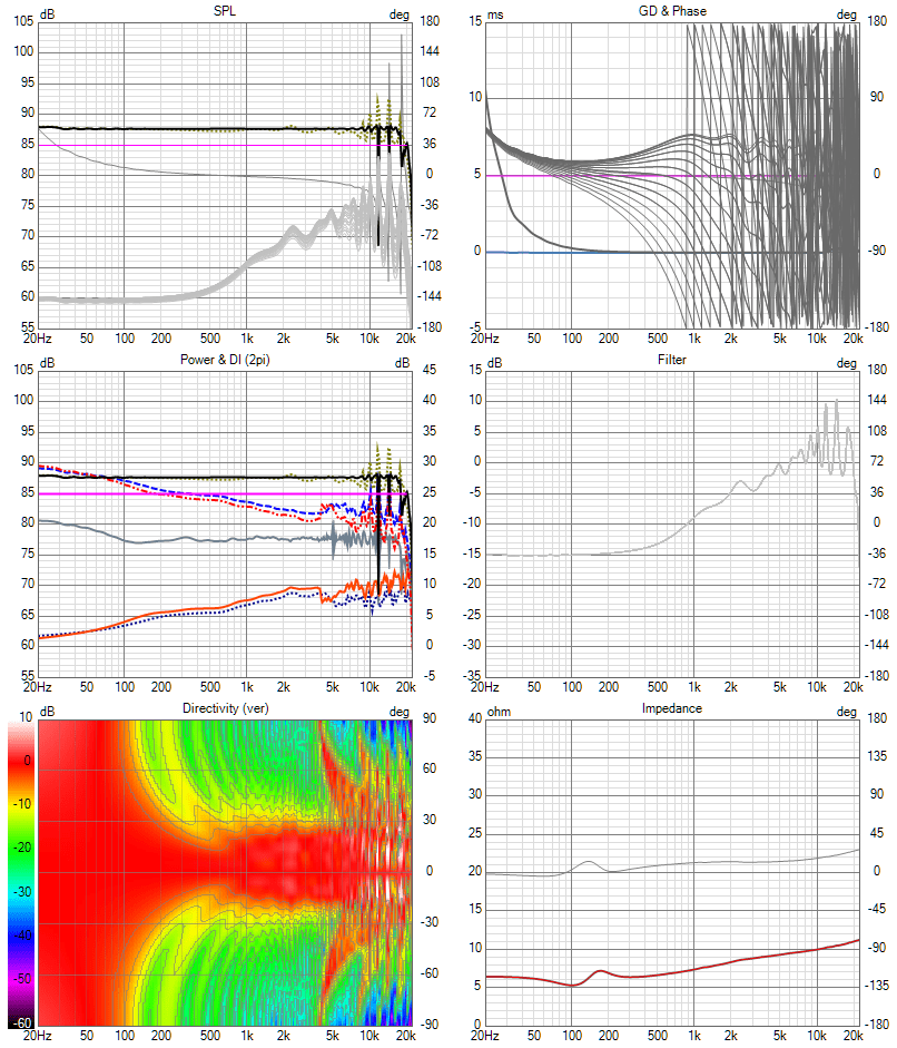

To complete this post, I'll add the unshaded 25 driver array with the same settings as the above. After all, that's the one I could live with for at least 7 years without remorse.
Straight and unshaded array:
And it's driver layout (identical to the filtered array):
What this proofs to me is that you need the smallest driver you can get away with for the widest bandwidth you're aiming for.
This holds true for the CBT as well, size does matter. For my original goals, this meant a driver the size of the Vifa TC9 FD18-08.
With other priorities, it might have been something else.
