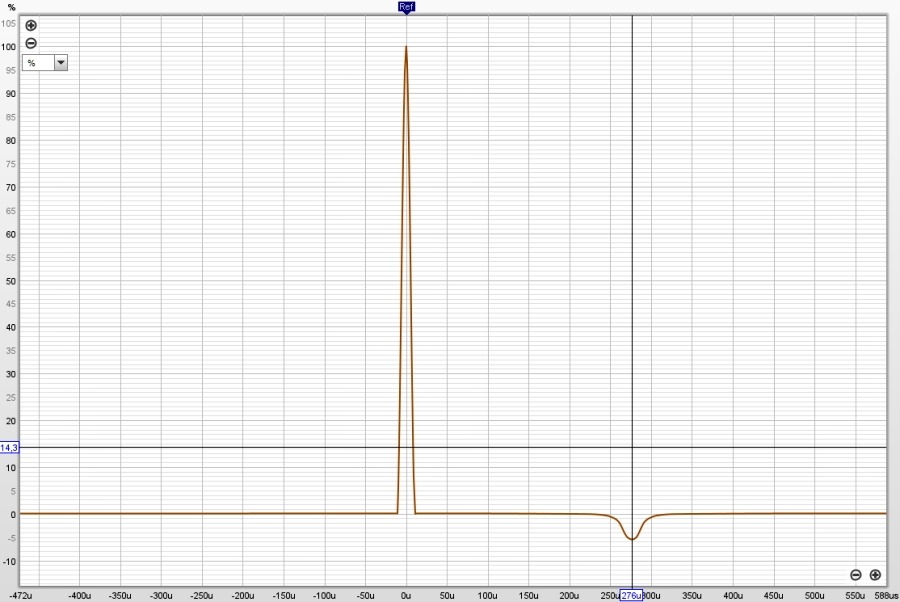

@krivium has been busy creating test files that split up the vocal part of an AI voice into a number of groups that get panned across the stage.
To get an idea how it works, just check out these reverence test files that show the original text before it is split into band-passes to test its position.
I've been using the preliminary files to test my own setup and we're still making tweaks to the files. However it is quite a fun exercise and tells a lot about the imaging capabilities of your setup. It's also useful to test tonality across the stage.
You guys may remember it, my whole mid/side tweak thing started to correct tonality across the stage!
Based on the preliminary test files I did make a couple extra tweaks, this time correcting the positions of the top end (above 4 KHZ!). Lots of the tweaks I've done were based on remembering what did what and dialing it in one at a time. Re-reading the Griesinger paper we've been so busy with discussing made me correct a mistake that I had not fixed ever since I put in the Scan Speak drivers.
For those that follow along and are into "recorded music" like Pop or Rock as I am, that paper can unlock a whole lot of fun!
It also tells me that I made the right choice when I went for "Stereo Bass"!
If you think that bass stream of the lower notes in mono anyway, think again! You're missing out! I used to call those lower notes the atmosphere creators for a good reason. They really define the feel of space. The lower it goes, the better it is. But keep it stereo and tweak it so it's width is similar to the higher notes. We'll soon have a tool-set that should help check that property.
Have your cake and eat it 😉, great imaging, tonality, dynamics and envelopment. You really can have it all at once.
Lots of songs really open up with these tweaks. Some are insane, like Shakakaw from Infected Mushroom.
The best part is that you can have the feel of envelopment and space without those early reflections. I've said so many times, but this time I guess I intend to prove it for anyone willing enough to try.

Did a trial with the anti-cross talk I have running. Slowly trying the delay, starting at 220 us up to 290 us to see which I liked best.
Could not choose between 270 and 280 us, so I'm using a mix of these two:
2x TrackControl to set delay summing to one middle ground delay between 0.27 and 0.28 ms.
(In real life this doesn't have to be 0.275 ms, I still need to check that by running a dry loop and view it in REW)
Edit: turns out to be a 0.267 delay dip in the IR. This is a 44100 file upscaling to 96000 before processing which can change/influence what TrackControl is able to do.
(most delay VST's I tried produce way worse in accuracy, that's why I decide to listen and pick the one I like)
The above tuning isn't what I expect to end up with, but it was an indication of a direction I had to move in.
Let me explain: half of the end result is the EQ I use, the famous mid/side EQ. The other half is a cross talk cancellation dip on top of that EQ.
That's that little dip after the main pulse at 276 us. But it is meaningless when viewed without the accompanying EQ.
I've altered the EQ to match the direction this was pointing towards and did some further testing. Currently the cross talk dip is centered at 265 ms after another session. Still need to check if I end up at 260 or 270 us or stick with the 265 us I have dialed in today. Another little tweak in the EQ, ready for another round 😉.
(the difference can best be heard in vocal parts, the more I get it right, the more intelligibility increases)
More trials: 265 ms it is...
