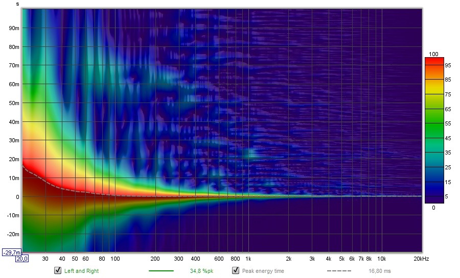

I have wrestled with plugins, especially phase linear EQ plugins. They didn't all seem to sound alike. For the longest time I was happy on Windows 7 Pro, with the equalizer plugin PlParEQ.
My FIR processing had become a study of sorts. The less I corrected with it, the better it got, meaning: using the shortest (frequency dependent) window I could get away with. For a long time I've used DRC-FIR for the correction, but always trying to find that ideal mix of linear phase and minimum phase. Eventually I've found my optimum preference. Short (frequency dependent) window minimum phase correction with DRC-FIR plus a manual phase manipulation (with RePhase) on top of that, as all that needs correction/manipulation is what is below Schroeder. And even there, knowing what you can correct and what not is essential. (study what happens in the room)
When I moved to Windows 10 Pro, and at the same time wanted to use 64 bit JRiver, I could start all over again. I couldn't use my trusty PlParEQ anymore, as it was a 32 bit VST program. So I needed a replacement. Eventually, I've found one that satisfies me in Equilibrium. The rest of the process didn't change. It takes me (what seems like) forever to work towards my goals, but it does work.
It doesn't take long in listening to hear what I want to hear. It's either there or not. Many EQ tweaks take me time to judge, but timing? or call it PRaT is recognized (or is it felt) immediately.
What I like about phase correction, being able to get that timing I've shown more than once (at the listener's ear):
It creates a sort of bloom. Probably not a great term for it, but the music simply sounds more "full". I can only ascribe that "full" sound to the lining up of the harmonics. Much like picking up the acoustic guitar, holding it firmly to your body and play super clean notes (takes practice and that sound isn't found all that often on 'girl with guitar' music). It projects the sound into the room, fills the air so to speak. For me, that's what I'm after. Involuntarily you're pretty much forced to move your feet to the music, the music takes over. Key words: balance and timing, headroom is required. Shivers down the spine and hair raising.
I've tried to find logical answers for all of it. For the FIR filters, I was able to find clues that have led me towards my current way of doing things. But for the equalizers? I tried more than one, yet only a handful remained in use. Right now, just one: Equilibrium. Don't need to look further.
But I cannot (yet) find a clue as to why, because when I inspect IR's made with say: Fabfilter Pro Q2 vs Equilibrium, I see no difference that I can point at. Yet, I prefer Equilibrium (when using linear phase mode).
If this all sounds a bit 'whooly', far fetched or audiophile like, I apologize. But hey, this is what I've encountered so far. These days my son, who has no interest often is used by me for a sanity check. He has no interest in the technical side, but speaks his mind if he likes what he hears. I try not to tell him if or what I've done, just let him take control over the music library and let him do his thing. If it's right, one usually hears it anywhere in the room. If it's wrong, and gets on my nerves after a while, I'll feel it in my body, cramping up etc.
I'm not afraid of DSP though, as it has given me lots of joy. 😉 I'm gonna close this window now and listen to some tunes...
