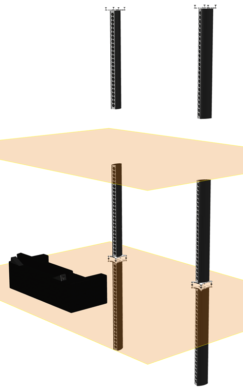

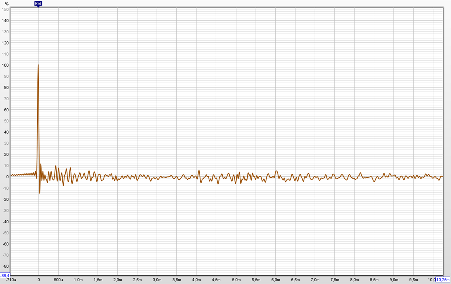

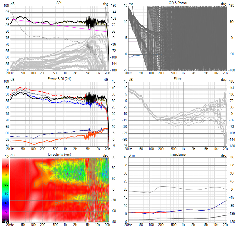

I've said I use VituixCAD to see what floor and ceiling effects I could expect. Firstly, VituixCAD has floor and ceiling effects build in, so once you design your speaker, just turn on the desired room effects and you'll get a prediction of the in-room frequency curve(s). I was looking for something more, an IR that I could compare to my in-room measurements. As I did have enough of those. @nc535 did lead the way and got Kimmo to expand the VituixCAD program so we could model the floor and ceiling reflections. So what did we model to be able to view that IR?
Pictured, it looks somewhat like this:
(man made, no AI was used in the making of this picture 😉)
Pretend those yellow planes are the actual floor and ceiling within the room. We modeled the arrays like usual and put mirror images of the array above the ceiling and beneath the floor. Using the respective ceiling and floor as the mirror. One day I may try the same for back and side wall results.
That's what's being modeled in this VituixCAD result below:
In this case the reflections are modeled to be 2 dB below the level of the real arrays. I put a second order highpass at 30 Hz to mimic my in-room results. The result in the upper left graph now represents the arrays + their floor and ceiling reflection. Which means that if I export the Impulse response "Total SPL", these reflections are now included. The FR graph looks exactly the same as the one that VituixCAD models, except that one is just a frequency response, not able to be saved as an IR.
That IR (total SPL) is what resulted in that animated gif (versus the in-room measured result):

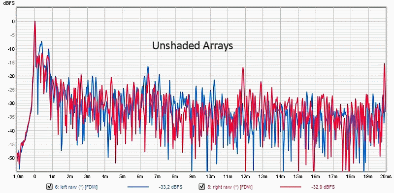

One thing that cleaned up the IR is the ETC differences between unshaded and shaded arrays:
(the room changed quite a bit too, between these two plots, as well as the drivers used in the array)

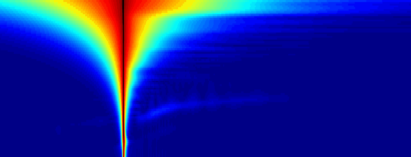

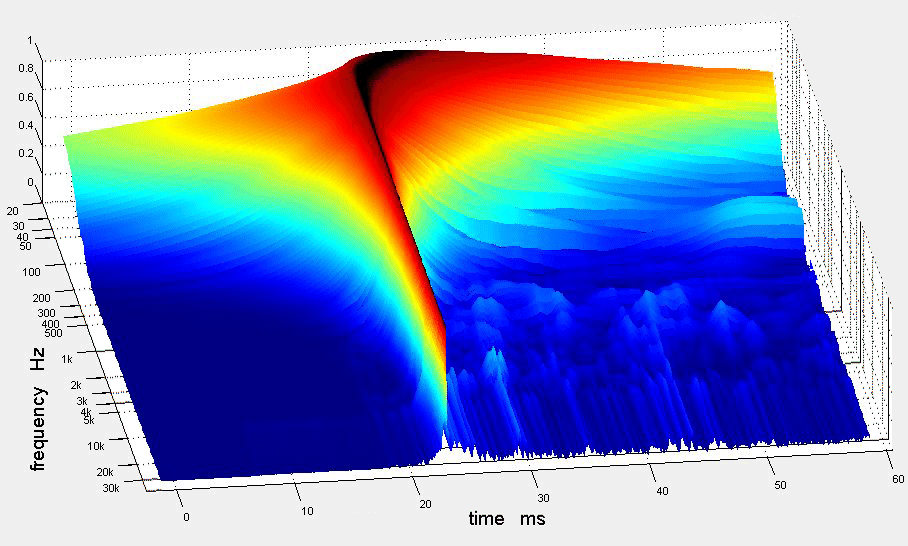

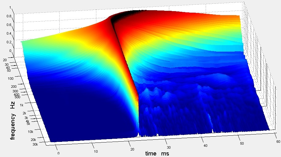

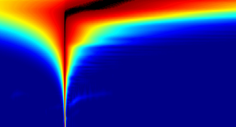

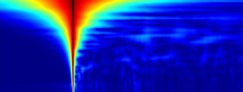

This difference can also be seen in the APL_TDA plots, first the unshaded array:
Compared to the frequency shaded array set at the same time frame:
Fun to see I had a lower cut-off frequency with the unshaded arrays running fullrange. (didn't have subwoofers back then)

Animating the change going from unshaded arrays with TC9 (without subwoofer support in our room pré renovation) to the current shaded arrays using the 10F (with subwoofer support in our freshly renovated room):
A change starting in Februari 2016 and moving towards Februari 2024
A lot of little things have changed in this period. Overall the changes have had the most effect on the vertical directivity, and that does show as a reduction of in-room energy in the top end of this graph (4K and up).
Horizontal directivity has remained the same, the changes in our room being responsible for the largest difference here.
The added subwoofers did clean up the in-room result of the bass below ~200 Hz. The shared load there further reduced the influence of room effects.
