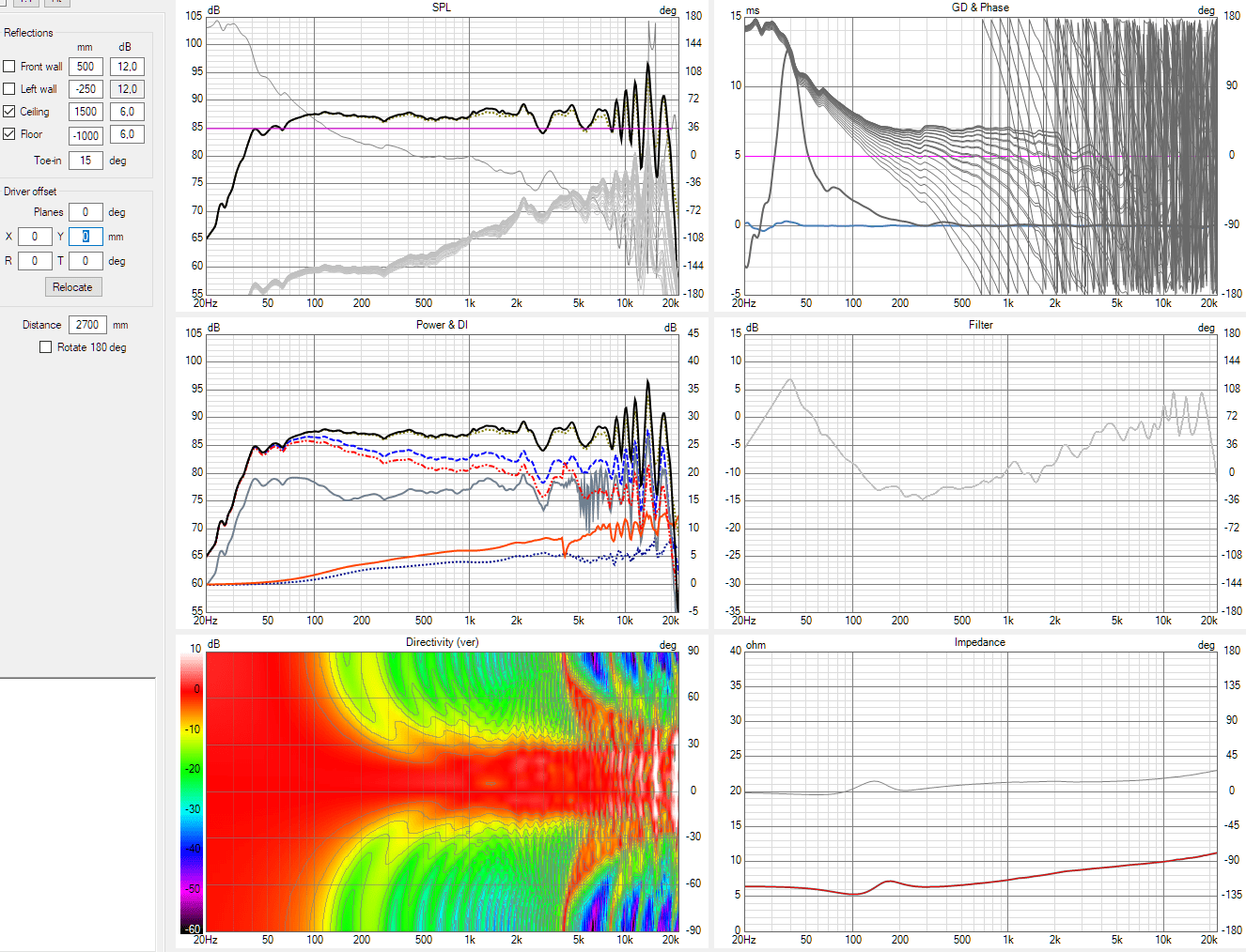

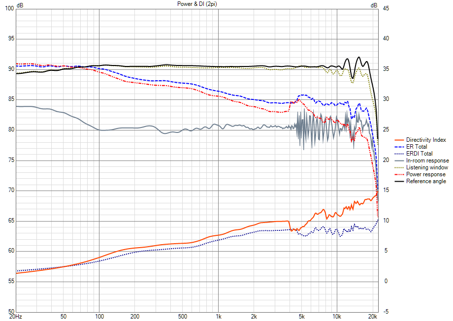

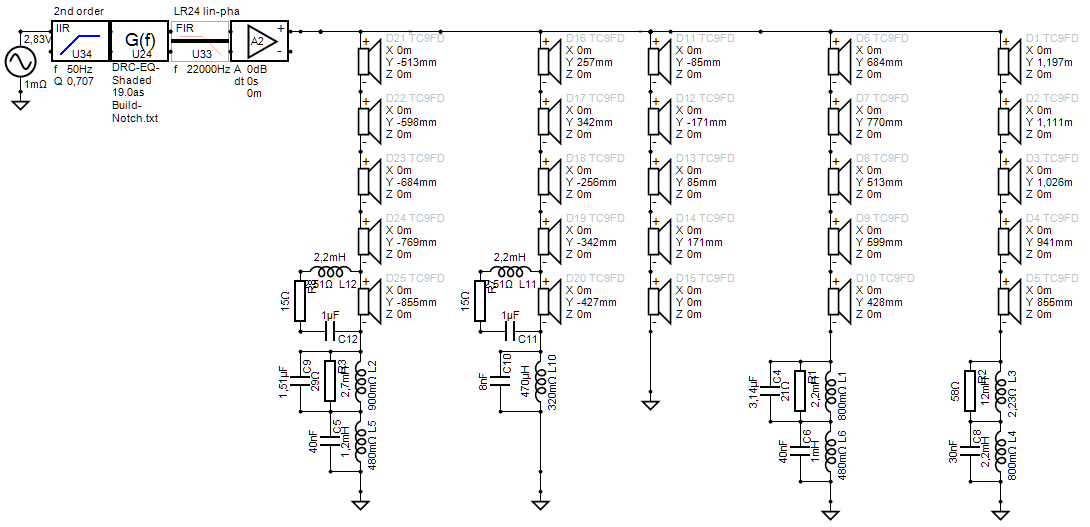

Looks like you could squeeze five more drivers in there! Wouldn't that fix the wiggle at 5-10khz?

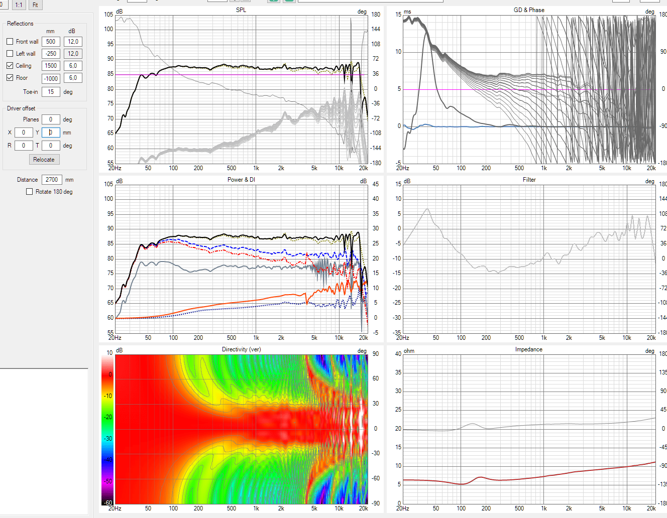

Sadly, no. It would only influence the frequency where the side lobe shows up. And only somewhat. If I simulate it with VituixCAD where I put the ceiling above the end point of the array, I get a more severe reflection at ~5-6.5 Khz:
(ceiling just above the array)

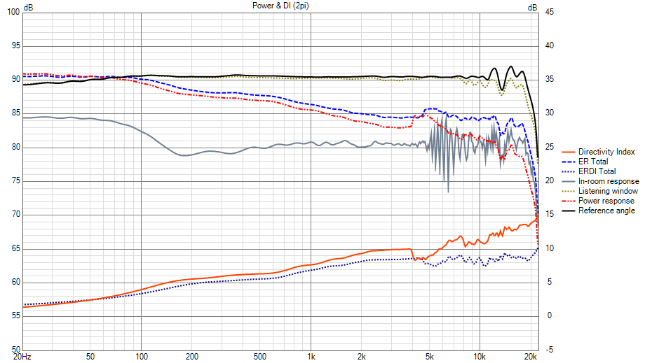

With more spacing above the array I get less of a sum of the lobe effect due to the distances that vary (more spread out at 4-5 Khz):
(ceiling where it is currently, about half a meter higher)
So it's not worth it to me. The side lobes simply are a result of driver center to center spacing, nothing to do with this array being a true floor to ceiling array or not. About 70% of ceiling height gives enough advantages to call it a tall floor to ceiling array.
Symmetry isn't always ideal 😉.

Doubt. What if instead of using the towers on the floor, with space between them and the ceiling, you installed them in the middle of the wall, so that the distance from the first driver to the ceiling was the same as the last driver to the floor?
I'm sorry if you've already simulated this before and I haven't read it.
I haven't tried that specifically. But from previous experiences I did learn that symmetry isn't always our best friend. While it may appear to be ideal, any side effect it may have would double up. For instance a reflection, having the same distances between floor and array as well as ceiling and array would mean that any reflection becomes twice as strong. So it's best to have it vary somewhat. It's like the diffraction of a tweeter on a baffle. Place it in the center of the baffle and you have equal spacing to the diffractive elements. That's why we often see a tweeter or even mid placed somewhat to one side.

Your contributions are incredible! You imagine, test and demonstrate. I would love to know what criteria you used to define the shading cutoff frequencies. I think it's very important to understand the graphs you shared here and on https://www.vandermill-audio.nl/adding-passive-filters/Acho que nunca postei o esquema real da matriz TC9 sombreada por frequência que acabei de usar:

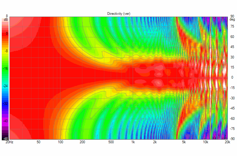

A quick view of what it does. I assume the use of an unshaded array in a 2.5 meter high living room. Further more I assume a listening height of about 1 meter (seated ear height).
First a 2.5 meter high living room. Array on floor:
Next, moving the array to the center of the room:
Don't mind the irregular frequency response, instead look at the red line in the left middle graph plus the bottom vertical Directivity graph.
If your room isn't higher, it could work just fine. In fact, the resulting Directivity Index looks slightly better (minute differences).
One other advantage is that standing listening position will now almost be equal to seated position.
If the room is any higher than the 2.5 meter ceiling I mentioned, use a longer array! Or move the listening position up, that should work too 🙂.
A shaded array would make less sense in this situation because the array center is above seated listening height and below standing listening height. I favored seated height and made my shading model ideal at that (1 meter height) listening spot.
I highly recommend getting VituixCAD yourself and modeling your living room! A starter package of an array with the TC9 can be found in nc535's thread.
If you view the VituixCAD six-pack of graphs, I looked at the bottom left graph to optimize the vertical directivity and the red line in the middle (representing the directivity curve). I experimented with values until that directivity became more bundled. Pure low-pass didn't work that well so I used something resembling shelf filters, often combined with misused notch filters. Basically anything that worked!
It took me a long time and several versions before I had something useful. I counted to version 19, but several of the in-between versions had a, b, c and d variants 😀.
Be aware that I re-wired my array to have a group of 5 drivers that were centered around the 1 meter listening height. I accepted the fact that standing position would have a slightly less optimized result.
