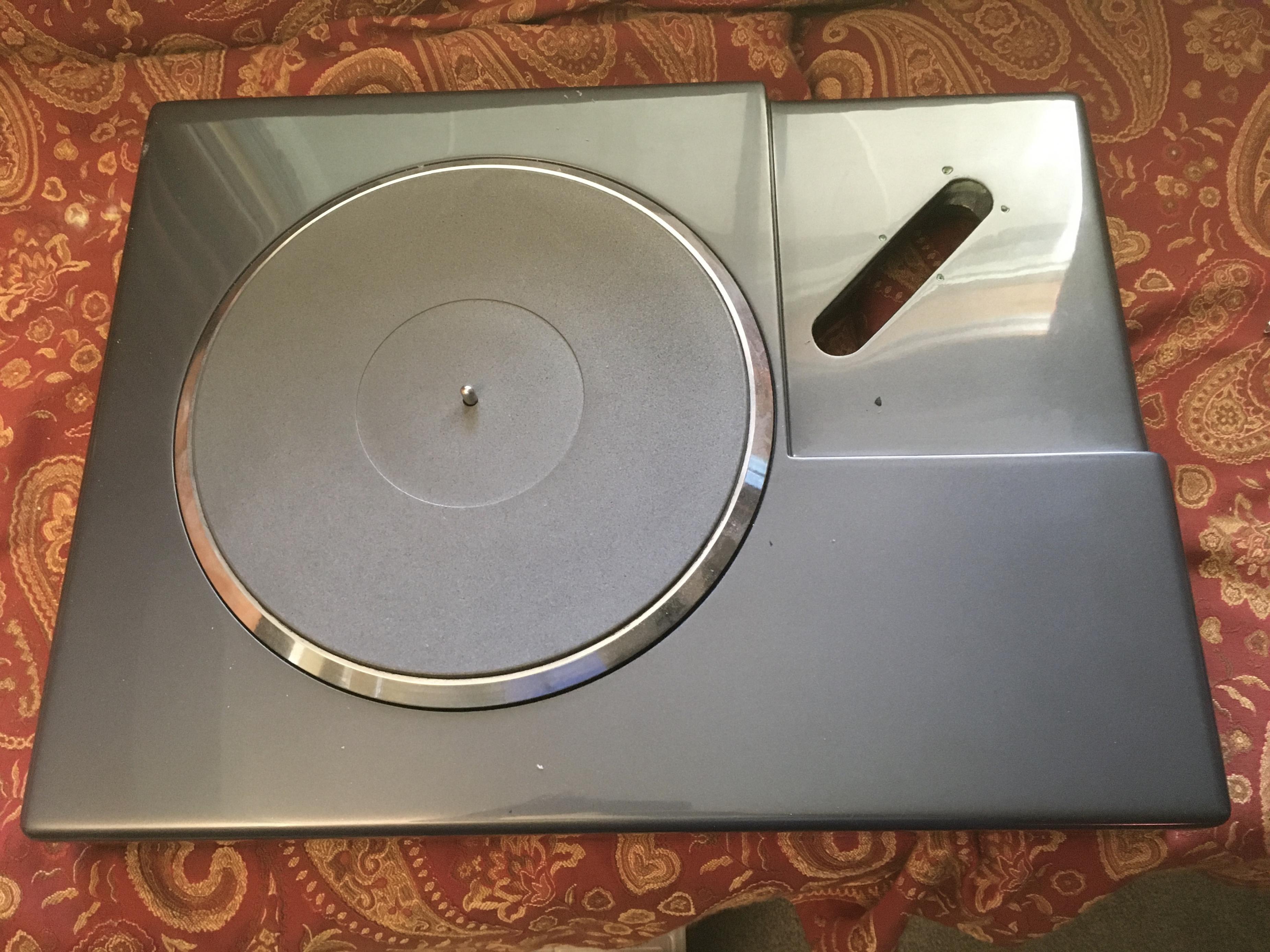

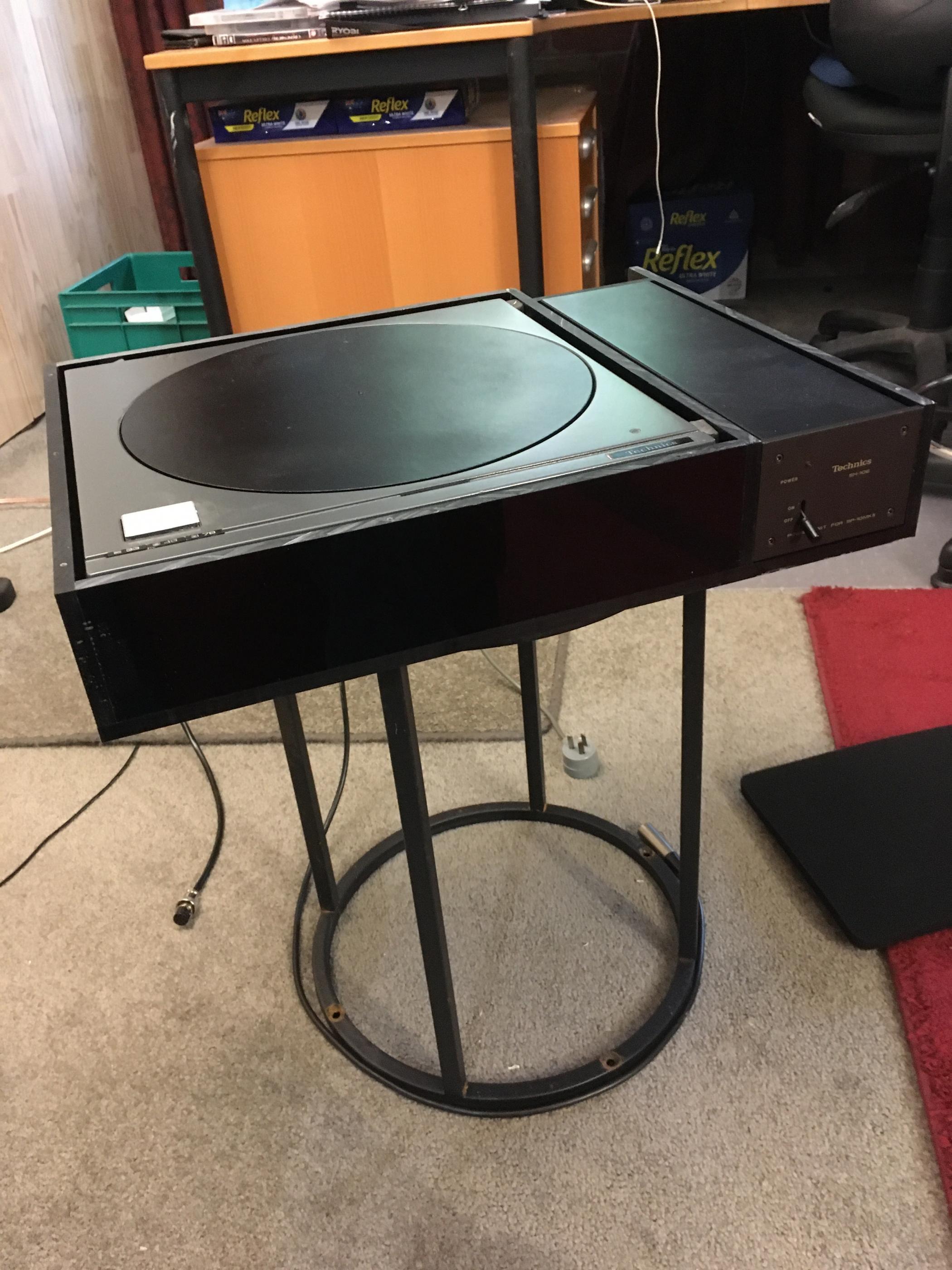

The Image is my SP10 MkII, it was discovered in a shed in a very wanting condition.
The individual who was going to work on the refurbishment,
gave me a Donor Chassis, in a slight better condition than the one I supplied.
I took the Donor Chassis to a Local Vehicle Custom Paint Shop,
and 'Voila' this is what I was returned.
Definitely not original but a nice application of the Paint Job.
I have been using this one for the past year as my go to TT.
It has been out on few visits to the homes of other Vinyl Minded Enthusiasts and has won much favour.

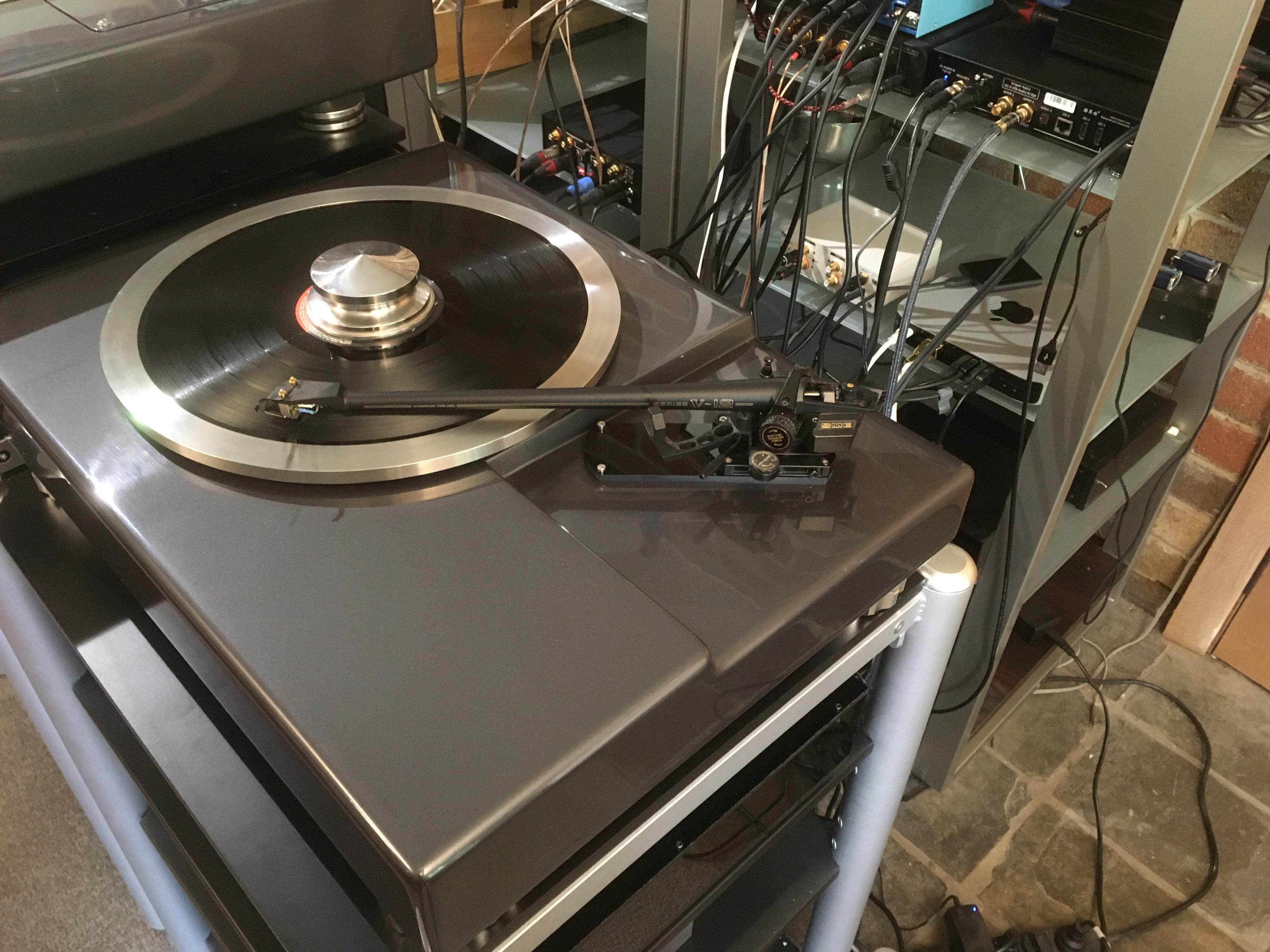

The Linear Tracking Arm and plinth was made by me. The plinth was made specifically to take this gantry style tonearm, which was inspired by the Clearaudio TT1. The rail and carriage are not TT1 they were copied from Niffy. I have a Technics EPA100 and this LTA is so superior I will never go back to a pivoting arm. There is a lot of discussion on why the LTA does so well and it is down to the very short and stiff carriage resonant frequency being up the top of the audio band so there is very little audible resonance in the carriage (arm wand).
My build starts about here, it goes over about 30 pages.

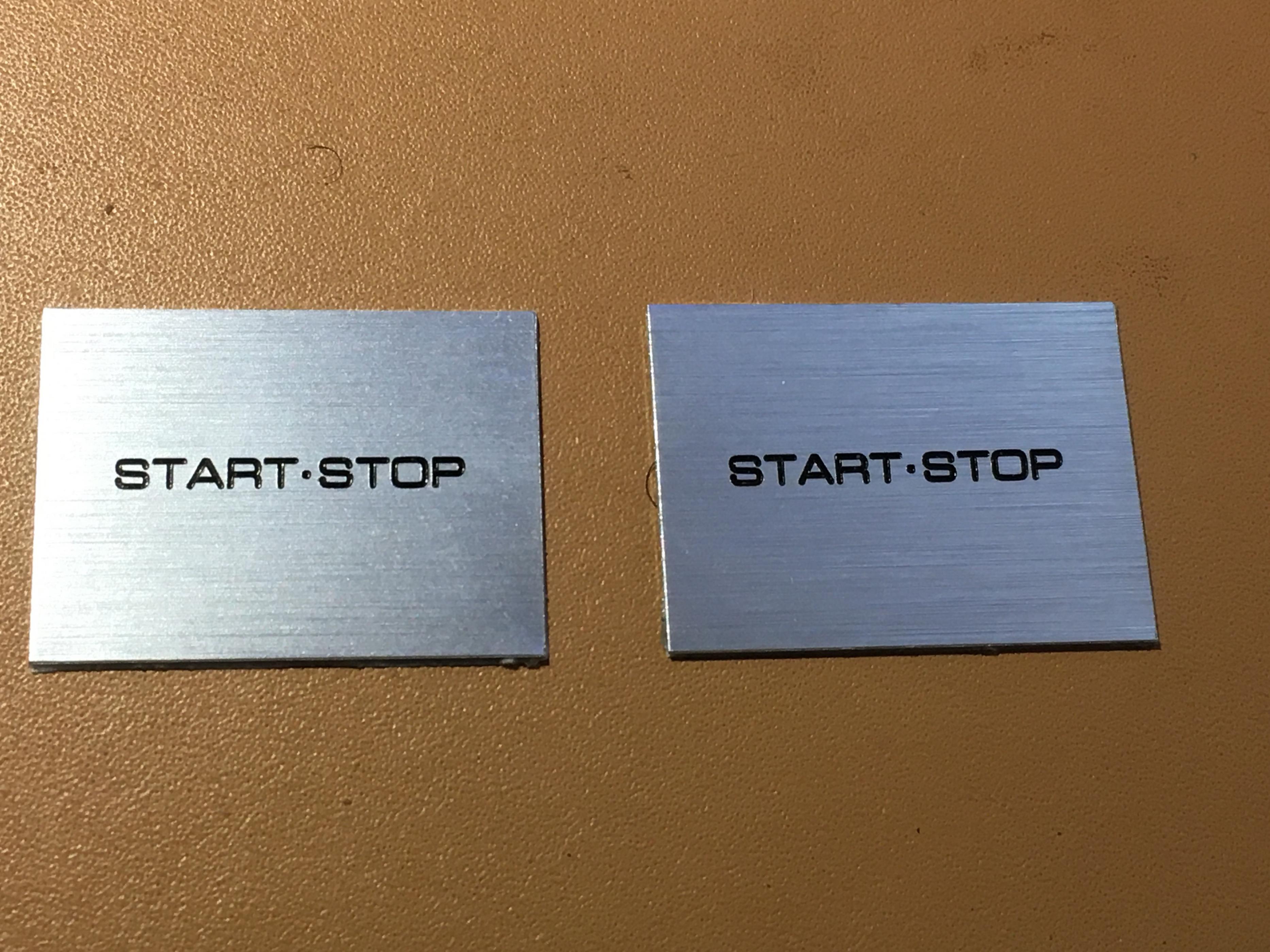

If you go to a trophy maker, they can make up something like this for cents. It is thin aluminium (approximately 0.5 mm) with a sticky peel off backing. The dimensions 38mm x 29mm make it a perfect fit over the Technics button.there are several ways to repair the aluminum start /stop cover from dents.

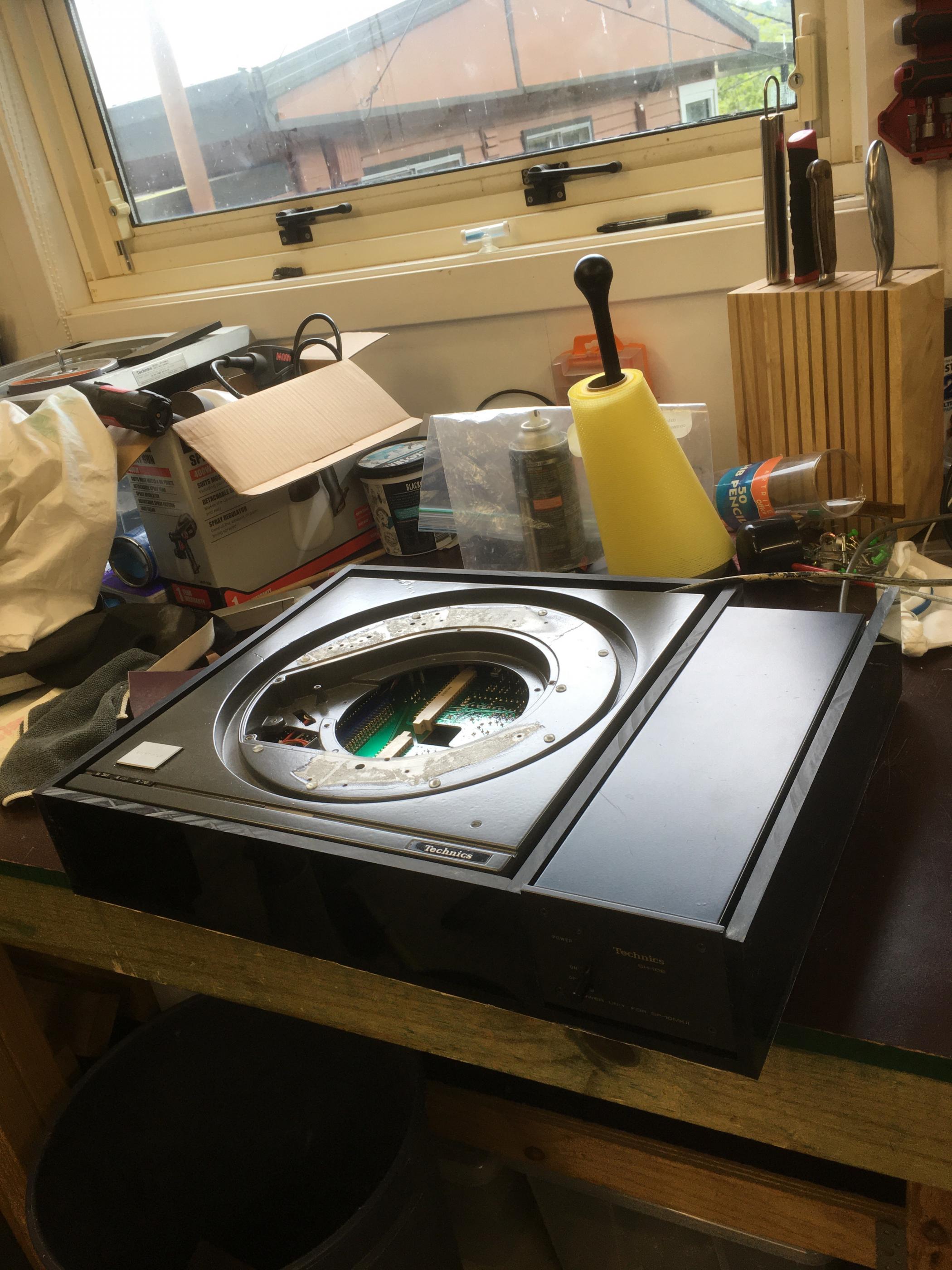

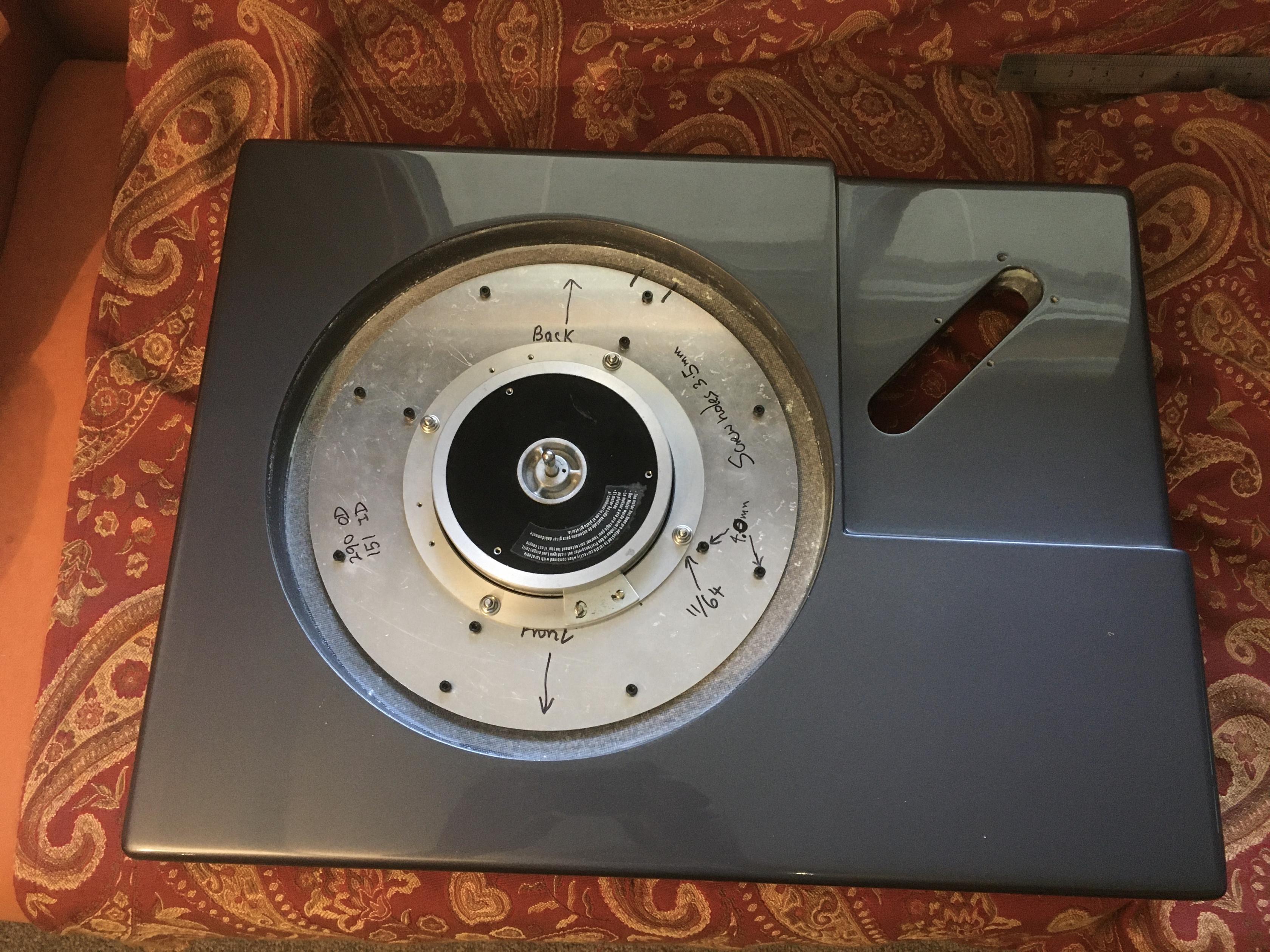

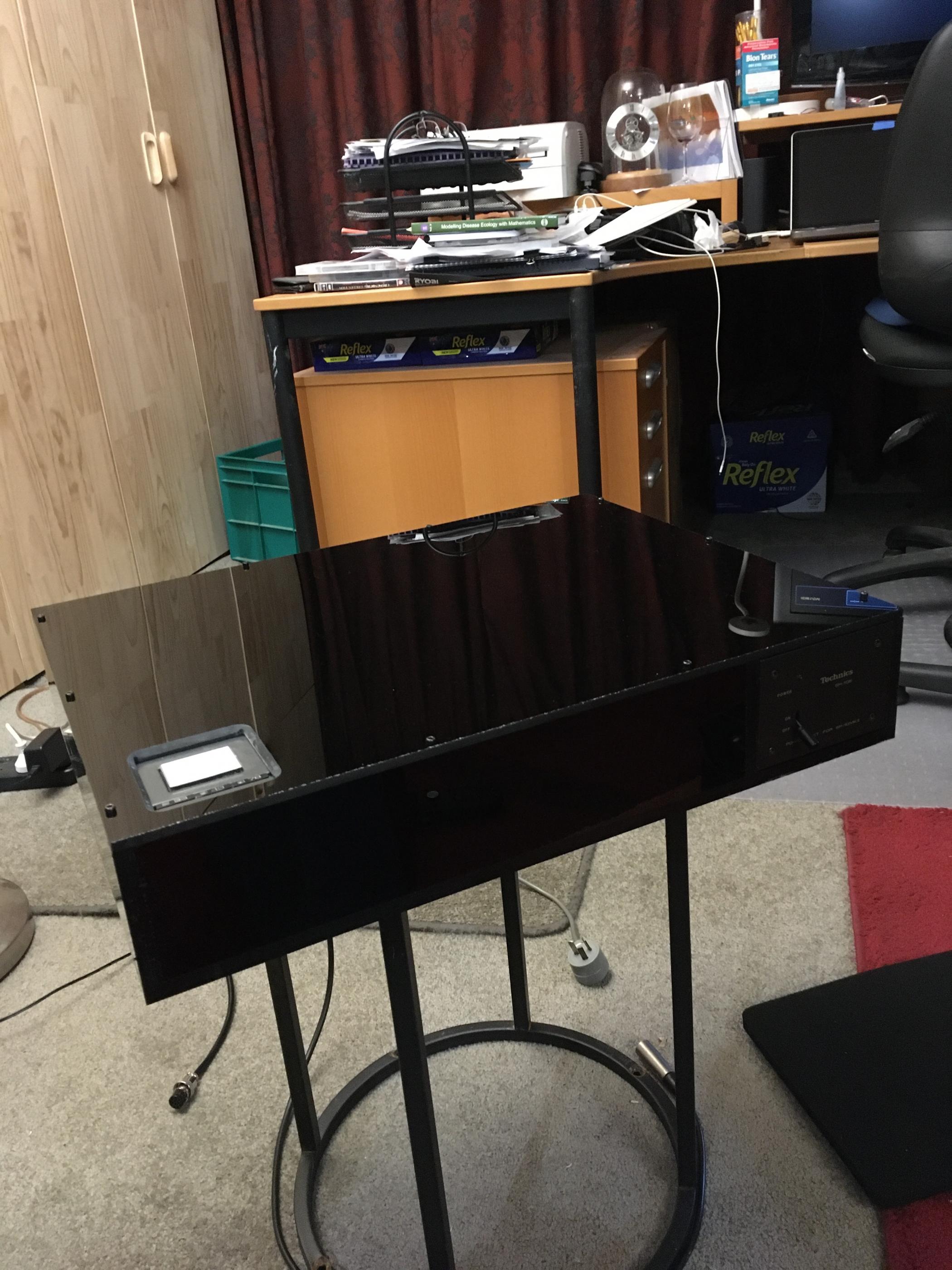

Kaneta style plinth and acrylic control box.
It's been a long term project to re-configure the SP10 mkII with the motor in a custom plinth and electronics and power supply in a separate control box. I have dismantled and serviced about 10 mkII's. This is usually prior to re-finishing the chassis. It has always bothered me how resonant the bare chassis is. It would make a perfect dinner gong. Although a good damped plinth will minimise any negative resonance effects, it is something that I wanted to do something about. I've taken the CV-19 lockdown opportunity to finish off the control box. Nothing fancy about it, just enclosing the old chassis and power supply in one (large) case. The plinth is cast resin/bentonite from a custom mold. The finish is automotive spray paint.
I realised there is very little evidence of the SP10 mkII original, so here are some more images.It's been a long term project to re-configure the SP10 mkII with the motor in a custom plinth and electronics and power supply in a separate control box.
Hi Bon, I haven't scrutinised the images at present, but am I right in assuming the original Chassis has been cut in a 'Saucepan Lid', which is the term used when that type of modification happens on a Lenco Chassis.
This is very timely as I have just sent out a Mail early this morning, describing my change of direction in a Plinth Design I am working on, and it looking more like it could be Circular or Ovoid in shape.
I was thinking the SP10 might look a little off on such a design, but this presentation of your design is giving me food for thought

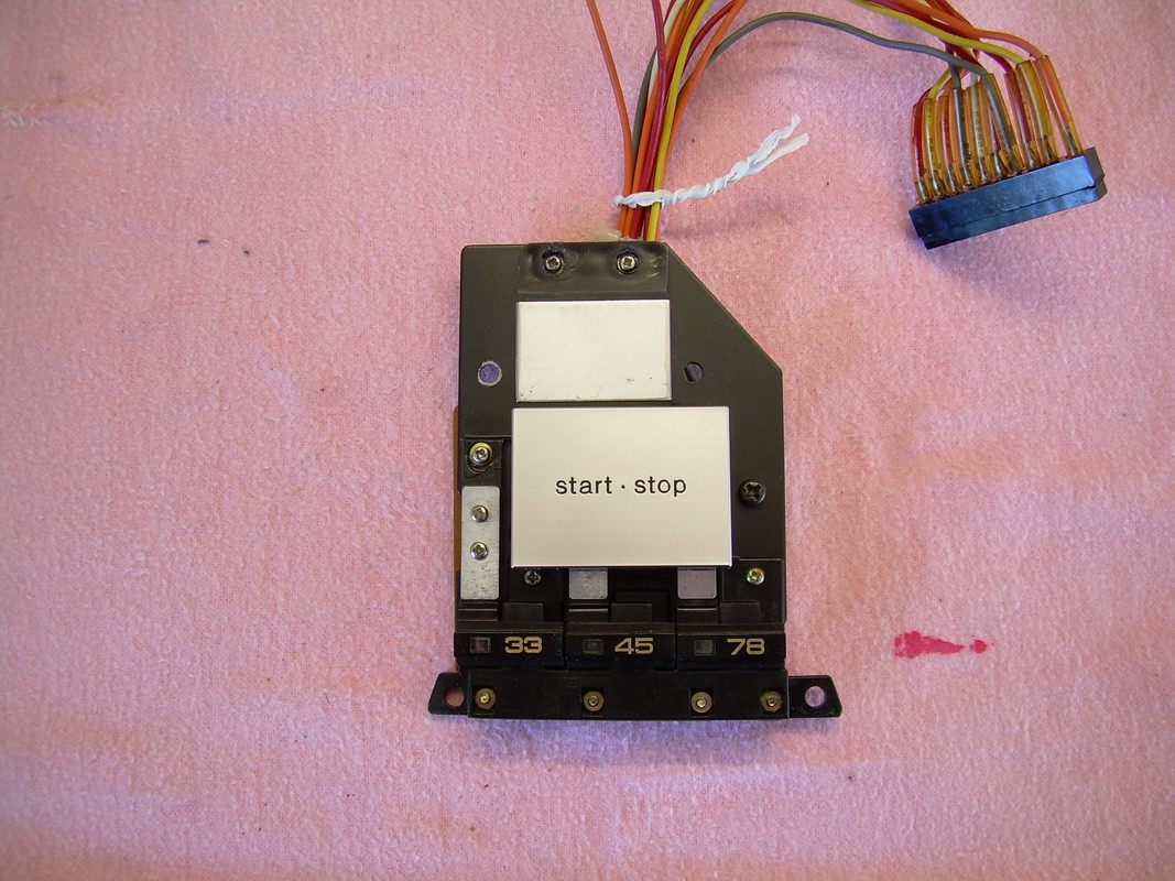

does the photo represent the buttons made by a trophy maker?
I know the aluminum button very well, if they are irreparably damaged I recover them from the remote SH-10R 😱😀

I have not heard of the 'Saucepan Lid' mod before, but I am not a Lenco follower. To clarify, my mod results in two components, the SP10 motor in a separate resin/bentonite plinth, and the motor electronics and power supply in a separate enclosure. The 'lid' in the first photo of my post, is a circular plate covering the hole left in the chassis by the motor and brake removal. I don't know what could be removed from a Lenco, because the motor, drive mechanism are integral to the chassis, in my understanding. Here are some more images of the control box arrangement, which may clarify the design.am I right in assuming the original Chassis has been cut in a 'Saucepan Lid', which is the term used when that type of modification happens on a Lenco Chassis.
The photo is of the actual stick-on thin plate that covers the damaged button. It will increase the height by about 0.5 mm. The printing I think is laser cut and is sharper and cleaner than an original Technics button, especially after 40 years and thousands of operations. It depends on the fabricator selection the correct font and size, which should be simple if provided with an original button to copy.does the photo represent the buttons made by a trophy maker?

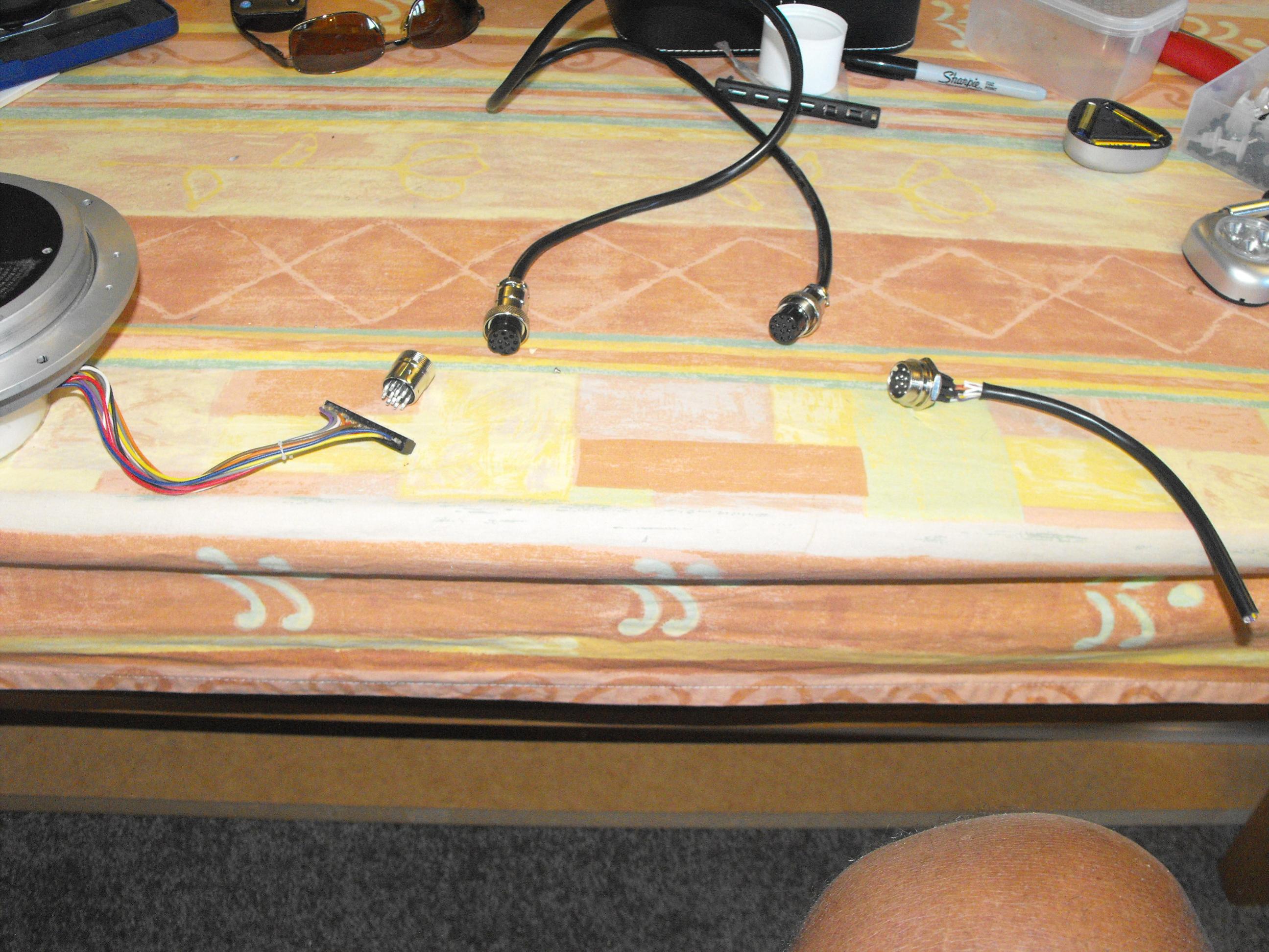

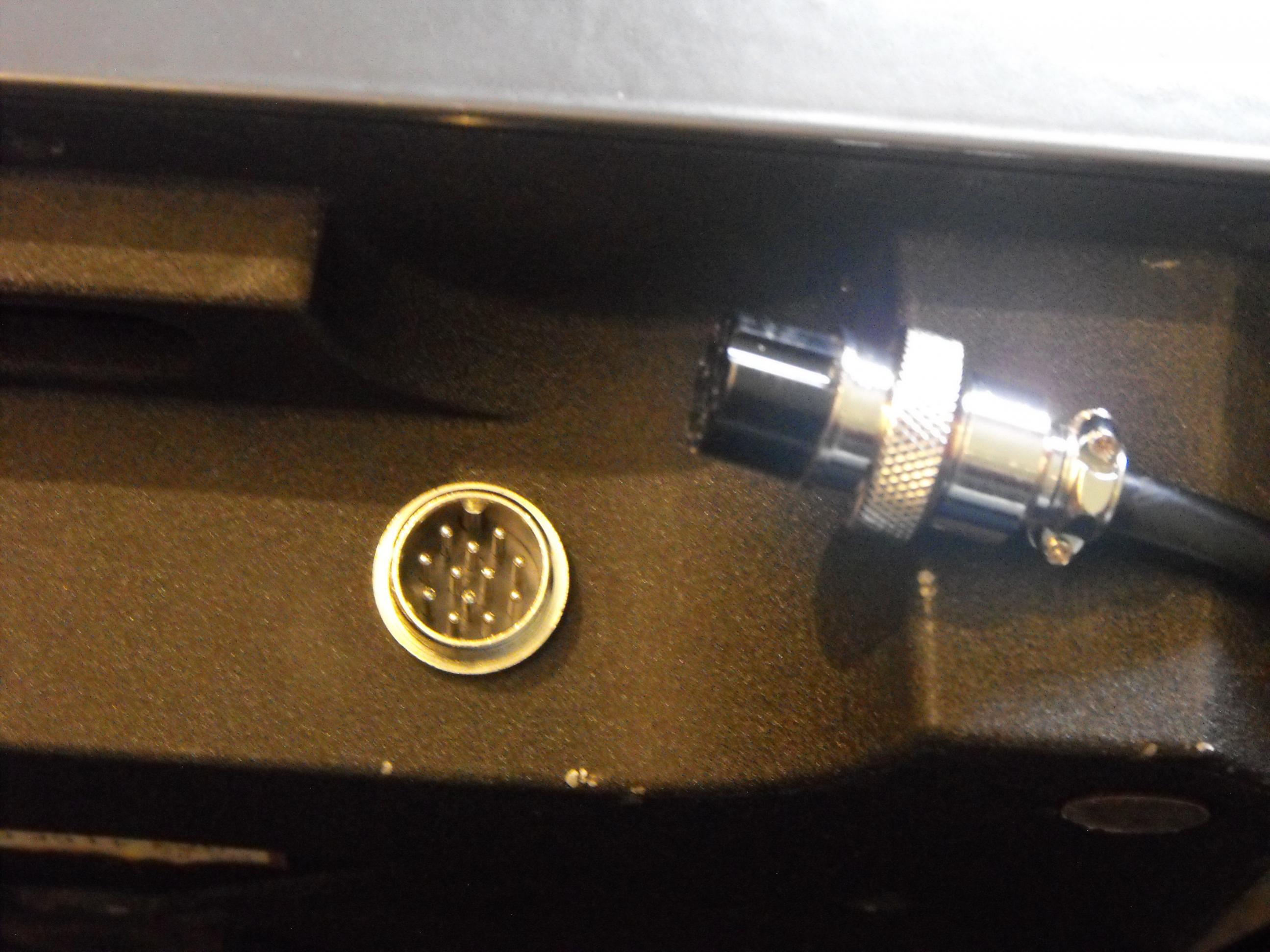

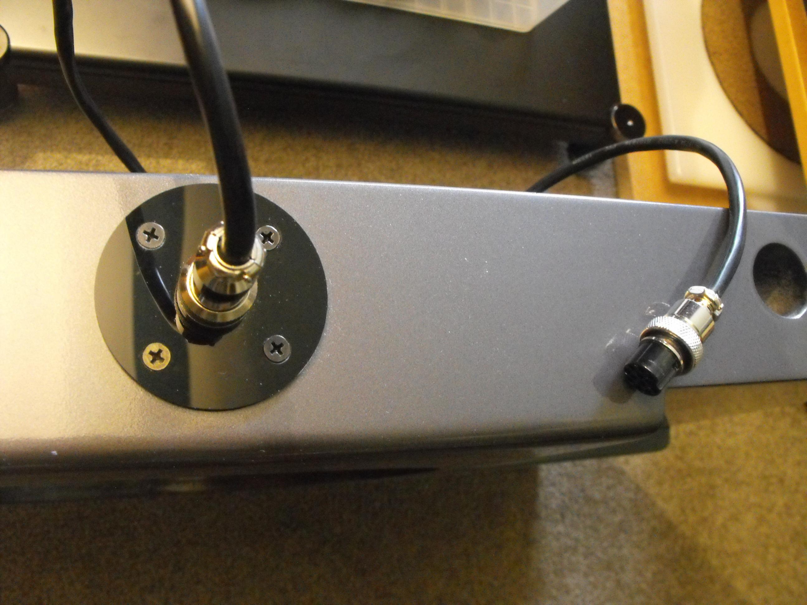

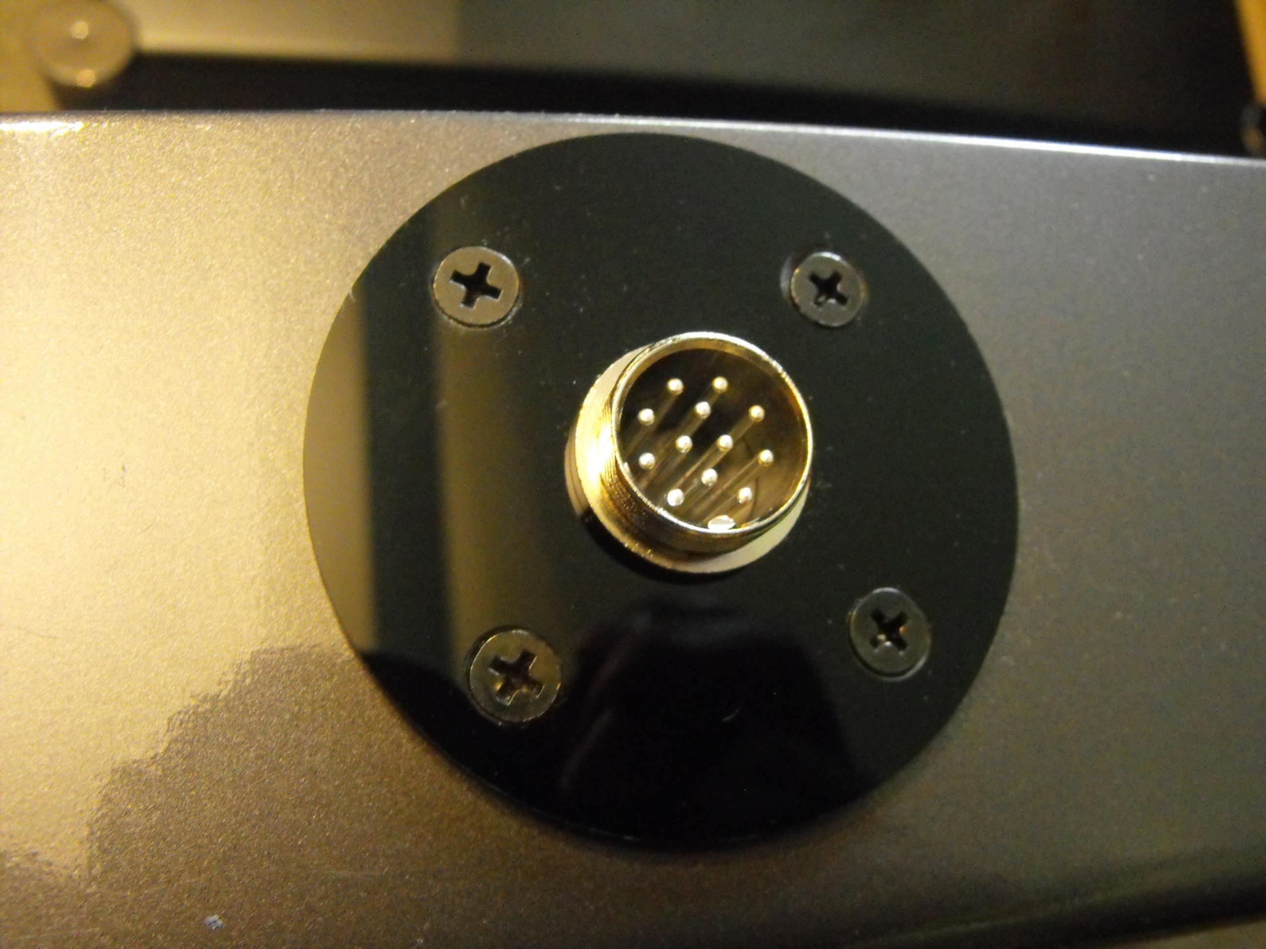

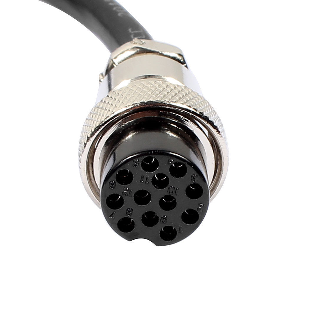

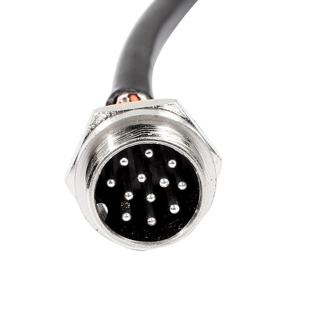

12 pin aircraft connector. Connects the 12 wire motor loom to the controller box.Looks good Bon, what cable are you running between the TT motor and electronics?
The 12 terminal motor cable tag strip is relocated to the end of the cable on the right, which is inside the control box chassis electronics. The first 12-pin male terminal replaces the tag strip on extensions to the plinth rear.12 pin aircraft connector. Connects the 12 wire motor loom to the controller box.
Hi Bon
Now I have seen the innards of the Plinth, I can see how the design has come together, still a very nice workmanship to be seen

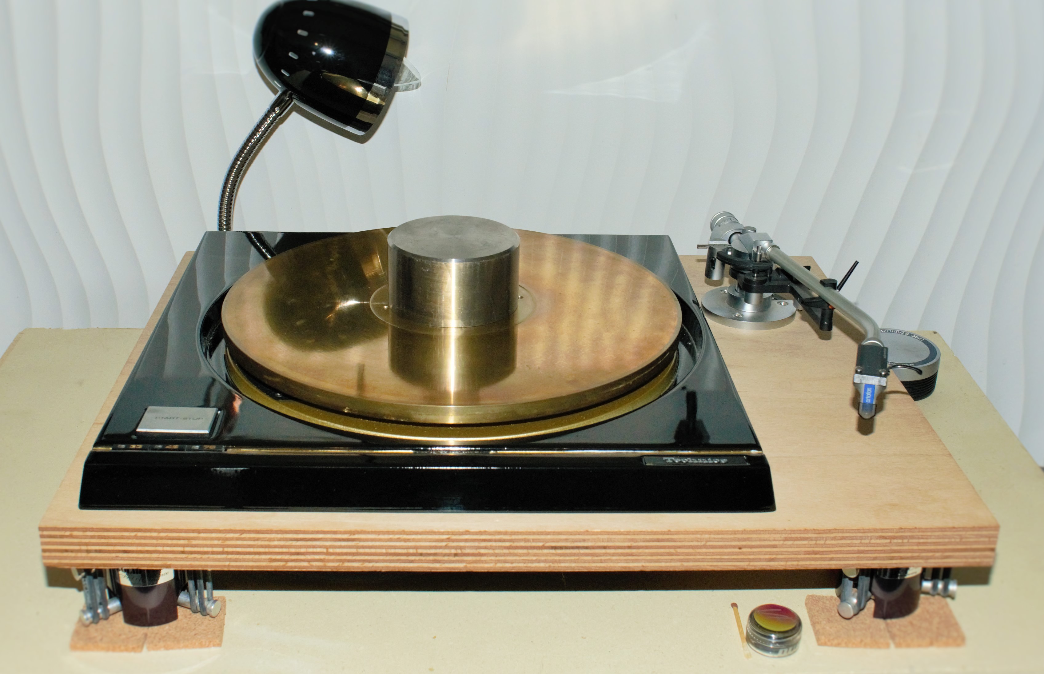

A enquiry was made about the Platter on my SP10, at present it is concept idea, the design of the Phosor Bronze Platter is to be investigated to see if it can be used on more than one Brand of TT.
