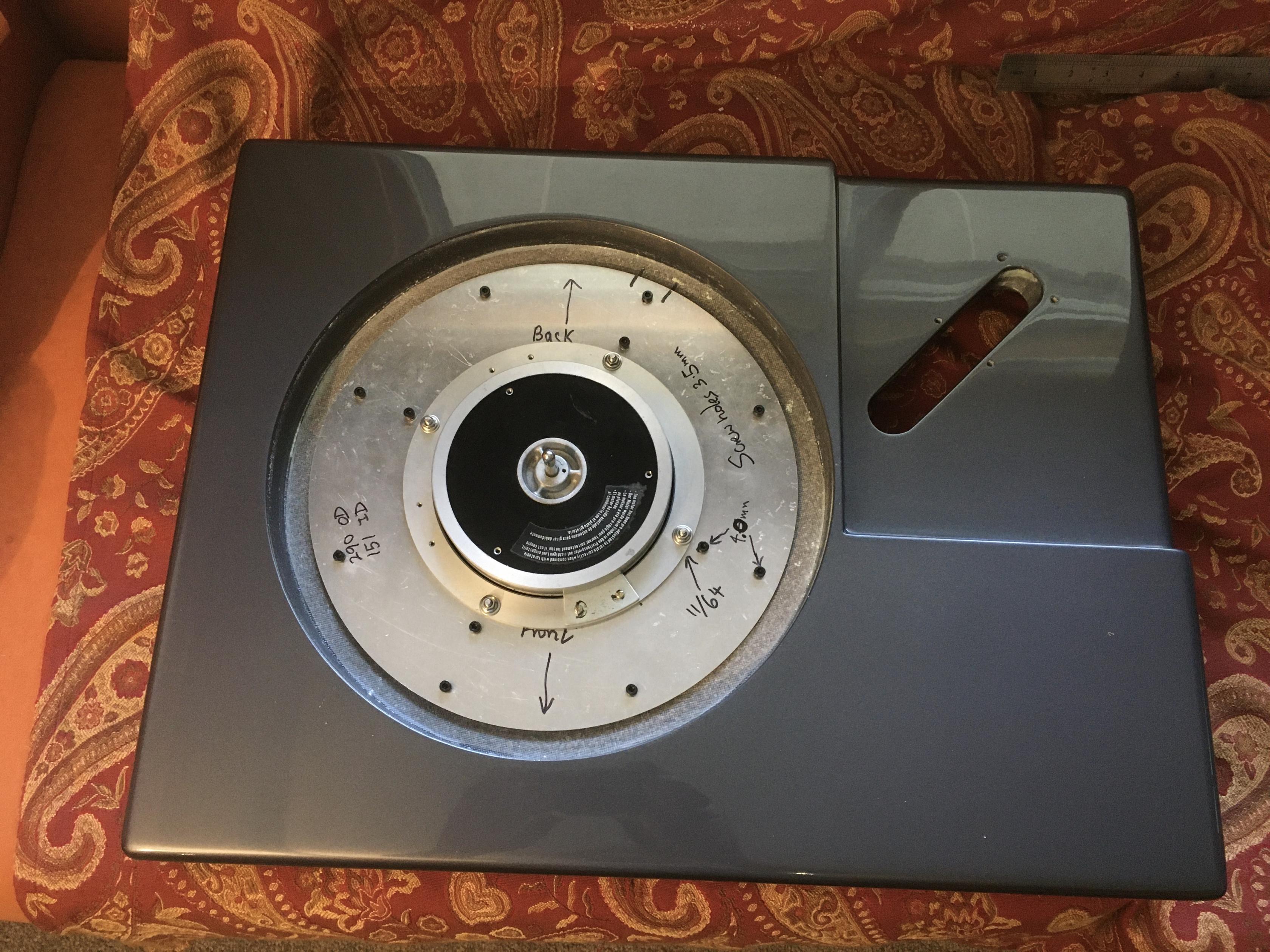

Kaneta style resin/bentonite plinth report
This is a project that I have worked on intermittently for the past 3 years. My previous posts in this thread ##1314, 1488, 1493, 1497, have mentioned various elements of the construction. The final part of re-housing the electronics and power supply in a custom case, has recently been completed.
I have used the SP10 mkII as my main turntable since 1998 and I have had about 10 pass through my hands. The main work I usually performed is the band-brake removal and thrust bearing replacement for worn samples. Then re-plinthing in a cast resin/bentonite plinth.
The naked chassis rings and this bothered me. The Kaneta mod of housing the motor in a high performing plinth and relocating all the other components, seemed like a great idea. It has been brought up in this forum before but did not go anywhere. There is a commercial version by Artisan Fidelity.
SP10 mod plinth a la Kaneta- ideas?
Technics Sp10Mk2 NG — Artisan Fidelity

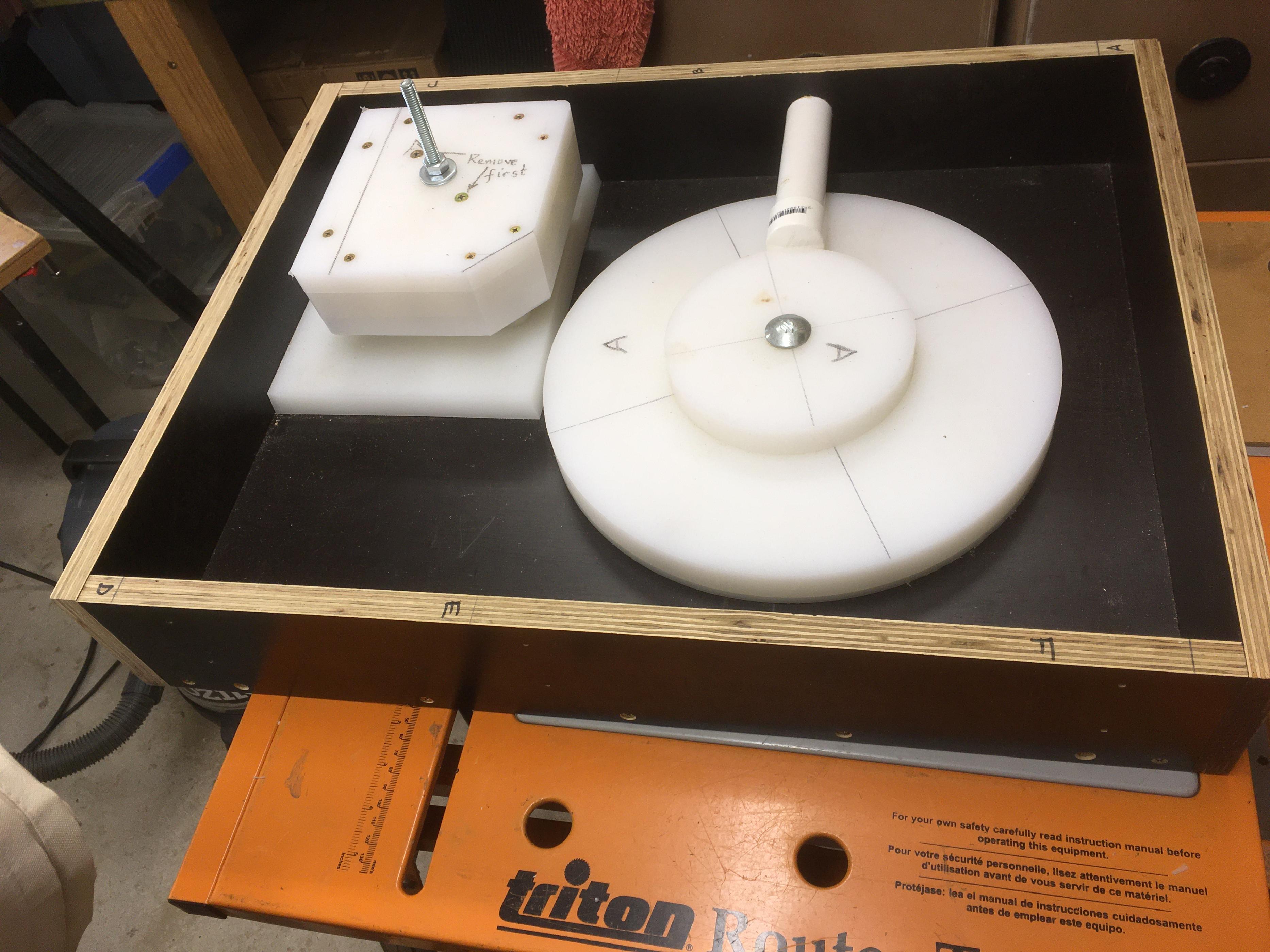

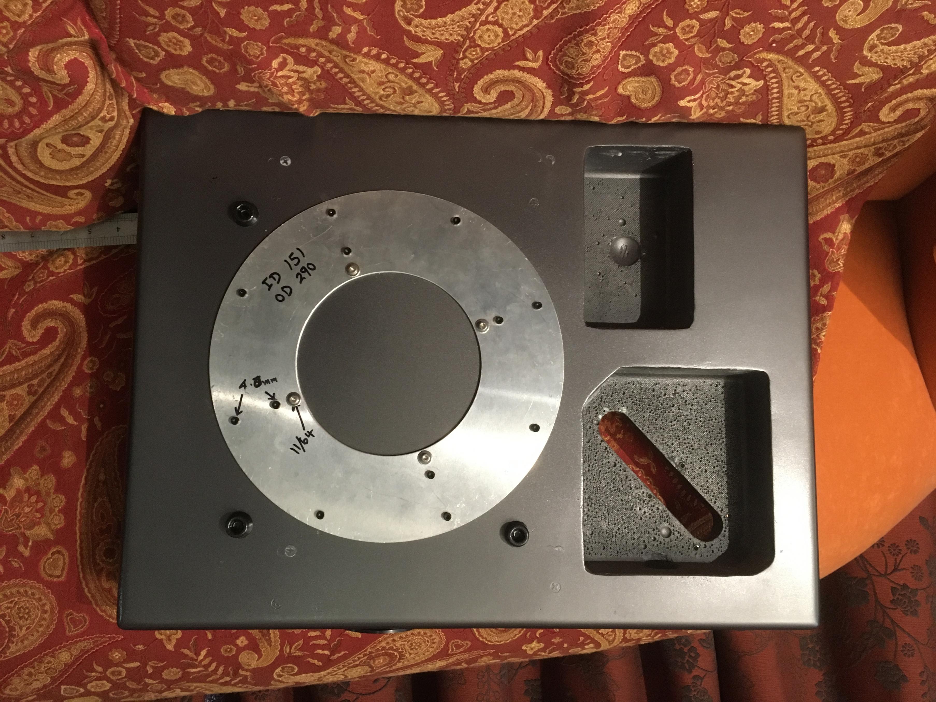

The plinth mold is quite complex, with all the voids and through apertures cast-in-place. This is highly desirable because the cast resin/bentonite composite is not friendly to machine. It dulls cutting tools, produces bad fumes and does not produce a very clean machined surface. The mold construction and inserts are required to be non-stick for easier removal. The dimensions have to be spot-on for the motor/platter void. The bare plinth mass is 28 kg.
The motor is clamped with long stainless bolts through the entire plinth thickness with aluminium plates top and bottom. These plates are tightly fixed to the plinth with multiple fasteners. The massive damped plinth is rigidly attached to the motor in a sandwich arrangement. The plinth is prepped and painted by an auto spray painter professional. This was the most costly part of the project. Materials are inexpensive but you need patience. I glued up an mdf test version in a day. It was used to work out the dimensions of the mold inserts. The cast version takes a week to cure in the mold and weeks of fit and finishing. Definitely not a week-end project.
I will report on my findings of the audio performance in my next post.

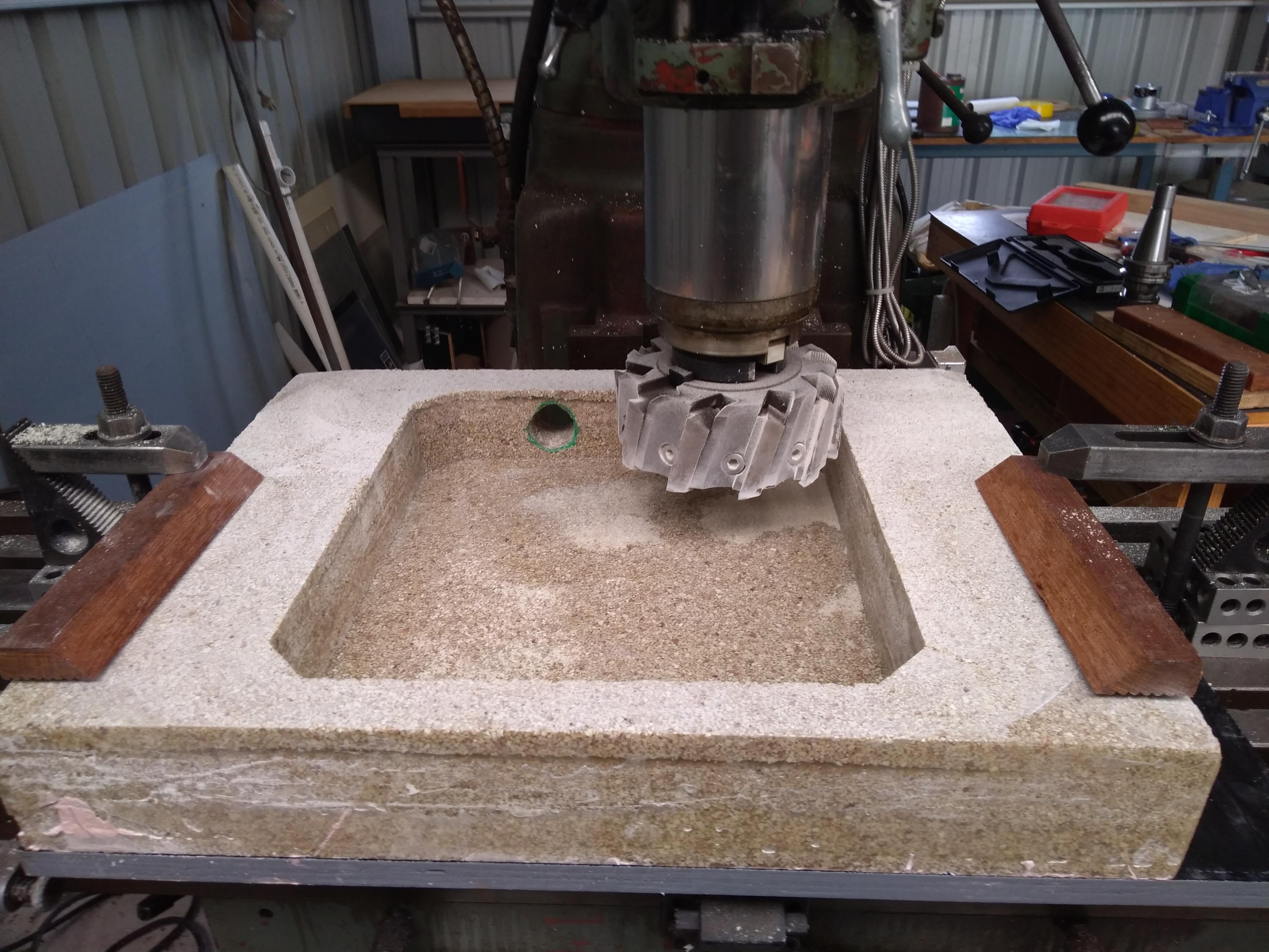

Great project Bon,
I'll be interested in your opinion on the improvement over a cased SP10. I will most likely go down this path for my next SP10 upgrade. The linear arm was a huge improvement over the pivot.
Did you use poly cutting boards for the inserts?
Machining this stuff sucks. I had to do it as mine warped. I used the resin I had (20kg drum of laminating resin) and even though I laid up in 10mm thick pours the plinth still warped. So I machined it flat. That's a 150mm diameter face cutter with HSS inserts and I had to sharpen it 3 times.

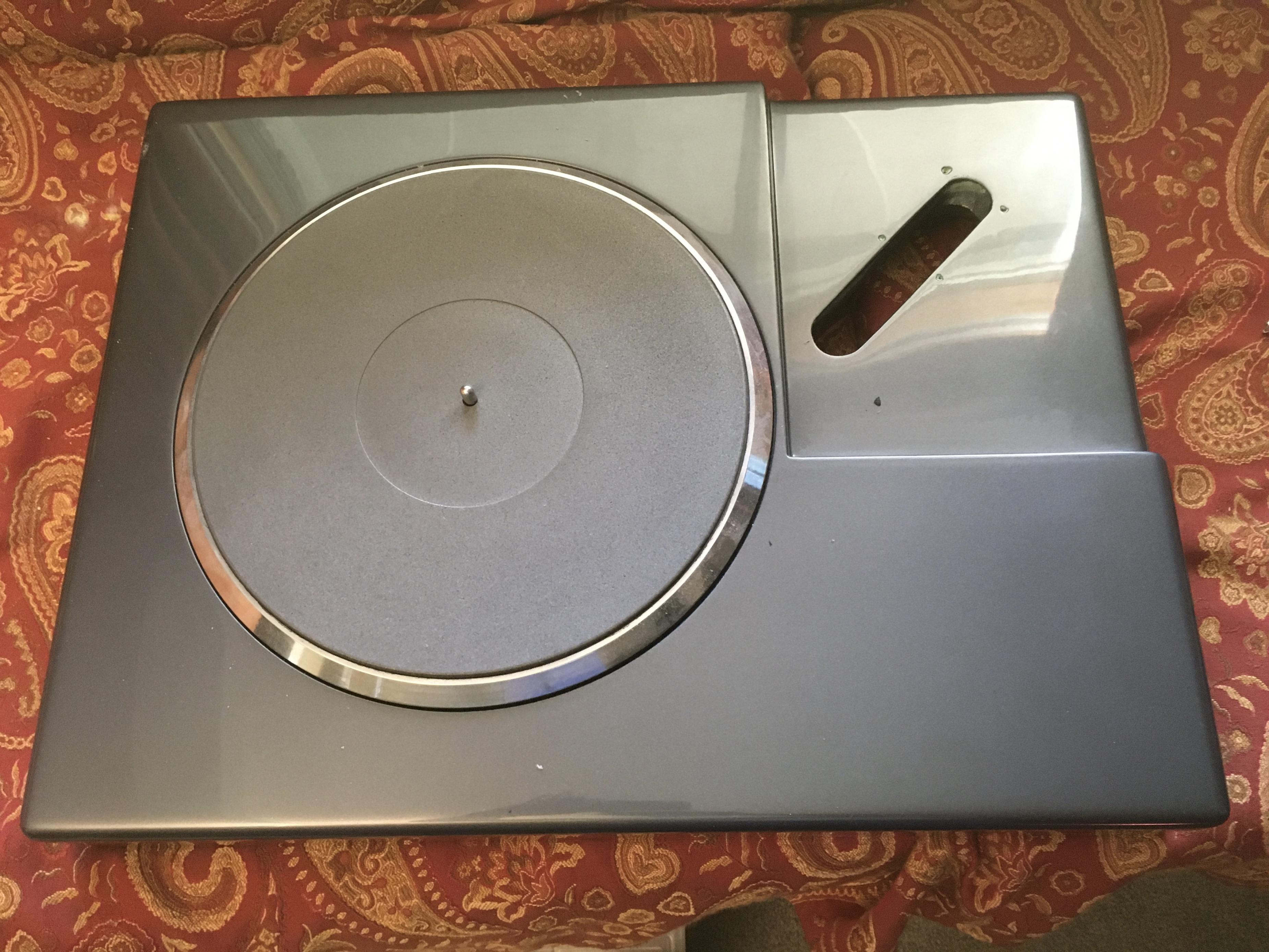

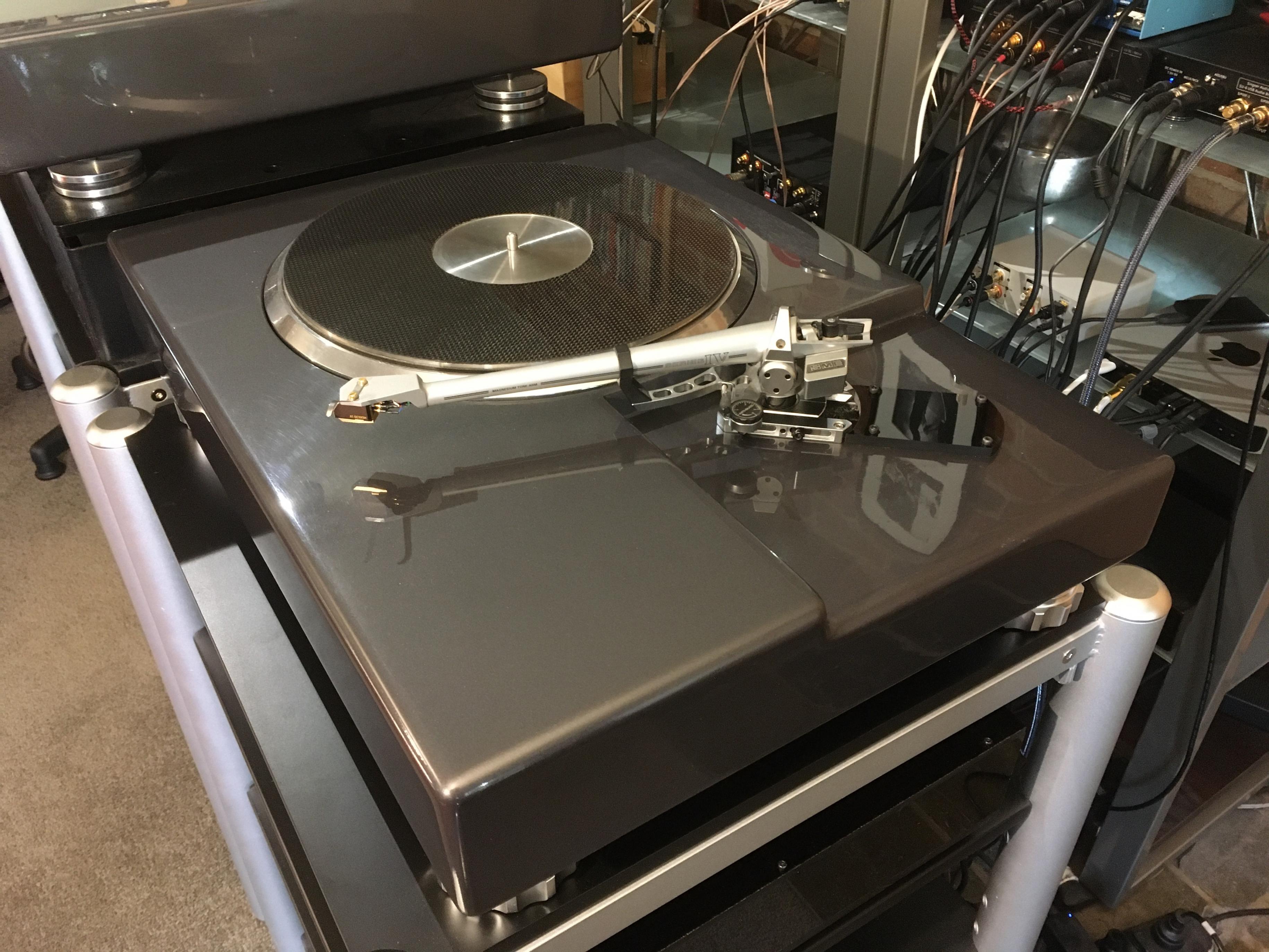

I understand that DIY is more concerned with the technical and constructional issues than subjective reviews, but here are my mains impressions of the pros and cons of the results of the mods. Comparisons are with a mkII (minus band-brake) in a resin/bentonite plinth.
PRO:
1. Presentation is smoother than the stock SP10 mkII.
2. Weightier bass
3. Less noticeable impulse noise (clicks, pops, run in/out grooves)
CON:
1. Switches are less accessible in the separate control box.
2. No brake or strobe
3. Control box is bulky, takes up the same volume as the plinth/motor/platter
4. Platter to plinth clearance is low, limited height for peripheral ring.
I realise that all the PROS are subjective and CONS are operational issues. I can't detect any subjective CONS, the performance exceeds my stock mkII in a resin/bentonite plinth. The smoothness does not seem to be at the price of treble loss. I paid a lot of attention to jazz cymbal reproduction. It was all present and correct.
The tonearm used for the comparisons is the SME IV, cartridges, Ortofon Cadenza Bronze and Audio Technica ART9 and OC9 XSH.
It is well reported that SME V series tonearms are optimised for rigidity and poor plinths and especially floating sub-chassis turntables, can have issues with the energy the tonearm presents to them. I am confident that the mass/stiffness/damping of the Kaneta plinth is dealing effectively with these.
I found that the Kaneta plinth/motor/platter was more sensitive to platter mats than I expected. I settled on a Boston Audio graphite mat (the older type, not the thinner newer version).

Yep. Polyethylene from a wholesale kitchen supplies. It turned out 2 layers of 25 mm was just about perfect for the correct motor/platter height.Did you use poly cutting boards for the inserts?

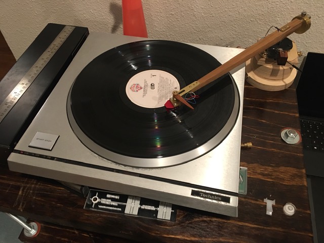

It's spinning... in the right direction
The SP-10 gods have finally smiled on me. After two years, I got this thing to finally work! Oh, the hours I have spent working on it, cursing it, to spin in the right direction. It was with a repair tech for a few months and even he couldn't figure it out. Anyway, here is my story, hopefully it can help another unfortunate soul.
I had already done the following things to it:
- New regulated power supply, though I'm still using the original transformer and top board in the PS. The bottom board has been replaced by an LM317 regulator board.
- All new boards in the table itself. This is after I shorted the 32V and 5V lines on one of those long troubleshooting sessions.
None of that seemed to work to get the thing spinning in the right direction. After it came back from the repair tech, it sat for a while as we moved to a new home. I just started looking at it a week ago. Some of my troubles have been documented in the earlier pages of this thread.
The top part of the motor, which comes off, has the magnet being held by a relatively malleable plate. It looks like it is glued to the sub-platter. The previous owner probably used platter screws that were too long causing them to push down on the plate, which then started sticking out at one place around the rim. This had happened earlier and it made the top plate brush against the coils in the stationary motor. Well, after a little bit of pushing and bending with hand, it was now sitting relatively flat against the underside of the sub-platter. Now it was at least spinning smoothly. So, I thought let me give it a try again and viola, it began spinning in the right direction. Checked the waveforms on the scope and they were all locked in with the correct deltaTs. I added the LED-based strobe while I was at it.
I had pushed the plate back last time around because it was brushing, but I didn't undo the whole underside of the sub-platter. This time I did and I could do a better job of bending the plate flat.
