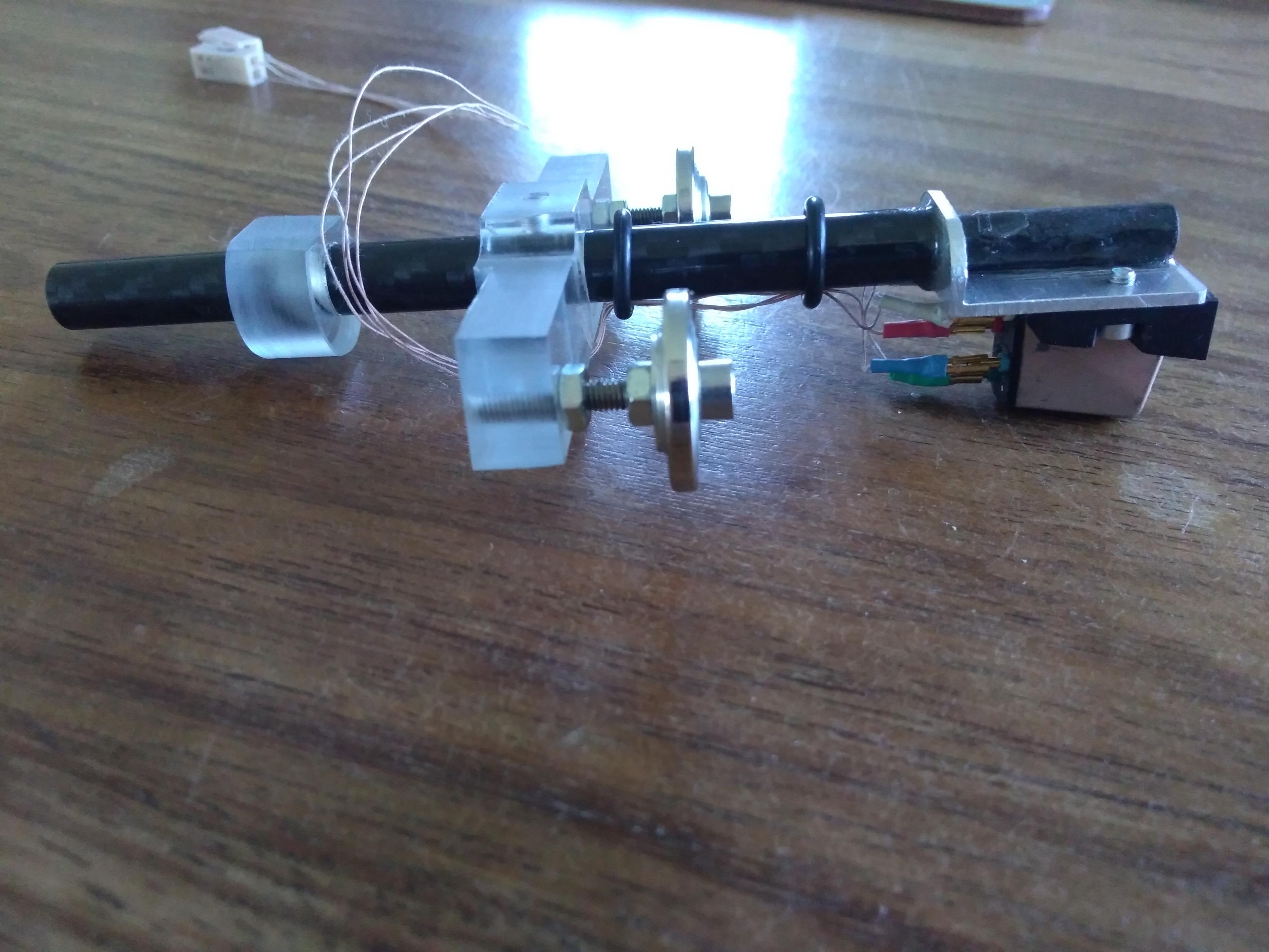

I have rolls of fiberglass mat and a 20kg drum of resin left over from my car project so still using this up. I'm designing a new servo driven unipivot linear tracker and will build a new plinth for this.
I opened out the hole on that LP as a torture test. It's one of my old kiddie LP's from when I was 5 and only stories so didn't listen to it.

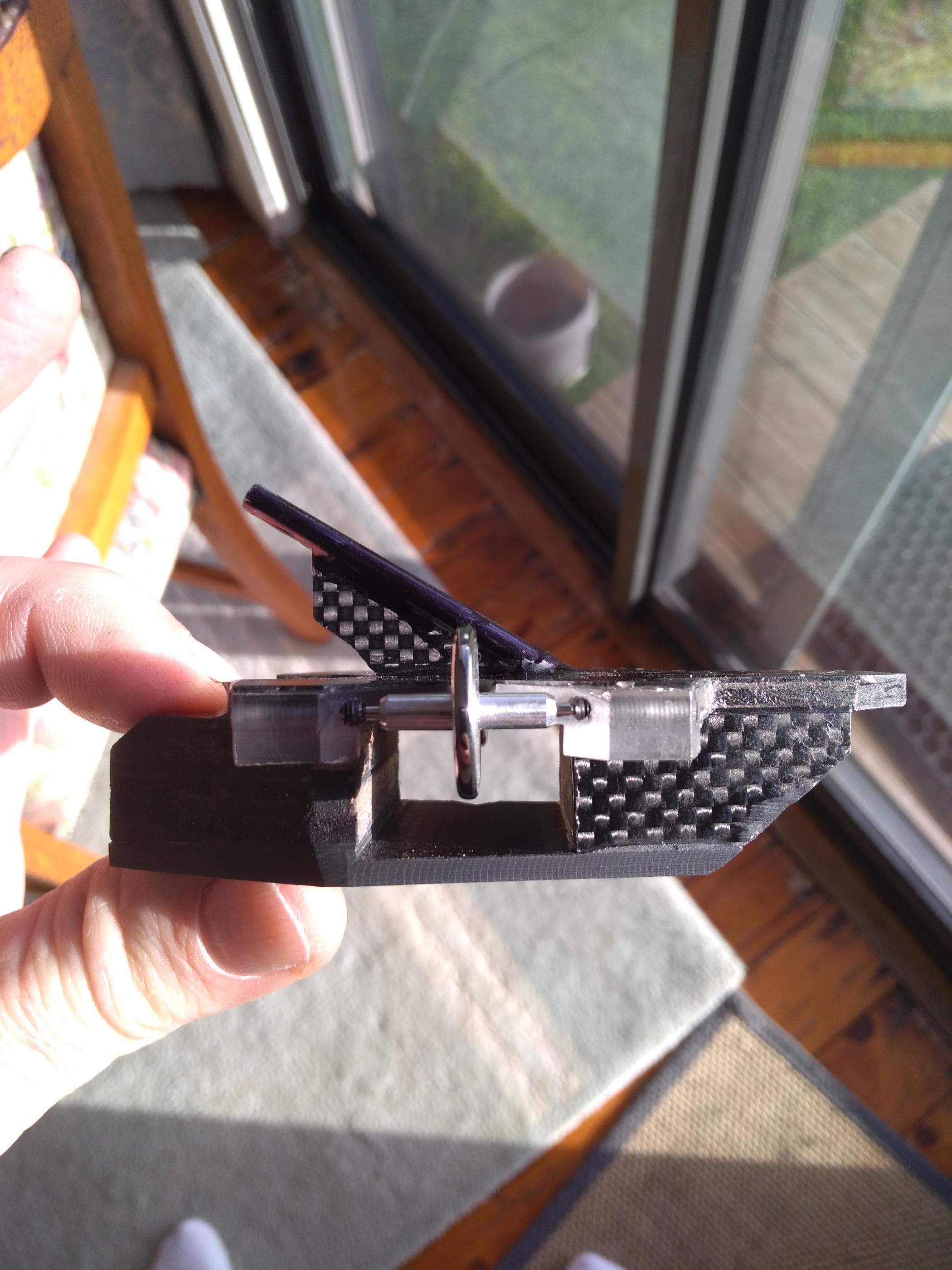

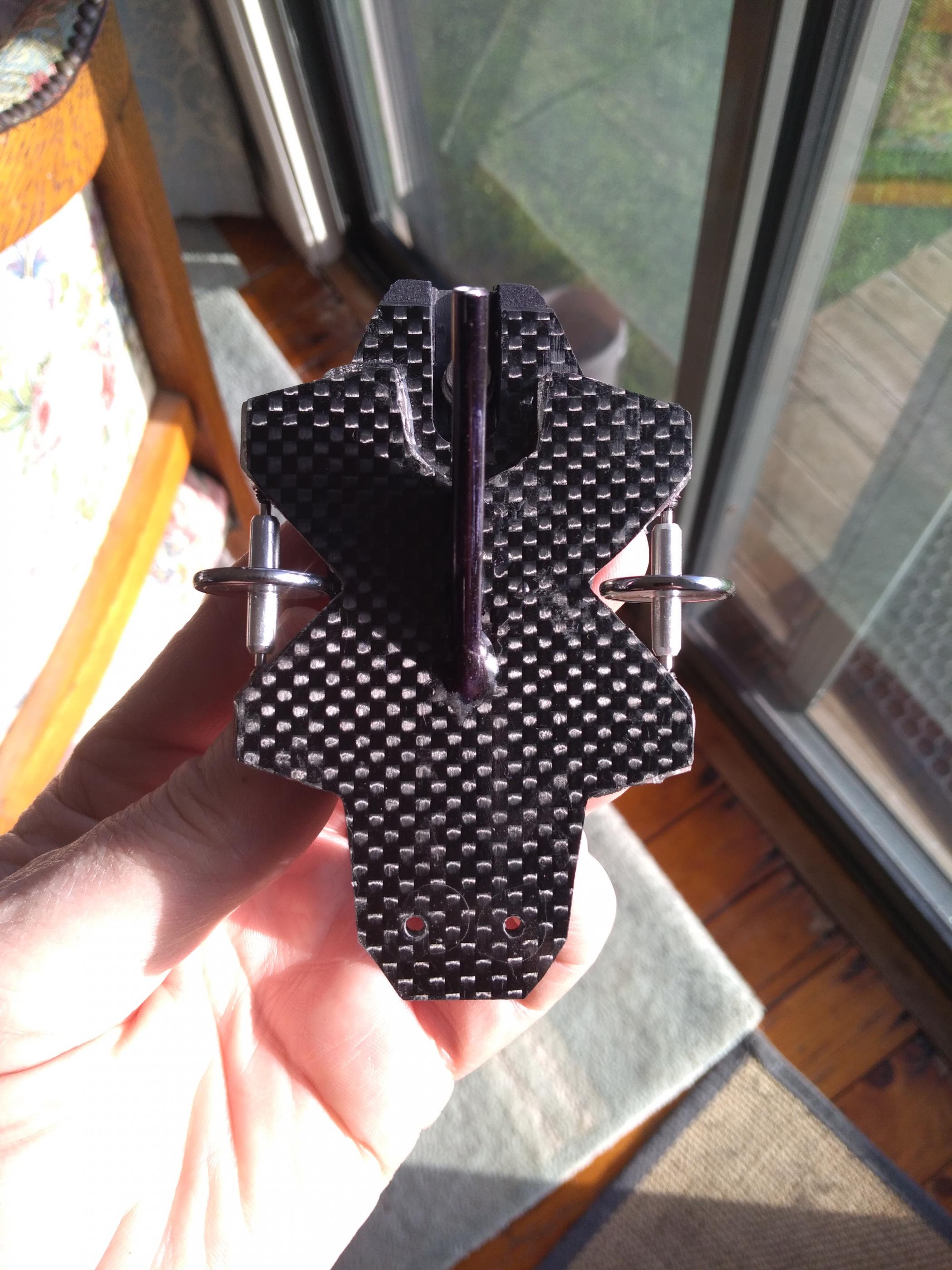

As the carriage is only 100mm long ans pivot to stylus is 58mm I use a reflex clamp to hold LP's down. It does a good job of all but the worst and I don't have any of those.
VTF does vary with stylus height. As the pivot is so low COM is above the pivot point so VTF decreases as the stylus lifts. I plan to add a spacer under the cartridge tomorrow in an attempt to lower COM.
It's not perfect and given the right amount of eccentricity, warp, modulation it will spit the stylus out of the groove at worst and distortion at best. This only happens occasionally and is repeatable with the same song.
Even with this issue the performance is stunning, on Pink Floyd The Wall it out performs my digital in bass response, which is something I wasn't prepared for. The noise floor is also lower than my pivoting arm, significantly reduced clicks and pops on old second hand LP's.

I don't have the 881s installed as I could not get the Linear to track effectively with the Stanton, too much horizontal mass for the ultra high compliance. I have a Technics EPC205 with a Jico SAS stylus.
I have run both horizontal and vertical resonance test tracks with the EPC and the arm does not show up any resonance in the frequencies on the HFN. I copied the carriage from another member and his calculations on the resonant frequency of this carriage were in the vicinity of 20kHz.
I have had 3 different carriages on this rail. The one pictured I ran for a few weeks while I rebuilt the Frog (as my wife calls it). The noise floor on the temporary carriage was higher more clicks and pops, but still lower than my EPA100. On a good LP (one I've had since new 1980's) there is almost no noise the Frog is eerily quiet.

My comment about the resonant frequency concerns the tonearm+ cartridge effective mass combined with the cartridge compliance which usually gives a low frequency resonance (below 20 Hz). Does the 20 kHz figure you mention refer to a carriage structural resonance? If so, it seems very high. These are typically in the hundreds of Hz.I copied the carriage from another member and his calculations on the resonant frequency of this carriage were in the vicinity of 20kHz.
Yes 20kHz is structural resonance and it high because of the design of the carriage.
I did run the arm cart resonant frequency test and had no resonance either vertical or horizontal, so the arm/cart resonance is not in the bands on the HFN test LP.
I rebuilt the carriage yesterday moving the COM as close to the vertical pivot as possible and changing mass distribution.
I ran the vertical and horizontal resonance on HFN test LP. Results 16Hz and 18Hz respectively.

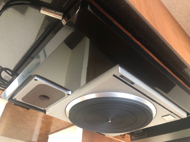

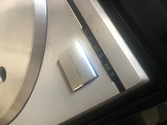

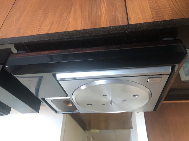

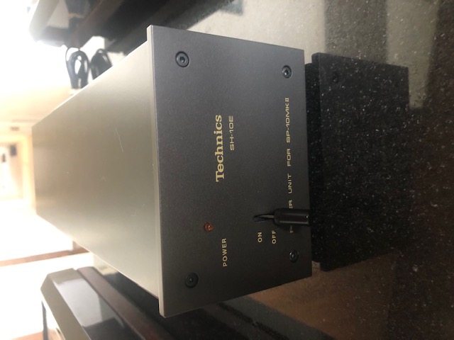

It started with conversations on the Salas FSP thread and came to fruition with the incredible help of pfarrell. I now own two really nice SP-10mk2's. One is a low time excellent condition, perfect working order with EPA 100 tone arm and the second is a zero time flawless and inop TT with no tone arm. Both on Panasonic Obsidian plinths.
My plan is to get the inop unit working. Then I will recap and time the unit.
When successful with that I will tackle a recap and timing of the second unit.
In between, I will tackle the tone arm setup.
Who knows what I'll do with two but I am sure I can get some guidance with that.
I am pretty new to diy audio and certainly to these tables so I will be needing help and there will be lots of questions.
Hopefully getting some pics up will start. Thanking everybody in advance.

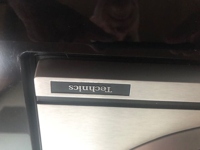

I can't figure out the image thing. They show up every which way but I think they go right side up when enlarged. Let me know if you're having problems. Thanks.
Don
Don
Maybe the pictures flip because of the flipping awesome condition SP-10s you got there 😀

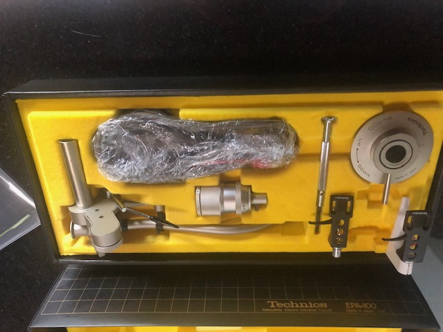

EPA-100 is still a gem of an arm to this day with super low friction bearings by the way...
I have never owned 2 TT's but now have 2 x SP10's, 1 with an EPA100 and the other with a DIY linear arm. Both have EPC205's
The EPA100 is easy to setup just set the spindle to pivot accurately, there are loads of commercial protractors for this. Not sure if the Technics arm board is drilled precisely for fit, if it is then you may not even need the protractor.
