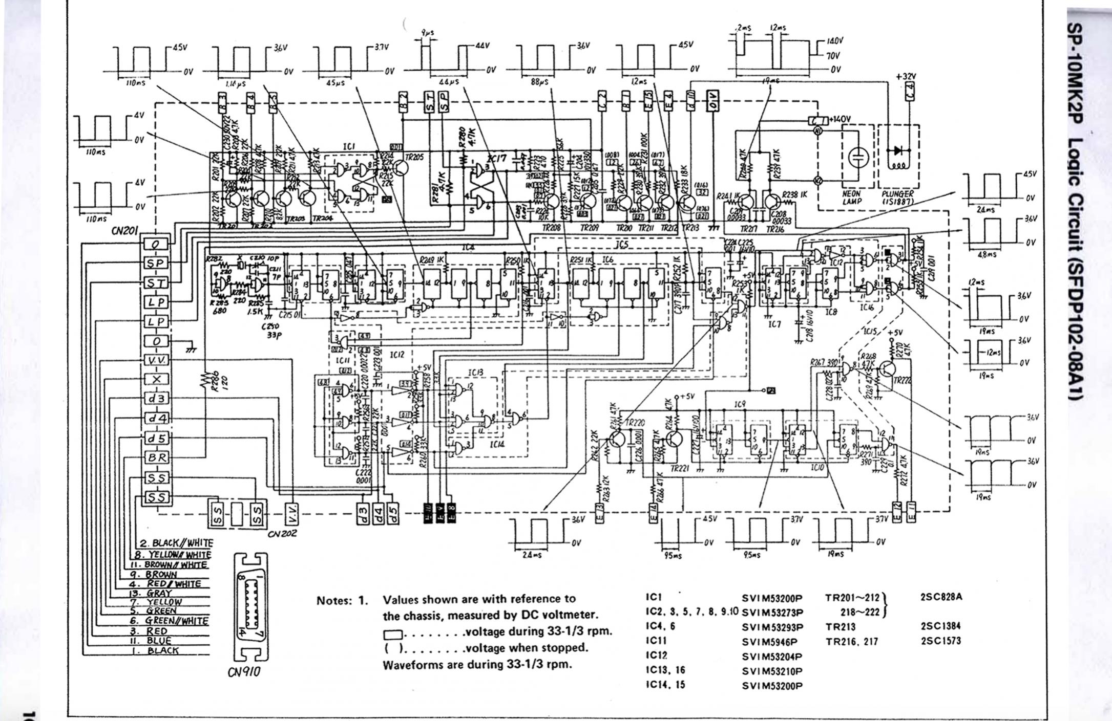

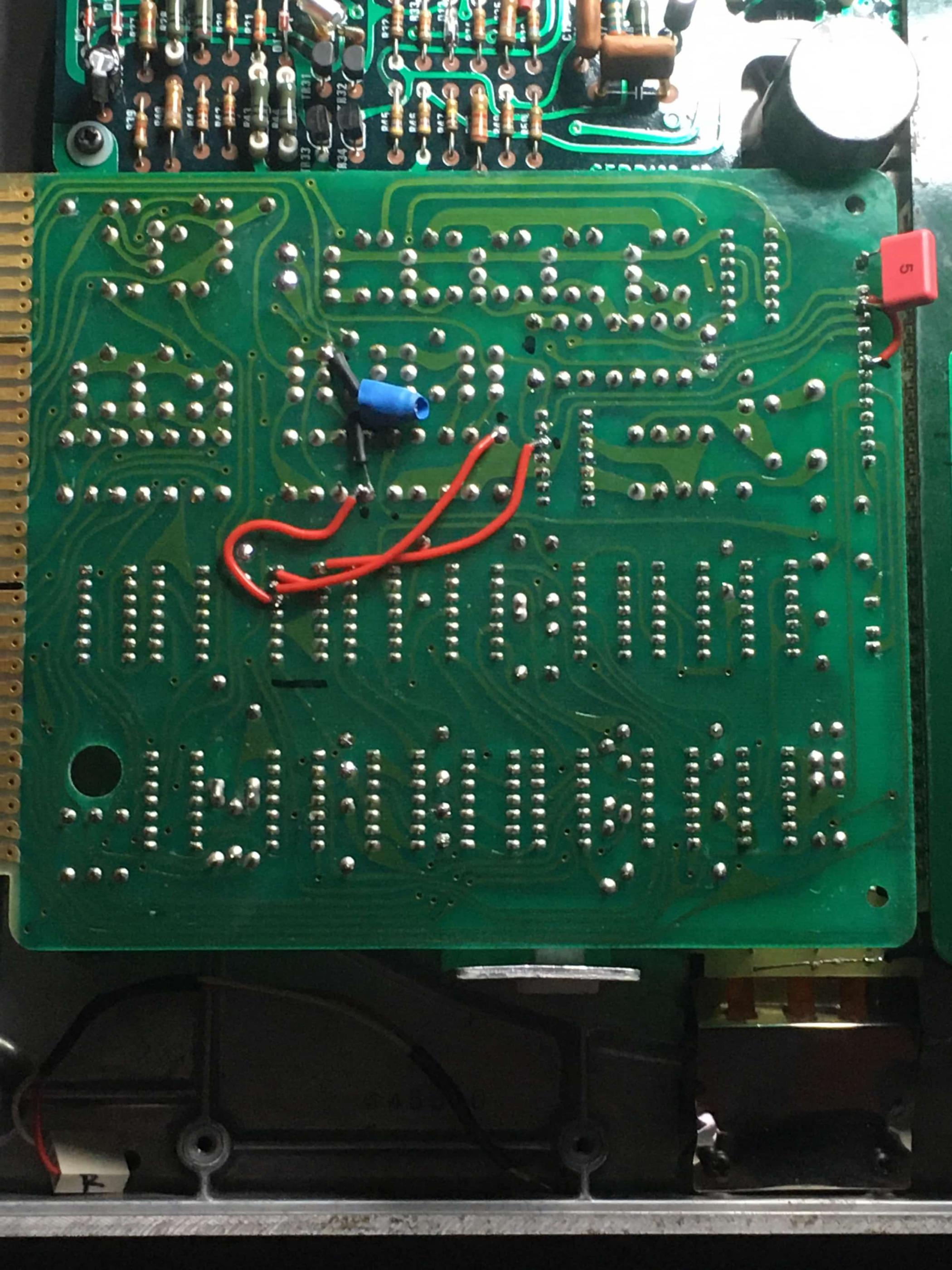

I have started to remove the control box following the very helpful and informative post by [mention]Aleks1 [/mention] (posts 999, 1001) but have run into some issues....

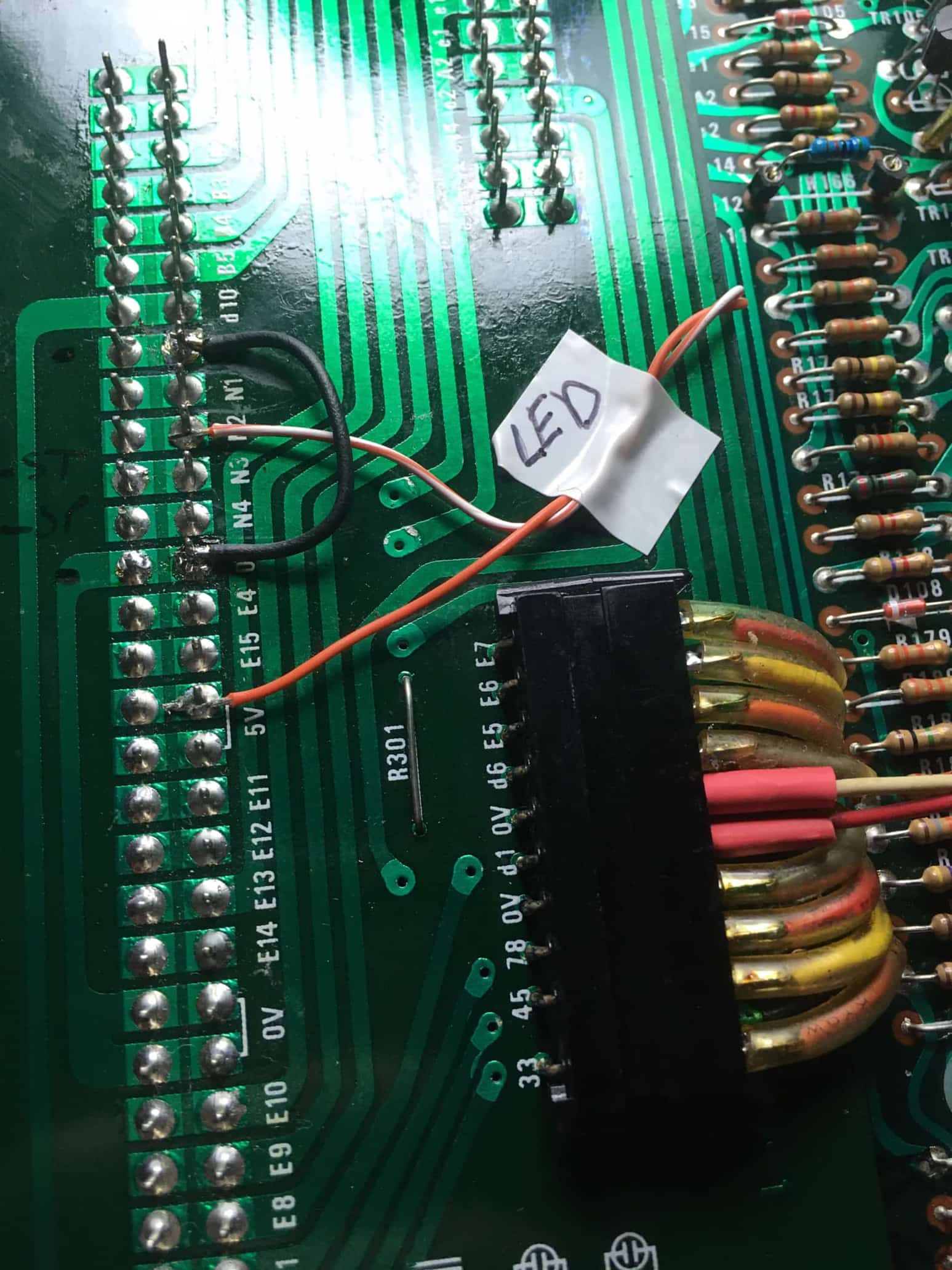

The start button was wired to a header on the left of the logic board at cn202 but after doing the mods to convert it I have wired the start switch to the where the rest of the 33/45 buttons which go on the connecting pcb as I seem to get better results with it there.
Currently I can select any of the three speeds but when I press start the platter stays still, it does however actuate the brake solenoid when start / stop is pressed.
If I spin the platter forwards then press start it brakes the platter as if the brake mech is seeing the start/stop command but it doesn’t quite command the motor to go so I would be greatly appreciative if anyone could point me in the right direction ?
I do not have a scope unfortunately and have never used one.
Changes I made
R281 I changed to a 56k resistor.
R166 I also changed to 56k
C203 I added this on the back of the logic board according my to Aleks
0.1uf capacitor (wima type as it’s all I had available ) between start switch and gnd
A jumper between ST and VV
Mods already in place

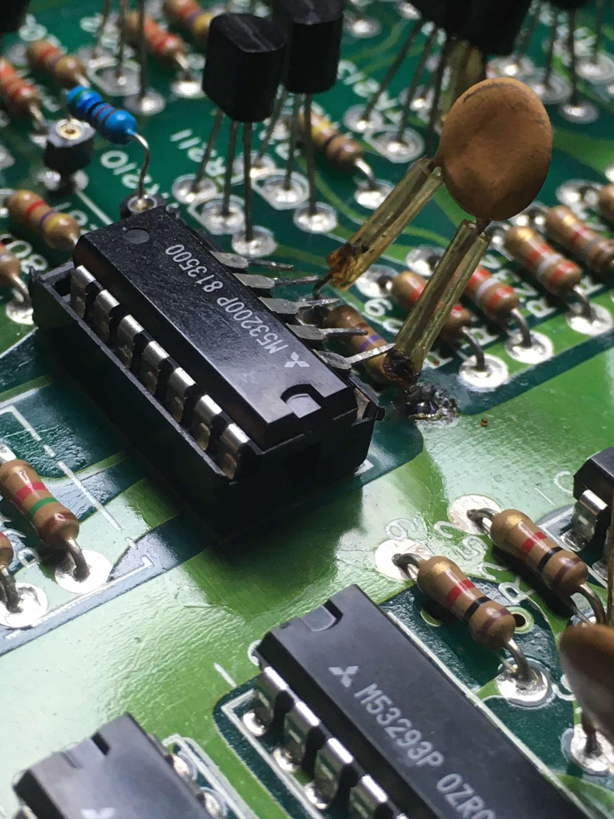

Piggybacked on R233 I have what appears to be a 0.047 mlcc capacitor which is marked on the PL circuit diagram.
I also have a black wire small jumper on the connection pcb which appears to be a connecting two 0v lines coming off the logic pcb (without this jumper my led strobe mod doesn’t work)
See pic below

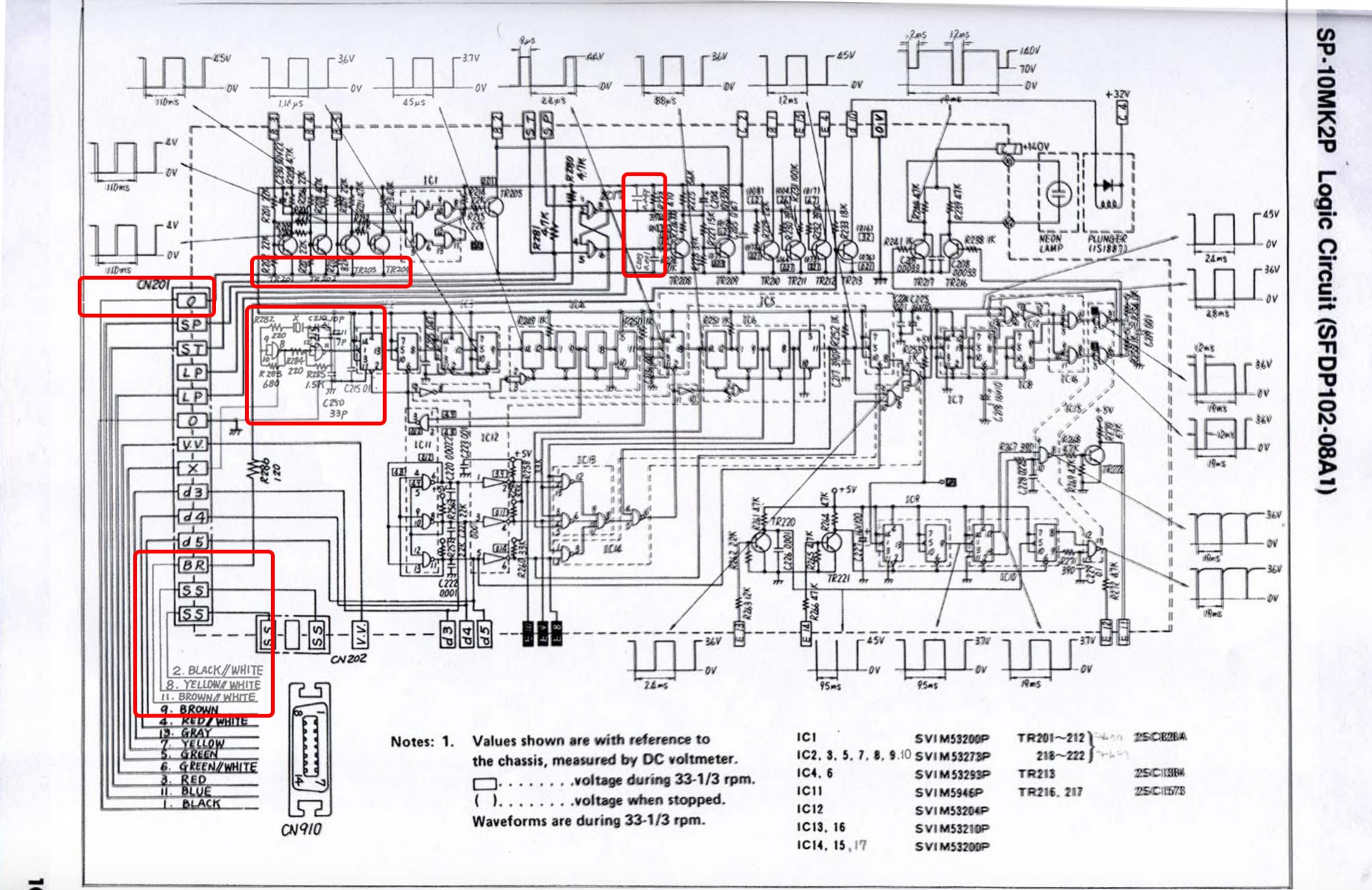

Hi guys - very weird timing, but I've also just acquired a P/L model and am also interested in the mod to remove the SH-10C.
As with Deburgh, I also don't personally own a scope, although do have access to them at work, and some helpful colleagues who can show me the ropes.
As a starting point, I created the following overlay(s) of the circuit diagrams to highlight the differences between the logic board which was modded earlier in the thread (the RP2/9) and the P/L board.
The only problem is, I'm not adept at deciphering circuits
So, is the same mod feasible with the P/L circuit, or do the highlighted differences on the original boards change the work required?
Any help much appreciated!

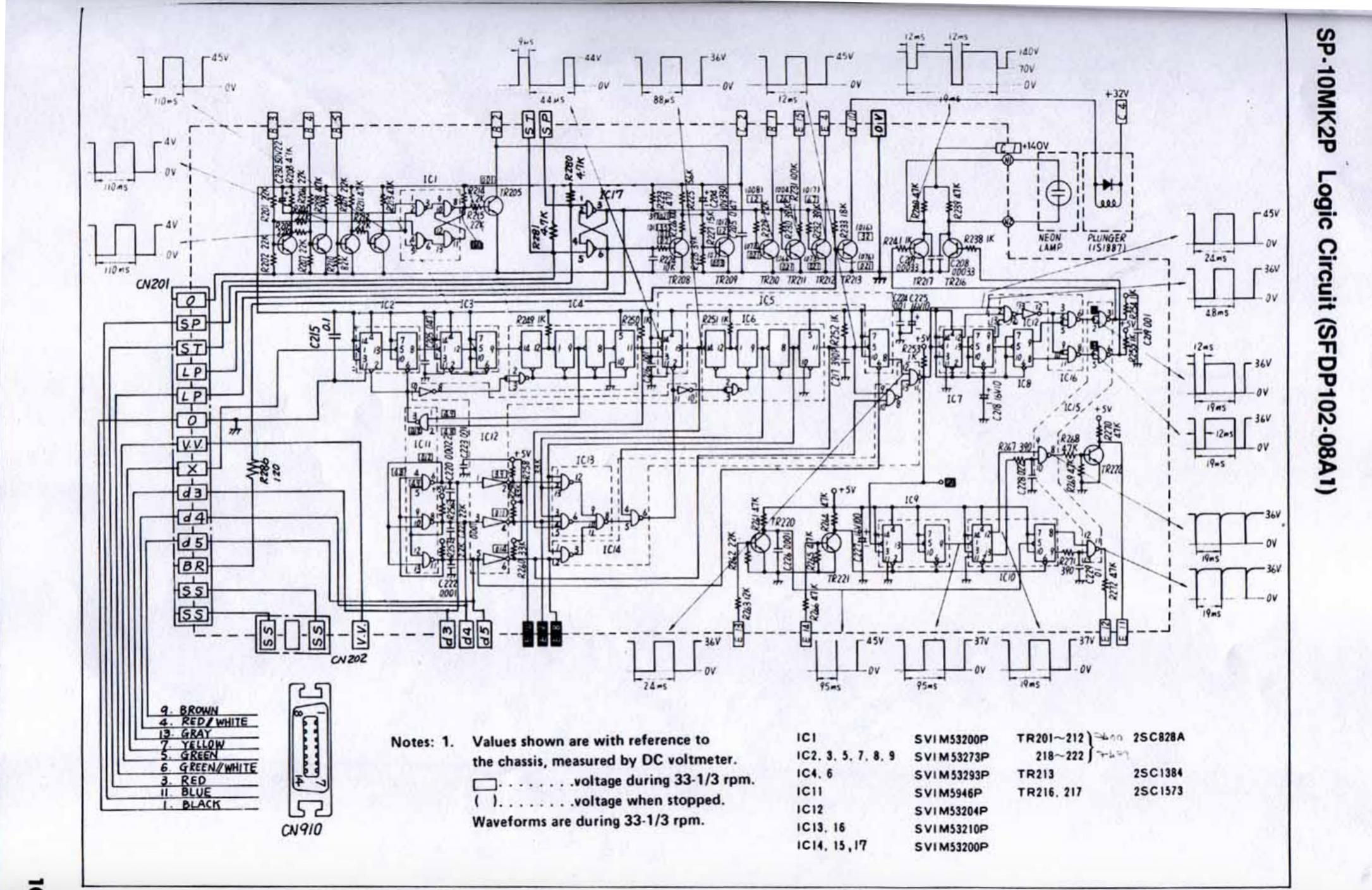

Thanks Winfried, the last image was the same as the first which is why Its maybe errored
Currently I have both the original and the p/l diagrams from vinyl engine and am looking for some pointers for my issue

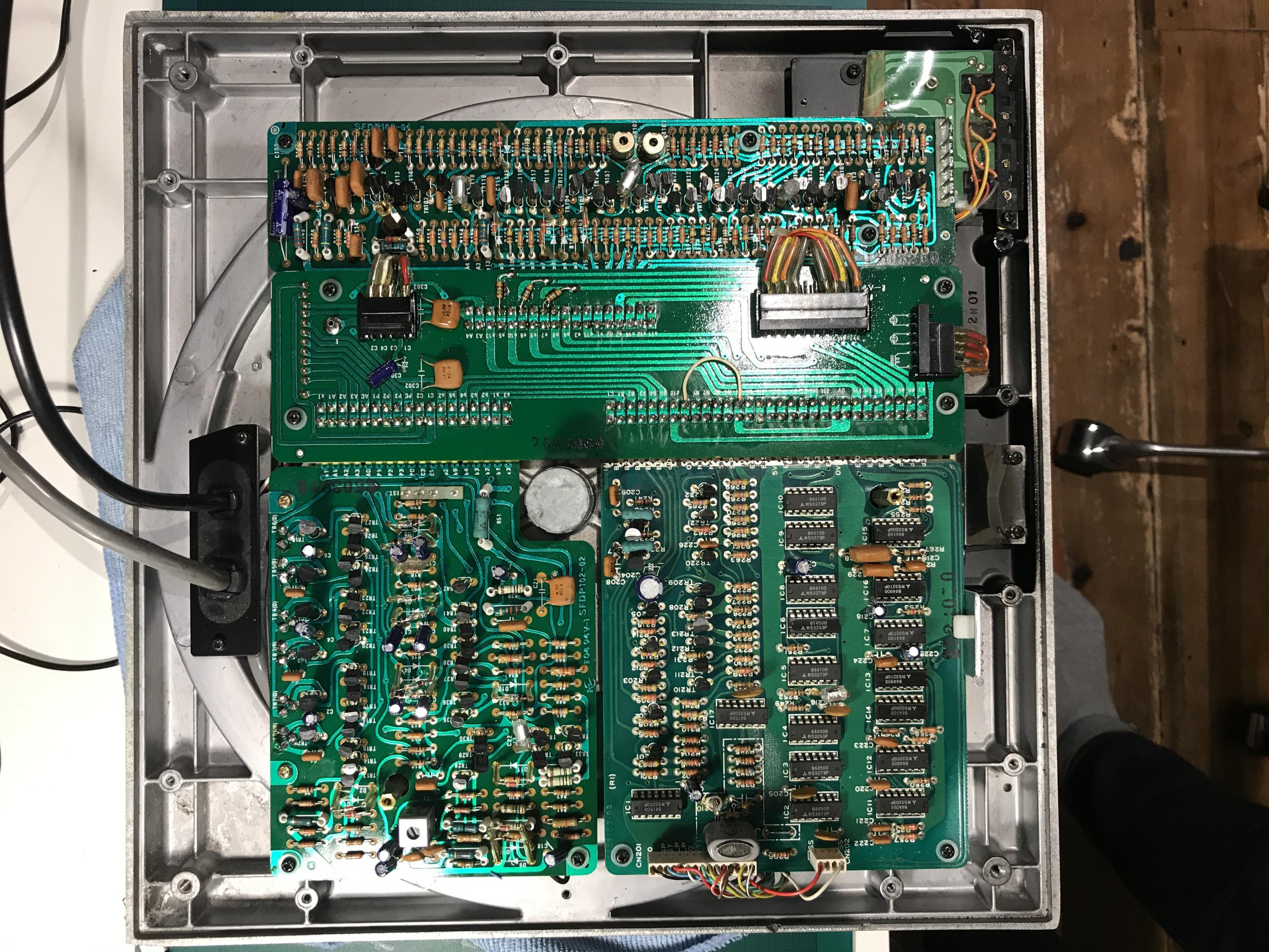

Ok, so I've opened her up and it looks as though the logic board (bottom left) is the same as Alek's board which he successfully modified in post no.999
This P/L variant has the start/stop logic components - which makes sense as the onboard start/stop is functional (with the SH-10C at the moment).
I can't find any images showing the complete PCB setup in Alek's RP2/9, but I would imagine the other boards are the same? If so, the mods should be transferable, but I know that deburgh hasn't quite got them working.
Any help appreciated

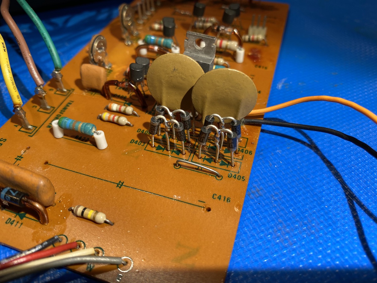

Hallo, I received a very messy SH10E power supply and not work because the dual diodes marked on the diagram D403 404 405 406 are not there, consulting the service manual I read the abbreviations that are RVD10DC2 and RVD10DC2R and unfortunately they are obsolete.
I saw that Technics has adopted them on a lot of past productions (deck and turntable).
I thought I'd wait a good moment to retrieve these components from some pcb if I can find them for sale on ebay assuming they are compatible but I can't know for sure, or alternatively I should try to look for compatible modern components to buy new and to easily insert on the pcb in place of the missing ones without forced adaptations but I have no idea what to look for.
Some advice?
Thanks.

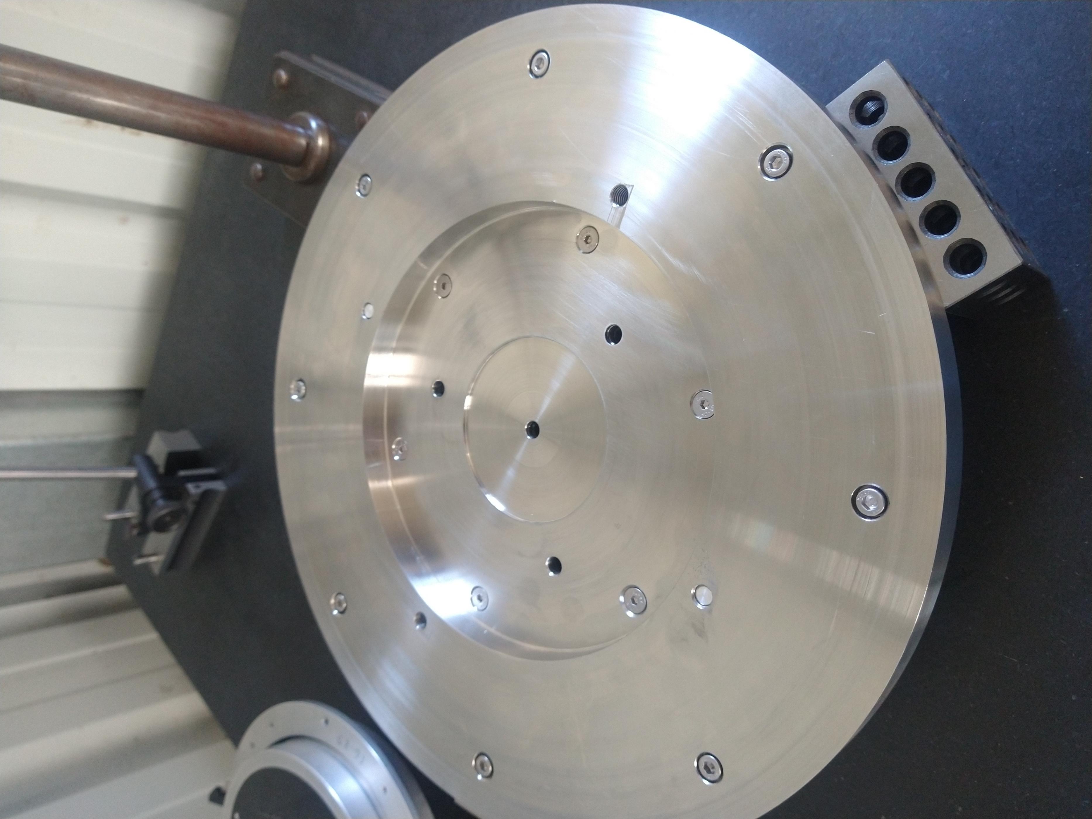

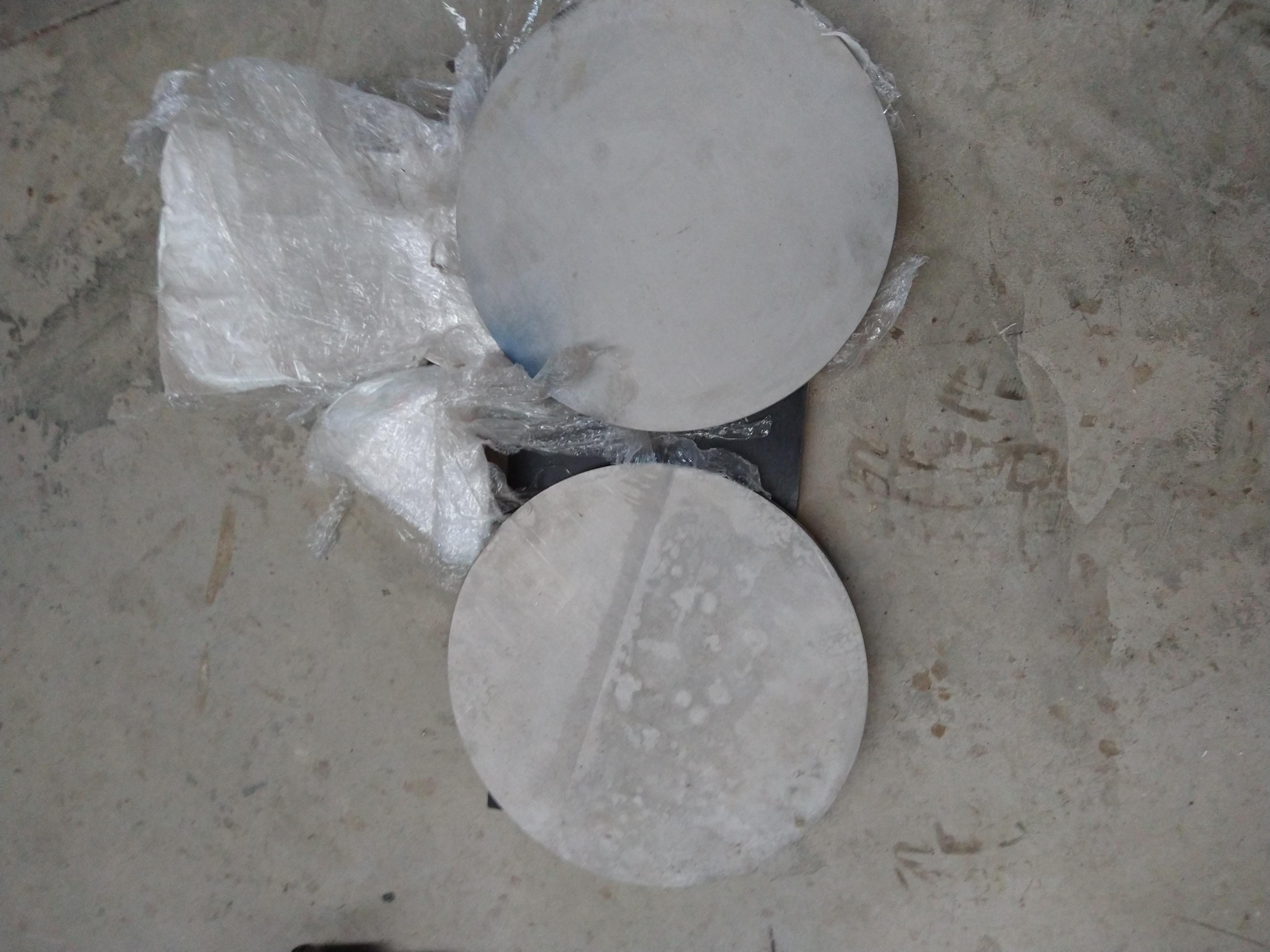

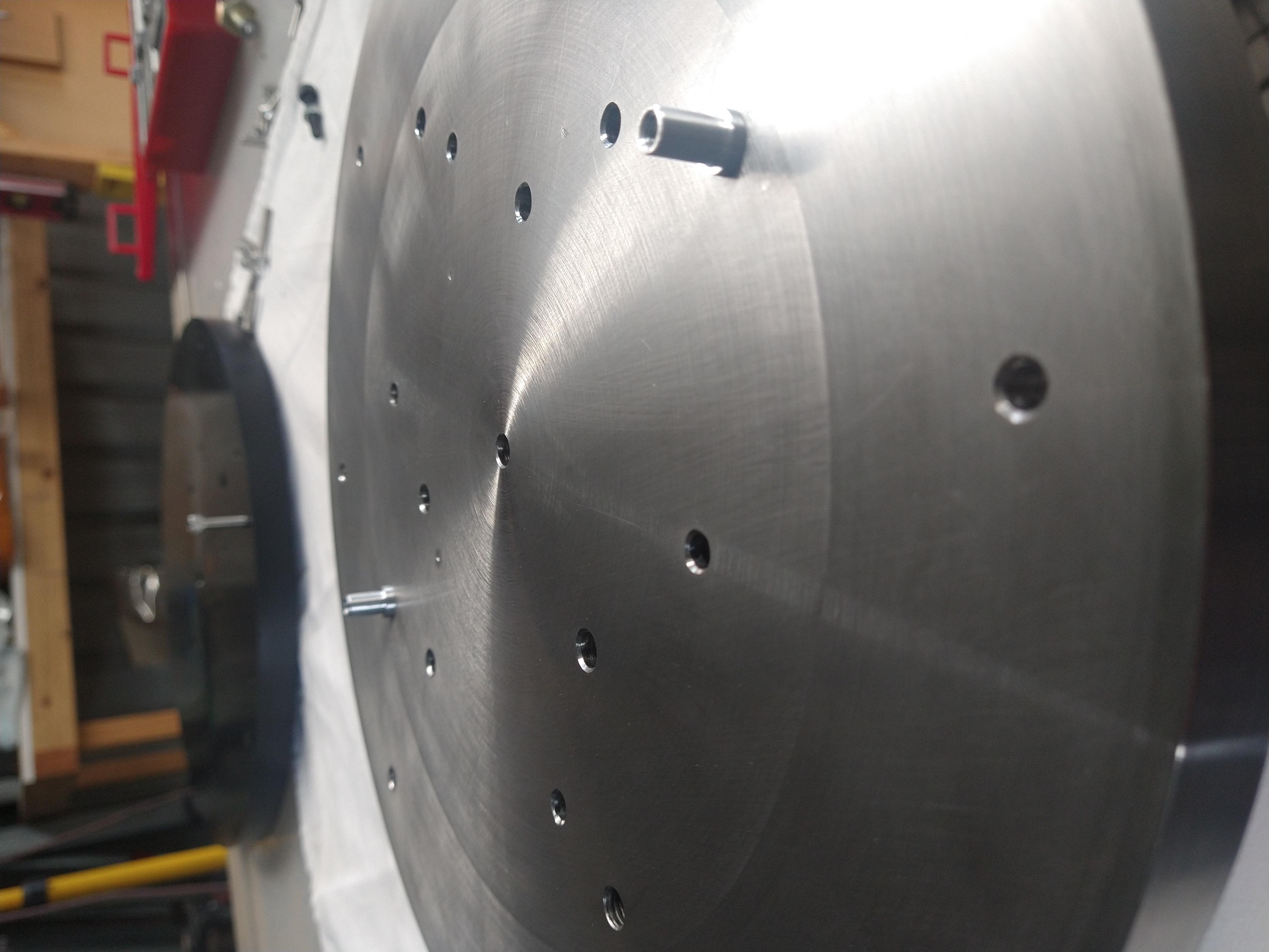

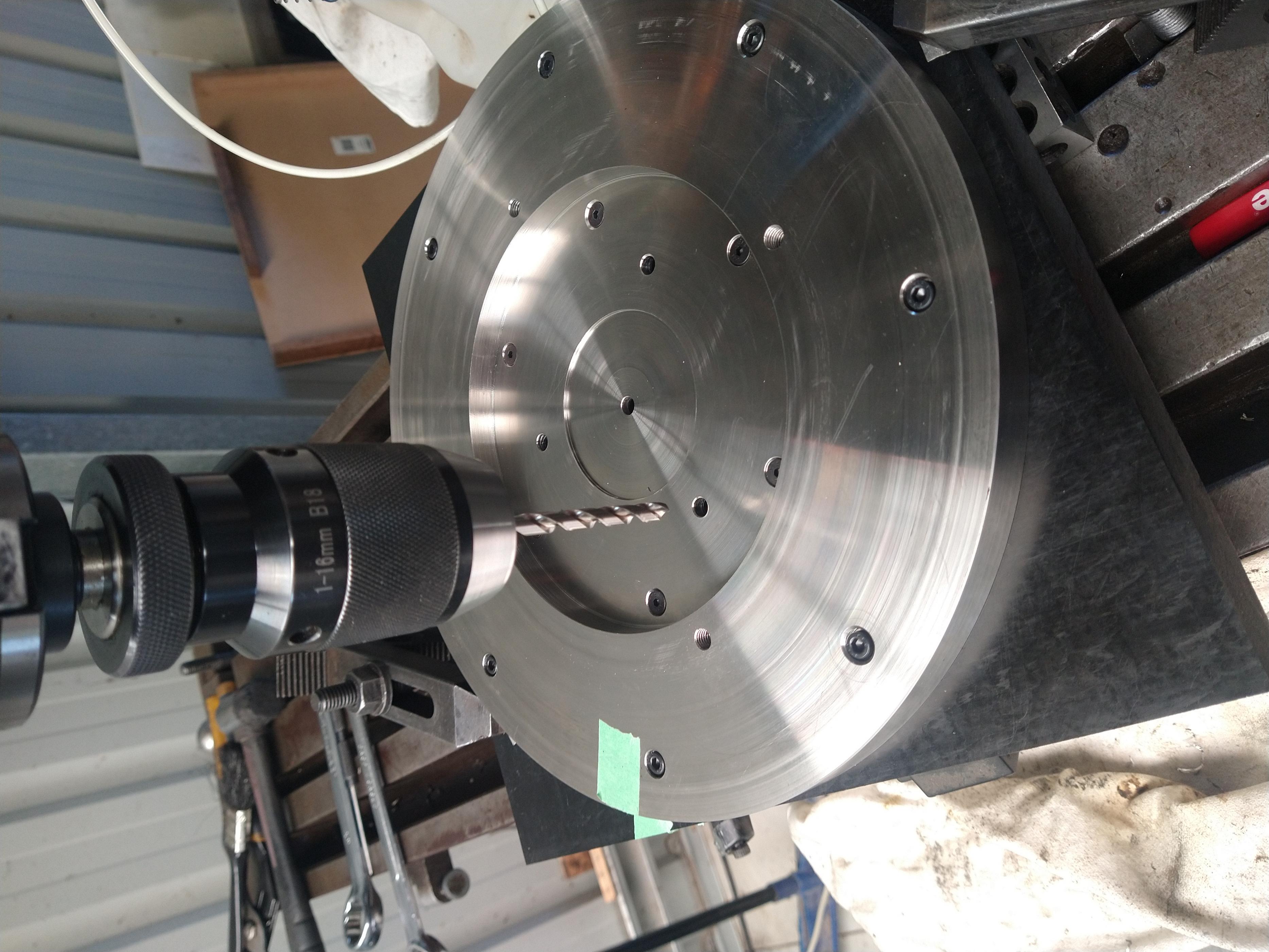

I thought I would post this platter I made for a DIY member for a chassis-less SP10. It's Stainless Steel and Delrin.
First pic is 322x20mm Stainless blank.
The pins sticking up from the SS in the 3rd pic are for SP10R M5 lifting handles. I don't have scales rated for more than 5kg but estimated weight is about 10kg.

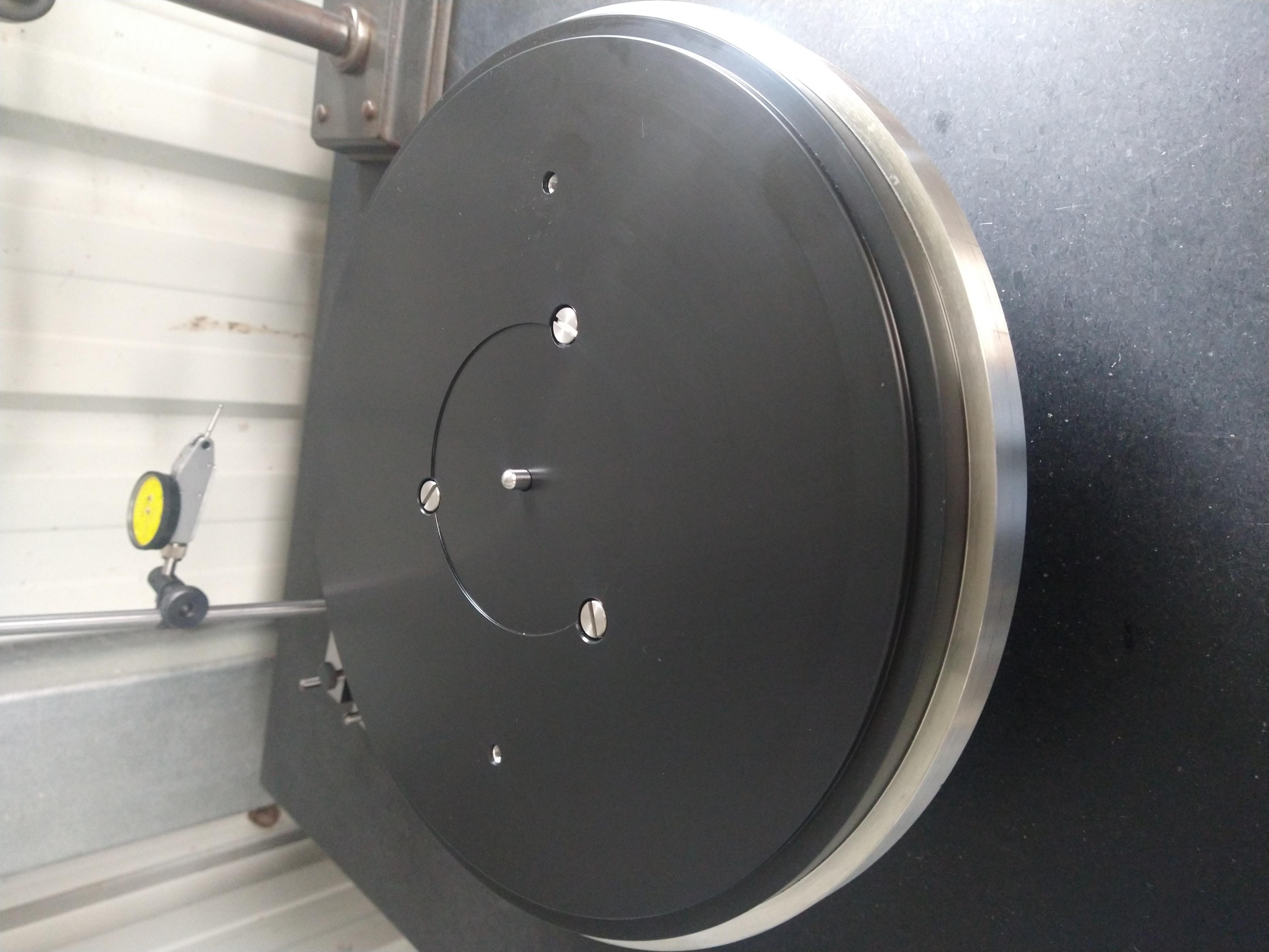

When I installed it on my motor the runout was not so good so I checked the mating surfaces.
This the platter mating surface
DIY SP10 Stainless Steel platter. - YouTube
All the runout is in the motor.
Technics SP10 motor runout - YouTube
mmmmmmm.........need to worry about an imbalance of that entity?
Unbalanced the counterplate or is the pin seat not perfectly vertical in your opinion?
I put the motor spindle with platter mount in the lathe, spun it slowly (20rpm), checked spindle runout to platter mounting face runout. Platter mounting face runout was about 0.05mm TIR (Total Indicated Runout).
After a LOT of measuring and re-measuring I came to the conclusion that the runout seen in the video is caused by the bearing sleeve not being perpendicular to the motor mounting face, the bit that screws to the SP10 chassis.
This may not be an issue as when we level a TT the usual place to put the level is on the platter so this would negate the effect.
