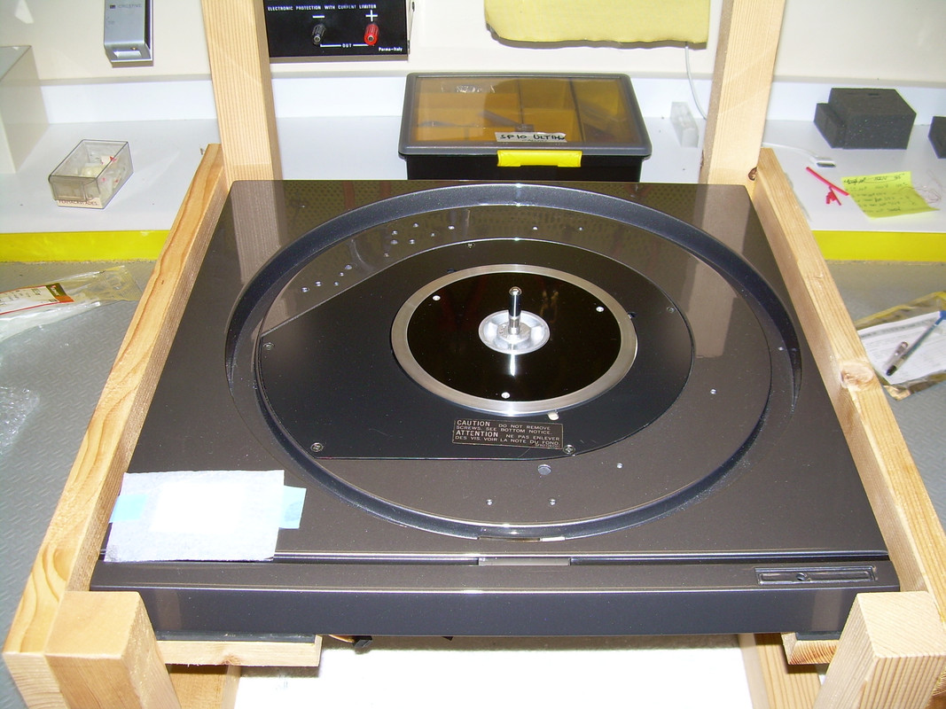

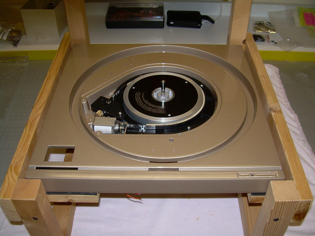

Flipped the unit over(PSU off), took the plate off, and turned the PSU on. Brake on. Turned the PSU off, brake off. It works and I learned something.

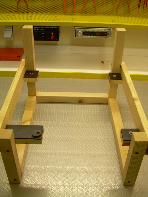

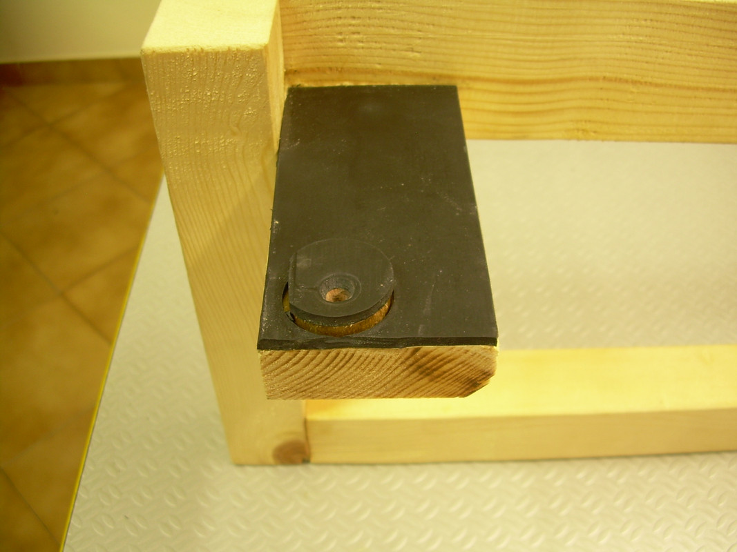

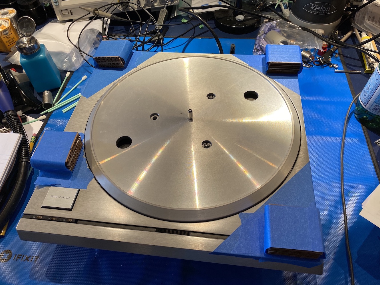

You can take squares of cardboard glued together to create four blocks for each corner of the chassis. Fashion these a tad taller than the spindle and attach with tape. You can then flip the 'table over with the platter on and compress the blocks a bit as needed to ensure the the spindle shaft has contact with the thrust bearing and is not hanging in the air. Works a treat, and far easier to do diagnostics.

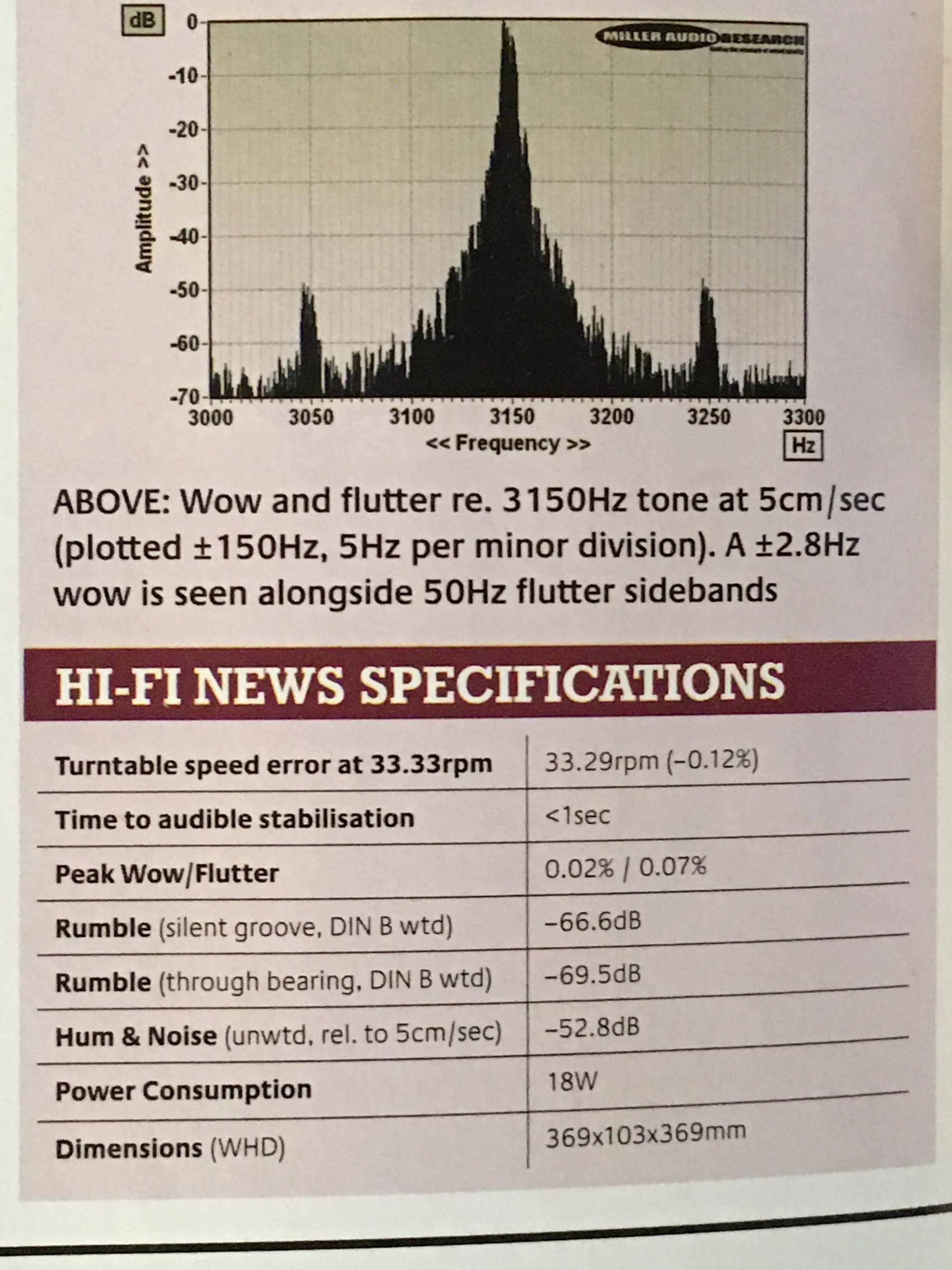

Hi Fi News has tested the mkII (Vol 55, No. 11, November 2010) and reported mains related breakthrough, principally 50 Hz, 100 Hz and 150 Hz on UK 50 Hz mains. This can be seen polluting the W&F measurements. The 100 Hz breakthrough is the worst and can be seen clearly in the ±100 Hz sidebands, which rise ~15 dB above the noise floor. Comparing this with the SP10R results (Vol 63, No. 06, June 2018), which has a 7 dB improved Hum & Noise, the principal measured difference between the 10R and the mkII, is seen in the flutter results. Is this due to the mains induced hum? Without these sidebands the 10mkII still measures state-of-the-art on W&F. The transformer induced hum in moving coil's does required sufficient distancing of the power supply from the cartridge. The 10R uses a switched mode power supply. Would a SMPS improve the performance of a mkII? I realise SMPS are noisy compared to LPS, but will this mainly hf noise be less deleterious to performance than the mains related hum of a LPS?
