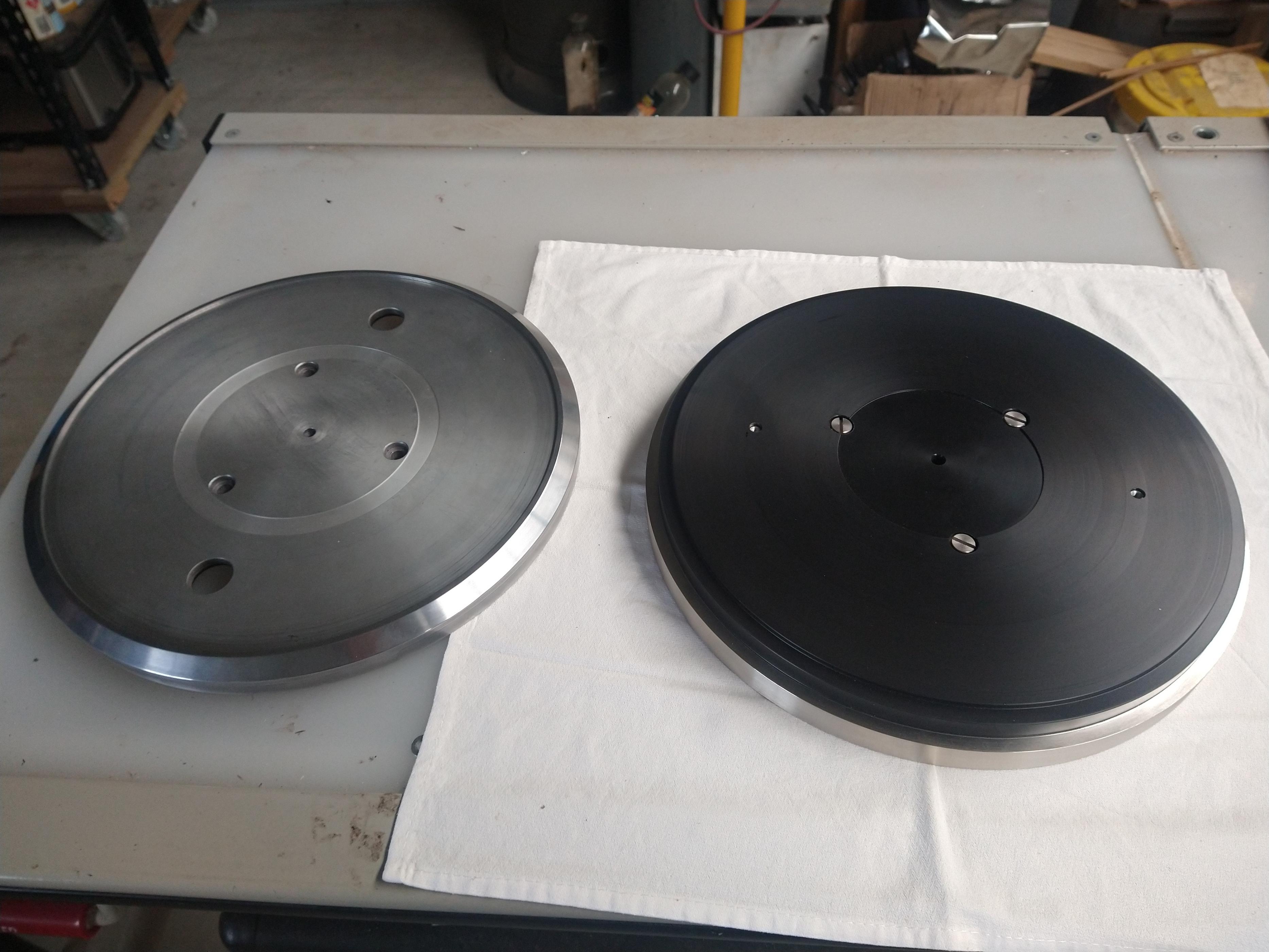

I'm about to go down this rabbit hole now. I have a spare mk2 that has the motor disassembled and is ready to go in a plinth. Electronics will be housed in a separate chassis (not the mk2 chassis).
I have also done a fair few measurements of the mk2 motor with both the OEM and stainless steel platter I made and have found a lot of flex in the bearing assembly, most of the flex is in the motor bottom housing
I am in the process of machining a Stainless platter to OEM spec then I plan to machine a new motor top and bottom housing from either 7075 or 6061 aluminium with a larger bearing housing and PEEK inserts.

Drift is 0.002% and W&F 0.035%. I'm struggling to see how modern electronics will improve a mk2?
An improved bearing and platter would be money better spent and significantly cheaper. The mk3 bearing is 16mm vs 7.14mm and the housing fixture in the motor is far more rigid in the mk3.
Put a dial indicator on the edge of the mk2 platter and light finger pressure will deflect the indicator ±0.5mm. Then there is the fit of the spindle in the motor rotor another weak point prone to flex. I also took some measurements of the motor bearing housing to see what flex there is.
In this video I have put the motor housing in the lathe. I pushed down on the top edge of the motor and chuck jaw, there is almost zero flex, next I pushed on the bearing housing and was able to get 0.01mm flex from finger pressure. BTW I could not get a lot of pressure on the bearing housing without touching the indicator. It's a bit blurry as I'm trying to hold the phone and the skylight above does not help either.
SP10 Motor bearing housing flex - YouTube
