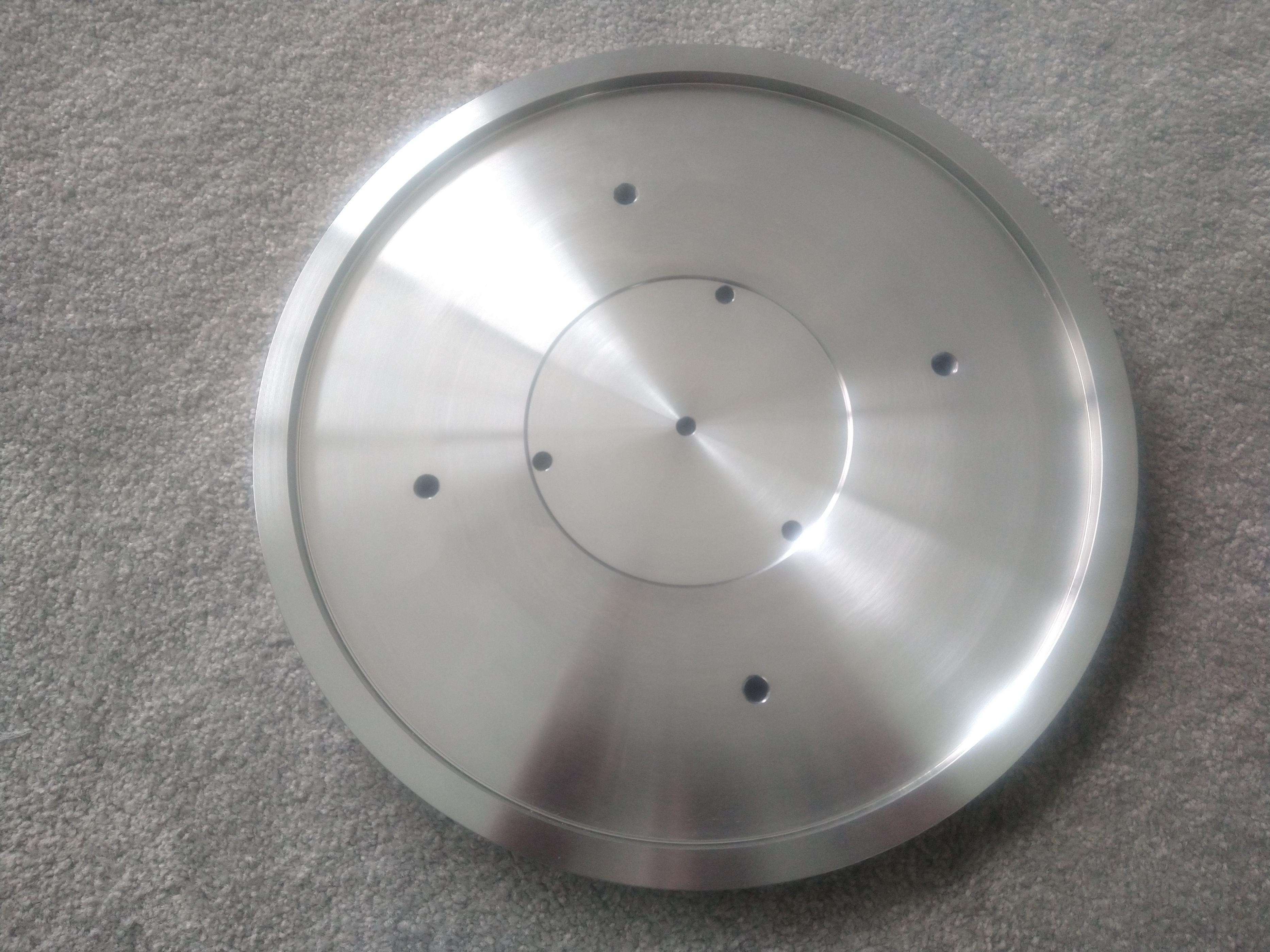

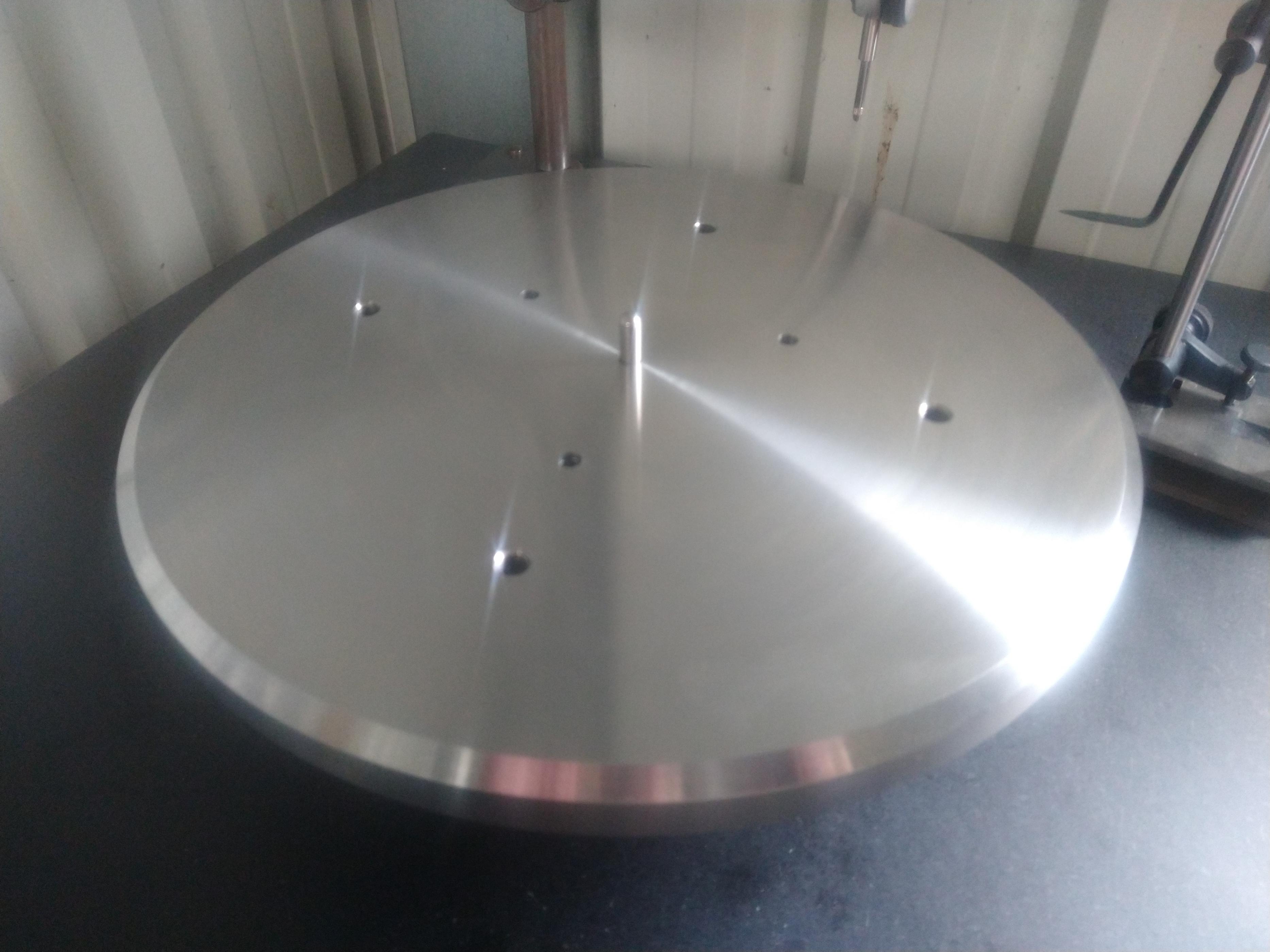

My Stainless Steel platter is roughed out just needs final sizing then I'll post some pics.

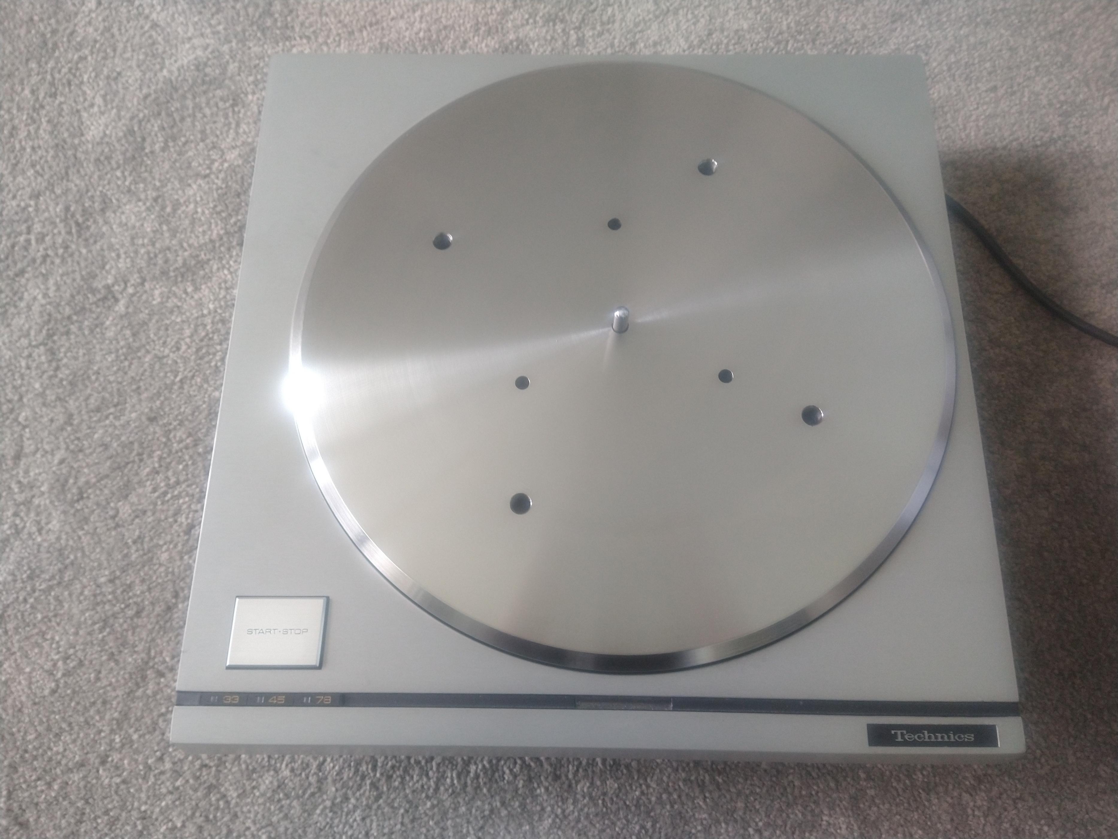

Finished the Stainless platter.
The SS platter is a massive upgrade. I have included a pic of the same impulse response test I did on the stock platter.
Bearing dropped from 300mm Stainless platter with acrylic mat. Impulse decay reduced from 418ms to 192ms.
How does it sound - exceptionally good.

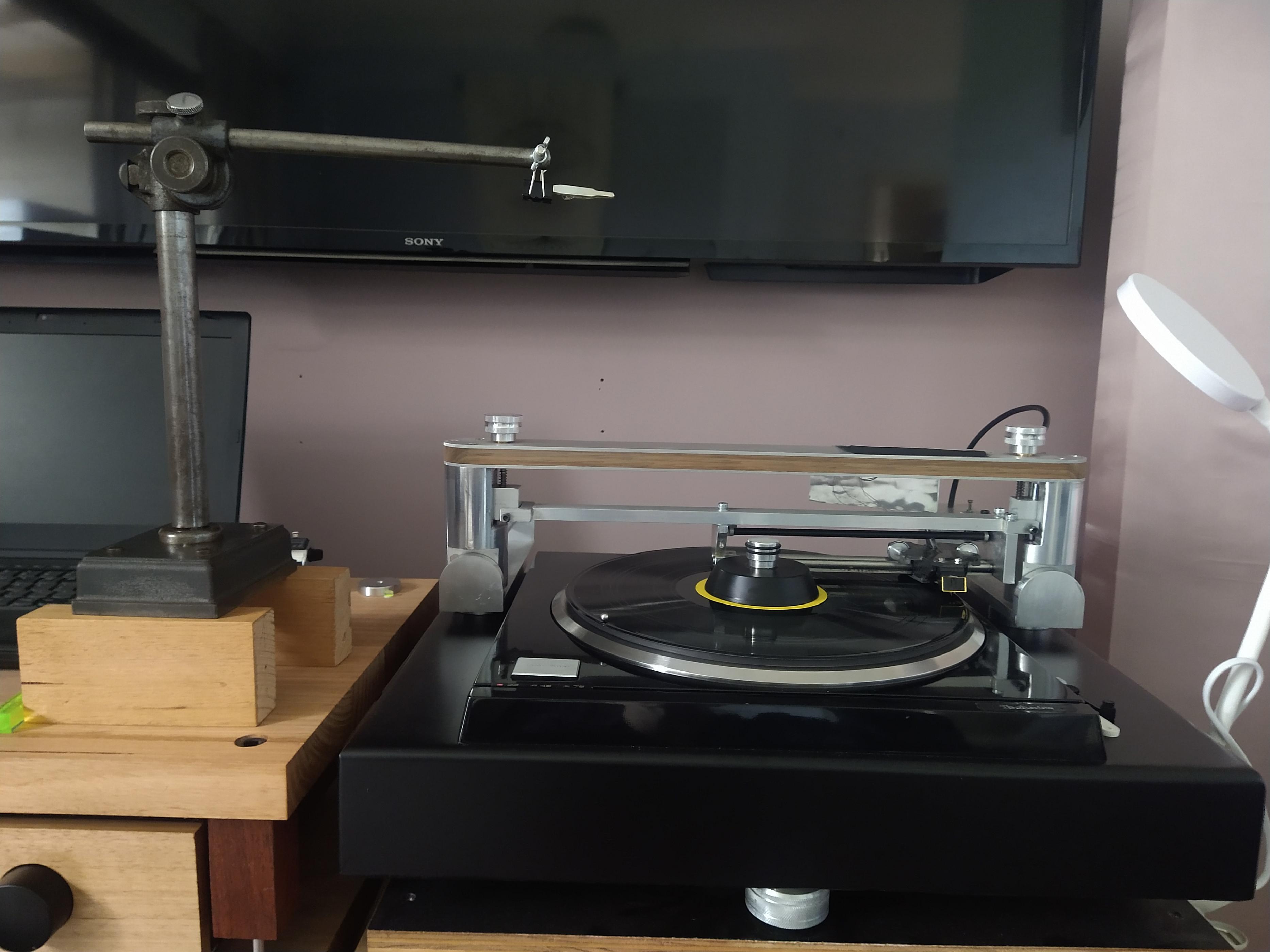

Fitted to my test mule SP10 in the pic.

Runout test.
Technics SP10mk2 Stainless platter runout - YouTube

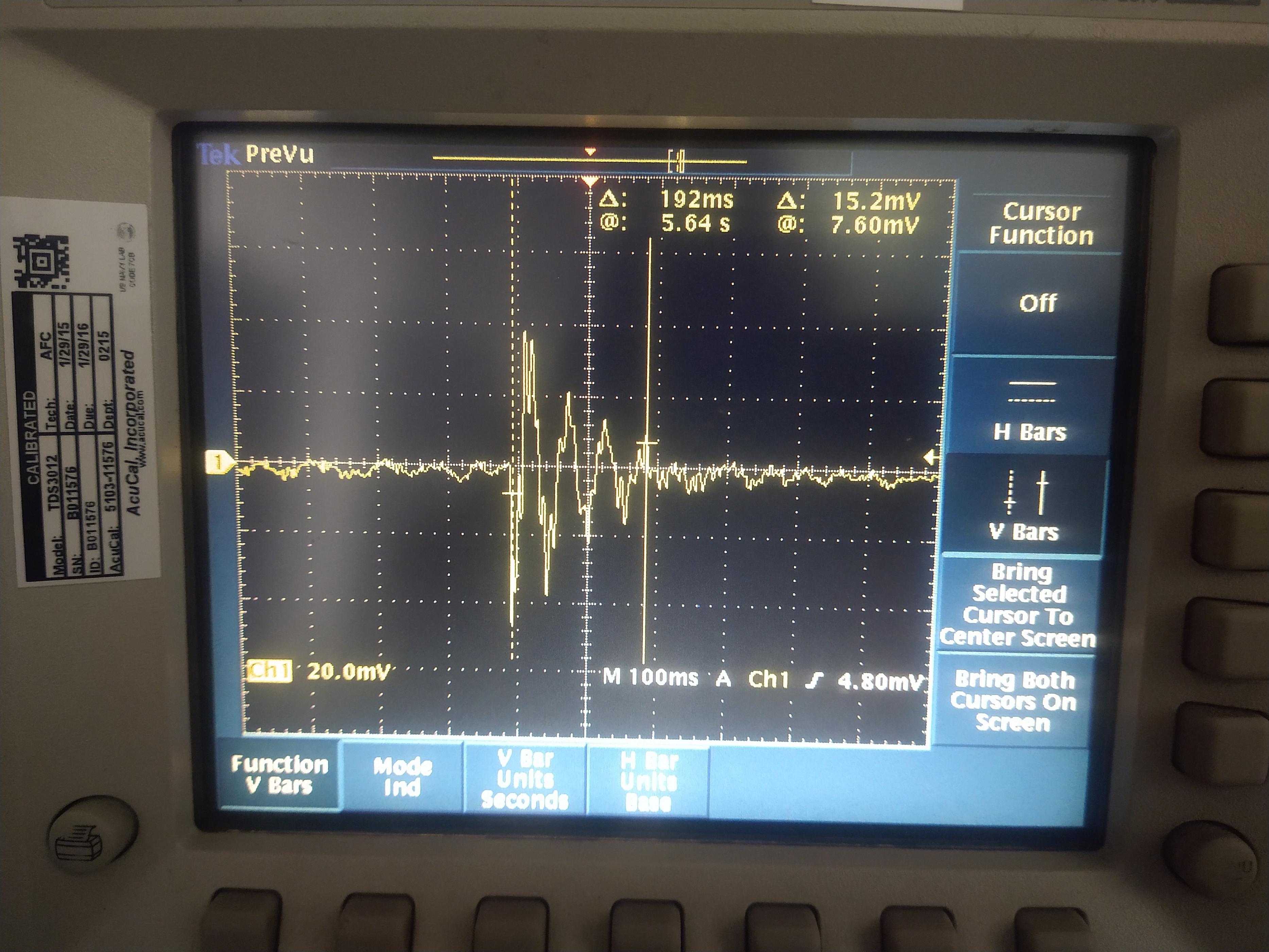

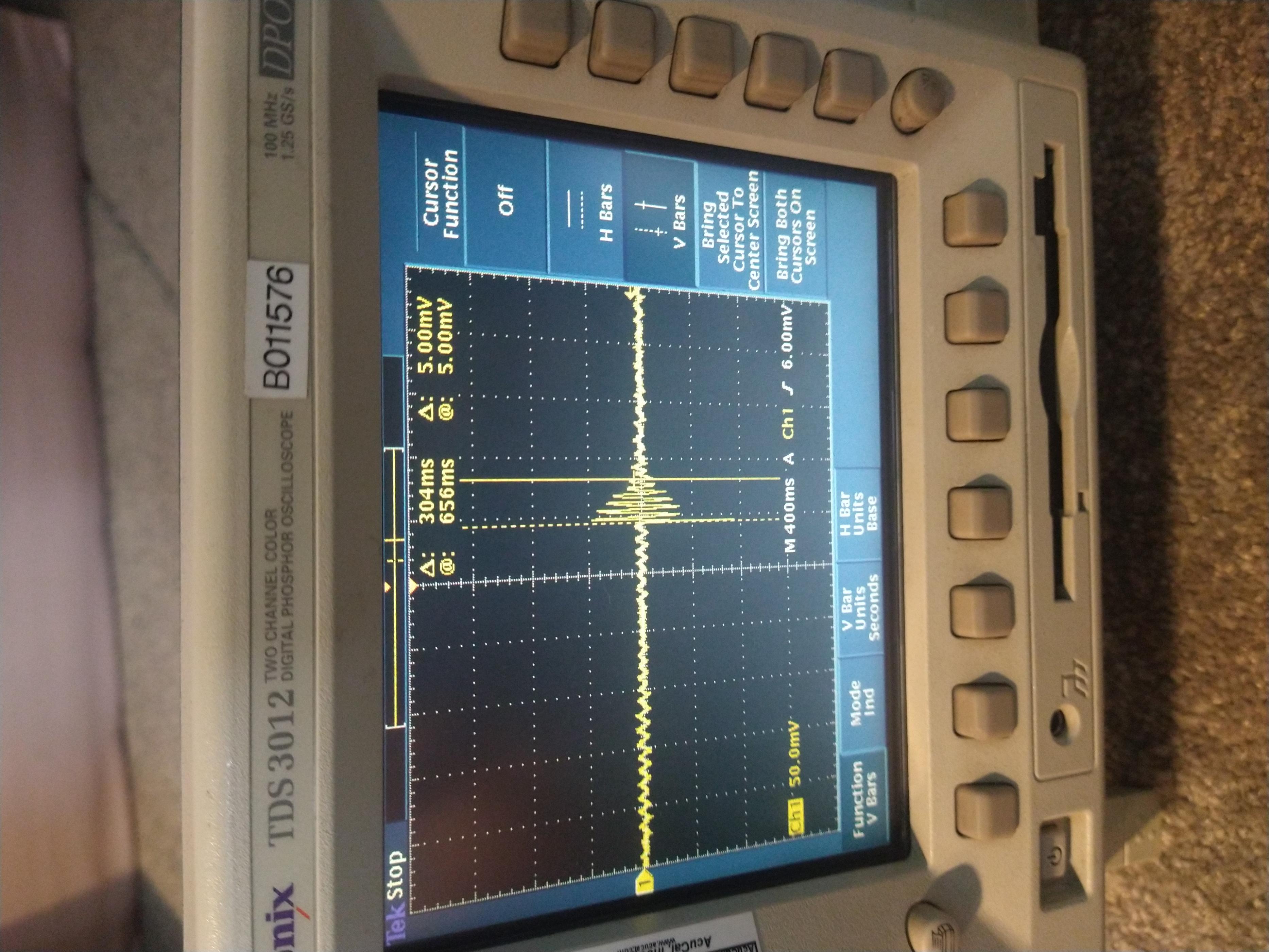

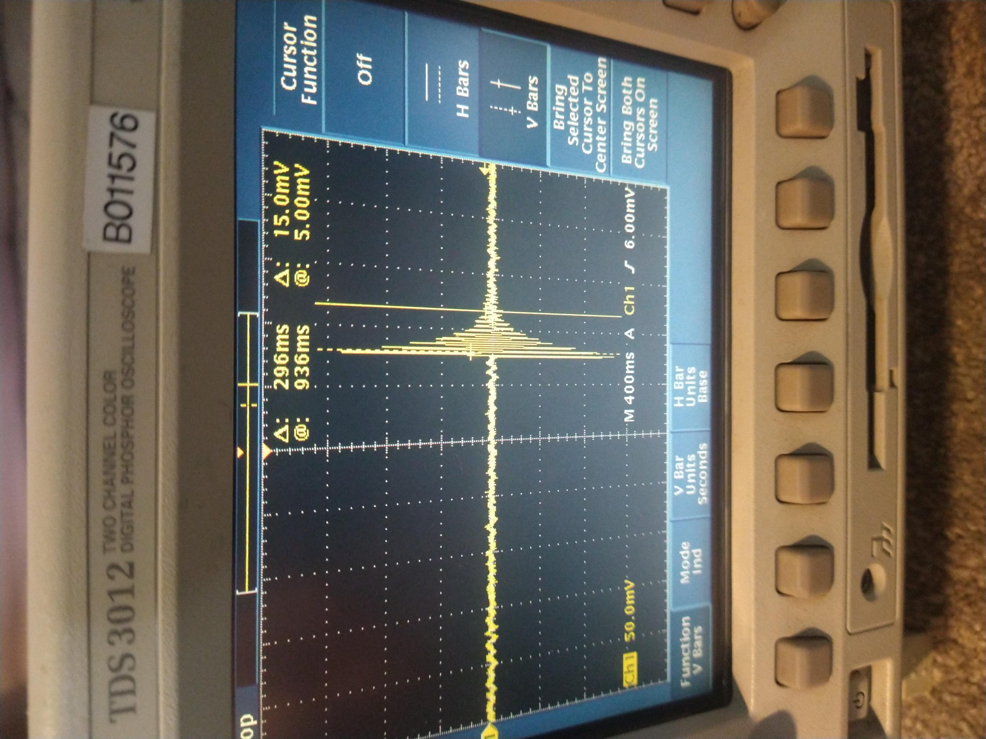

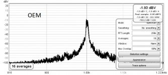

I have spent the morning revisiting the impulse measurements using a more scientific approach as well as other measurements. So without further adieu here we go.
Photos I hope will be in order of the measurements. SS platter is the first photo in each set.
All measurements performed on my main SP10mk2 with acrylic mat and reflex clamp.
Impulse Test averaged over 6 measurements photo just a snapshot of 1 measurement.
The last photo is the test setup used to drop the bearing on the LP so it was repeatable.
SS Platter
Fr = 18.6Hz
Level = 100mV P-P
OEM Platter
Fr = 30Hz
Level = 300mV P-P
Decay was about the same the main difference was impulse level and resonant frequency.

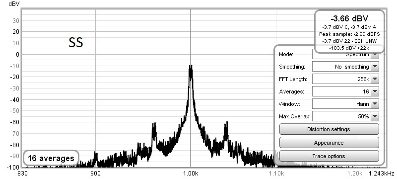

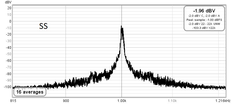

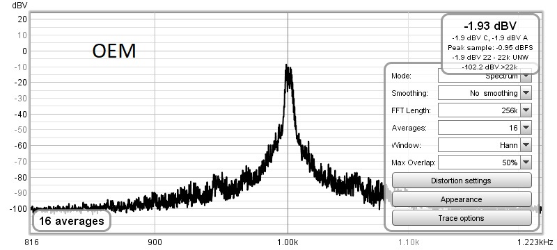

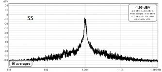

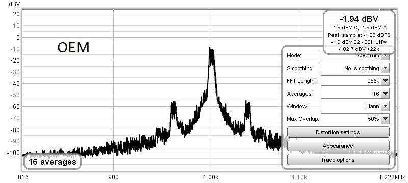

Modulation Test
Modulate a 1kHz test tone with external 40Hz seismic tone This is the biggest indicator to the difference between the 2 platters
18Hz was tired but there was no discernable difference in spectrum plots.
First 2 measurements are 1kHz with no modulation to set the reference which was then used for ALL measurements.
SS Platter
1kHz modulated with 40Hz
OEM Platter
Noise Floor un-modulated groove
No discernible difference between SS and OEM platter
W&F RMS DIN.
SS Platter
0.0732%
OEM Platter
0.0747%
NOTE: The Ulimate Analog Test LP and a software W&F meter was used for W&F measurements. The largest component of W&F was the Test LP being off centre and with a slight warp (Yes this is a new LP). But I was more interested in the comparative rather than the absolute value.
SS Platter
Fr = 18.6Hz
Level = 100mV P-P
OEM Platter
Fr = 30Hz
Level = 300mV P-P
Modulation Test
SS Platter
OEM Platter

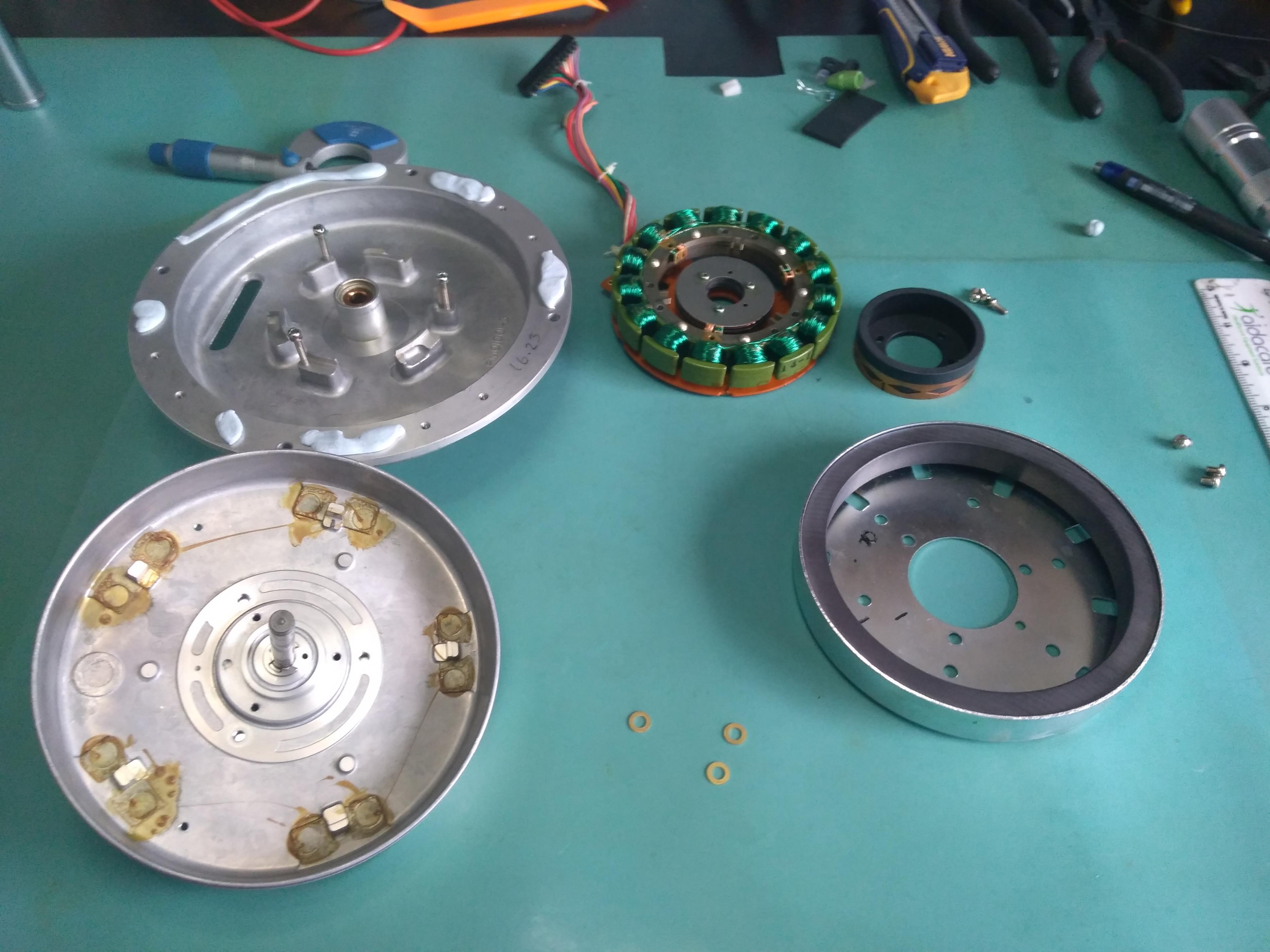

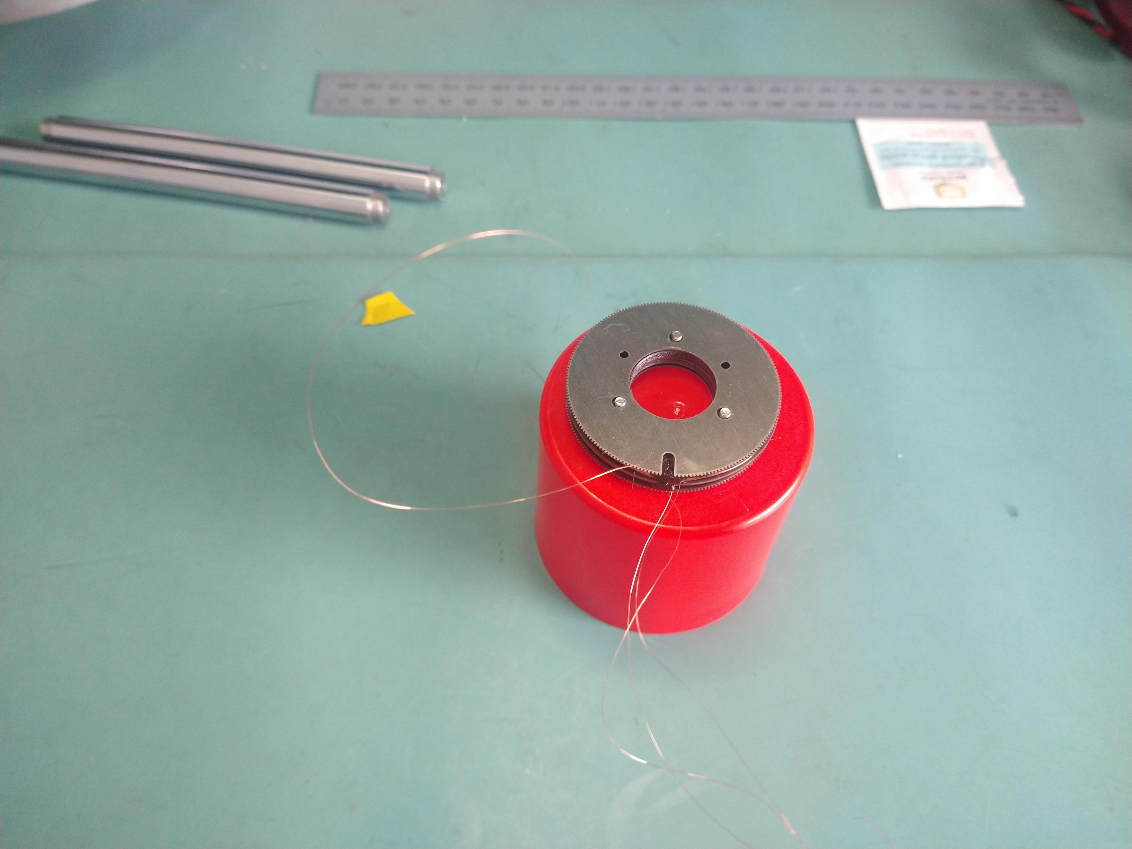

FG Repair
My spare SP10 motor developed an issue, on dismantling it I found one of the FG wires had broken. The only solution was to rewind the FG.
Here are a couple of pics of the FG apart and the rewound coils. The last pic is the motor ready for re-assembly.
Period adjusted and working perfectly. BTW for anyone adjusting the mk2 VR101 and VR102 need to be adjusted then re-checked as VR101 will effect 78RPM and vice-versa.
