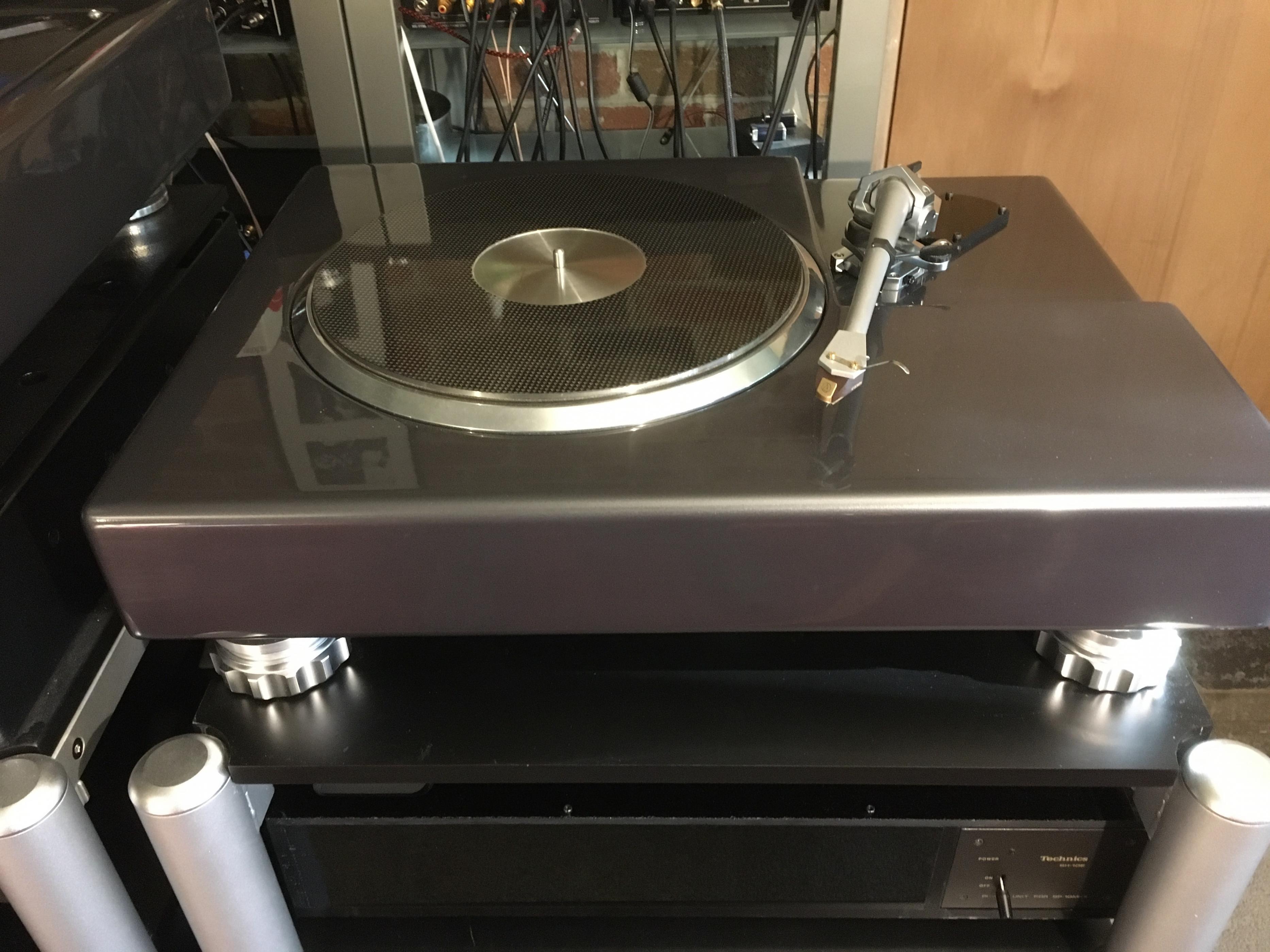

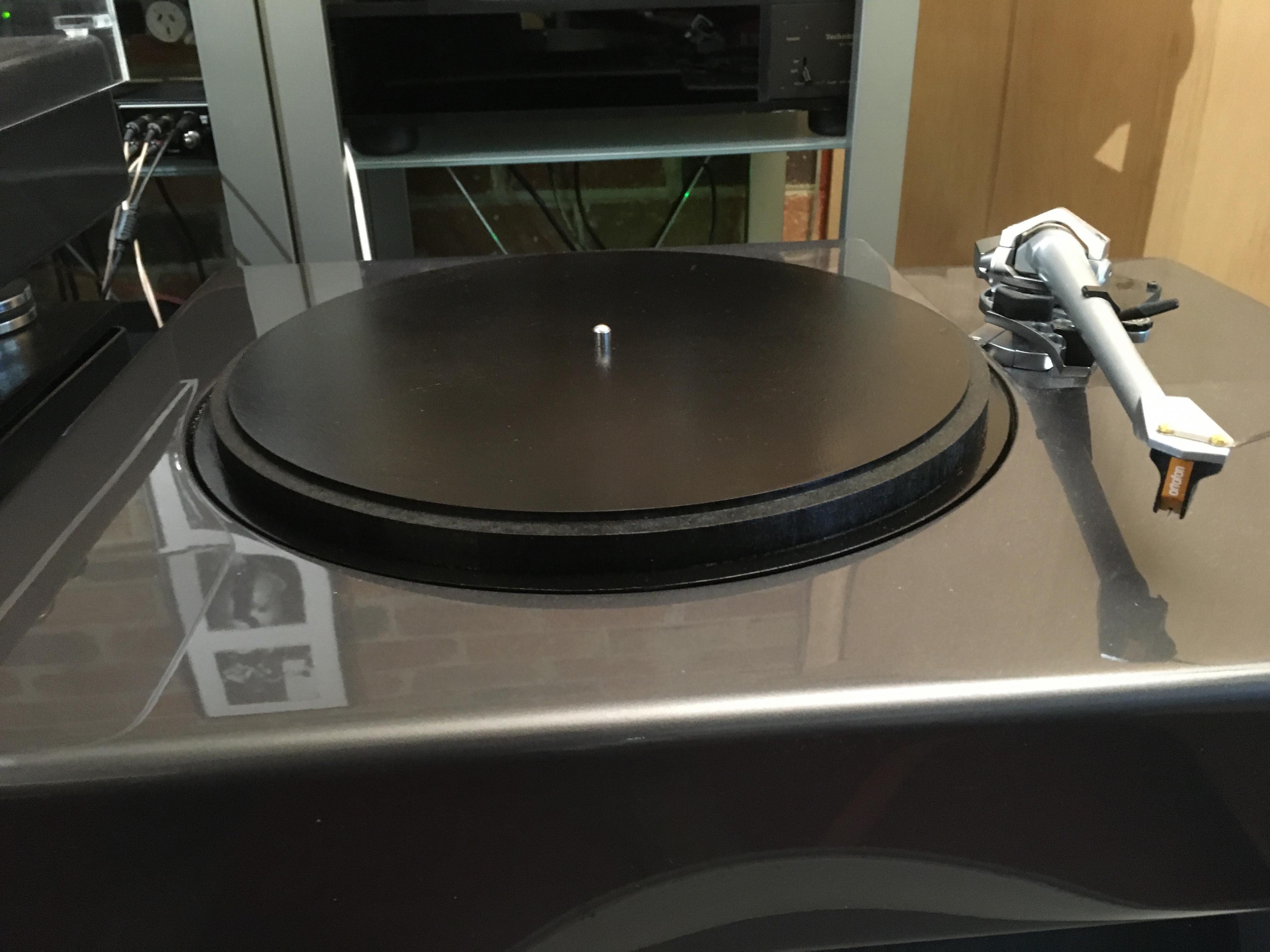

Time to out myself as the member for whom Warrjon has constructed the SP10mk2 platter in post #1614.
I have previously described my Kaneta style plinth in posts 1275, 1488 and 1528 and the discussions which followed. The final step is to replace the OEM platter, which has a clearly audible ring, despite the rubber damping layer. Warrjon is delivering the new platter in a couple of weeks and we will make some noise and impulse test measurements to try and quantify any differences in the platters mounted on the resin-bentonite plinth.
Here are some photos of an mdf mock-up of the new platter compared to the stock platter.

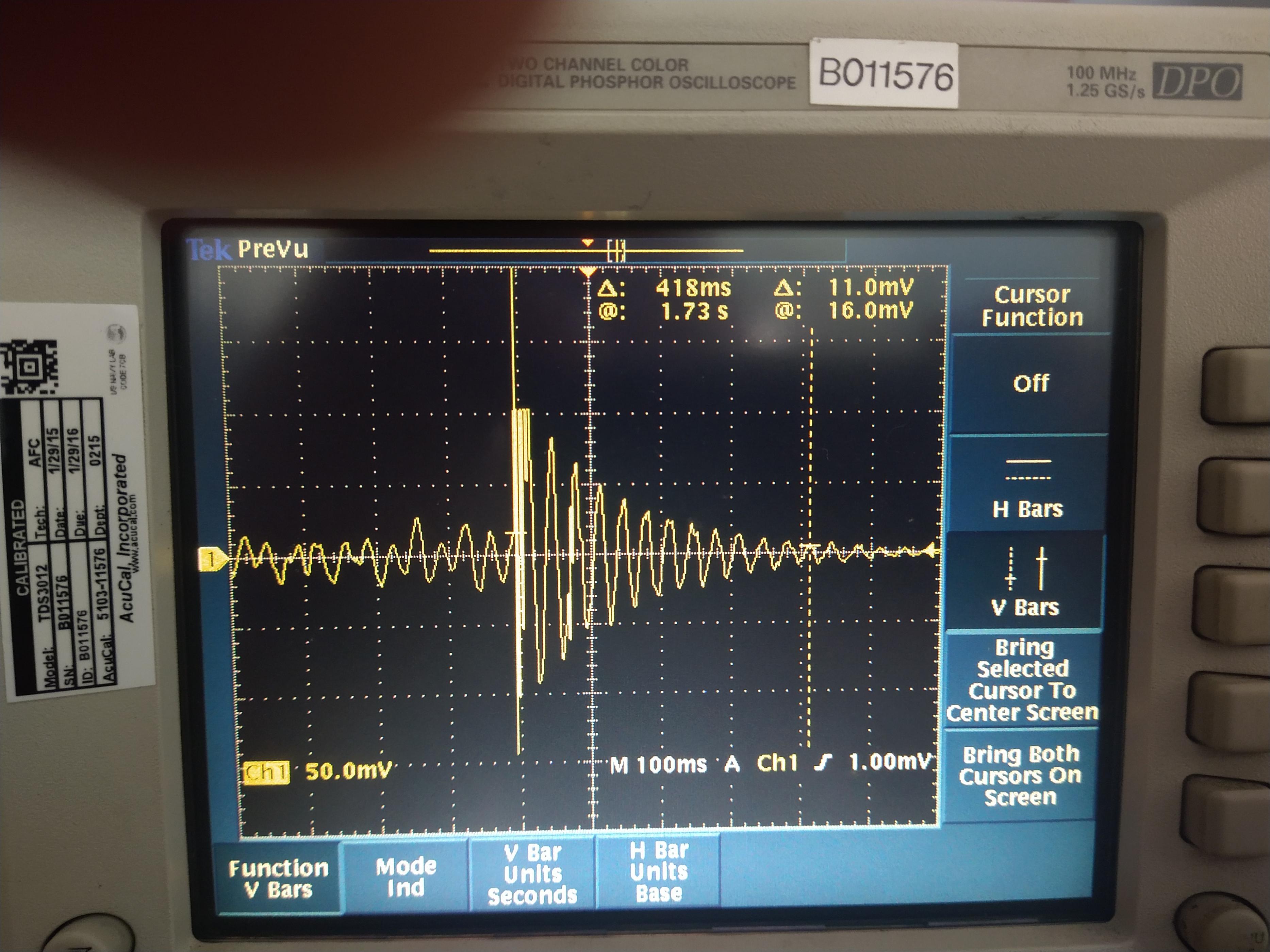

Here are some preliminary tests on my SP10. Stock chassis in a resin/bentonite plinth. I did this to set a baseline so when we do the measurements on Bon's TT I can also compare it to remote motor mount with his stock platter and mat. There are some variables note: Tonearm/Cart and phono-pre, but hopefully we can correct for these.
Methodology
Stylus resting in the groove of a stationary LP (an old LP)
6mm steel ball dropped from 300mm above the platter onto the edge of the LP.
Output taken from the Phono-pre.
First photo is the stock rubber mat.
Second photo is my acrylic mat with reflex clamp.
While the decay time is for all intent and purpose the same what differs significantly is the level of the initial shock.
