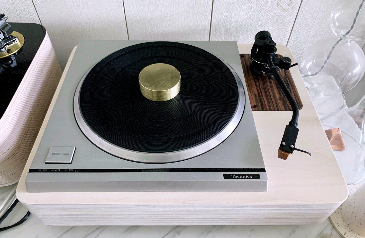

I’ve just finished putting this together.
SP10 MK2 deck, Phonomac Panzerholz Plinth, Puresound Tenuto Gunmetal mat, Fidelity Research FR64fx arm, Orsonic AV101s Headshell, Hana ML cartridge, Bigbottle Audio Spotfire cable.

Beautiful! However the FX version of the FR64 is a lot different in sound character to the 'S' version. I have had both - but I tend toward very low compliance cartridges. Also, unless you need really minimal mass, the flat FR headshells are far more rigid even if a lot plainer to look at. 🙂
How does it sound to you and was it worth all of the effort?

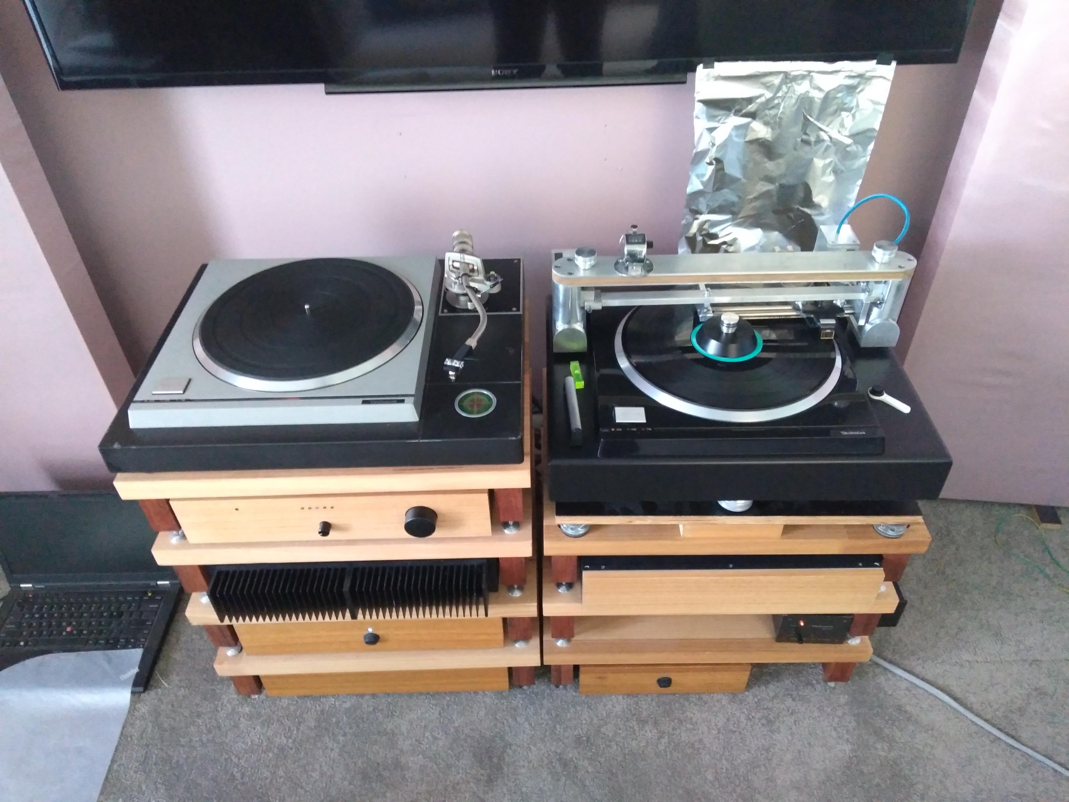

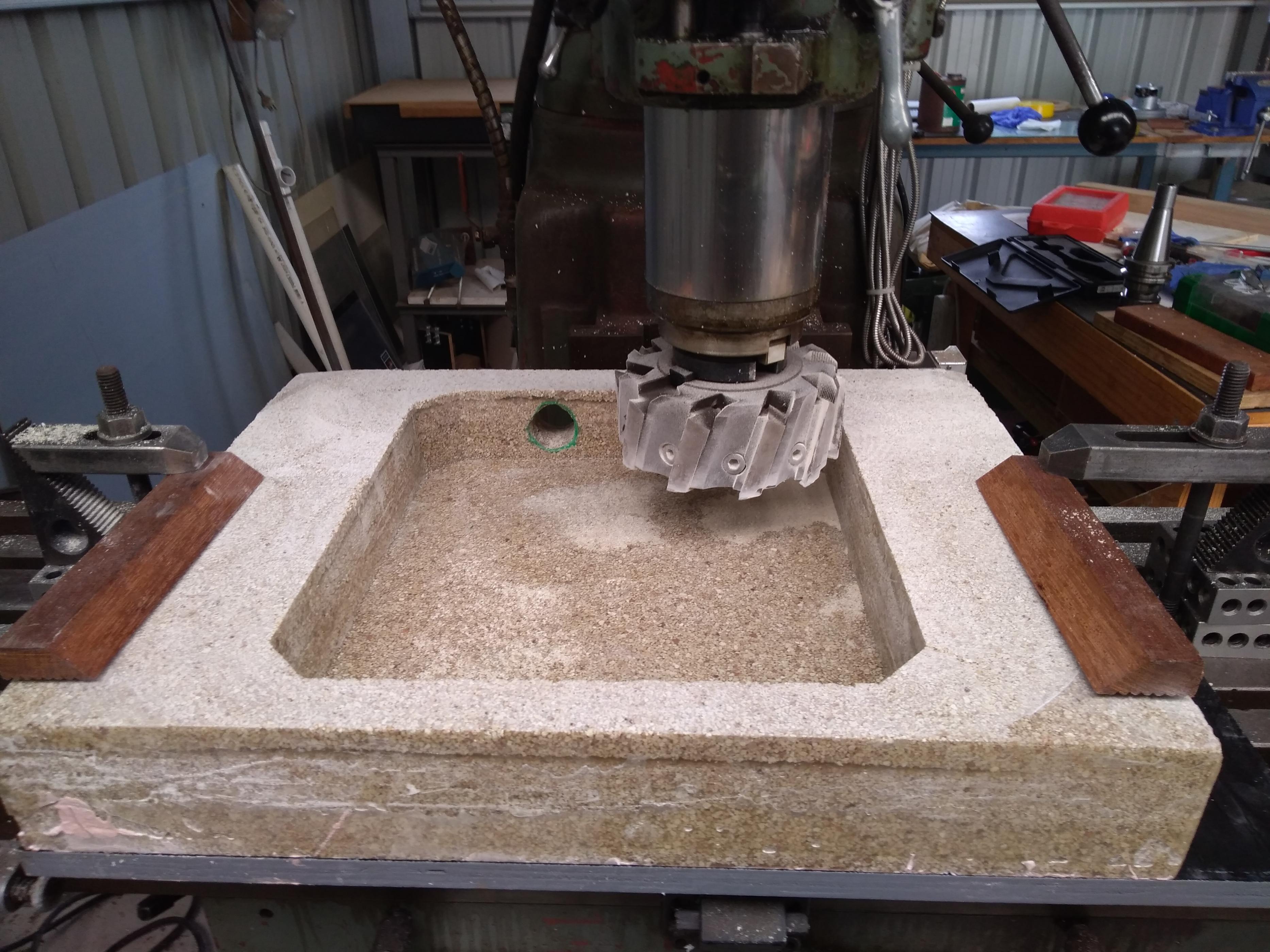

I made my plinth from resin/bentonite, the one on the right. The one on the left is a commercial plinth, still some kind of resin with a solid lead arm board. They both sound very good, although the one with the linear arm is 5 steps in front of the other with the EPA100 even though it still has a few issues to solve.

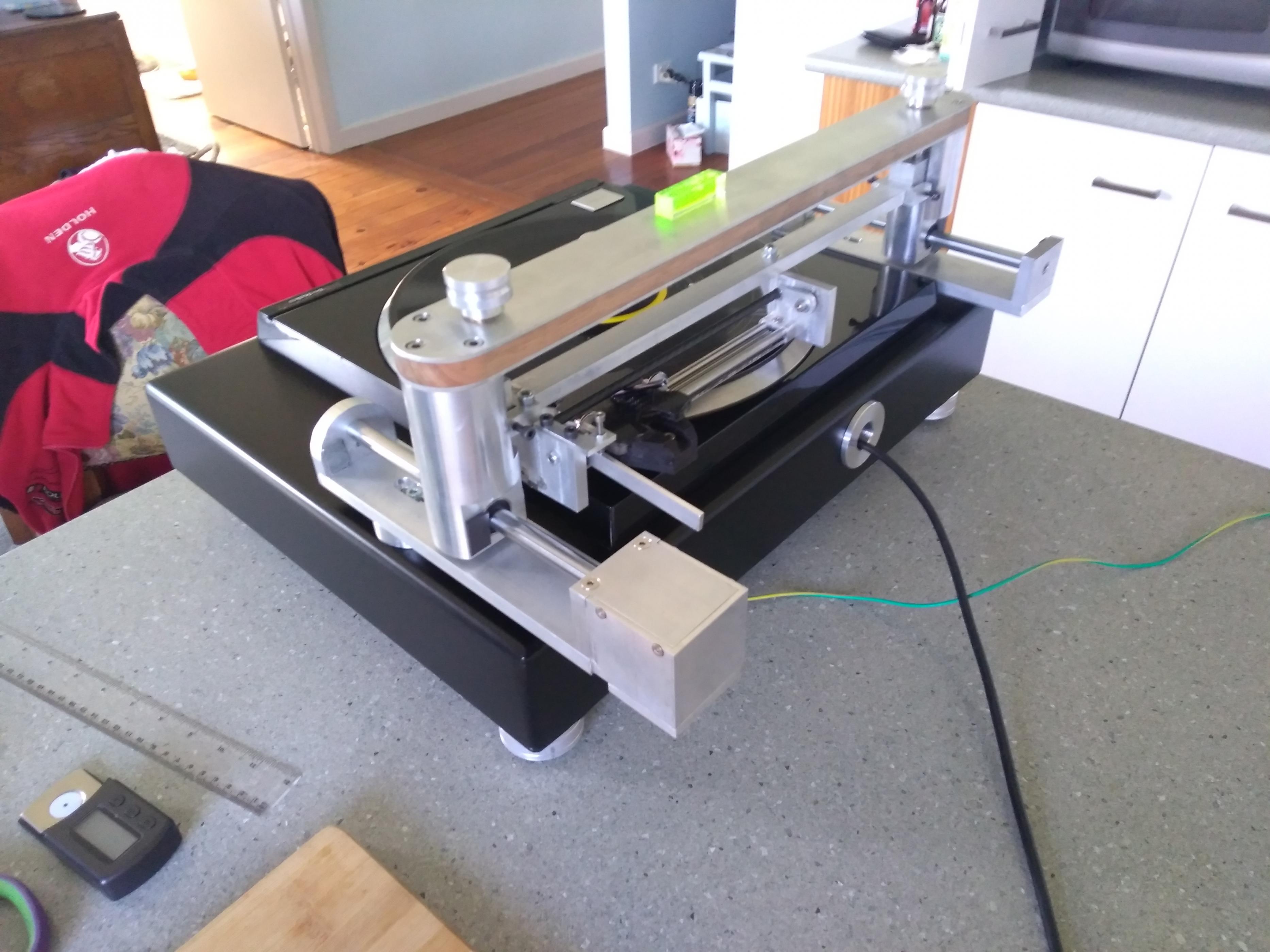

Do you have more and closer-up pictures? It looks interesting -- probably demanding of its own thread.
Hi Brian,
I assume you mean me. There are a few photos over on the DIY Linear tonearm thread.
Plinth was made the same way Bon made his (earlier in this thread) except I covered the whole plinth in fiberglass mat and then black gelcoat to smooth it as the bentonite tends to fall out and cause pock marks.

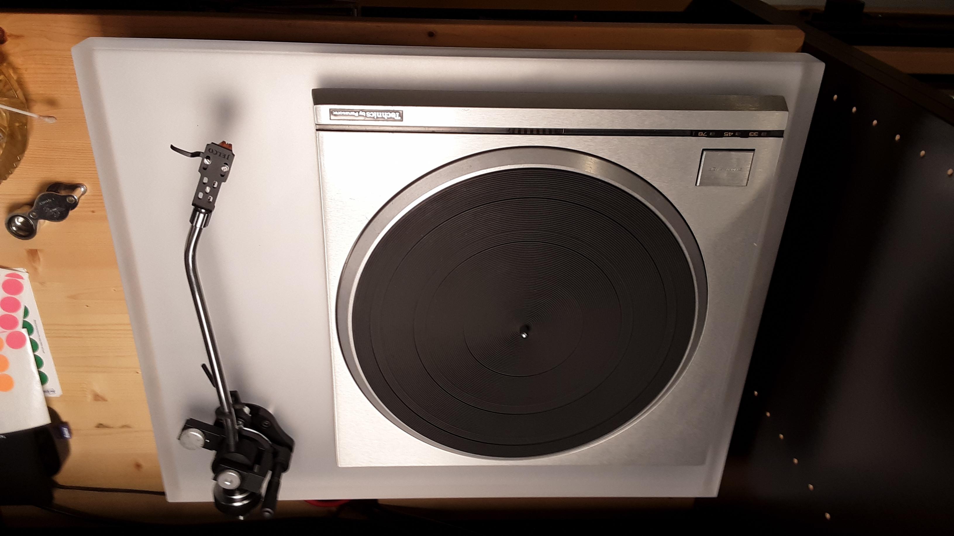

Well, I've got my SP-10MK2 completed. My inital post is here: The Incredible Technics SP-10 Thread
My apologies to 6L6, consider the complaint null and void...
I end up doing a full re-cap job on the deck and psu. I also replaced the bearing and went through the readjustment procedure. I really should have taken some in-progress pics. Everything went relatively smoothly that by the time I thought to take pictures, the deck was already back together.
The only issue I ran into was undoing a mod to make it compatible with the mixing deck used at the radio station. I had replaced IC8 with a 74LS73. I kept having weird start/stop switch de-bounce issues. I end up scavenging an old non LS series chip that worked flawlessly.
The new plinth is made from a 1.25" thick pane of Lexan. Instead of polishing out all the scratches, it was frosted instead. I think the frosted appearance looked better in the end anyways.
I am using a Jelco TS-550L. While a 10" arm would probably be better, I went with a 12" arm. Since I wasn't able to get a 10", and a 9" would be too short.
Sadly it looks like Jelco have decided to call it quits. From my research, Jelco definitely had best price to performance.
I also decided against refinishing the SP-10. While it would certainly look nicer, it would also erase some of it's history. I find it somewhat cool to see the thousands of missed needle drops made over the years. From the wear you can tell this deck outlived at least three different tonearms.

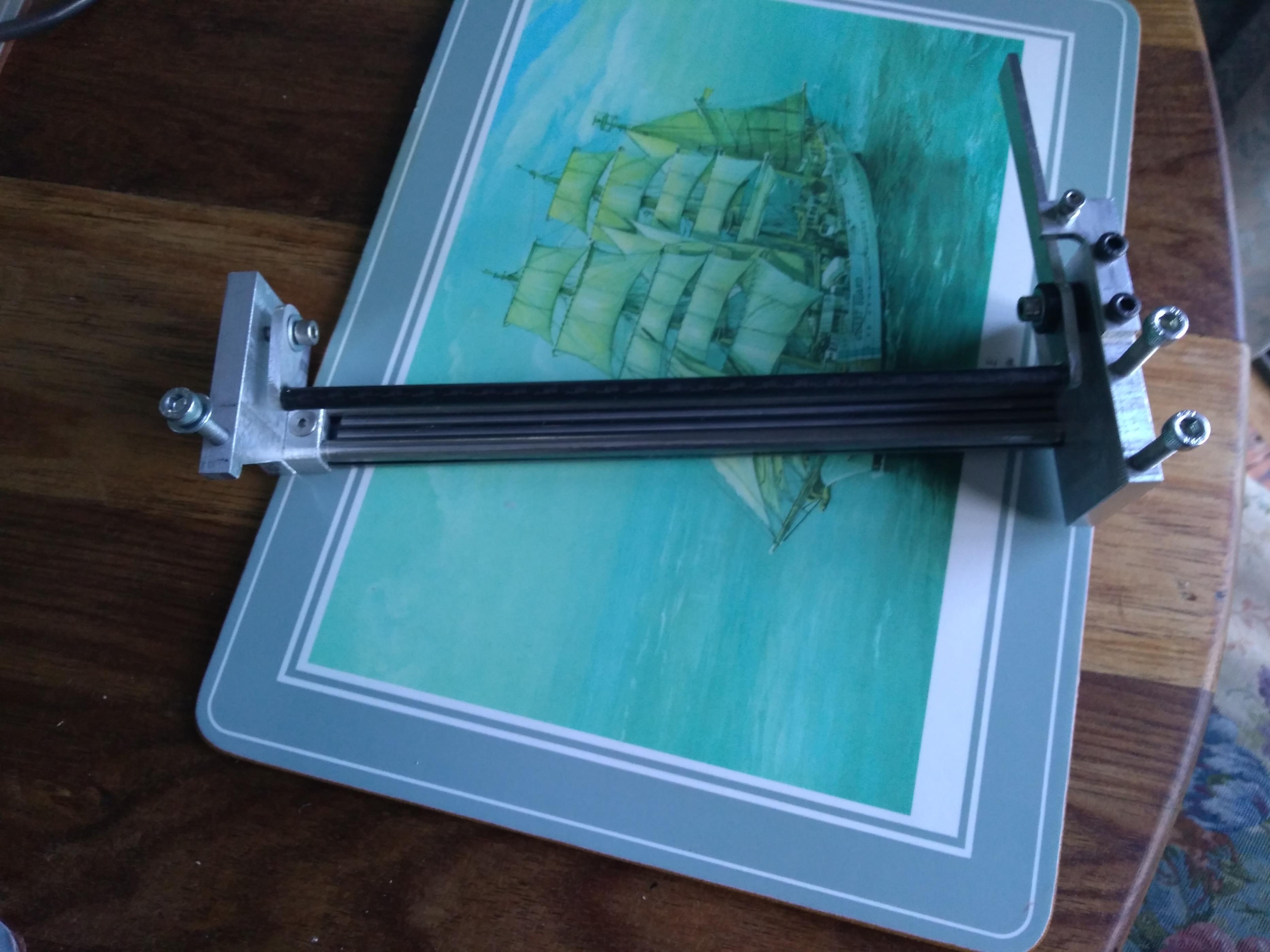

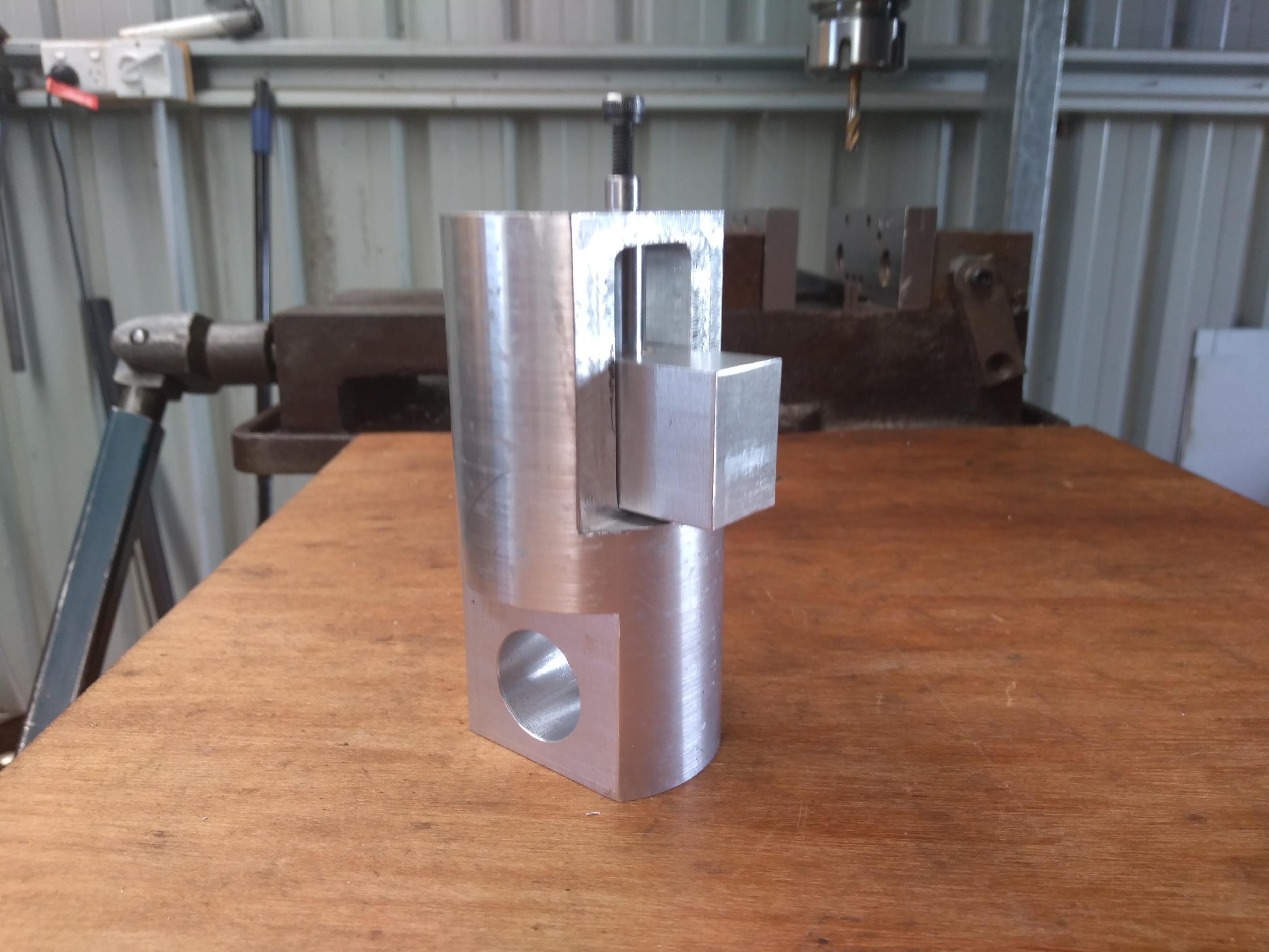

Hi Brian,

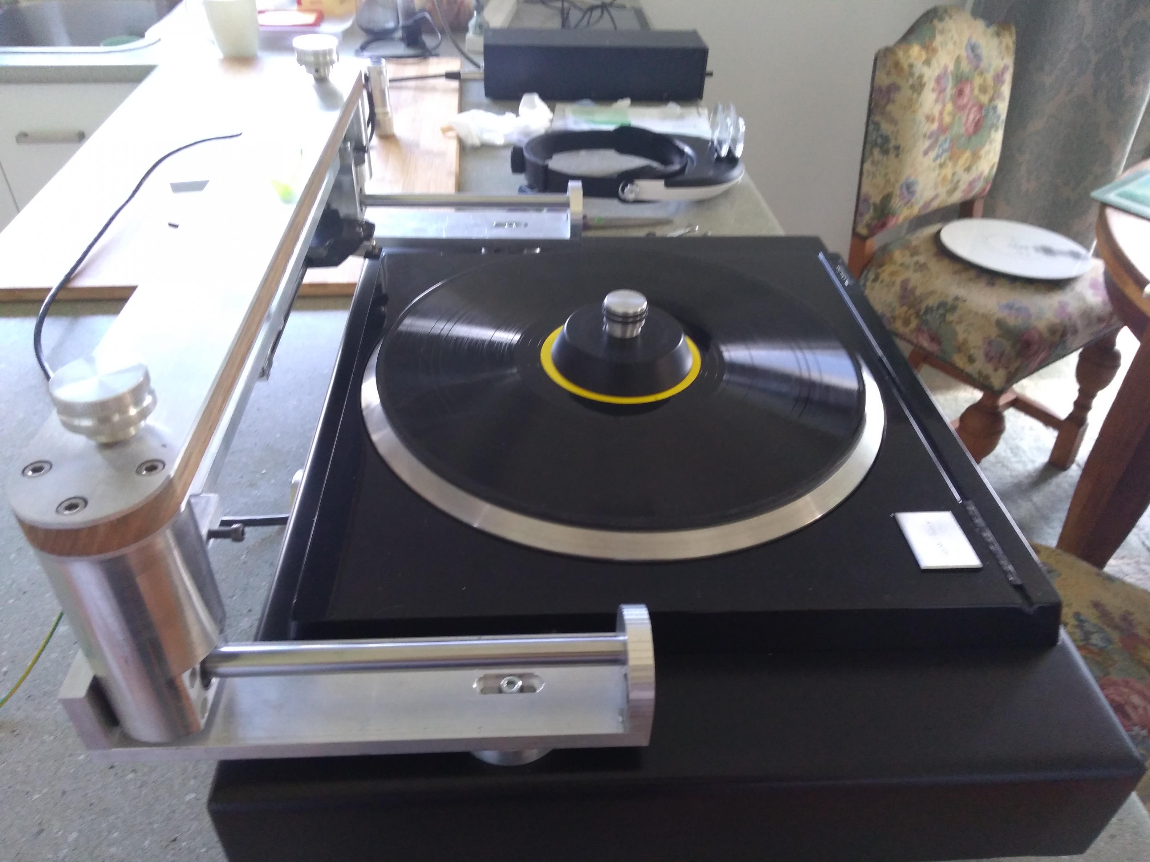

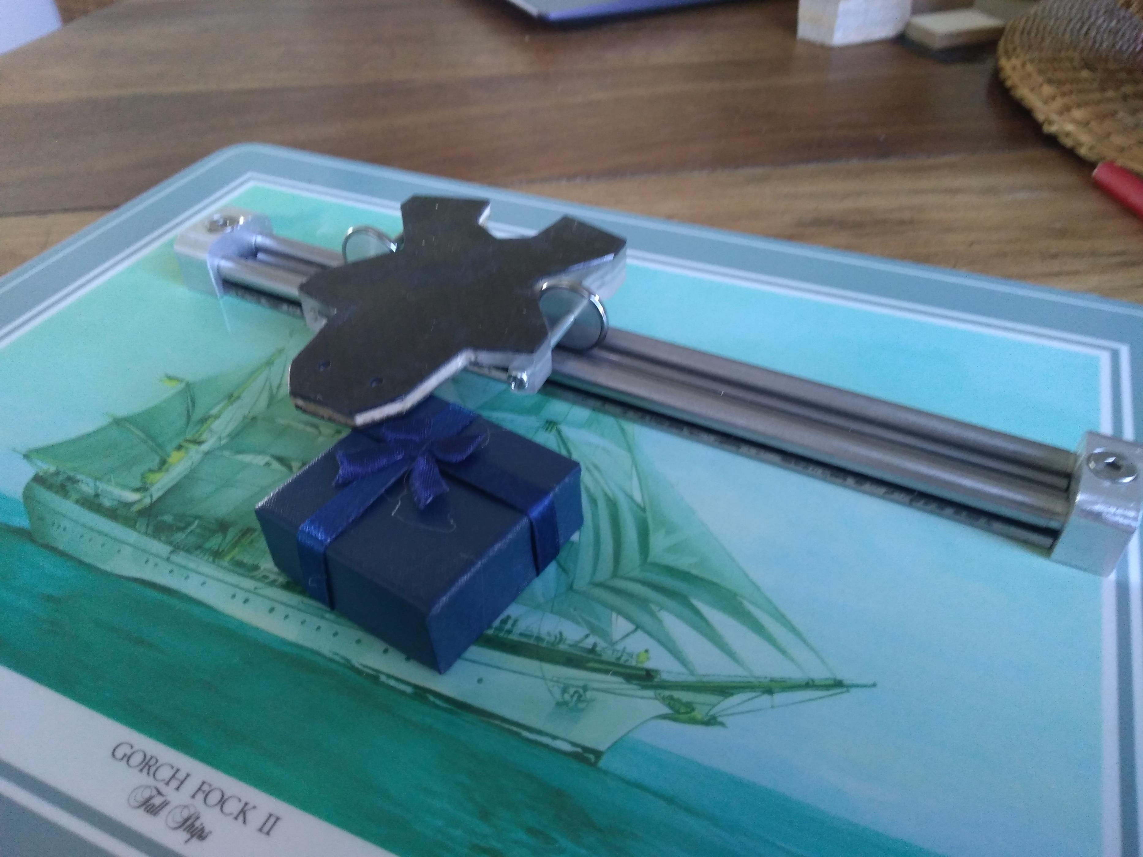

Here are few pics of the build.

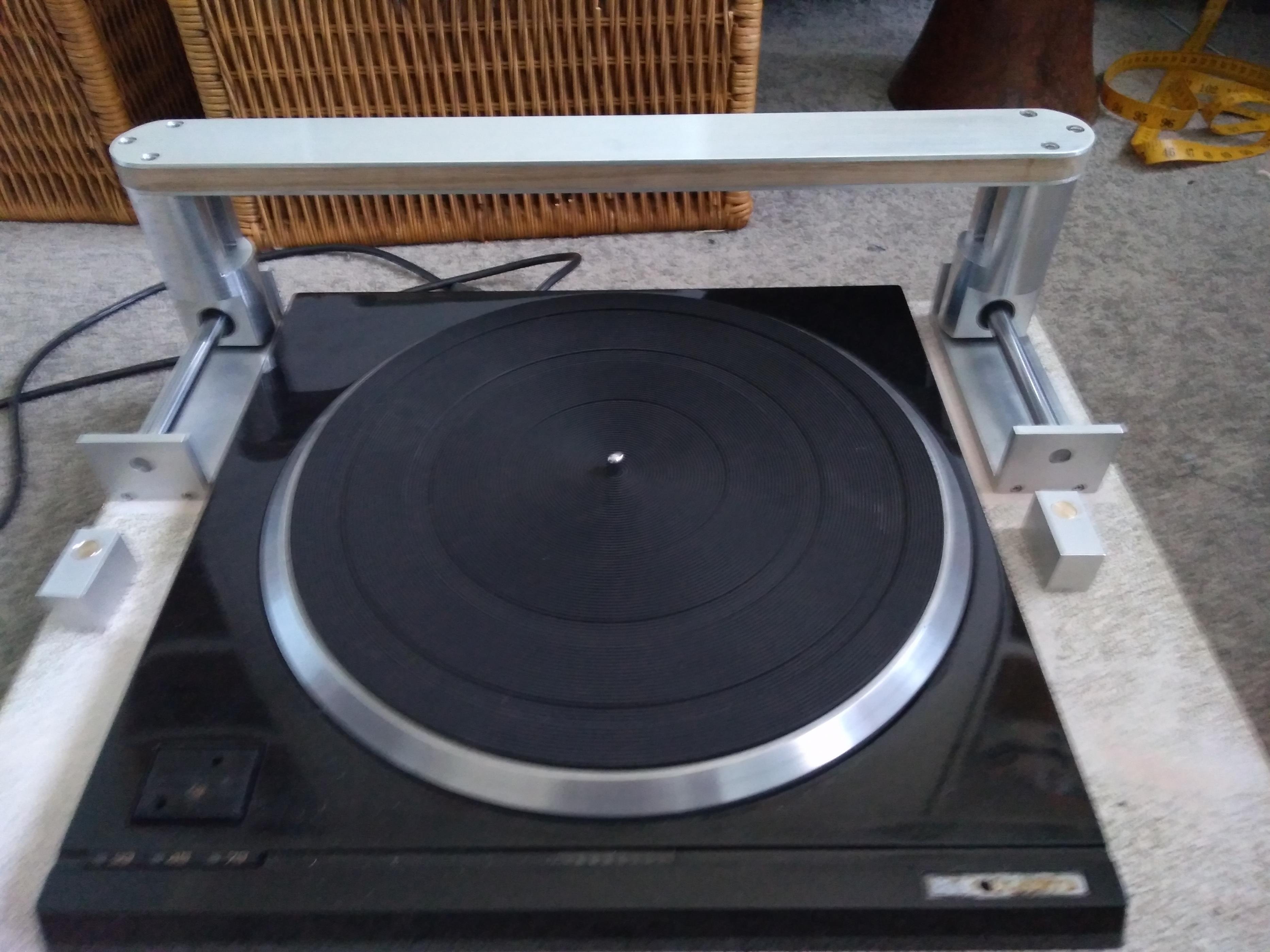

The bridge was designed so I could change rails to different style if needed. The uprights have blocks with brass inserts running on 8mm linear shaft and are individually height adjustable.
The rail support is held to the blocks with m4 bolts that have 60deg points that hold in brass Vees. This allows a small amount of forward aft movement to fine tune the rail for tangent and a pivot that can be locked tight to enable to rail to pivot for leveling.

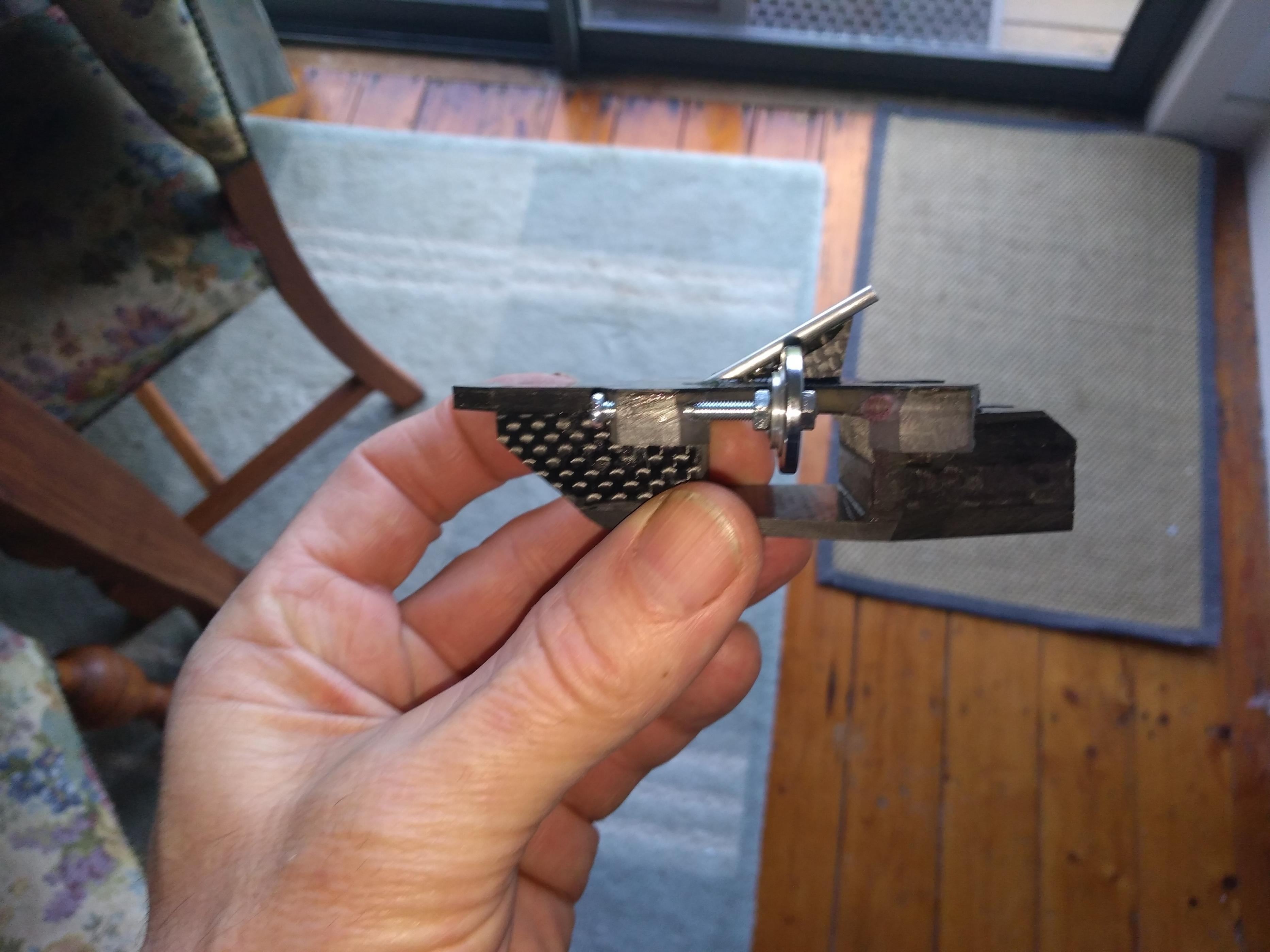

The carriage wheels are 1 piece aluminium with 2mm carbide wedding rings as tyres. It now uses Vee pivots the axles are made from 1.5mm drills with a 0.1mm radius and the Vees are m3 cup head grub screws that have a 0.5mm radius. The Vee's were forged in the grub screw with another drill ground to the correct radius.

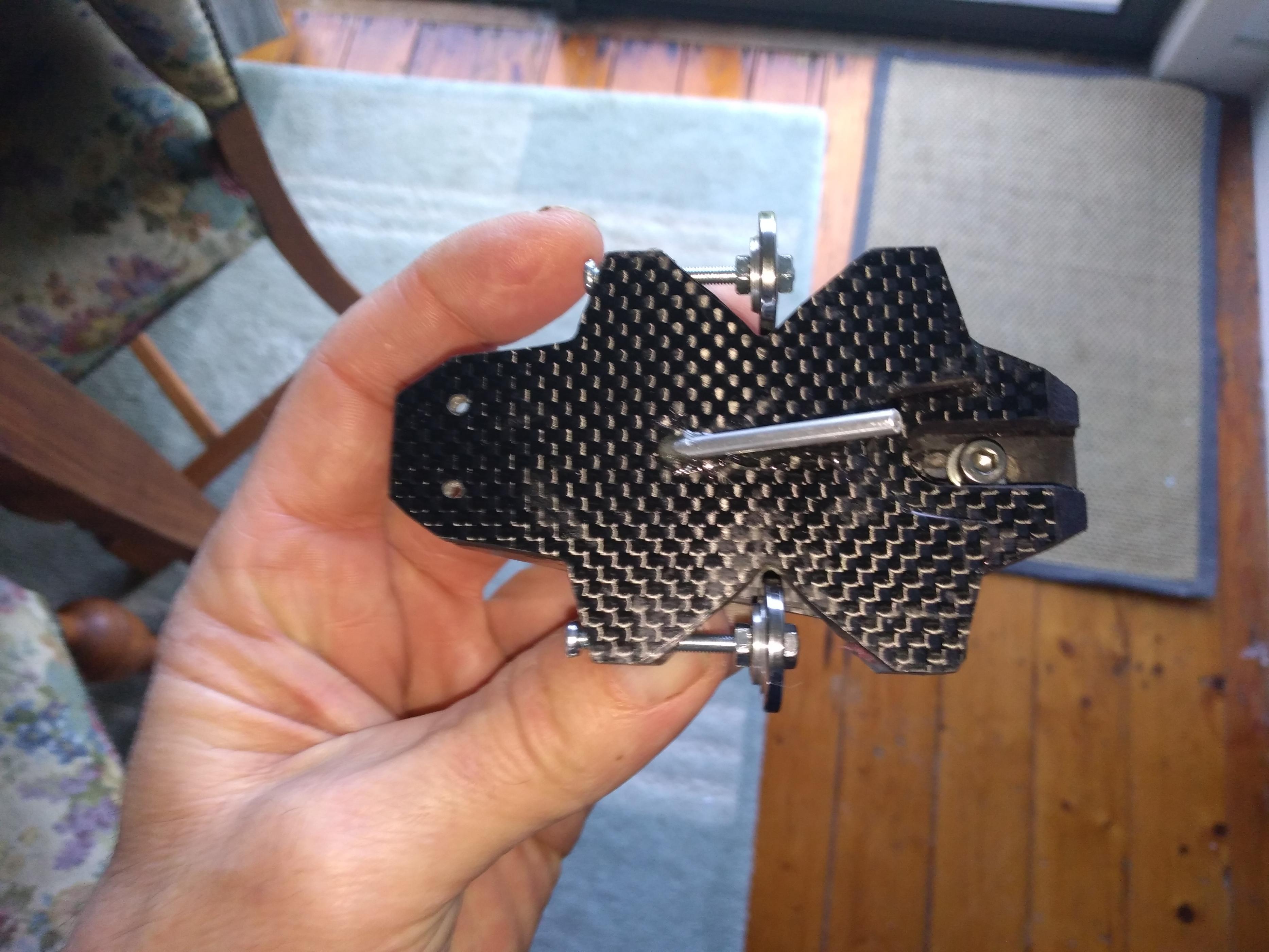

The carriage is a copy of the one Niffy made and is carbon fibre/balsa composite.
How does it sound OMG I have never heard vinyl sound so quiet, background noise (stylus in groove) is extremely low, and clicks and pops are almost a thing of the past. Not quite digital quiet but the closest I've heard.
I summed this up in a few words - Bass response, dynamics and eerily quiet.
Is it perfect - No I still have some distortion on inner groove with some female voices, I'm working on this.
