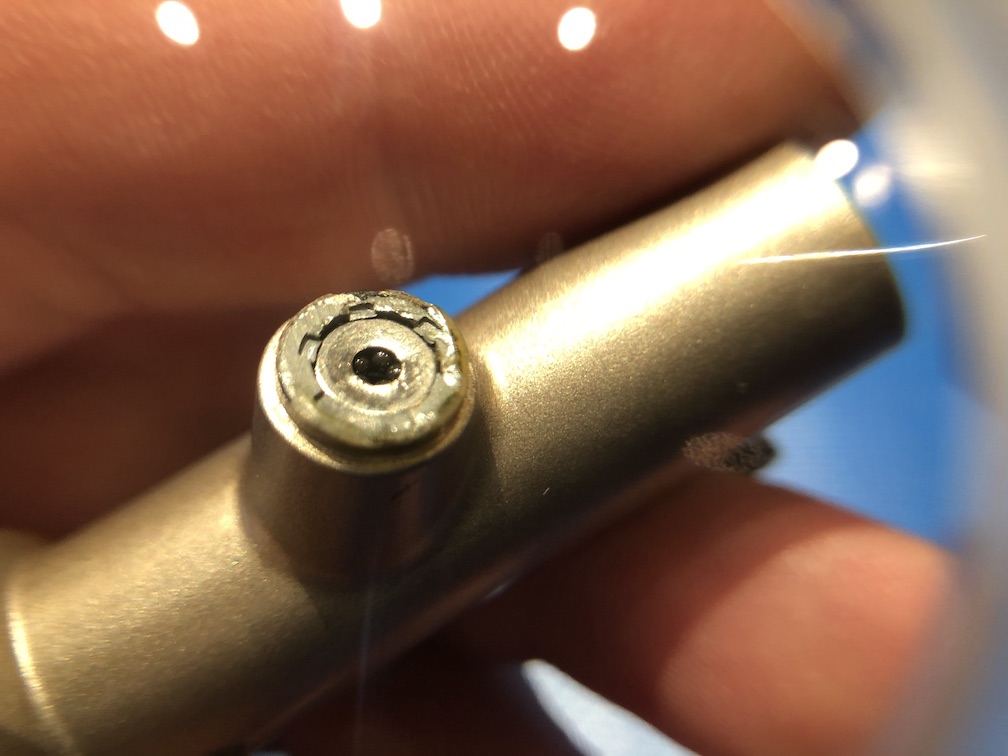

Those balls are 1.19mm in dia. Up for that?
So the original ruby bearing balls are 1.19mm? I have an EPA 100 mk2 that probably needs new bearings, and I have ordered 1.3, 1.4 and 1.5 mm silicone nitride balls after finding an old thread at audiokarma.org where the OP claims the original bearing balls are 1.4mm in diameter. I even emailed the guy, and he confirmed the size. Should I order 1.2 mm too? Could I ask where you sourced the 1.19 mm balls?
As Mark said they are 3/64". I converted to metric for illustrative purposes for Anthony. 3/64 IN-C SI3N4 BALL GRADE 5 (1 PC) by Boca Bearings :: Ceramic Bearing Specialists
Thanks a lot!

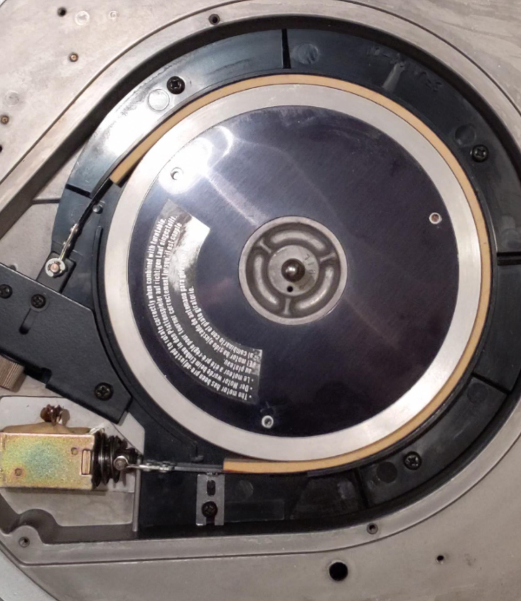

Any thoughts on how to shrink a swollen break felt band for the Sp-10mk2? It's way too thick and touches the motor assembly constantly. See attached picture.
Dremel and small barrel/drum sander.
