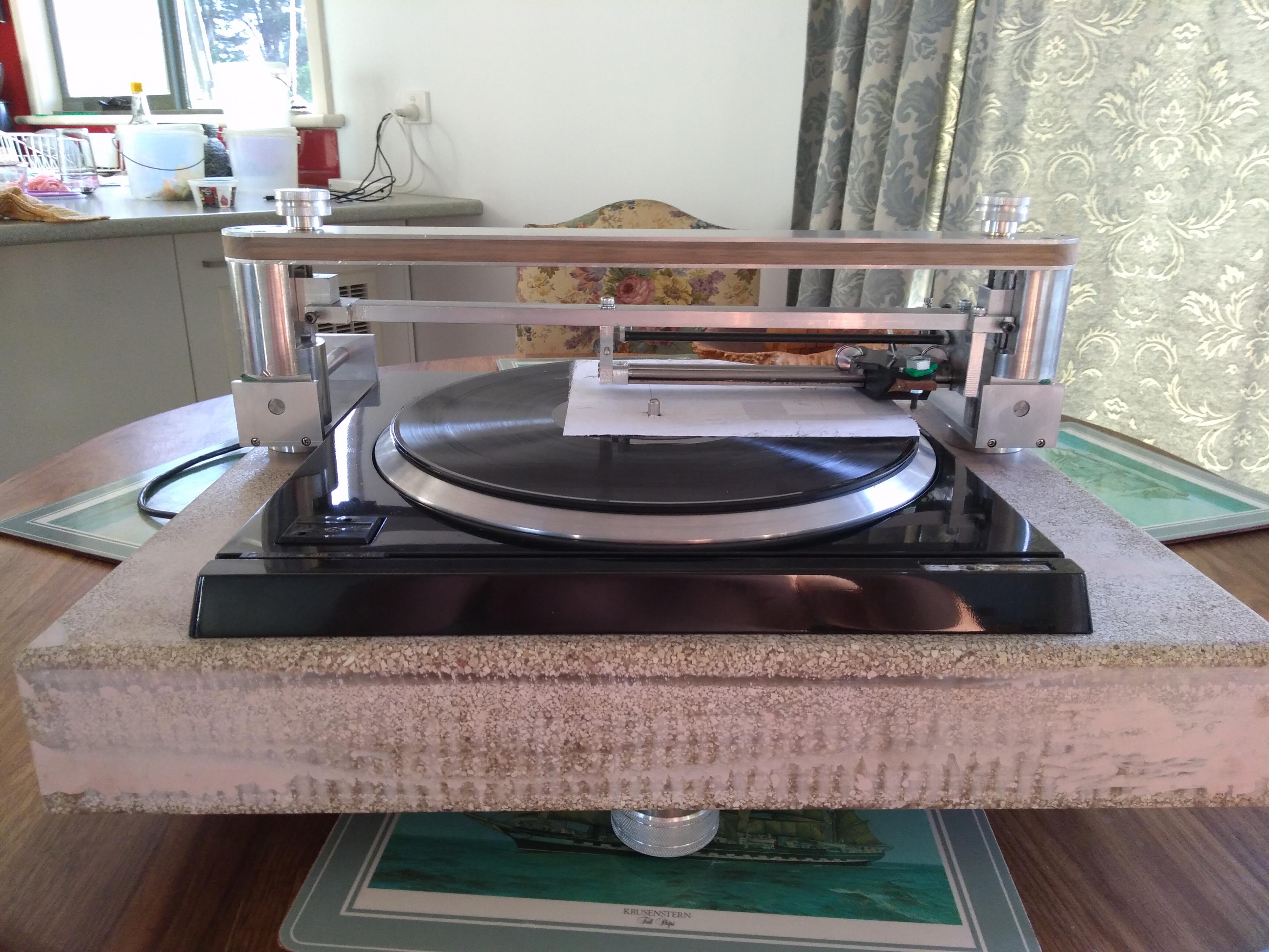

After hearing what the linear can do I would never go back to a pivoted arm. The short extremely stiff arm wand is what it's all about not the tracking error.
My current the linear arm reduced surface noise on one of my noisiest LP significantly.
Even my first linear made mostly from the scrap bin sounded better than my EPA100 in a back to back, bass response was most noticeable.
Yes VTF is same as pivot arm although setting VTF on a bearing style LT arm is a little more fiddly as VTF will vary with friction of bearing on rail.
Start reading here for a simple arm. This is the same as the first one I built and works very well for the input and cost. Bearings are important I originally used general bearings and removed the grease 693ZZ will work. I used MR104 then went to AEBC9 for an Abu Garcia finishing reel.

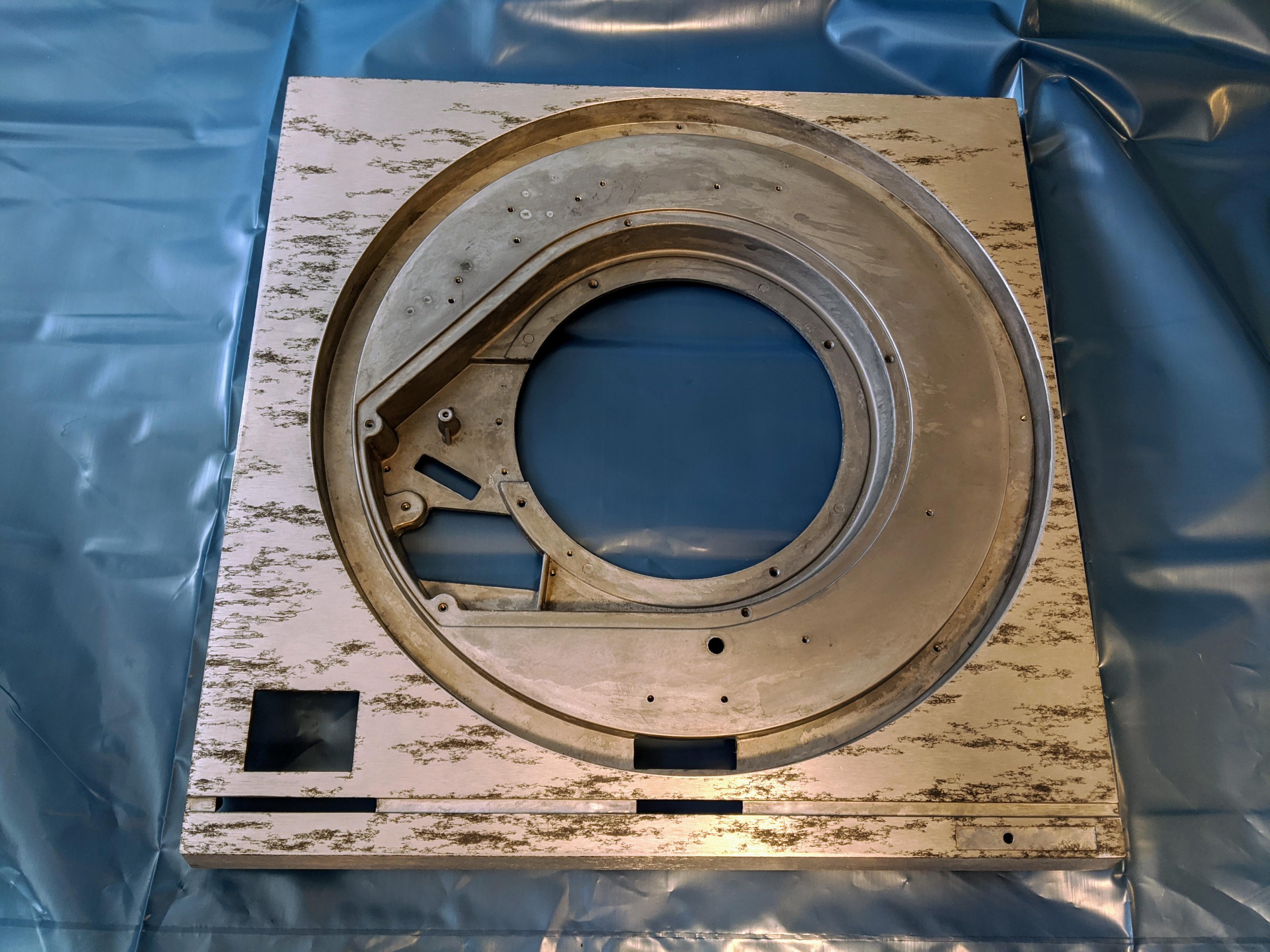

The break belt player is a mild disaster, cosmetically. It looked like it was painted by my dog, blindfolded. My dog is talented, but painting is not her strength. Eating my shoes on the other hand... Here she is, after eating my shoes. No sign of remorse.
attachment.php

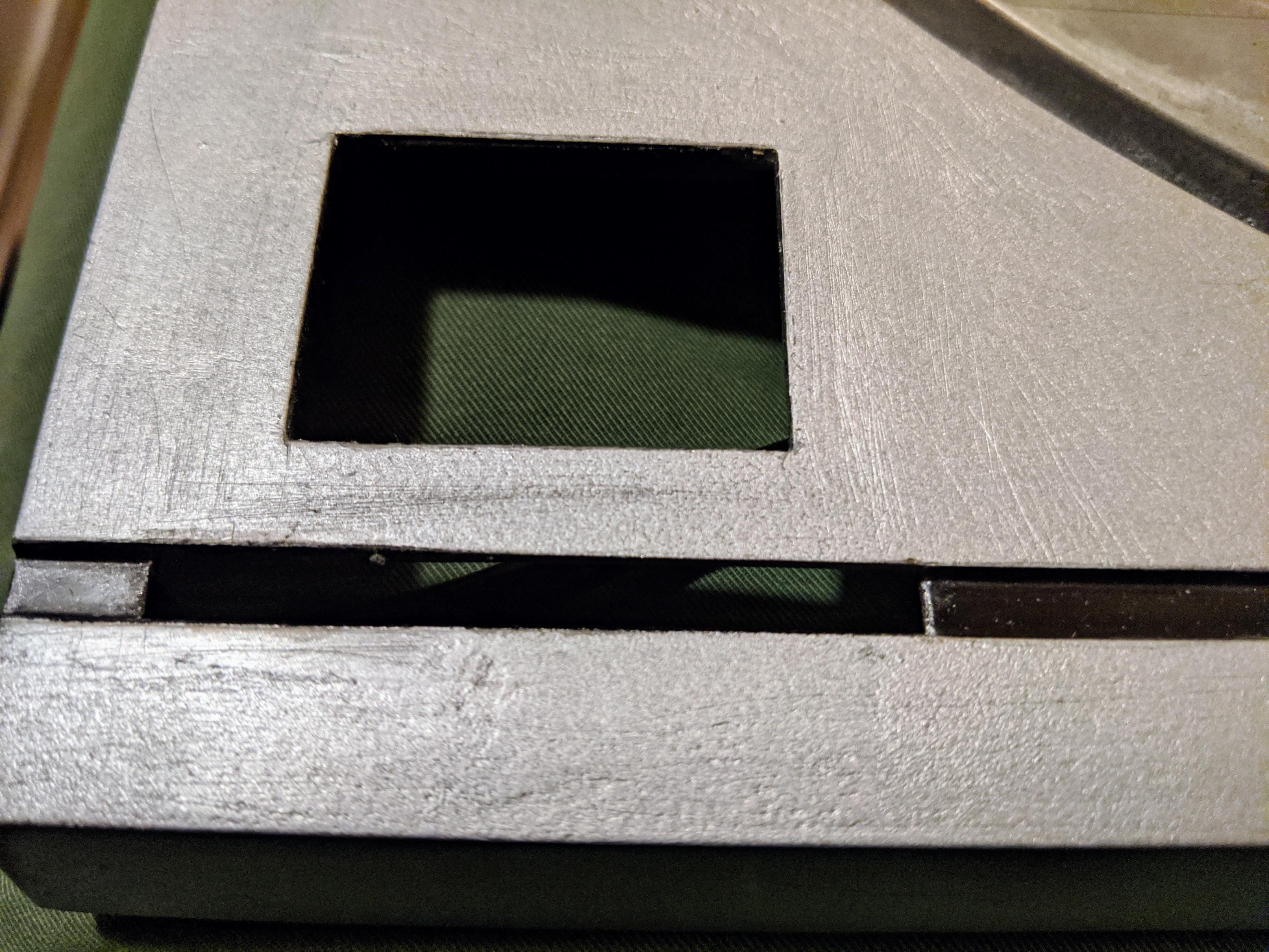

And here's a close up of the paint job
attachment.php
After serveral days of soaking in the most eco friendly and ineffective paint remover I could find, I understand why it was painted in the first place.
attachment.php
The oxidation of the aluminum is, as you can see, quite bad. I would like to keep the original finish, but I'm not sure I'll be able to find someone who can replicate the original finish way up north in Norway. Should I just get it powder coated and call it a day, or is there an ultimate trick on how to restore the turntable to its former glory?
Very bad...
you should brush it by hand to bring it back to the origin because the finishing you see in the photo and disappeared, after brushed you need the final finish with the transparent matte varnish as in origin.

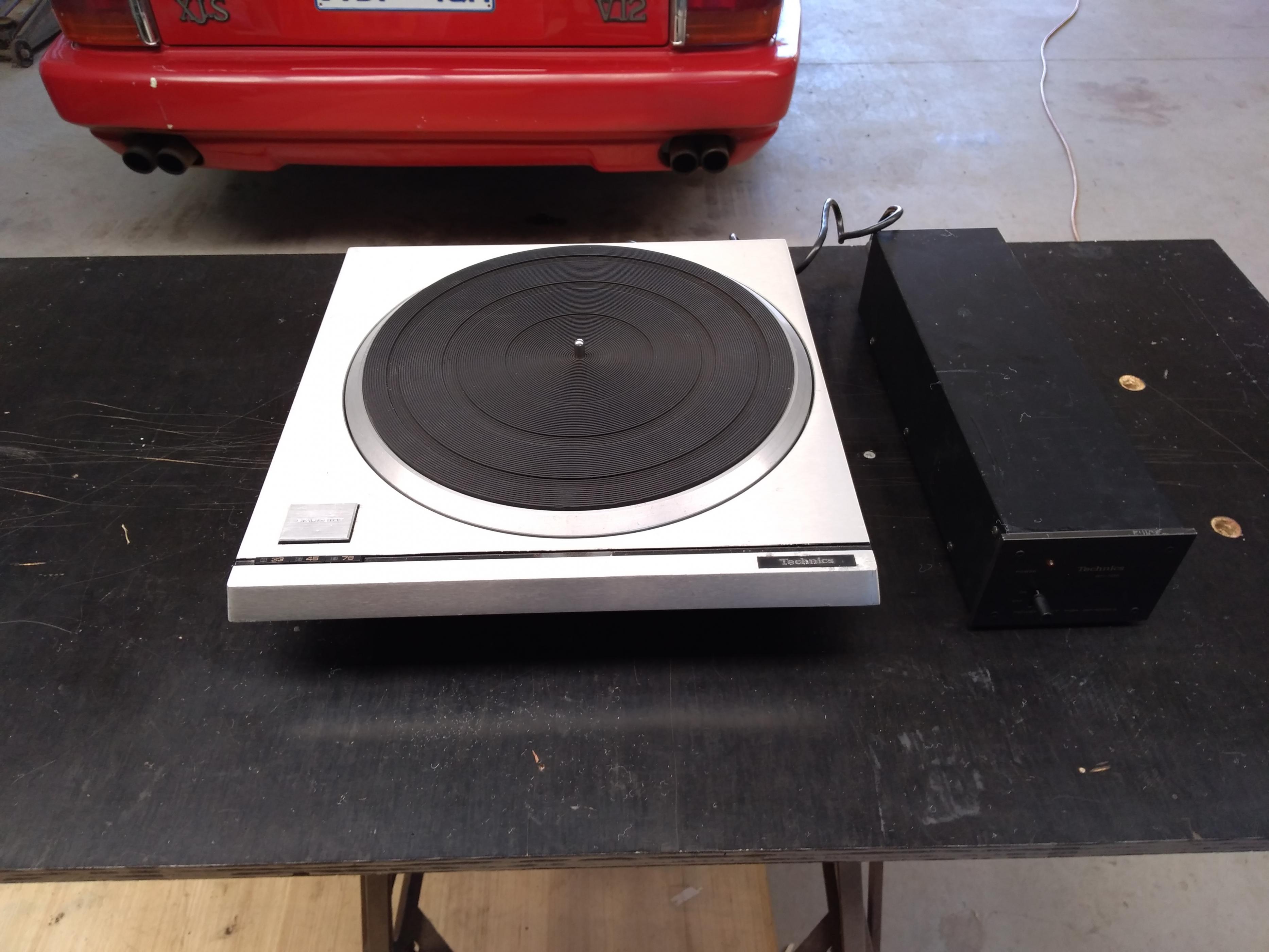

My SP10 was in ok condition cosmetically except for the dents in the start/stop switch because the DJ at the radio station it came from used a stick to start and stop the TT. When I received it it did not work correctly, all fixed now.

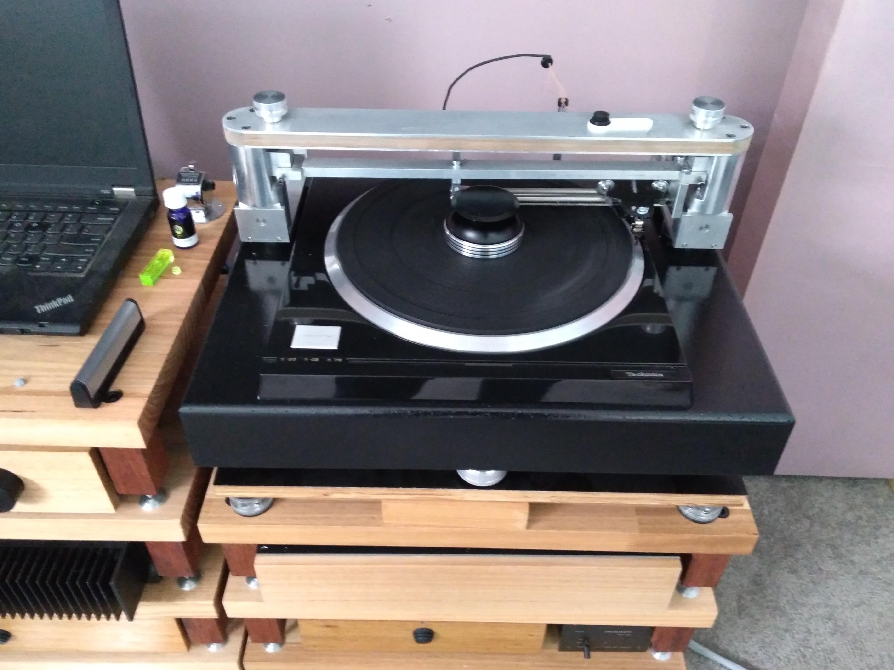

I went a slightly different route, painting the SP10 black. I didn't use any stripper just sanded the chassis with 120grit, primed sanded with 600 wet&dry then some left over chassis black from painting the car.
If you sand it and clean well with a wax and grease remover designed for automotive painting and use an etch primer it should be ok. I used a spray can of etch and surface primer then used a spray gun only for the black but you could spray it with a can if you do many very light coats.
