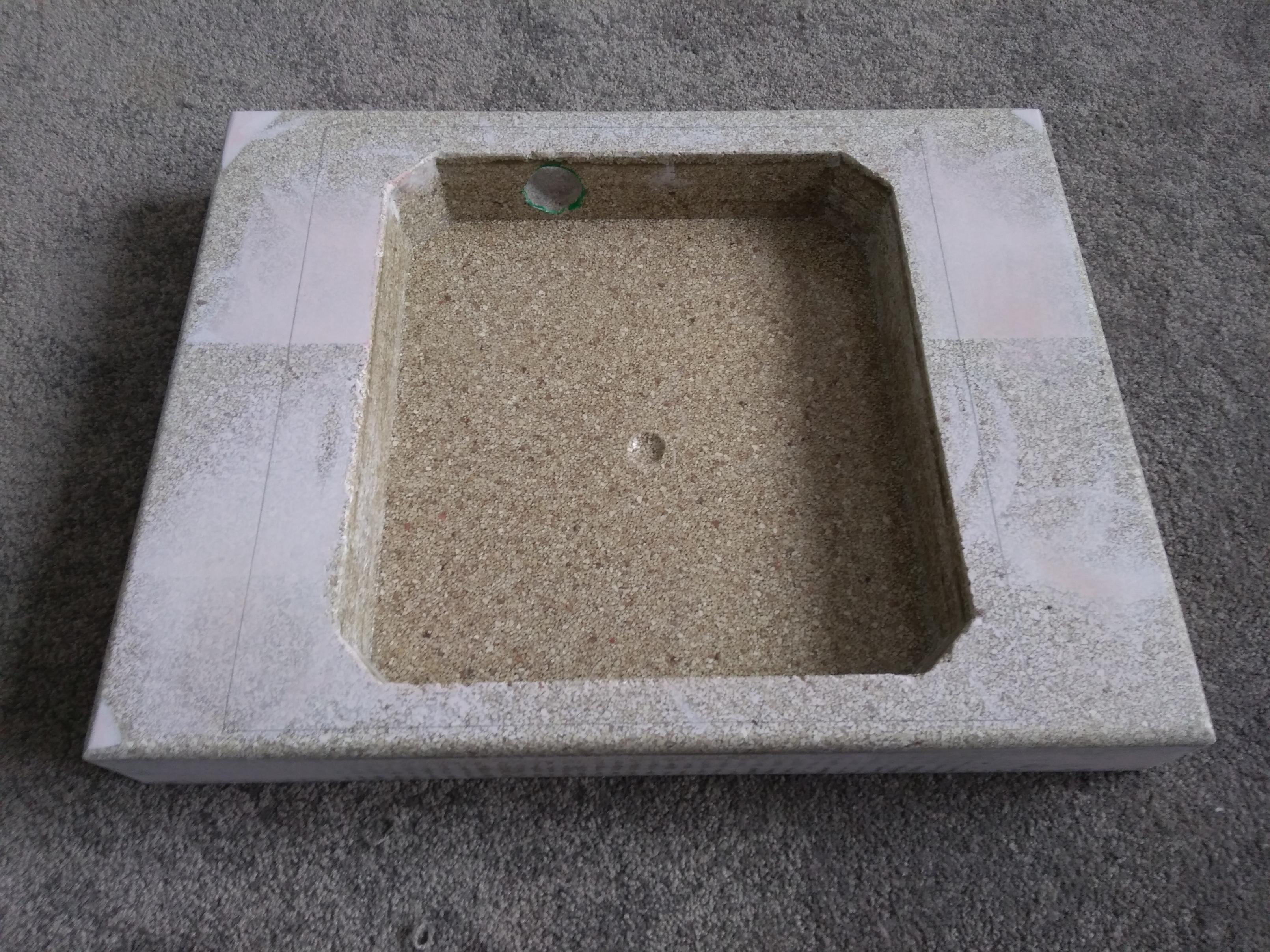

Just use lead or heavy construction to get plinth + TT 20+ kg. Heavy makes a significant and positive benefit.
My take on that is anything that can transfer vibration will be bidirectional, so my plinth does not have the sink. IMO the SP10 bearing is very good. Just clean it out and install a new thrust pad and ball if needed, oh and new oil.
If you want a great plinth build it from resin and bentonite (kitty litter). My other SP 10 has a resin plinth and it sounds great, absolutely blows a Rega RP8/Apheta 2 into last century.

And that is exactly what the resin bentonite plinth is. I haven't got bathroom scales but this plinth is over 20kg.

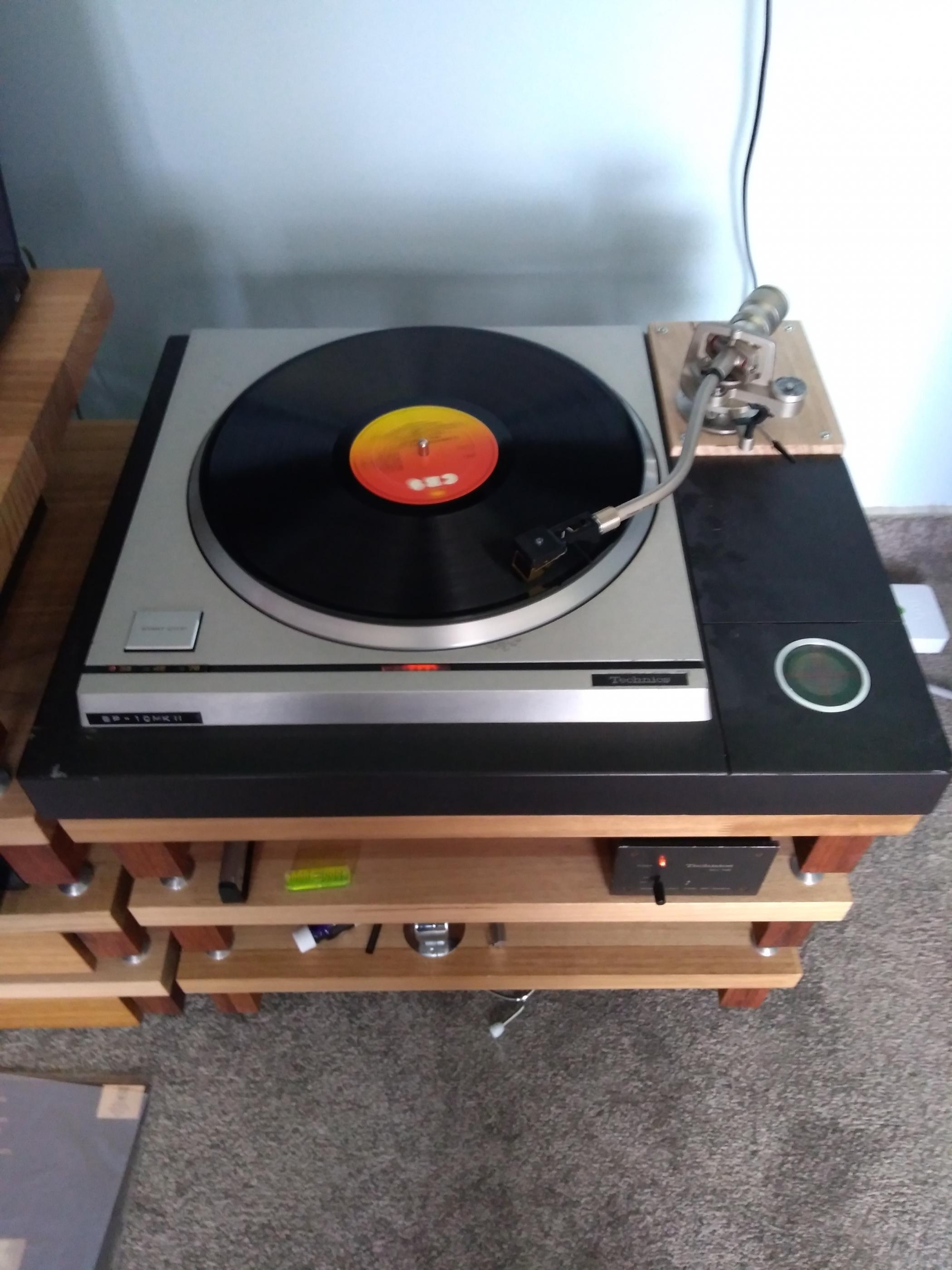

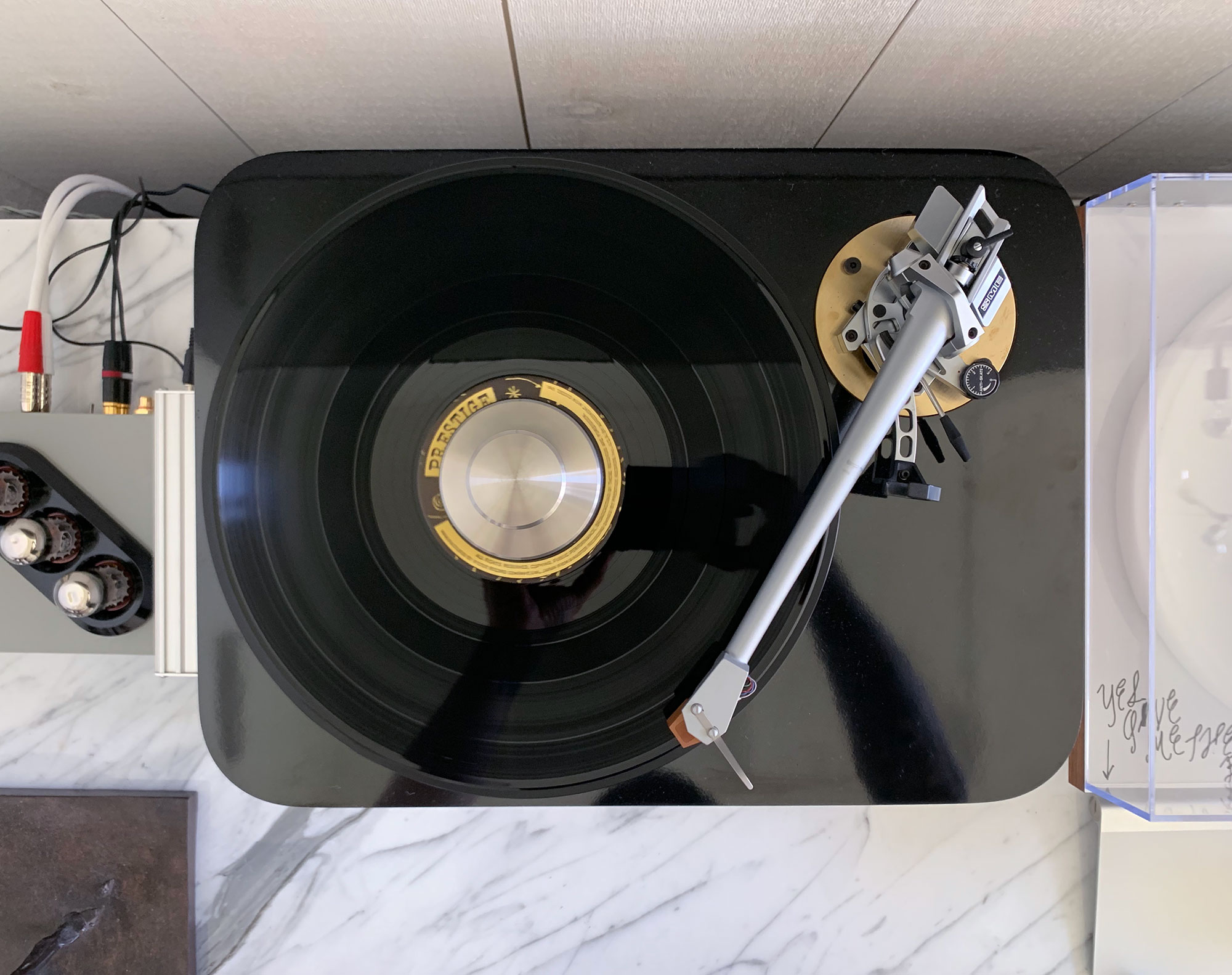

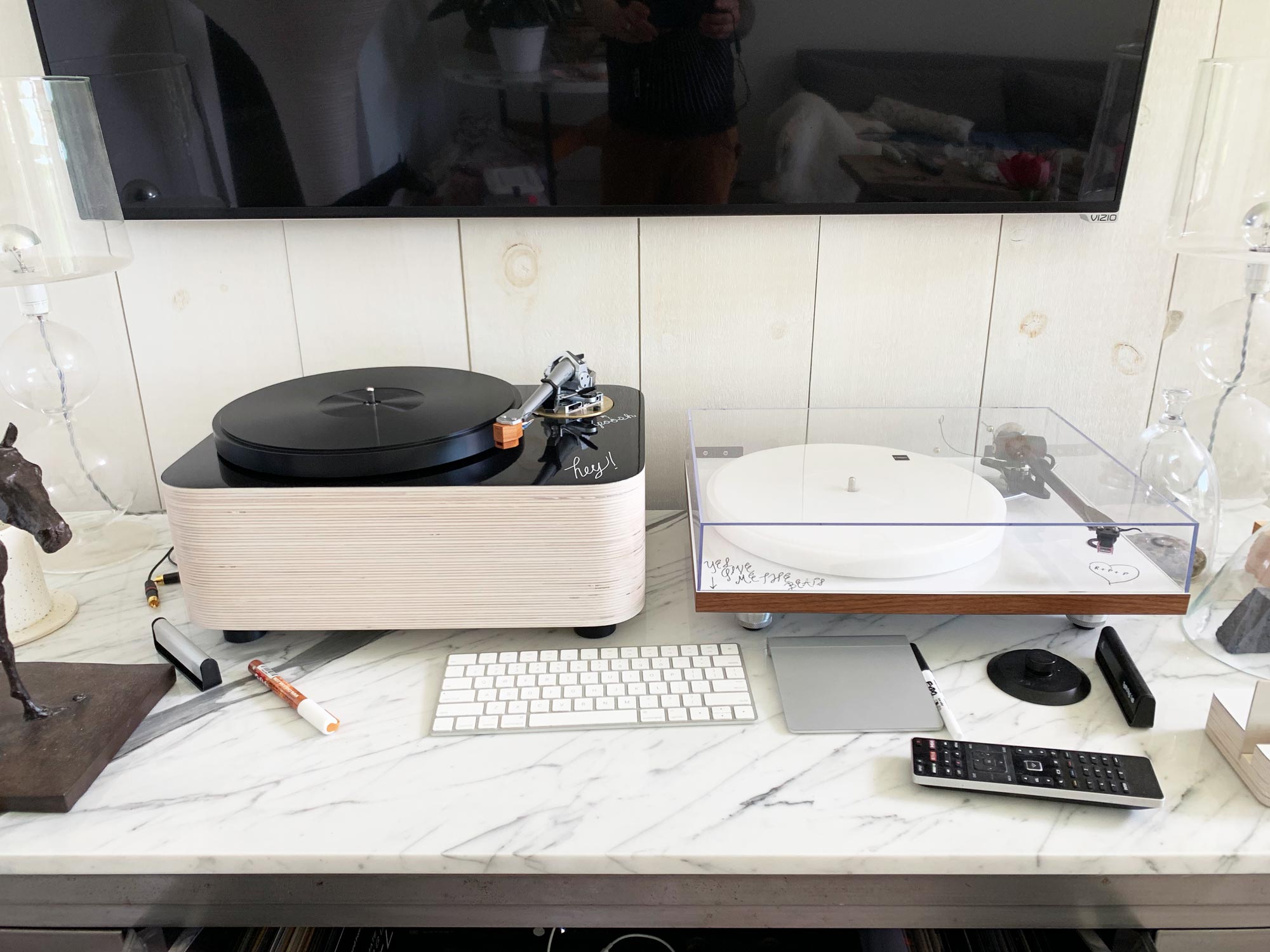

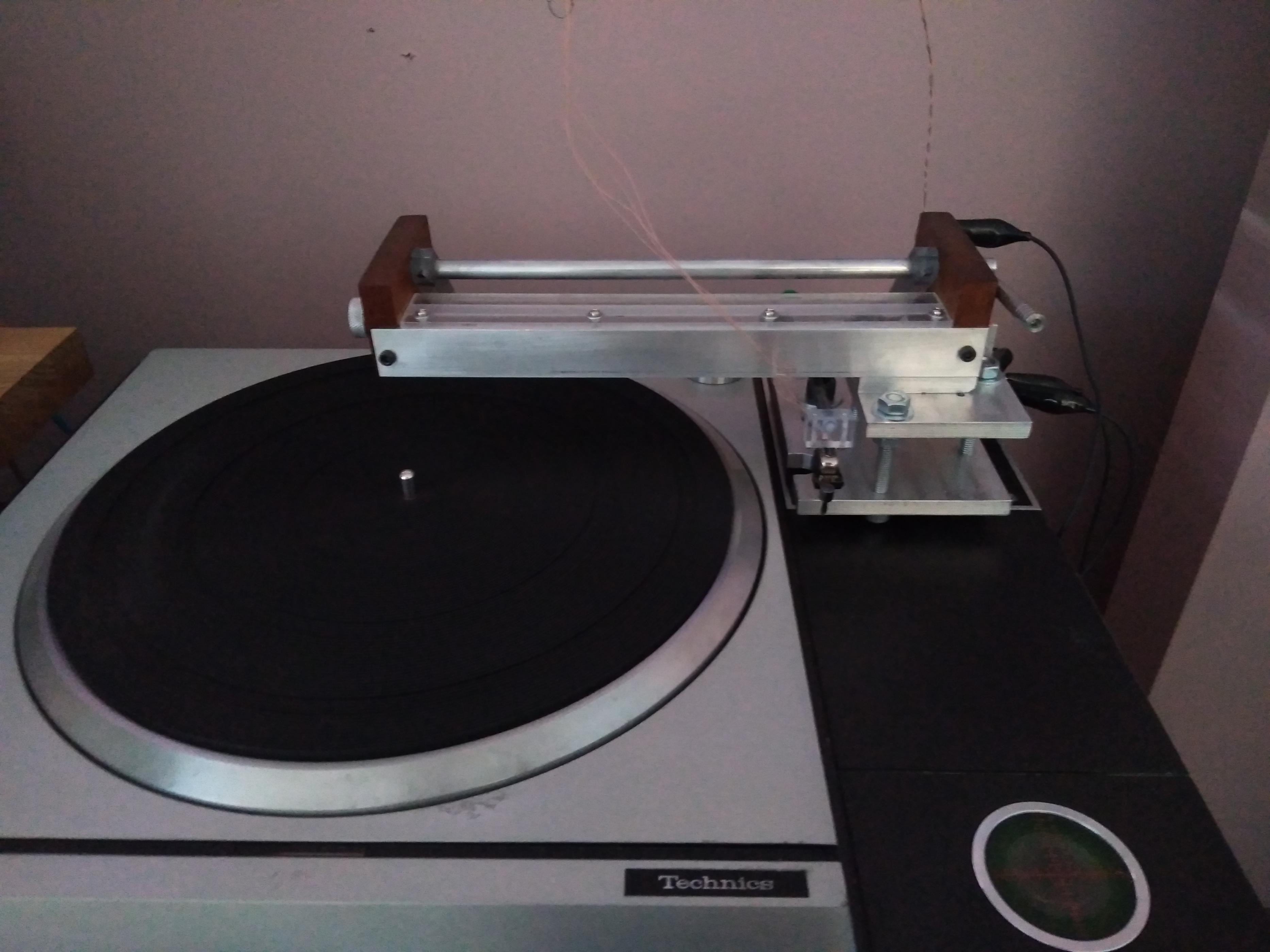

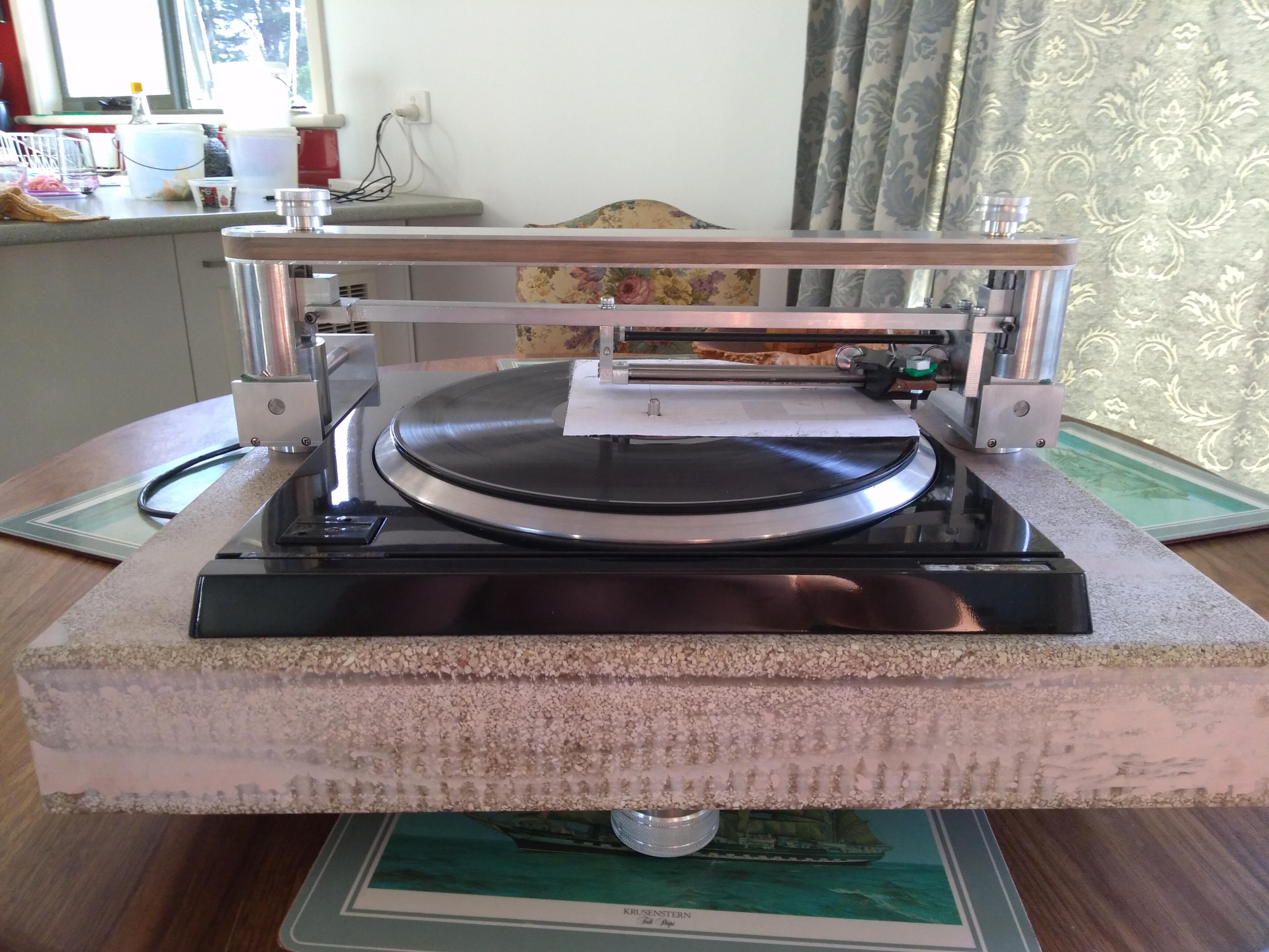

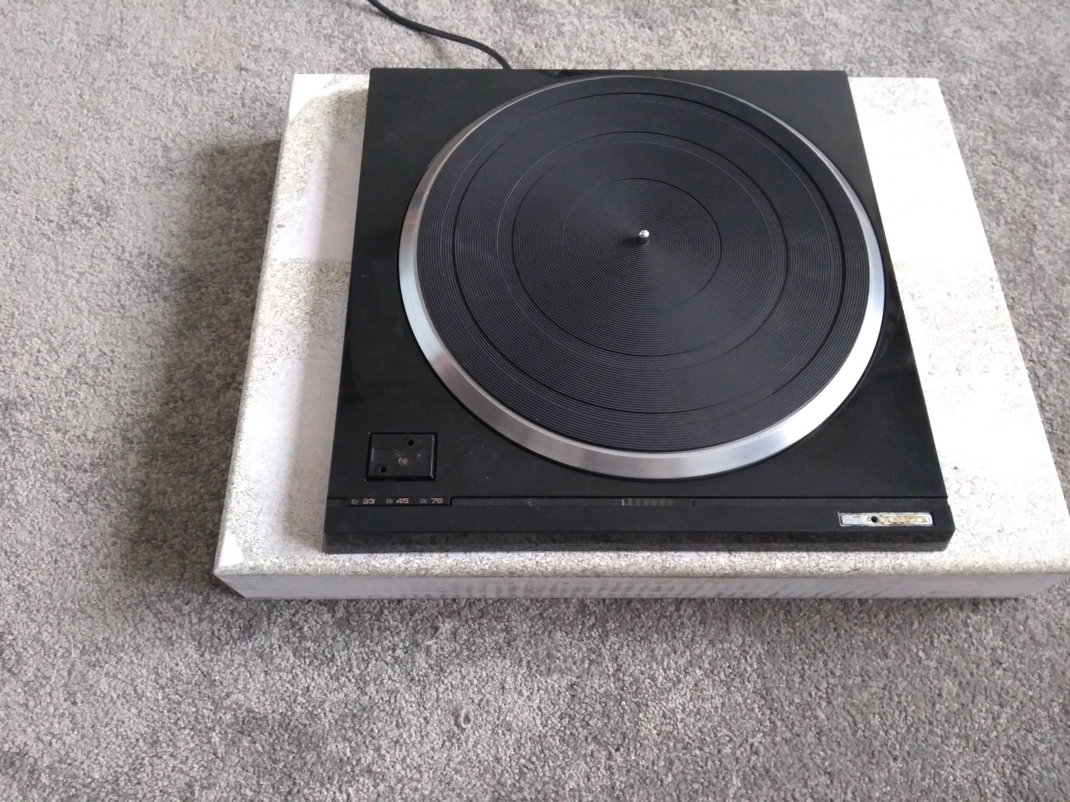

I have 2 SP10's the one in the 2nd pic is my current setup. I have an EPA100 with ECP205 and EPC100 (sold). The agricultural arm in the 2nd pic is better than the EPA100 and the EPA100 is a very good arm better than my previous RB808. I think I have about $50.00 invested in this arm as I had to buy a carbon rod and borosilicate tubes, the rest came from the scrap bin.
The 1st pic is the SP10 I bought not operational and have made a plinth (resin/bentonite, kitty litter) and my version a copy of the Clearaudio TT1.
If you have some DIY skills go for a linear arm with short arm wand, they really are very good.

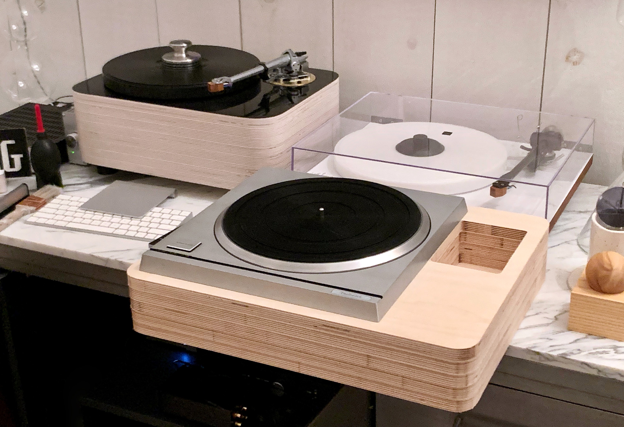

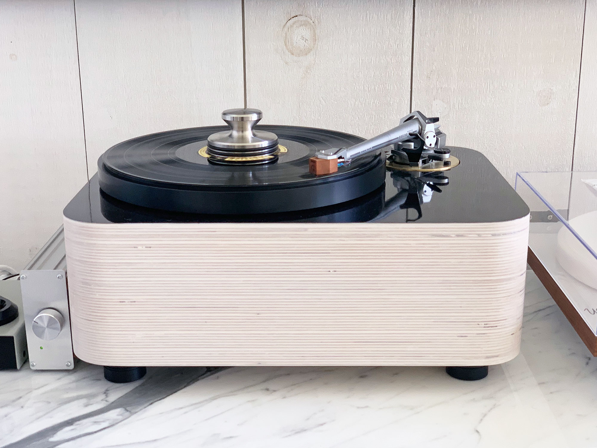

LOVE this thread (THANKS 6L6!). After reading it through... Here's the progress on mine....
Short version is the deck came from a super guy in Canada, rescued from a pile at a now defunct radio station. VERY far up north. Person I bought it from basically gave it to me (he knew "his" deck would be loved)—already refreshed internally—he kept it's mate from the station (they always come in twos!)—along with 6 pickup truck loads of their other discarded EQ—3 loads of which were vinyl I'm told. Incredible.
Missing the badge—but a friend donated a 3D printed one! which is undergoing beauty treatment.
I want to make GFRC plinth at some point...but I also need to listen to this thing—because apparently it's going to make my other decks all rejects and subsequently for sale (See pics ;-). One is a Rega knockoff that I made from parts inspired by the first deck I ever owned (RP1) which is pretty hideous in terms of build quality IMO—the other "beast" is made from a lot of nothing. But they are both belt drive. So this will all be a great comparo when the SP-10MK2 is up and running.

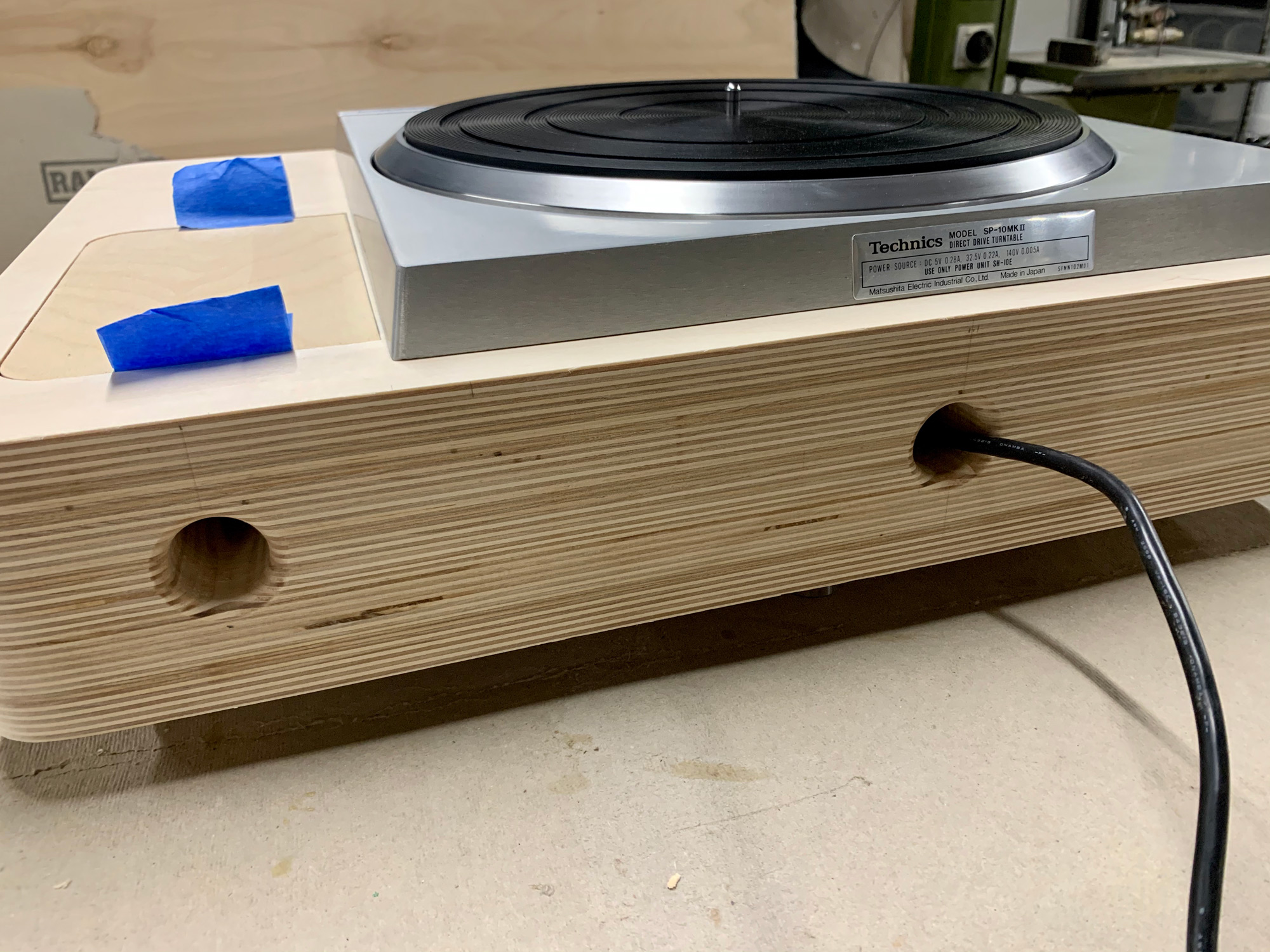

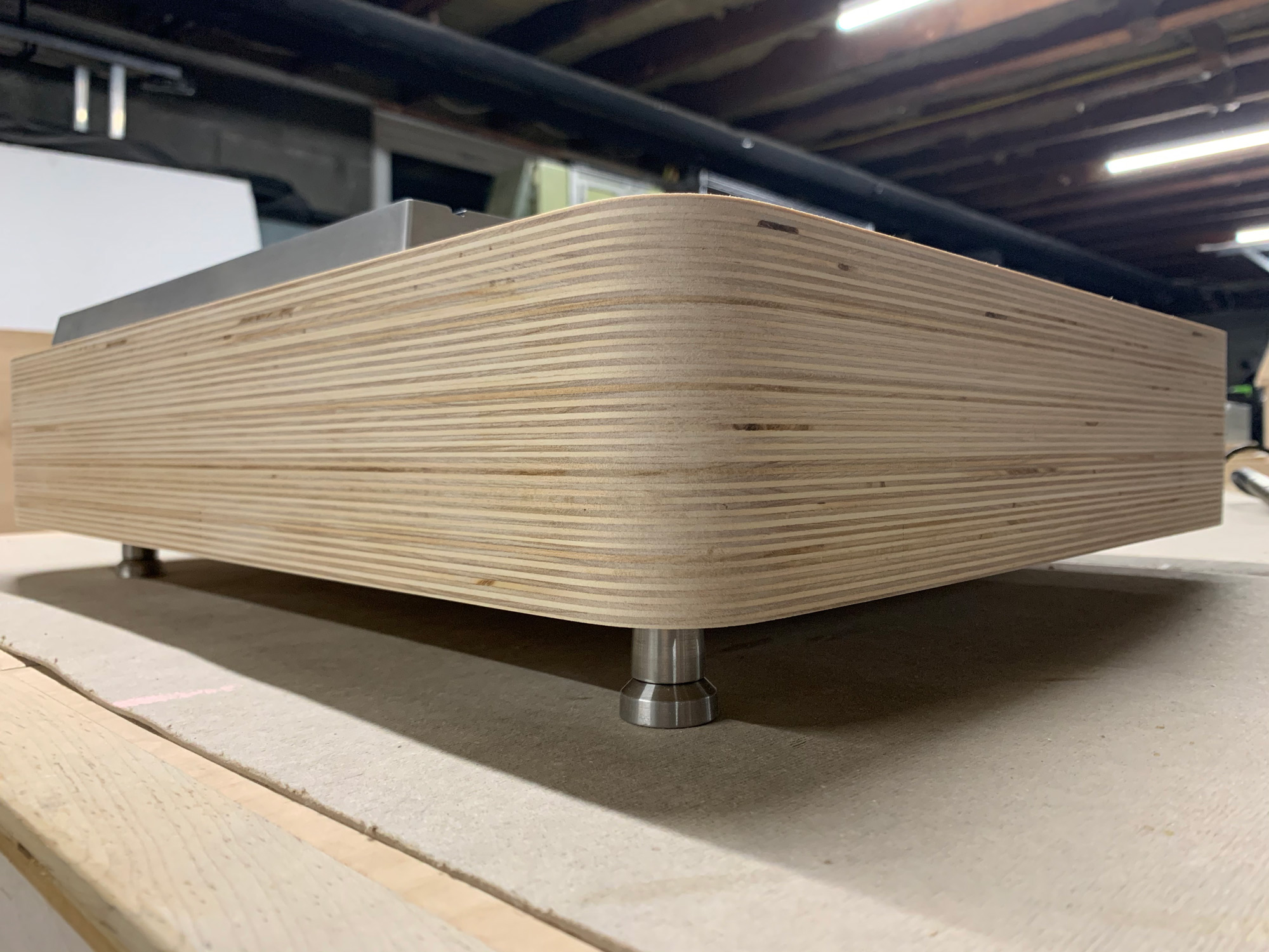

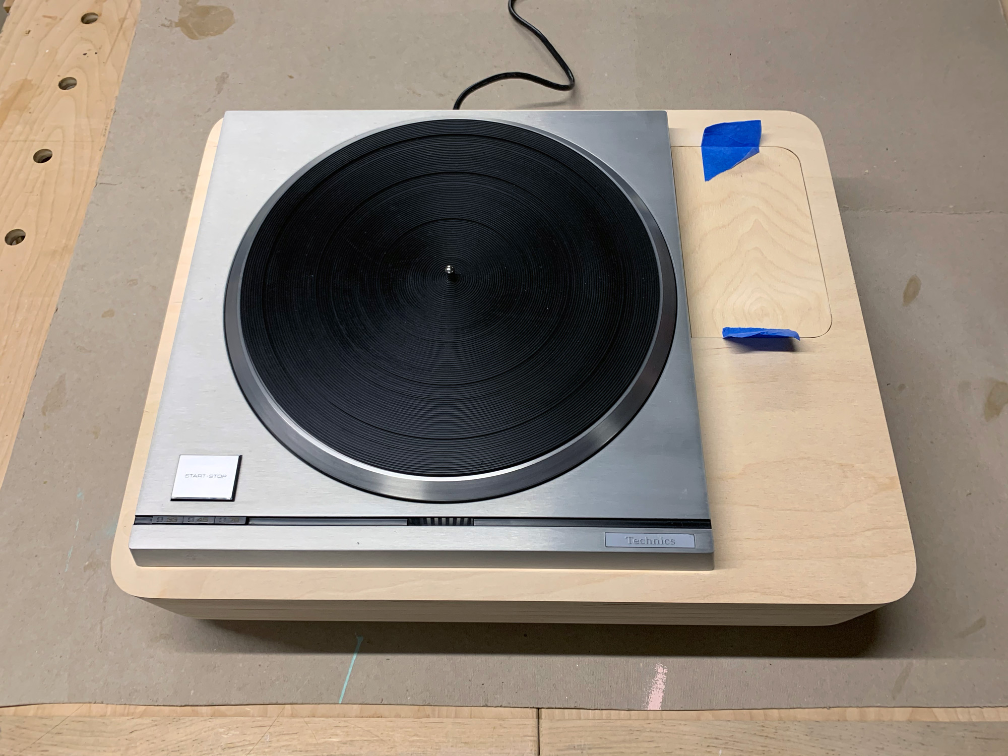

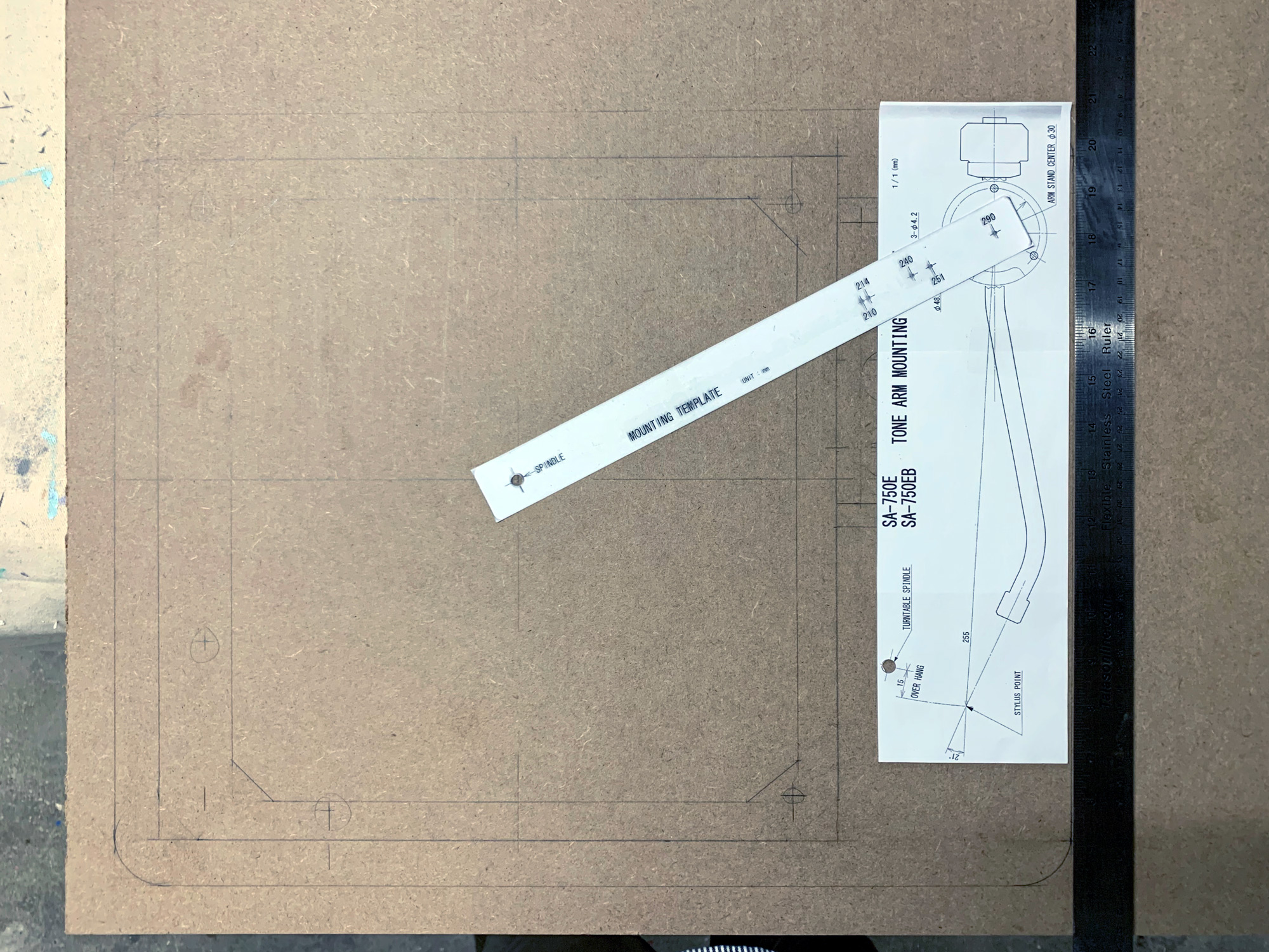

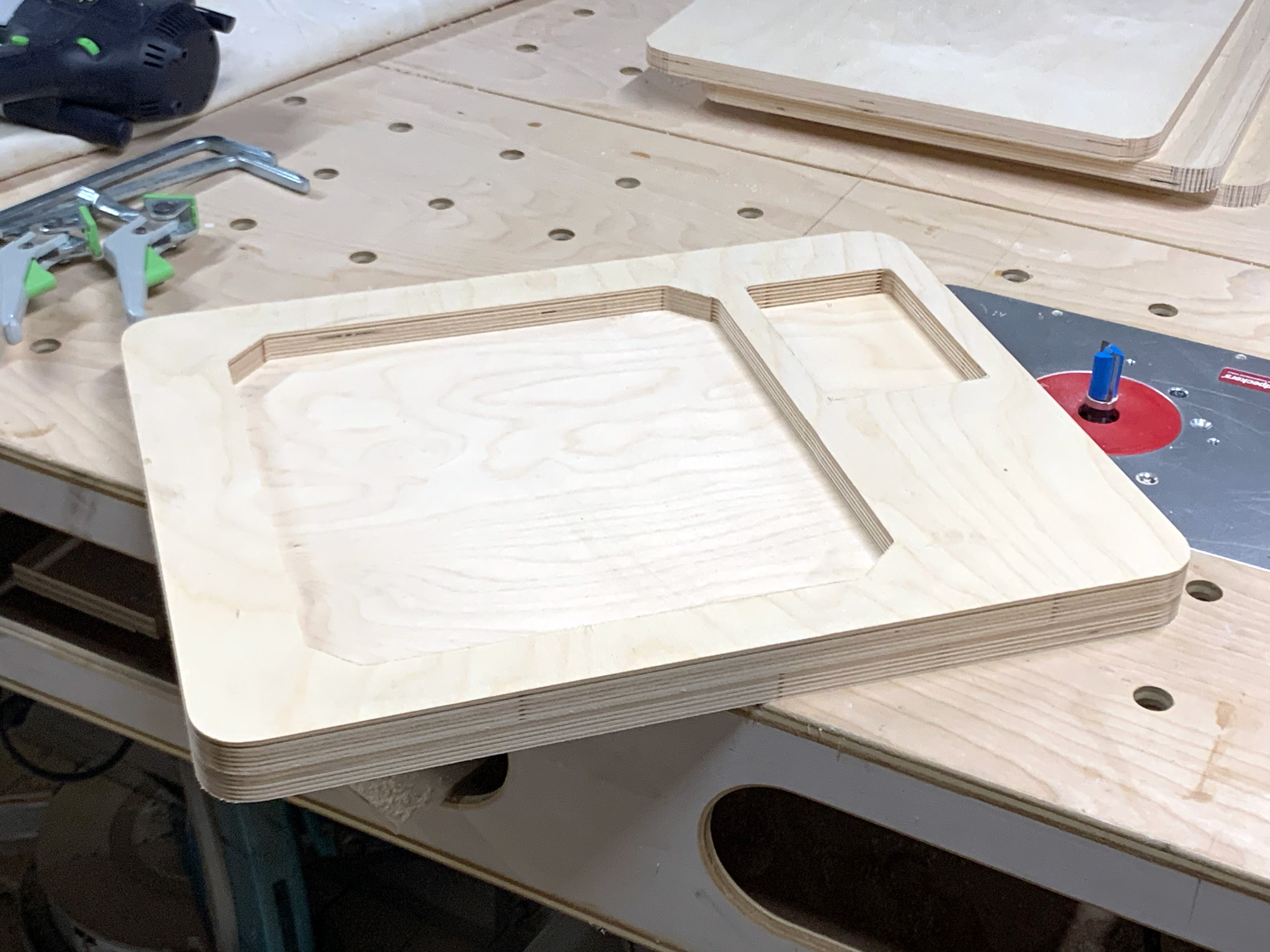

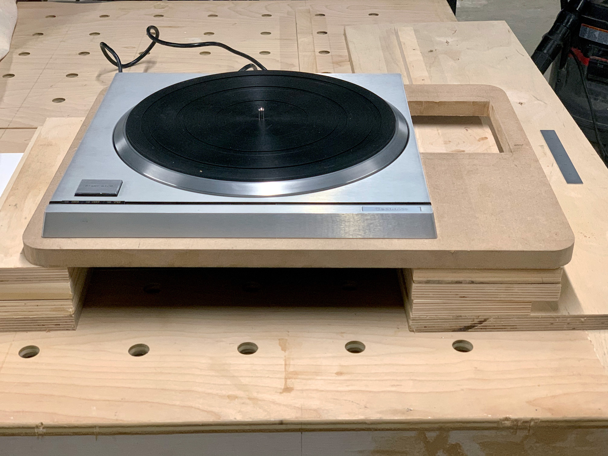

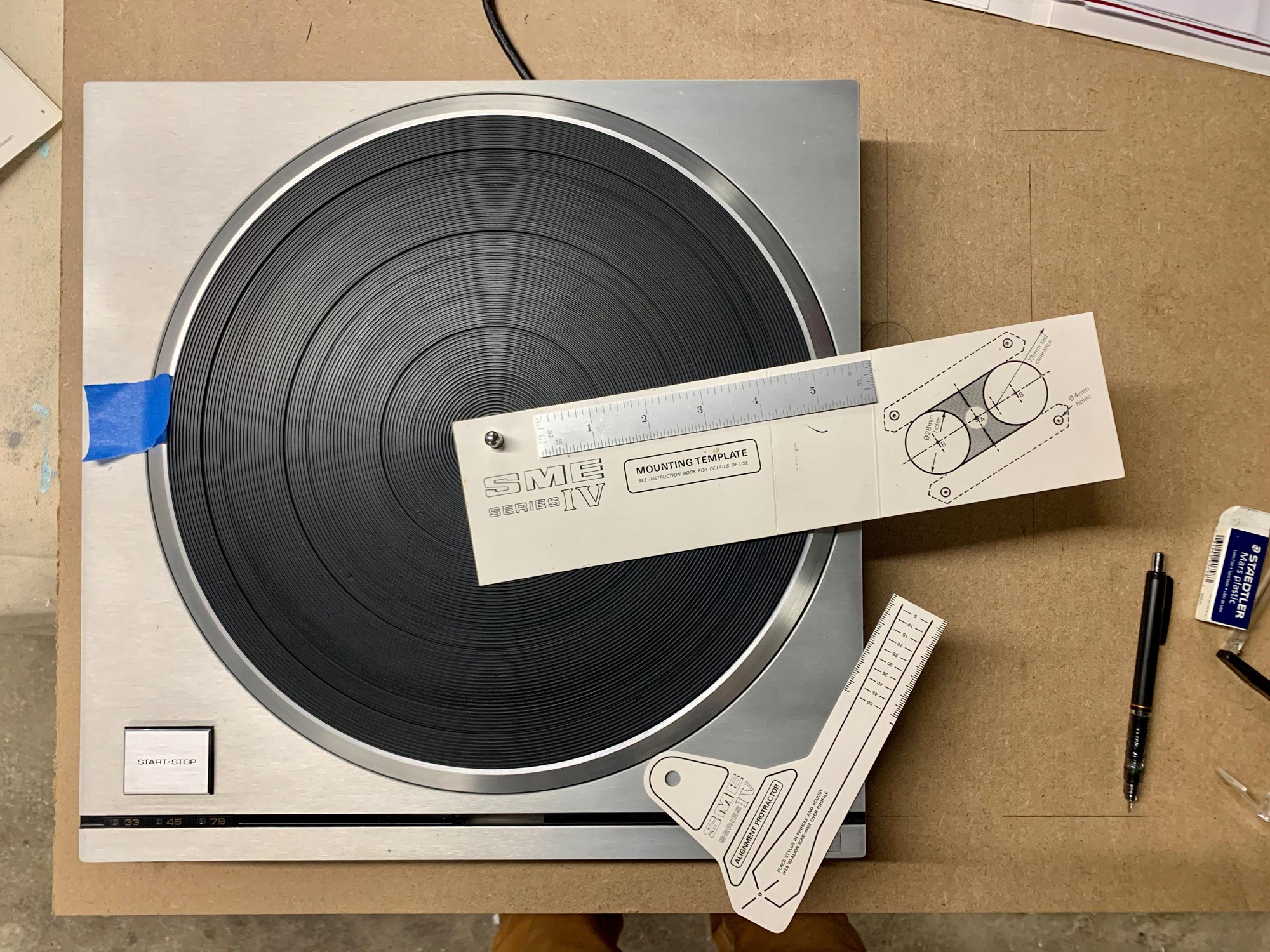

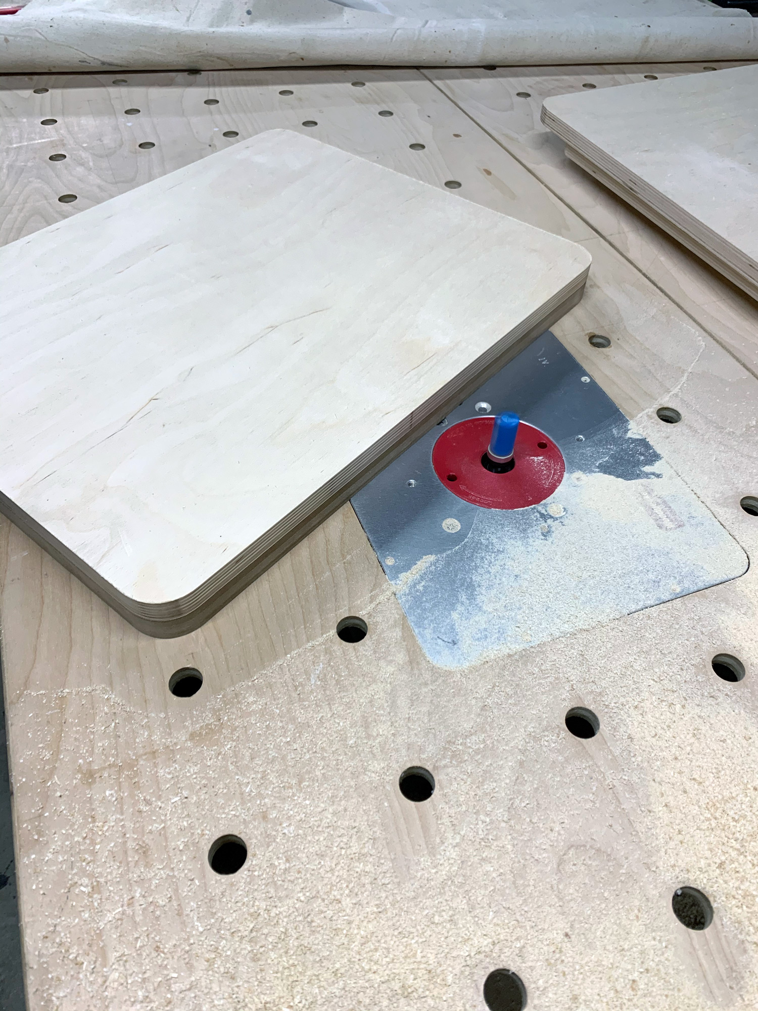

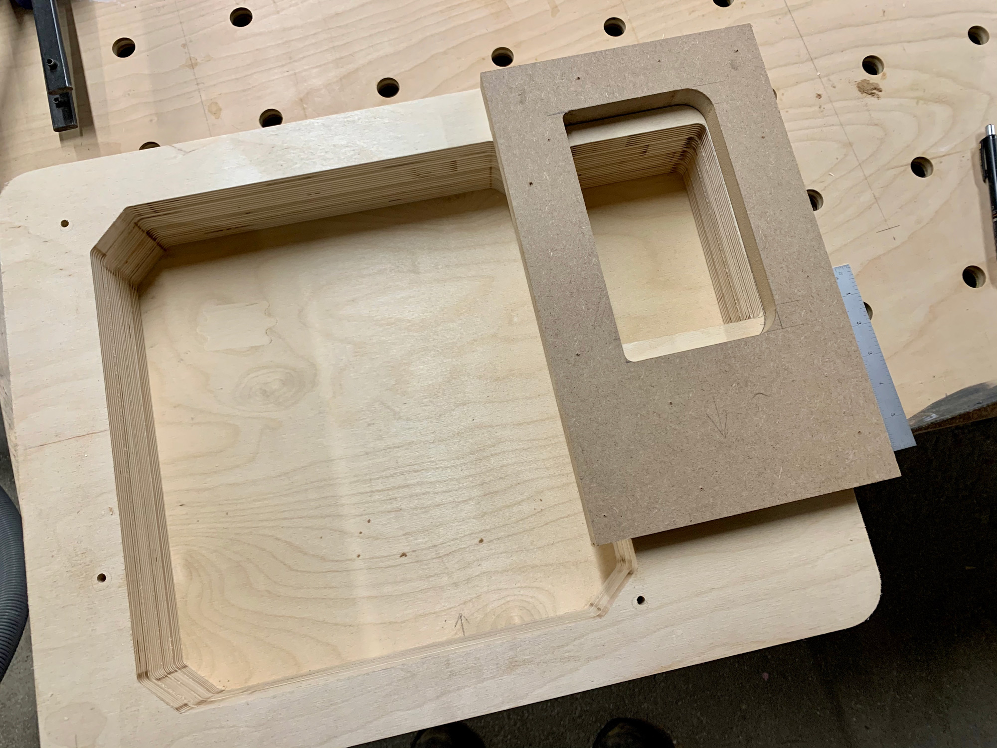

So for the SP-10 plinth—some shots of layout—building it out of the usual ply—this happens to be actual 5x5' finish cabinet grade ply—very dense and void free and fun to work with (my calls to the NA—in Canada—distributor of Panzerholz went unanswered). SME 9" newer style varieties are basically not possible to mount if you intend to follow the SME guides—and have a questionable resting point—visually speaking. We shall see what I can cook up there. I used some Jelco guides to account for 10" and shorter single mount arms. SME will fit I think if I shorten the travel they intend with their mount and nail the center point based on a short range of cart dimensions—ie act as if it's a center mount design with a few mm of wiggle room.
5 ply layers—solid bottom. About a 1" void for loading. Made a template after doing all my measurements—setup 2 routers—and off we go. Still have more layers to make—then some pins and glue up before next steps.
My calcs for weigh are 21lbs for deck alone, 15.4lbs in ply—leaving around 14lbs in lead. A friend hooked me up with some old telephone cable sheathing—pure lead. I'll hammer it out and stuff about half in there.
Might be able to listen to this sooner than later—Its been sitting far far too long—but then again I did accomplish making a killer phono-pre with a lot of help in the meantime! (6L6 again ;-).

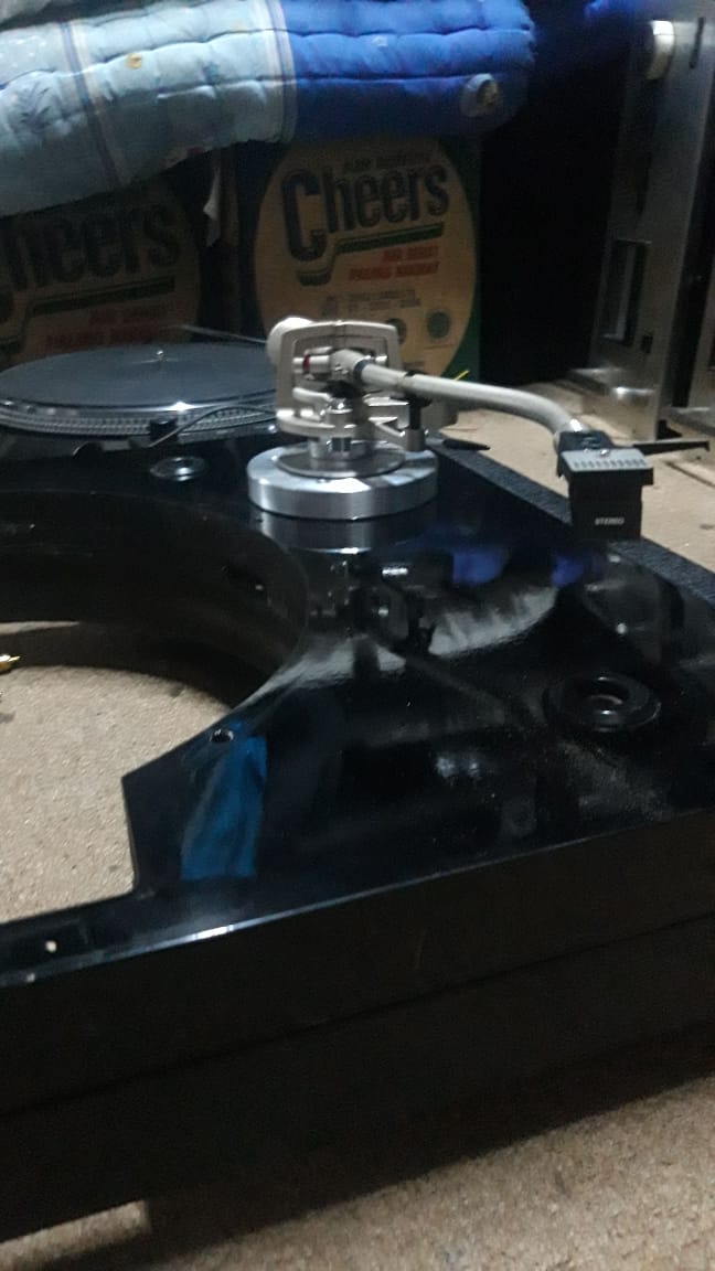

Mounting Epa100 to Sony tts8000
My friend had sp10 mk2.and we compared to Sony tts 8000. Speed control is equally stellar
You want to see if you can get hold of an SH100 this is the headshell that came with the EPA100. I have both and it is far superior to the SH98.
