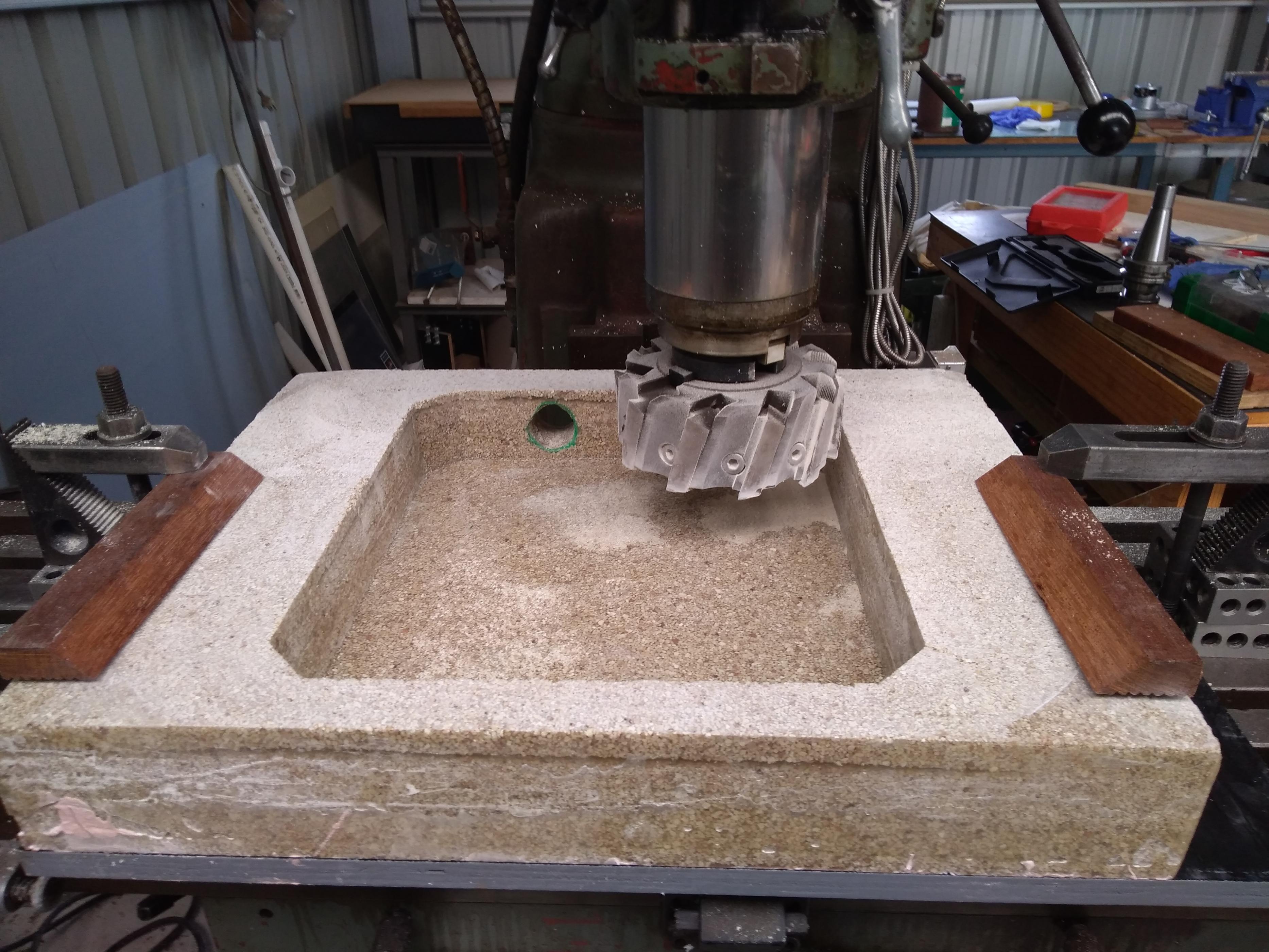

I made a resin bentonite plinth. 1% hardener was too much and the first pour warped badly about 10mm, so I had to put in the mill and machine the top flat. A fan placed blowing on the mold fixed the issue and reduced shrinkage of the resin significantly.
This is being setup for a bridged linear tonearm which will be mounted each side of the TT.
