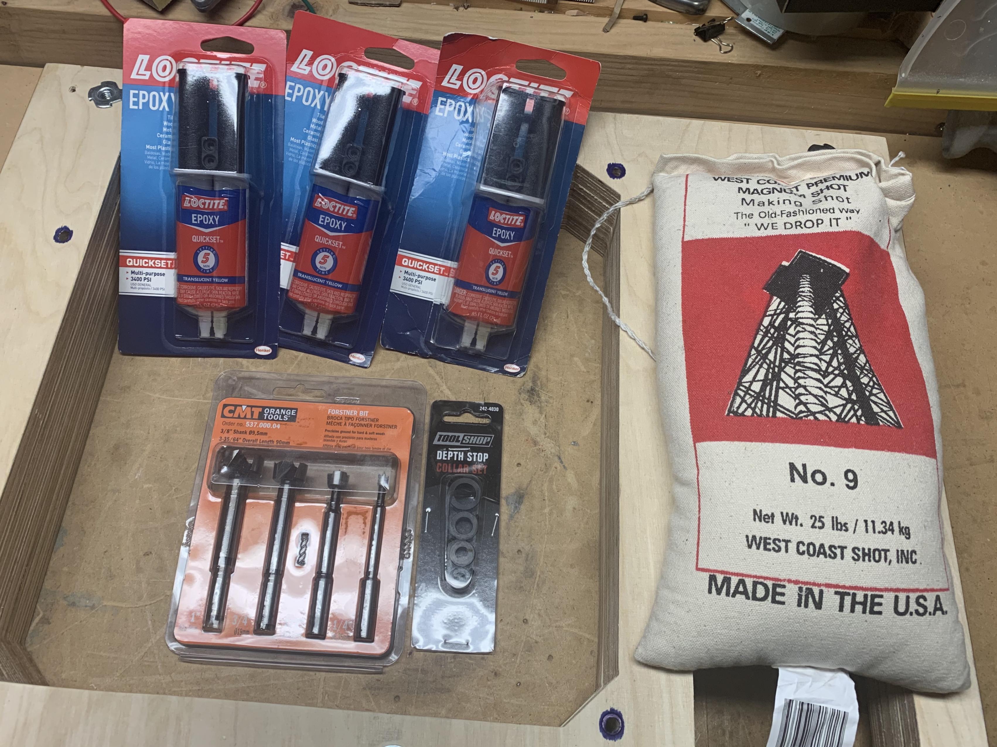

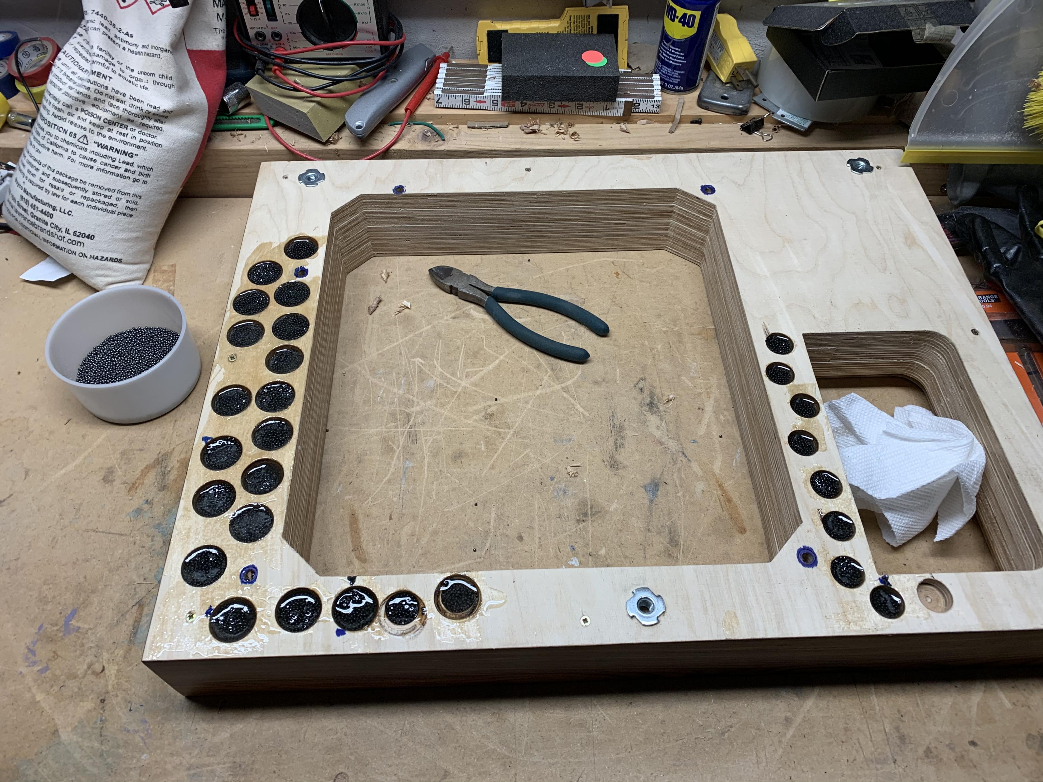

It’s the time of year for holiday weight gain. My plinth is getting a feast of lead with epoxy gravy. This is a plinth from ebay.
I found some screws embedded in the layers, and those screws kill the bits. So I need to get some more. I decided to put in some lead into the holes I drilled, and the 3 tubes of 5 minute epoxy was the perfect amount.
Now I need forstner bits and more epoxy. Off to Lowe’s.
