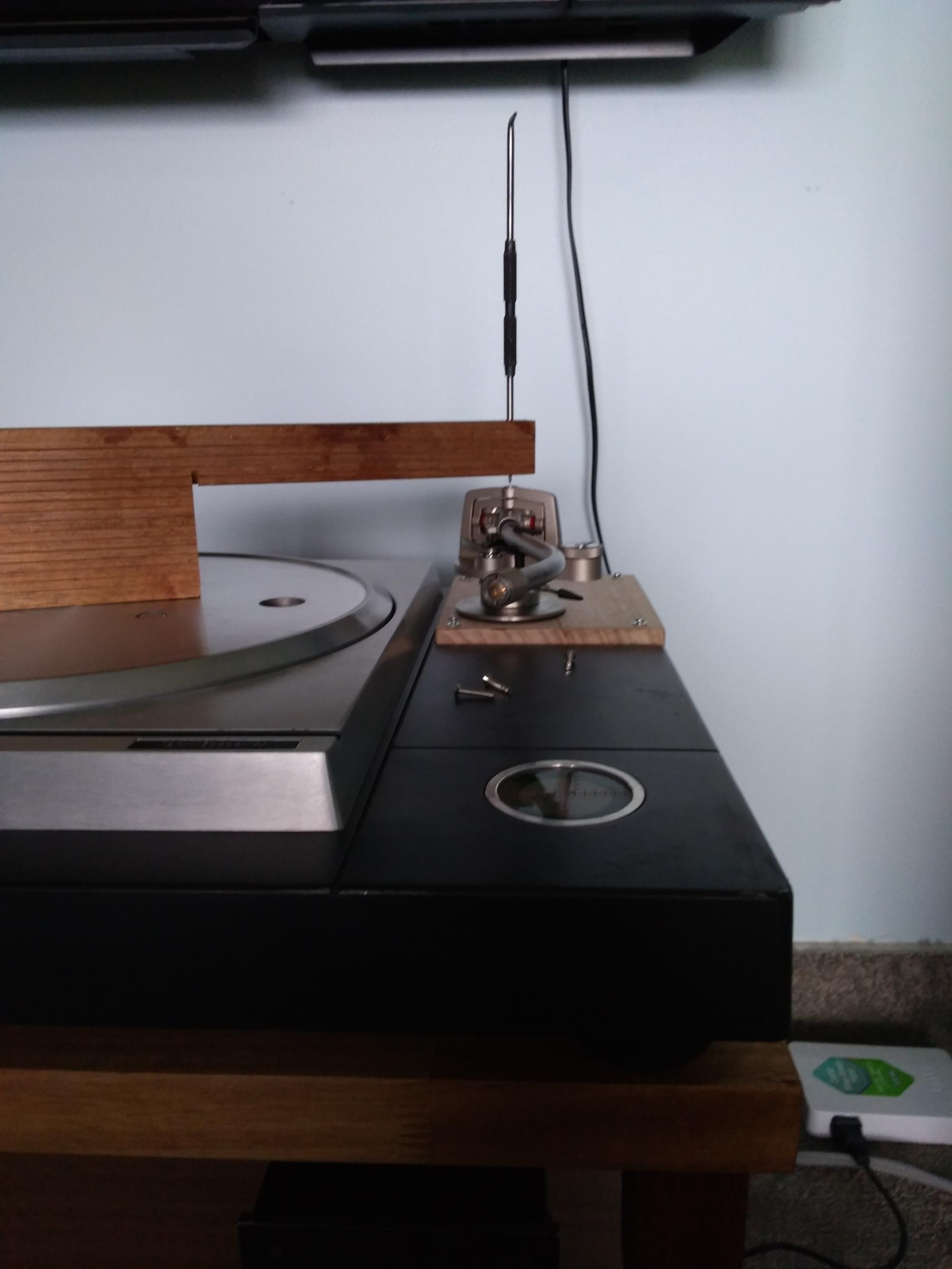

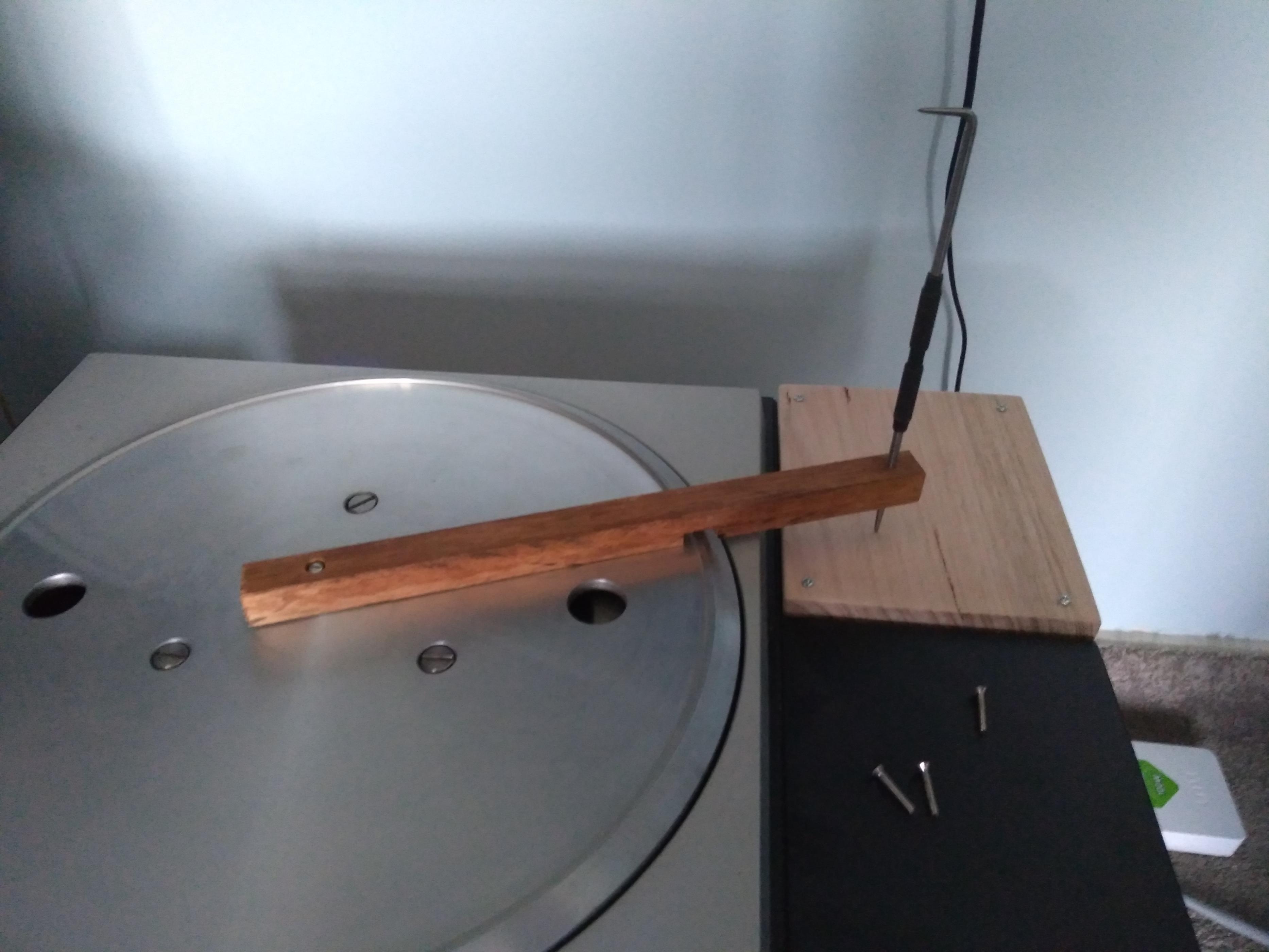

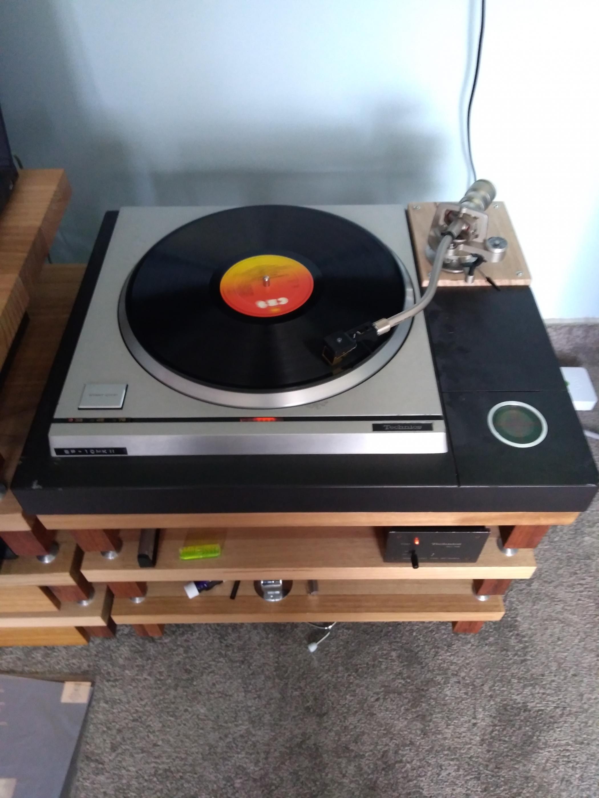

I made a couple of jigs with 235mm hole centres to mount the EPA-100, it's not ideal but at least got me spinning vinyl.
WOW even with this not ideal setup it sounds far superior to the RP8 and Apheta 2.
It tracks all but the most heavily modulated track on the HFN test LP although I did have to increase VTF to 2.0g. I have the EPC205C mounted with a Jico SAS/B stylus. Can't wait to get the bentonite plinth finished.

I am loving the SP10 and EPA100/EPC205
I have more hours on it in 4 weeks than my RP8 had in 6 years.
