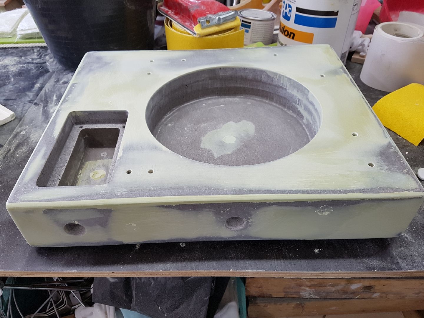

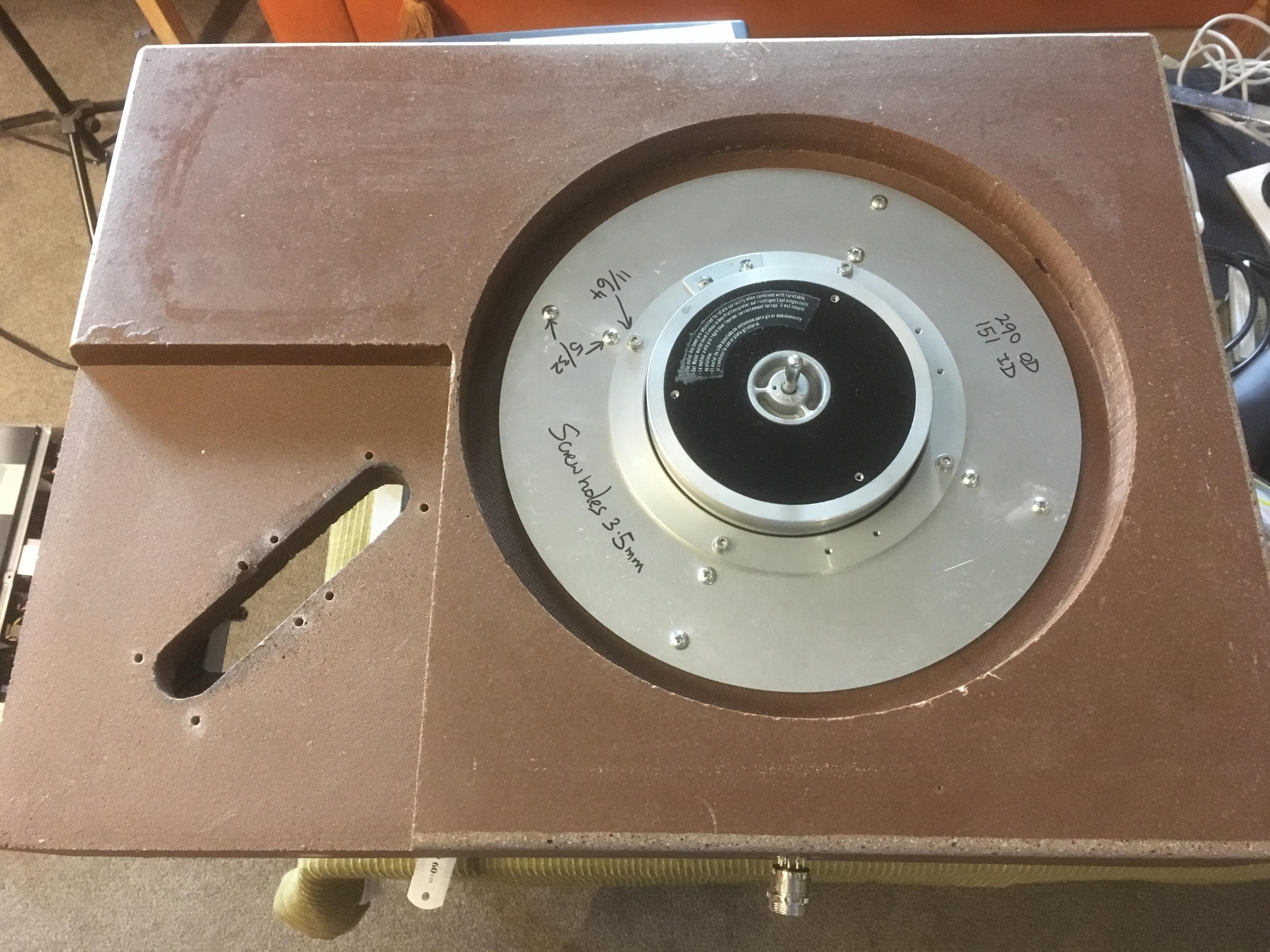

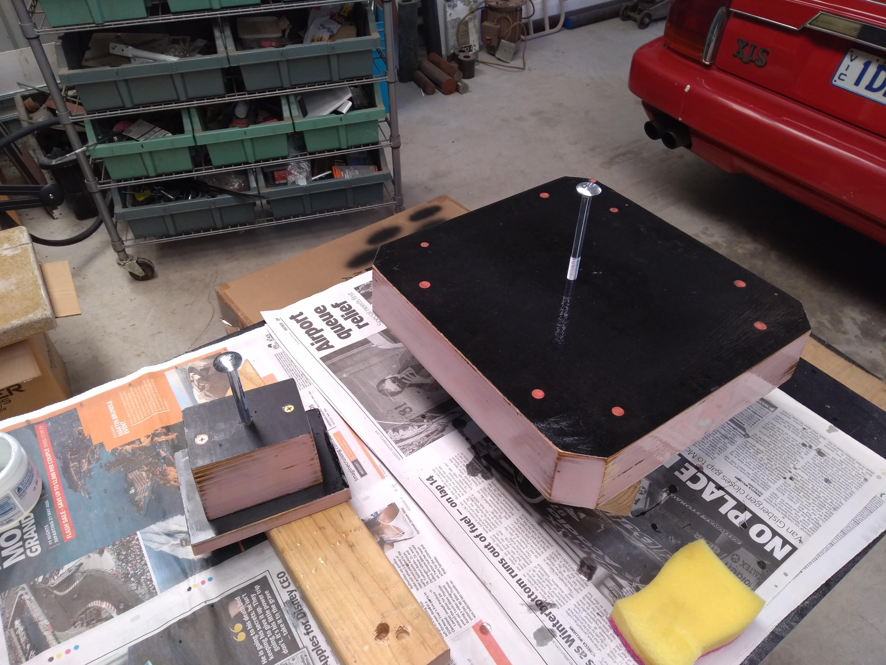

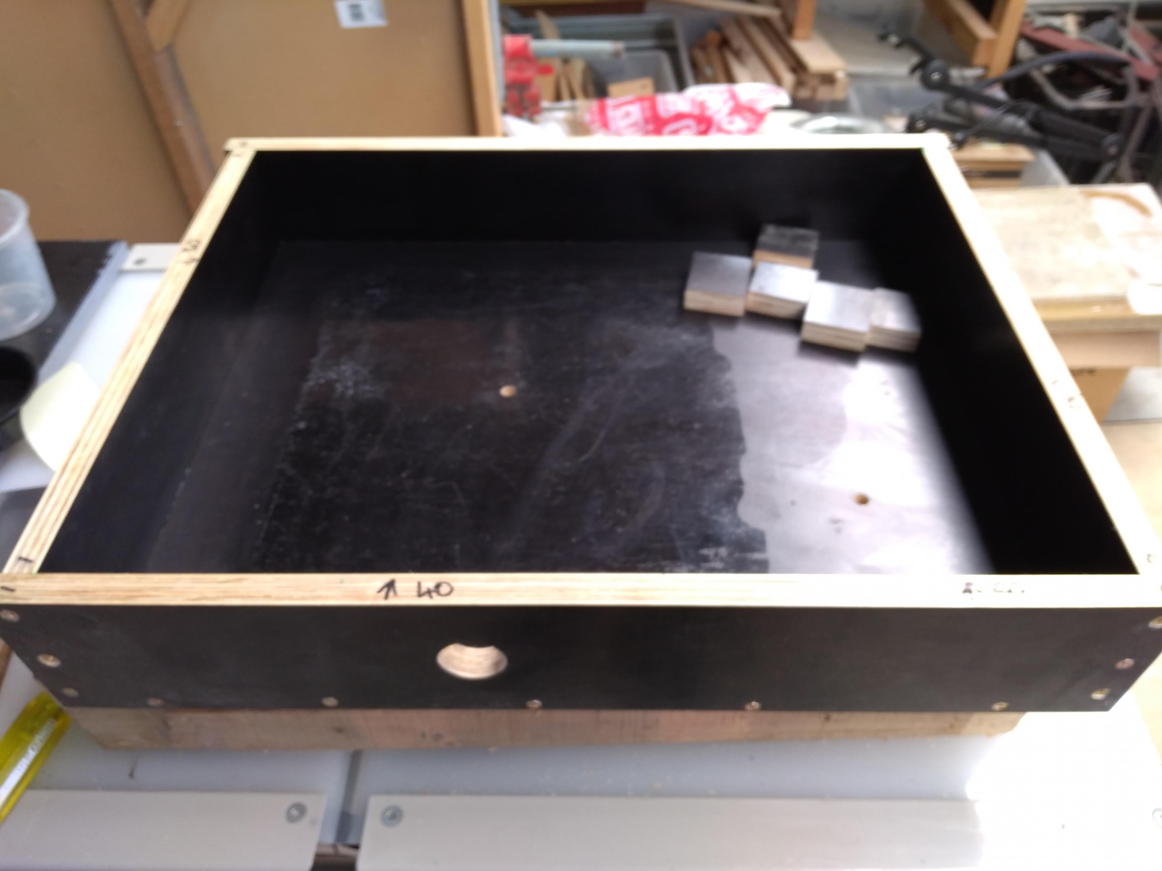

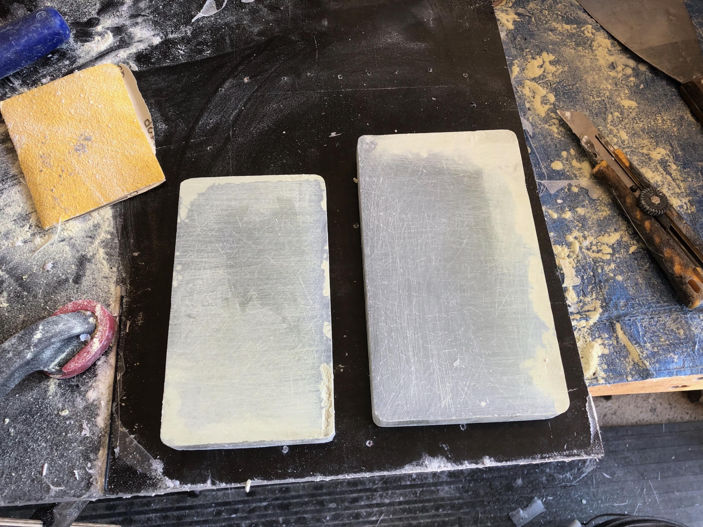

I borrowed Bon's idea of making inserts for the motor and arm.
These are made from form ply and MDF the motor insert is 60mm and the tonearm is 100mm to go all the way through the plinth. They are cut with a 2° taper to aid in plug removal.
To finish the plugs they are screeded on the edge with body filler, sanded smooth and coated with 2K polyurethane varnish (Wattle 7008), I have used this varnish successfully in many laminating molds
I spoke to the supplier of the isophthalic resin I bought and they recommended not using less than 1% catalyst and doing a maximum of 10mm thick pours. This is un-waxed resin so I will not have to sand between pours if they go over multiple days.
Imitation is the best form of flattery
These are made from form ply and MDF the motor insert is 60mm and the tonearm is 100mm to go all the way through the plinth. They are cut with a 2° taper to aid in plug removal..
You will have to make armboards. I suggest you layer them up from chopped fibreglass and resin. They will then be hard as rock (glass?). Then you can torque down your tonearm minimising the risk of cracking. Also cut them to a slight taper. It will require care to machine the tonearm hole.
1% catalyst is perfect if you have the patience to wait a week for the cure. I don't see the need to pour in layers if you use casting resin. It is designed for casting figurines, garden ornaments etc. I have never has a problem using it in 90mm thick pours (1% catalyst/resin). You just need a big flexible poly bucket (30-40L) and a stubby garden shovel for mixing.
I have a 3/4 of 20kg drum of laminating resin and it's exothermic reaction is different to casting resin, this is why I spoke to the manufacturer of the resin. 10mm pours was their recommendation. Because the resin is un-waxed it will remain sticky on top so I do not have to prep the surface for each pour.
I'll see how I go after the first pour, I'd rather go slow and not have to redo it again.

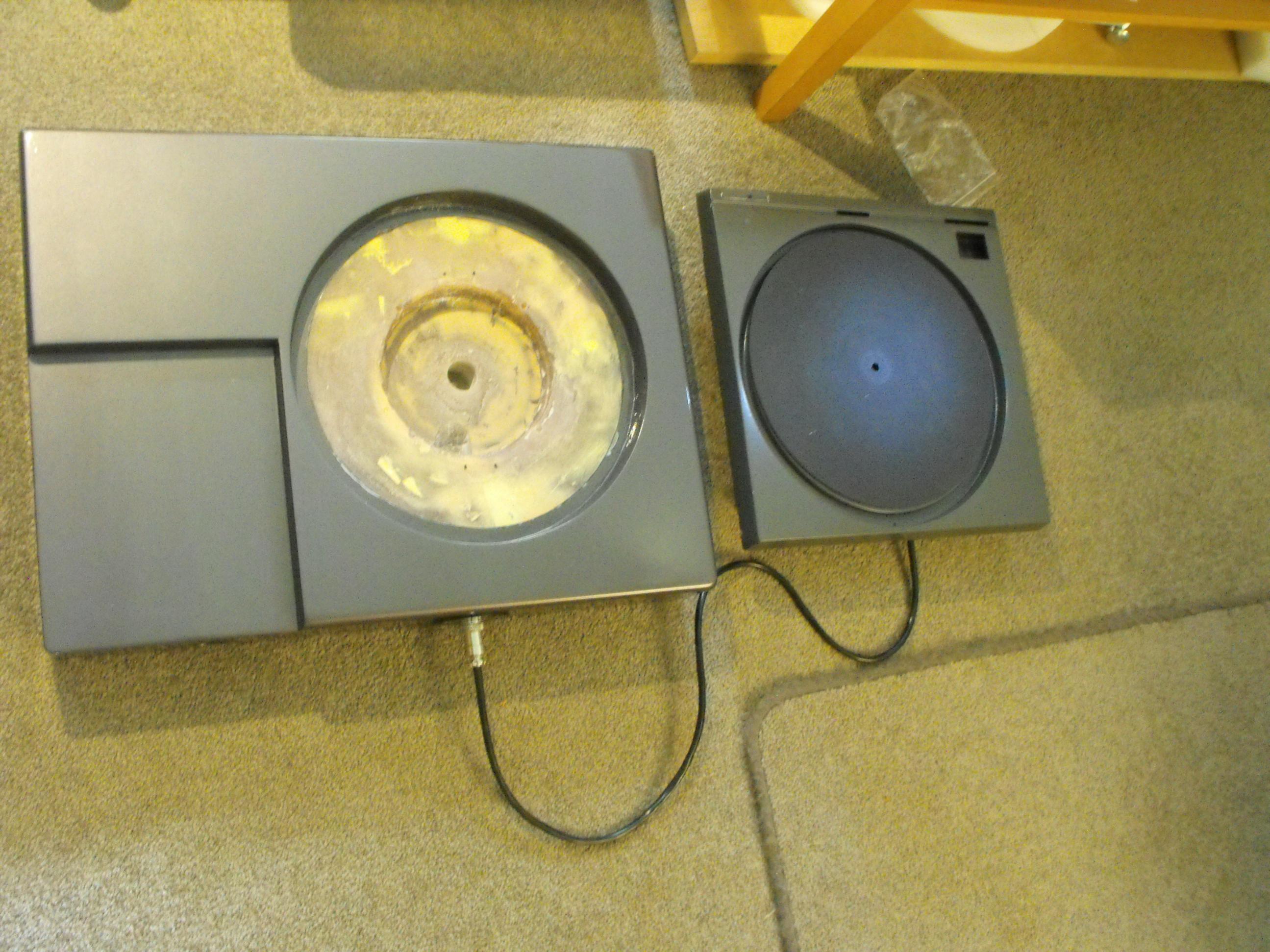

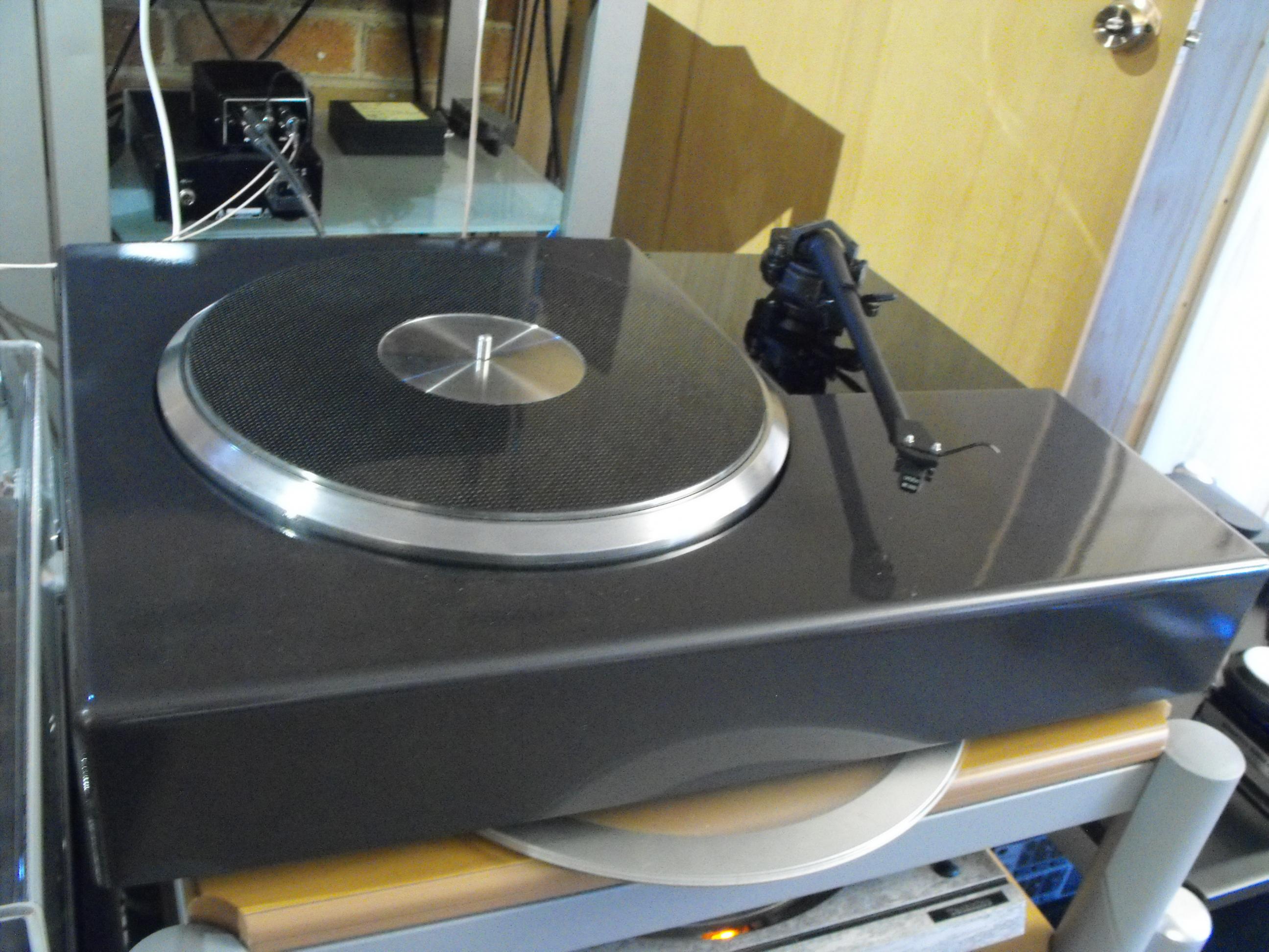

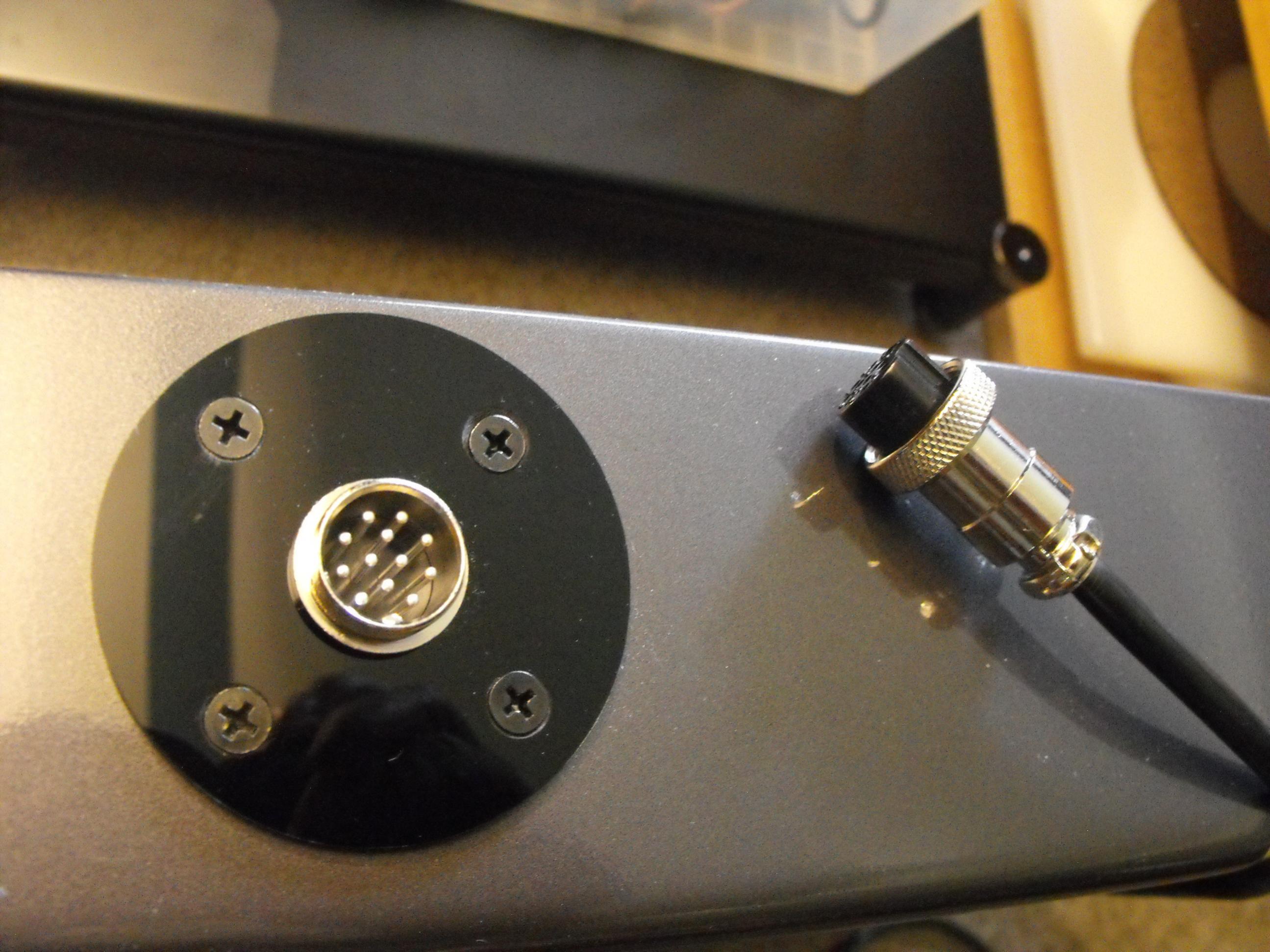

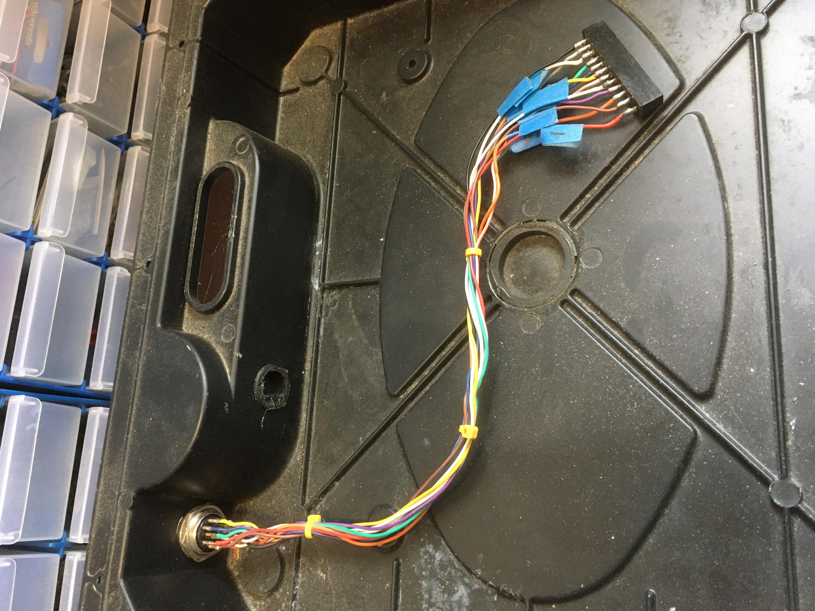

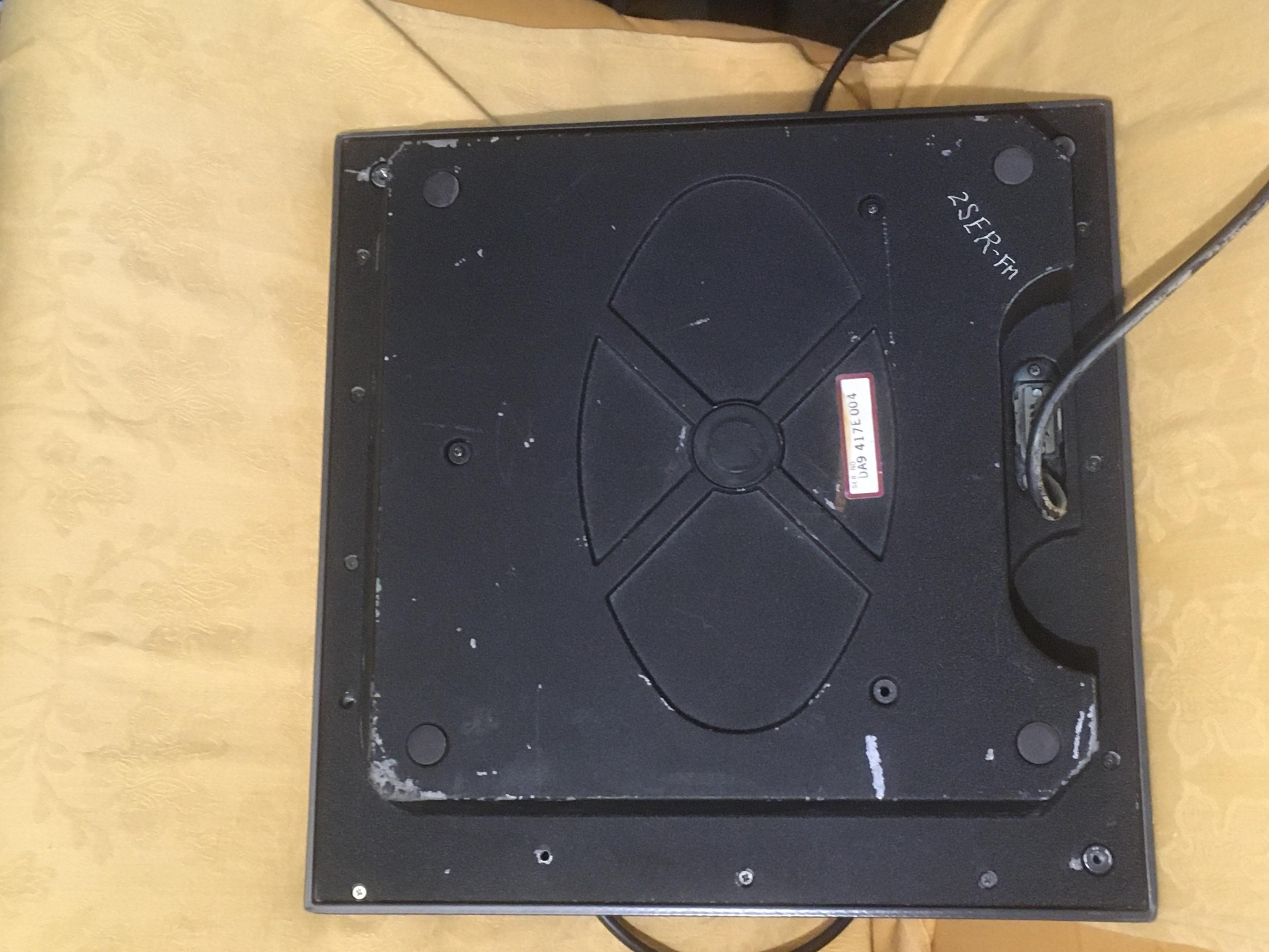

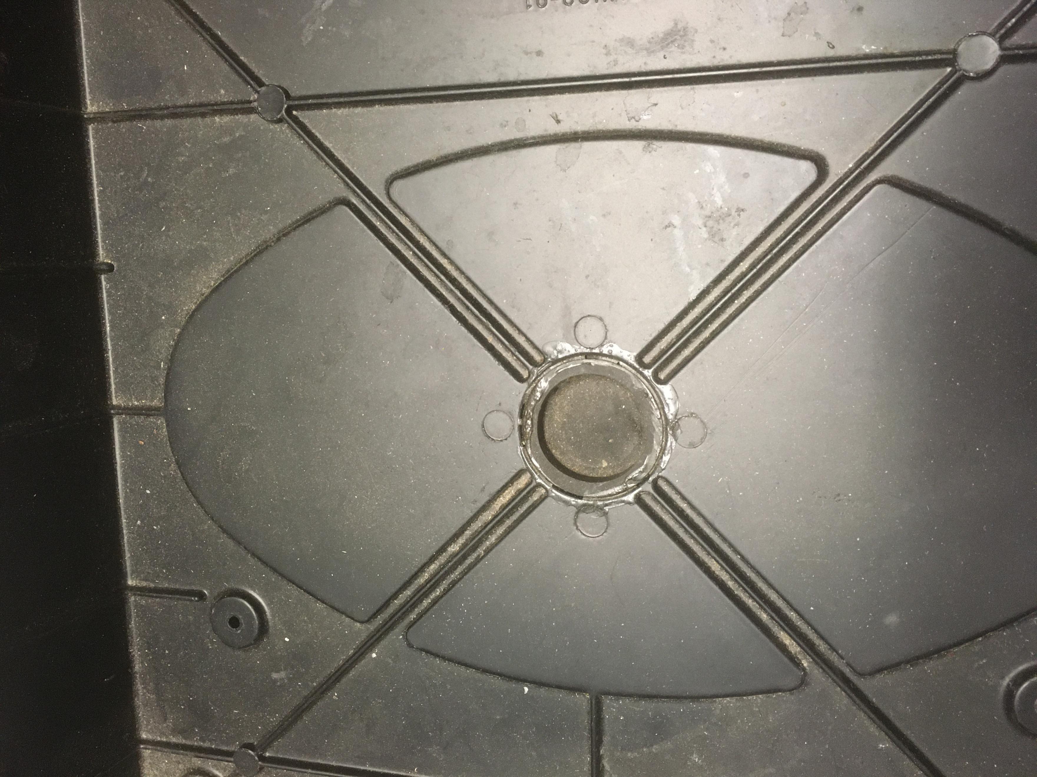

I have always considered the chassis of the mkII to be its weakest link. It is quite a thin aluminium casting and rings strongly when isolated.

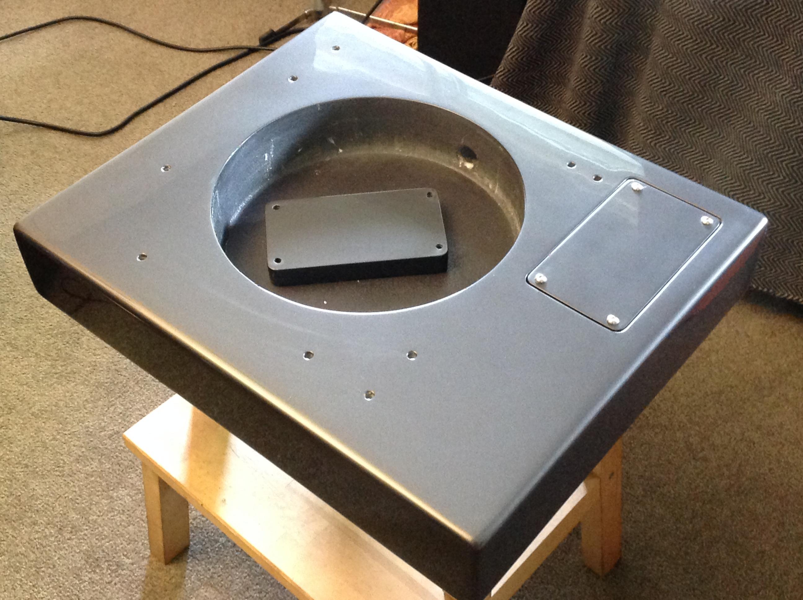

I have a number of back-up mkII's and it has been a long term project to dispose of the chassis and mount the superb motor directly into a well damped plinth. This leaves the electronics in the original chassis which now is a (rather ugly) control box connected by an umbilical. I never compared the stock chassis to the motor+plinth only but I will pull out the stethoscope for a test. The friction brake and strobe are no longer useable but not missed.
I found a similar rebuild by Artisan Fidelity, using panzerholz.
Technics Sp10Mk2 NG — Artisan Fidelity
No price quoted but based on other prices on their site, expect a shock. My materials cost a few hundred dollars. The cast resin-bentonite plinth is achievable by a competent diy-er whereas machining panzerholz is not in reach of my facilities.
I have some butyl sound deadening left over from my car resto I was going to add a little of this to the inside of the chassis to dampen it.

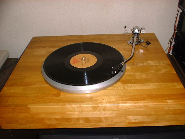

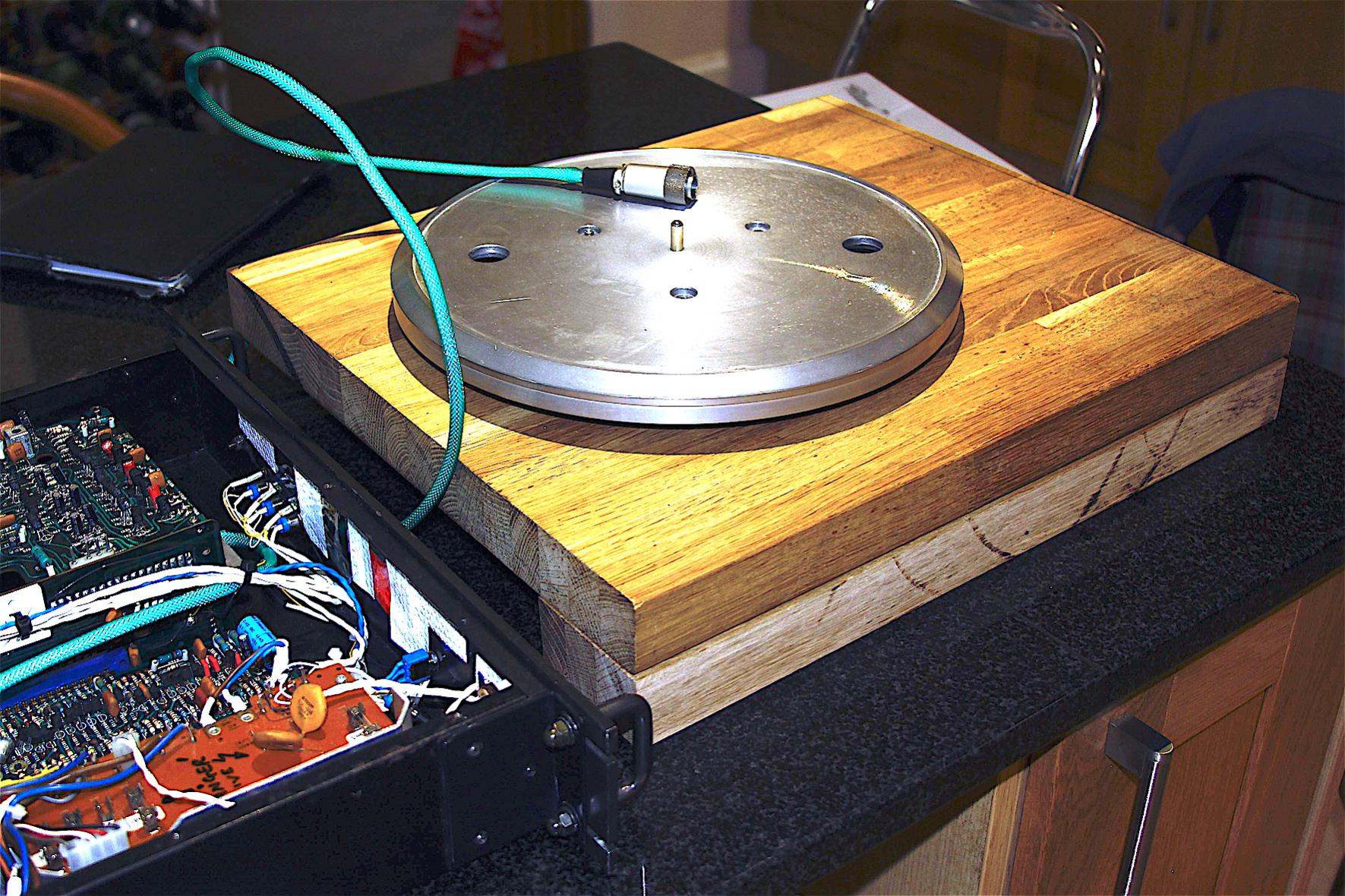

I am doing likewise...here is my mock up prior to making a high mass version in metal.
The electronics are now in the case to the left.
The other finished fruitwood plinth is a Kaneta pic from the doc linked above.
