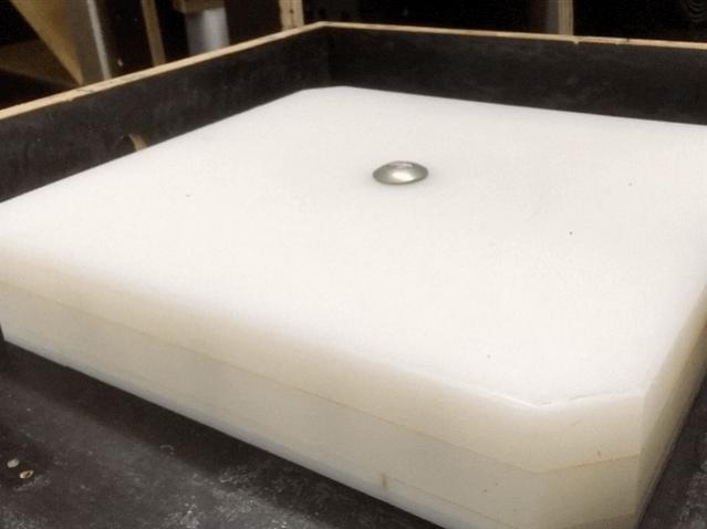

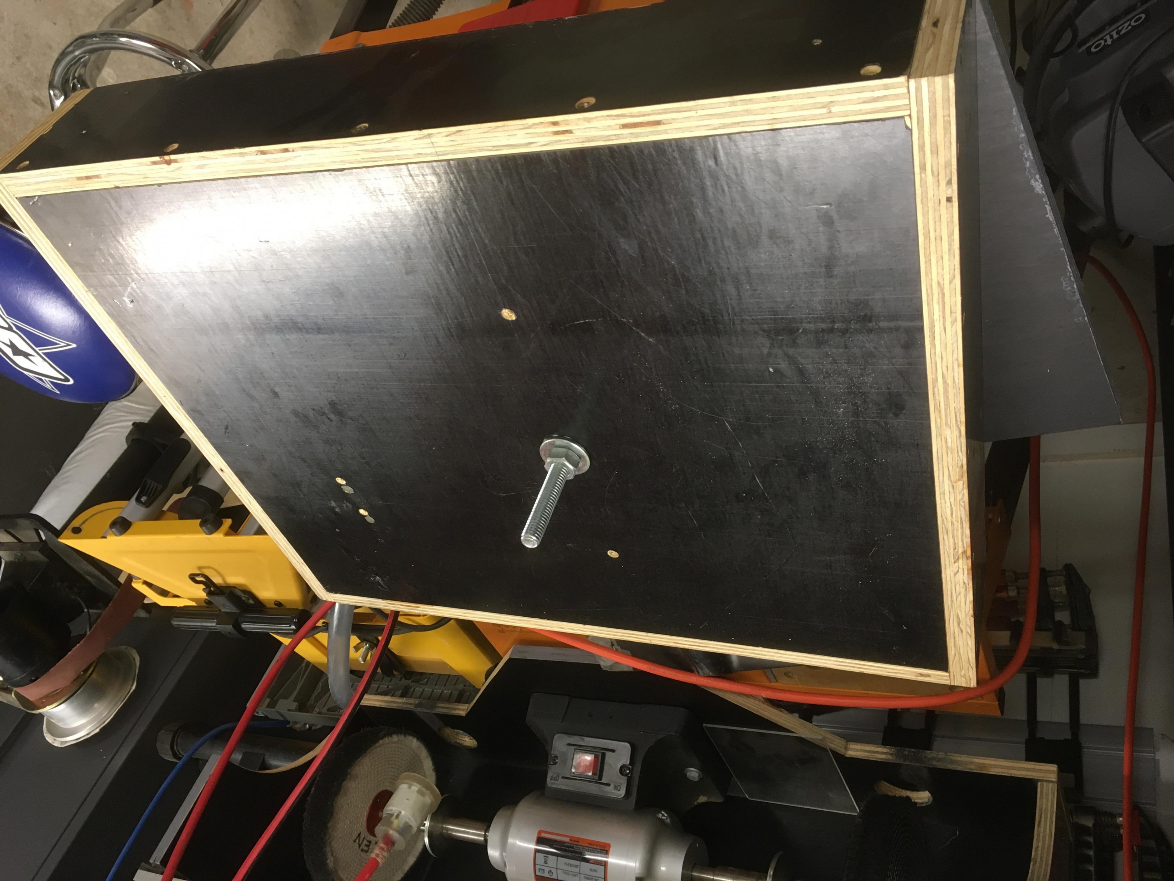

Good questions. The inserts need to be material that is solid enough to survive the extraction process, and with a slippery surface to aid removal. My solution is the white polyethylene kitchen cutting board, which can be found from kitchen wholesalers in various thicknesses up to 25mm, and can be snugly screwed together in layers for the desired thickness. They are cut to size with the table saw, on a slight taper to aid removal from the casting. Each insert has a central threaded 3/8" through bolt that is pulled through a support block with a winding nut to gently extract the insert, minimising the risk of cast cracking. For the SP10 chassis insert, the bolt protrudes through the base of the mold.
BTW the mold material is formply and liberal mold release is used.

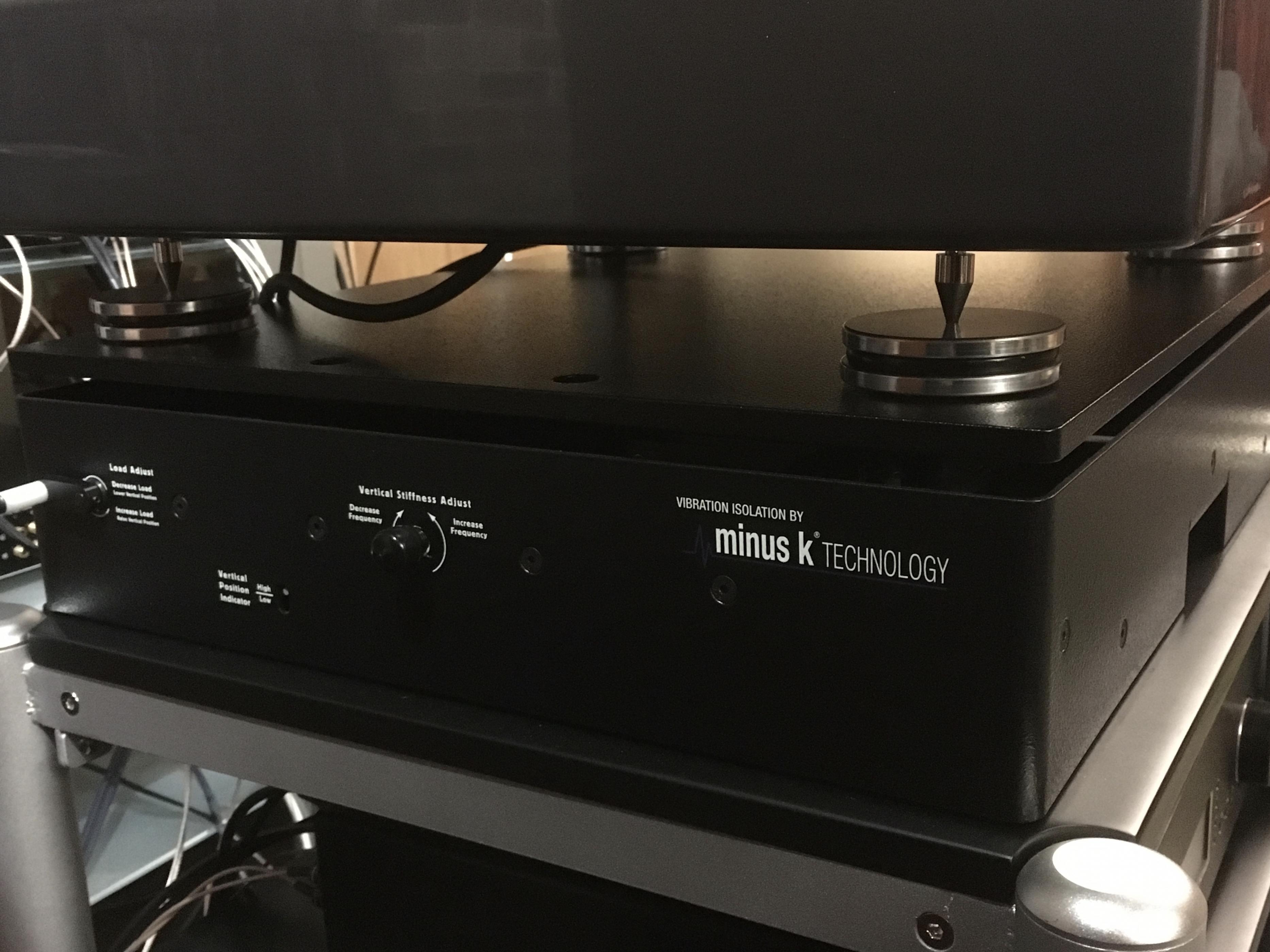

now for most of us the vibration is NOT from the turntable (untuned Lenco aside) but from the environment getting back in. For this the Minus-K is hard to beat at any price.
