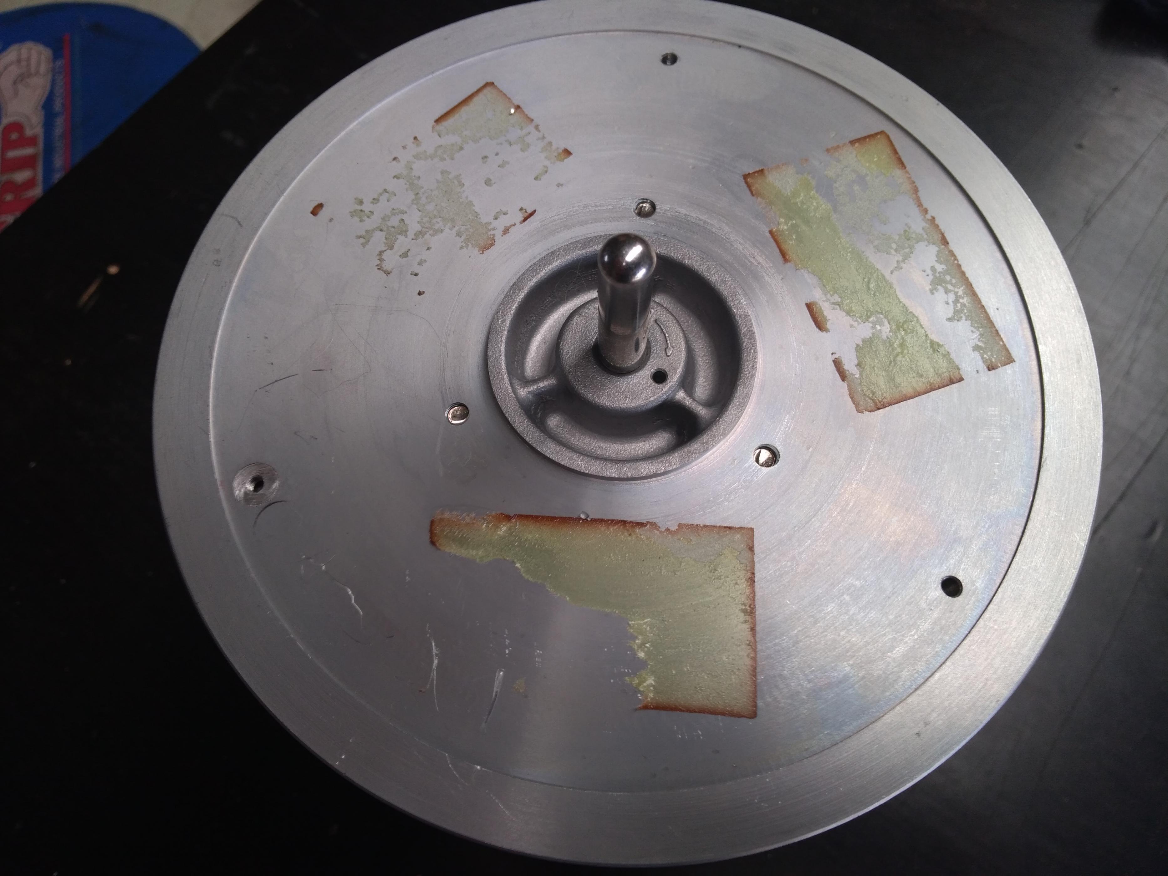

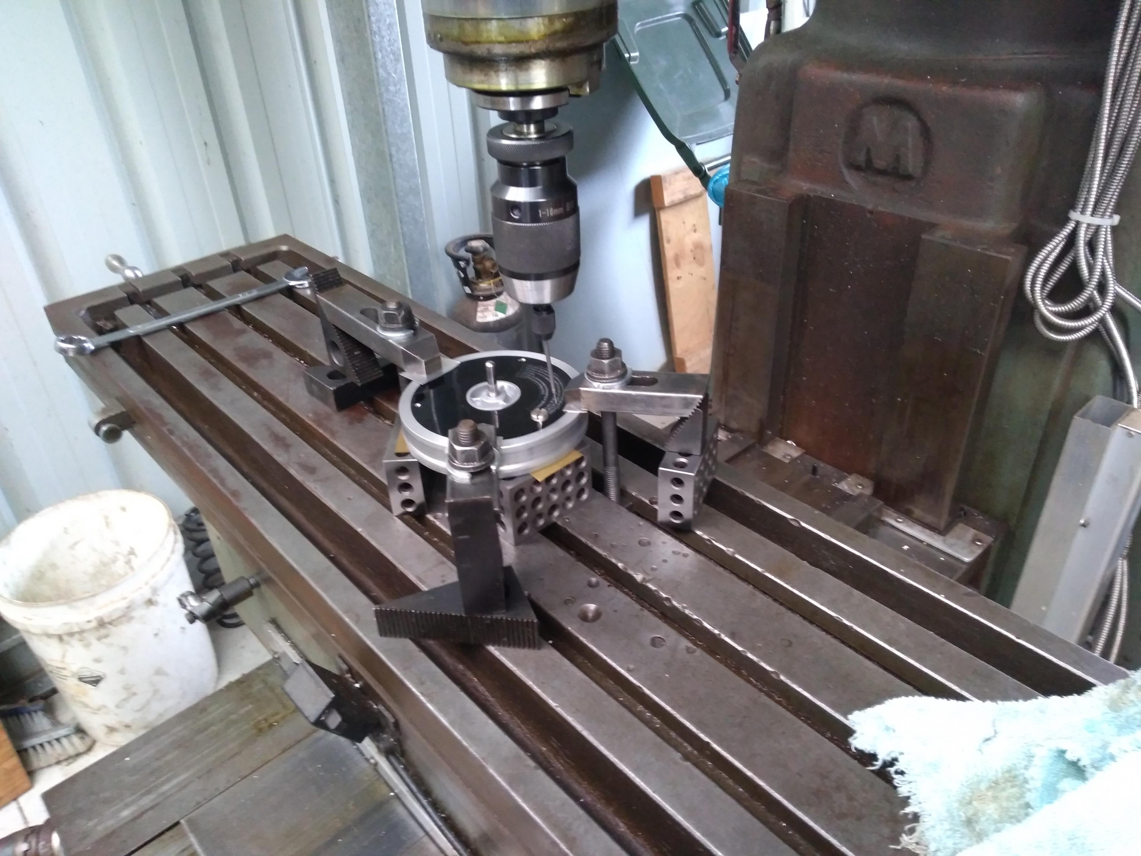

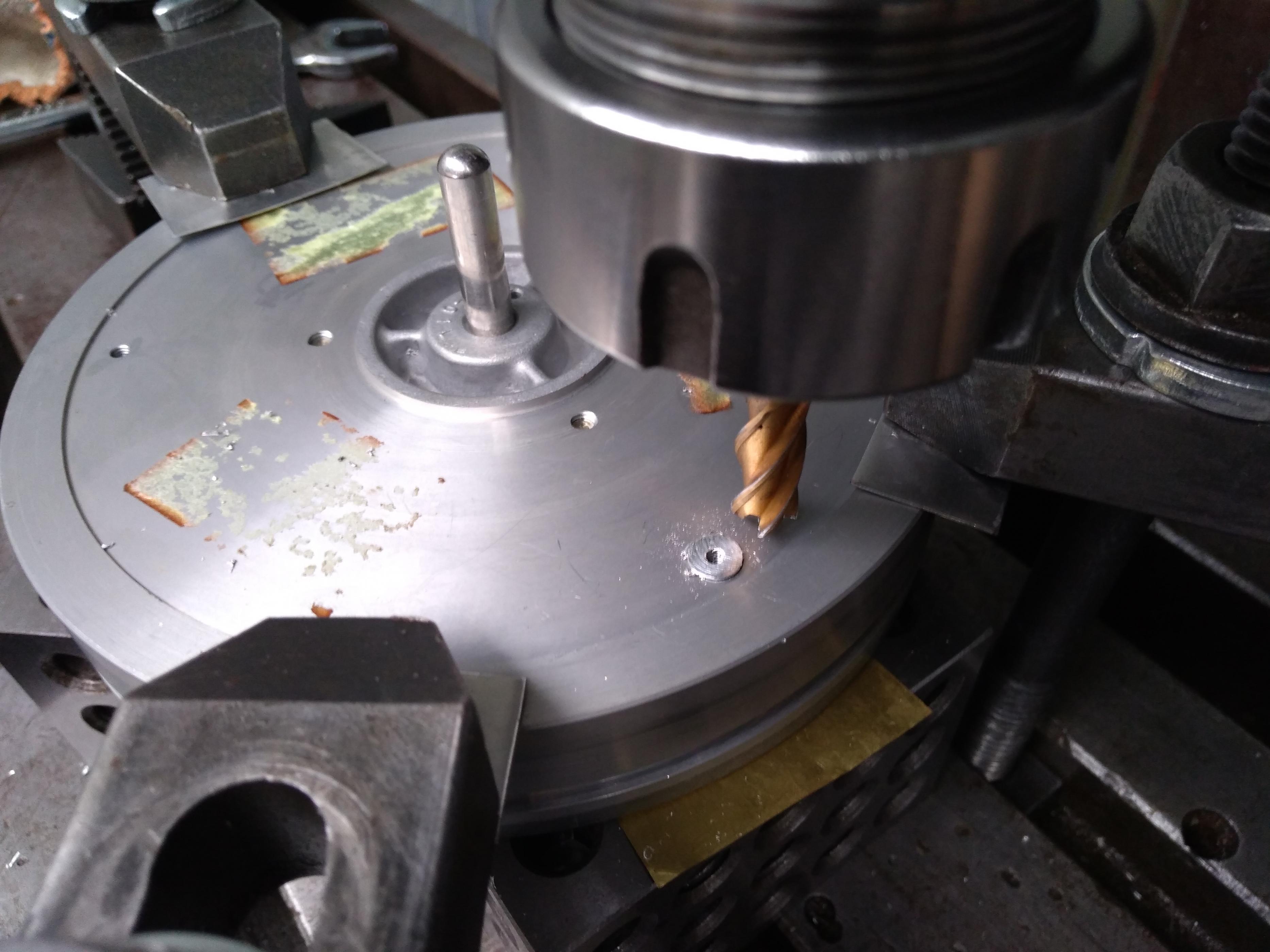

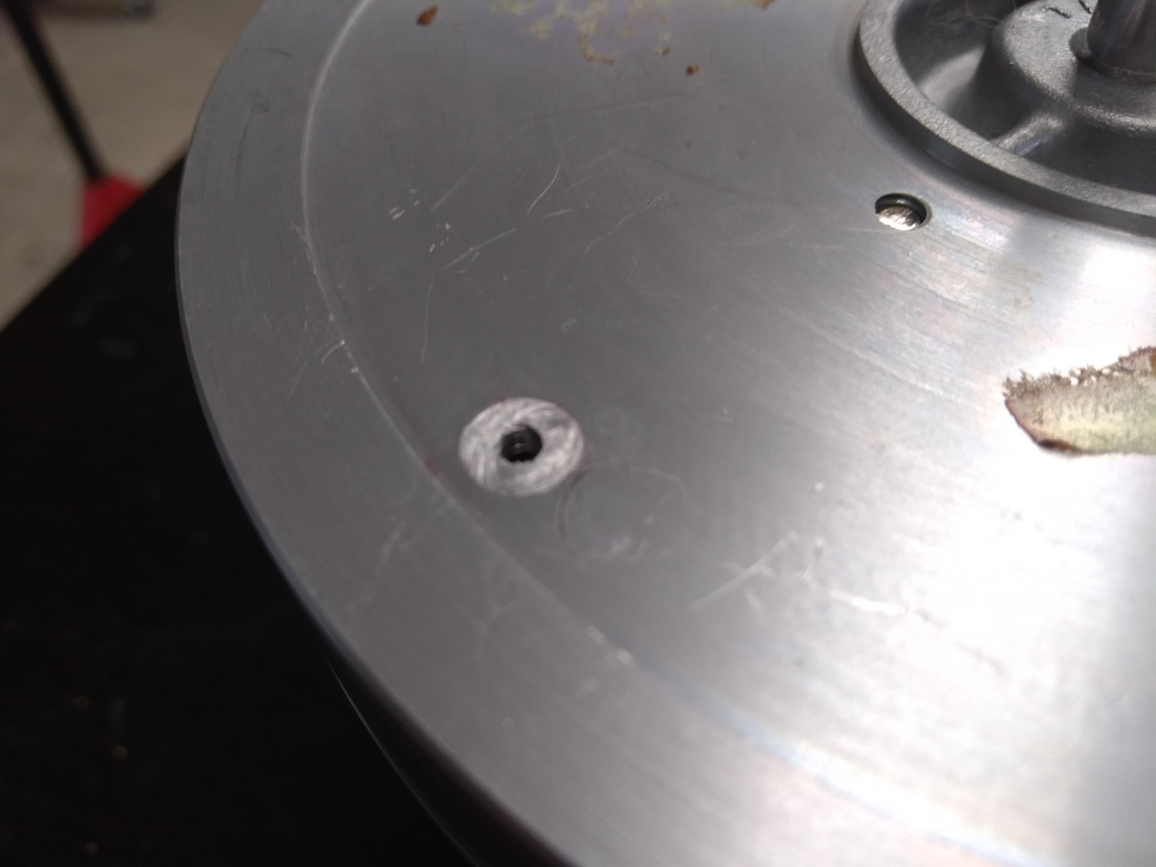

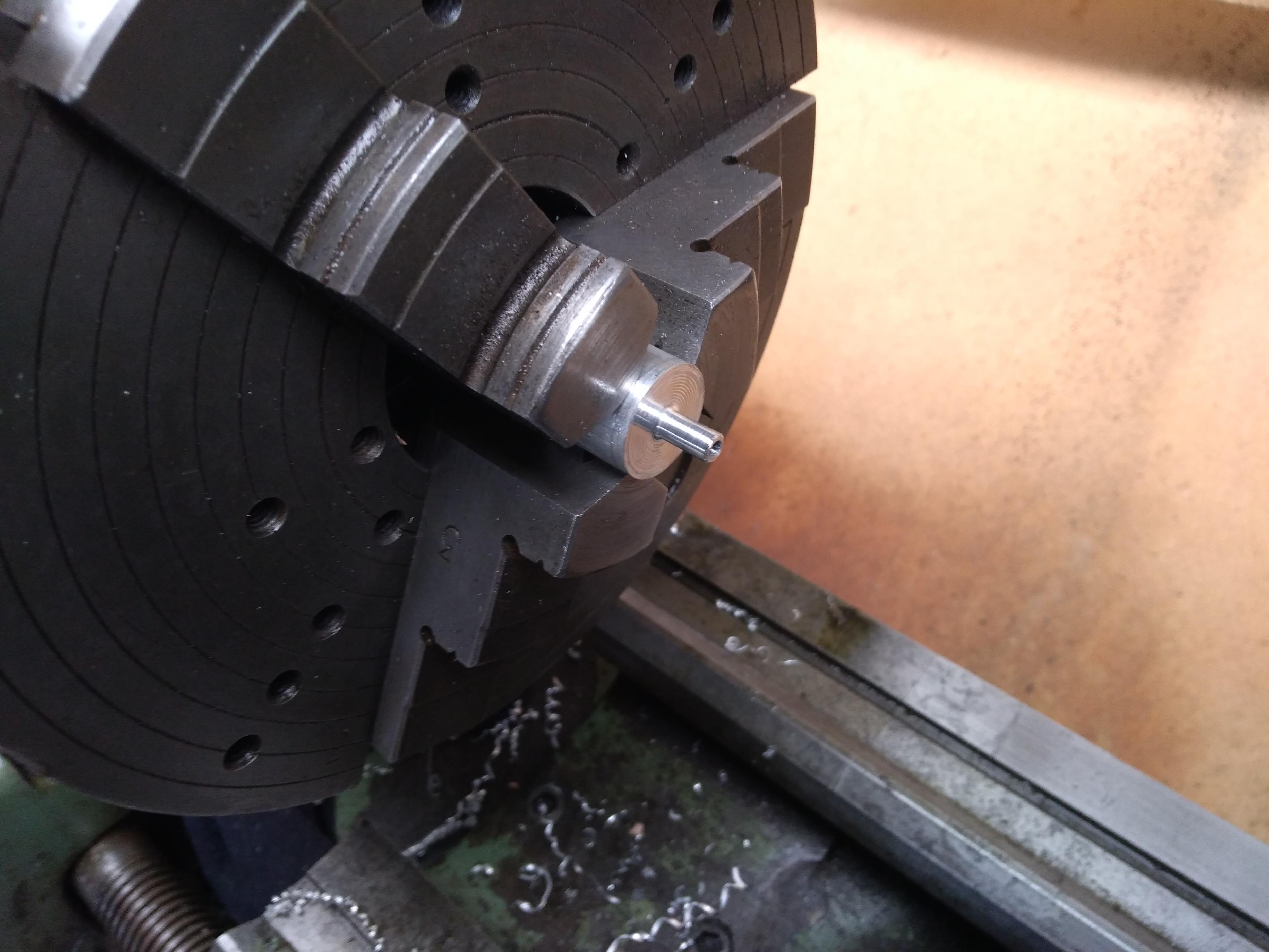

Started to repair the sub platter today.
First pic I'm setting up to centre the quill on the damaged thread. Milled the hole out 6mm and turned up a plug to fit. I've glued the plug in with permanent loctite. I figured the load is lateral so little to no force upwards on the thread.

I put the platter in the lathe today and polished the rim. I lightly sanded the platter top with 240 but didn't polish it.

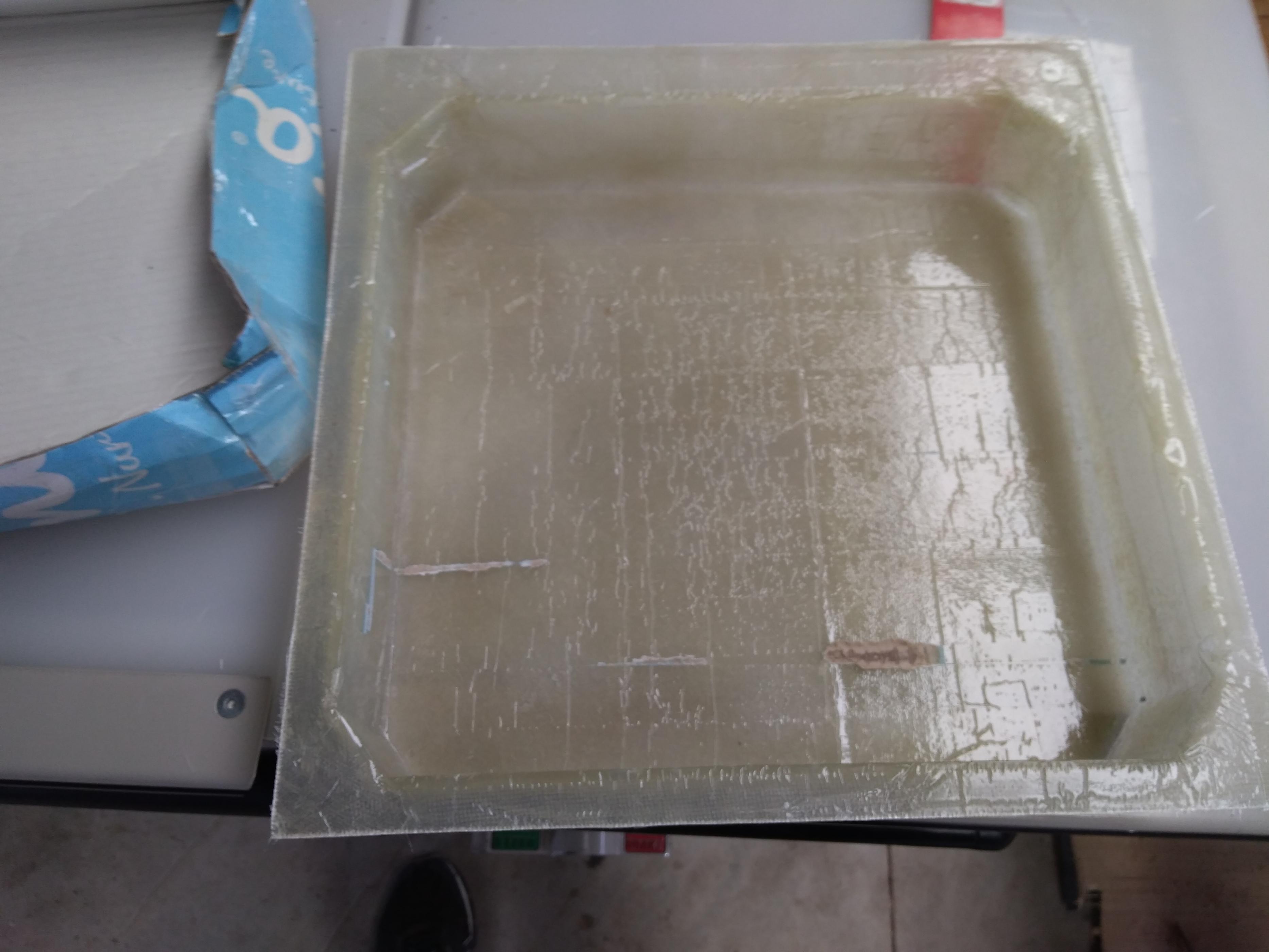

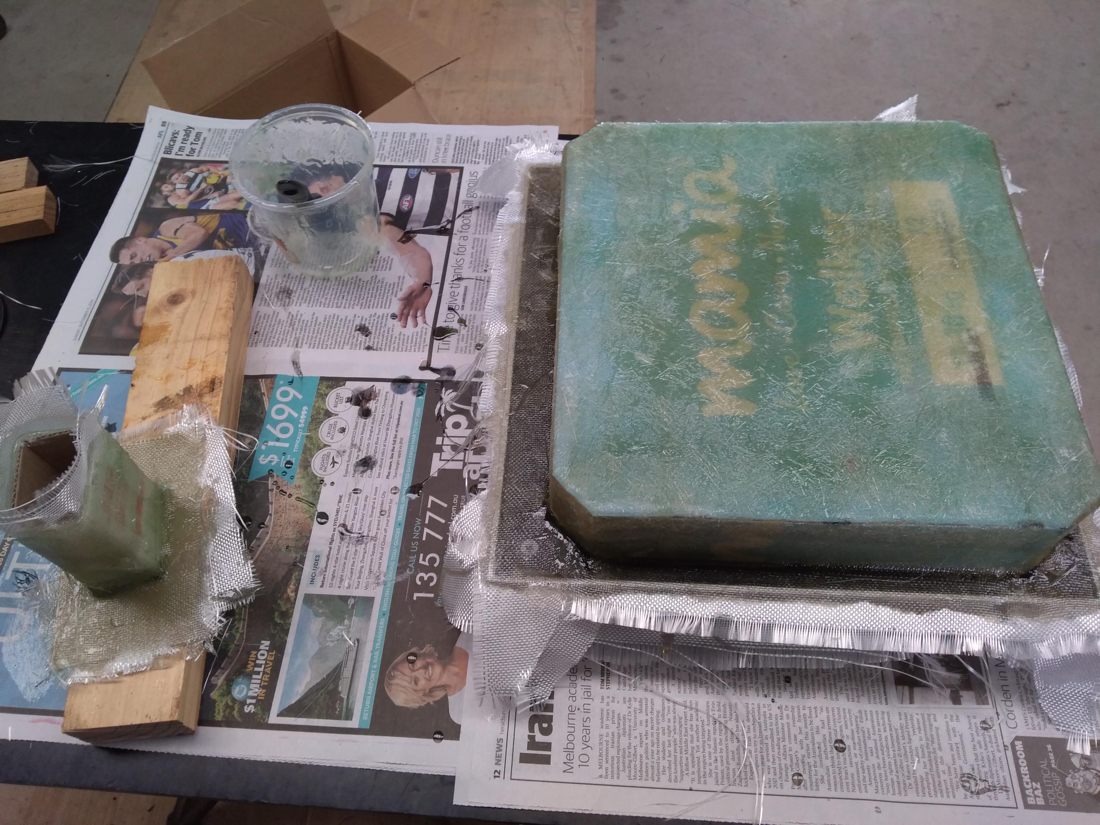

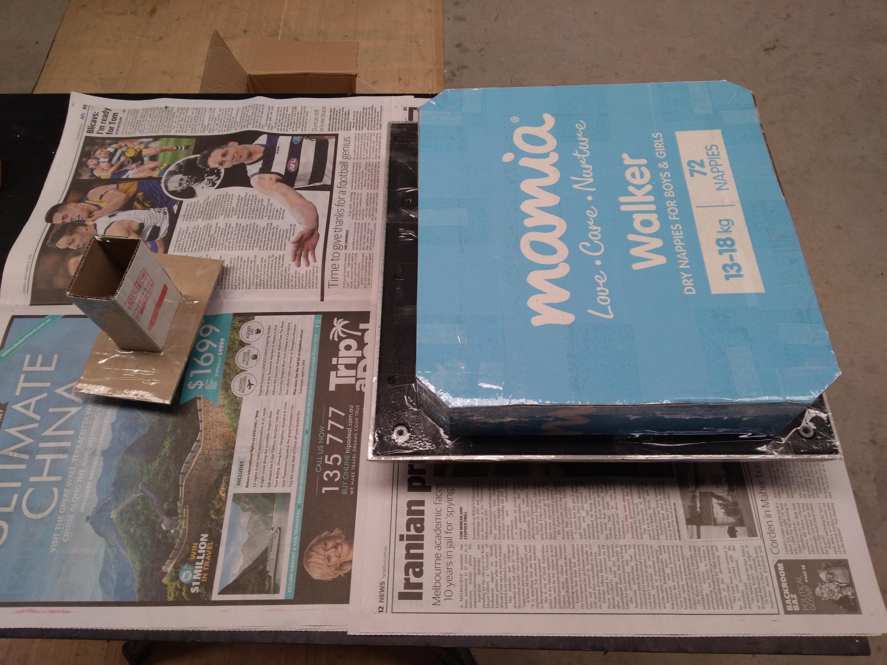

Some progress. I made 2 holes............. I figured it would be easier to mould the holes for the SP10 and tonearm instead of having to machine holes into the resin. I made a cardboard cover for the bottom of the SP10. This allows a little wiggle room to move the TT around to square it up. I have ordered 20kg of ISO resin which has not arrived yet so I made this with regular resin.

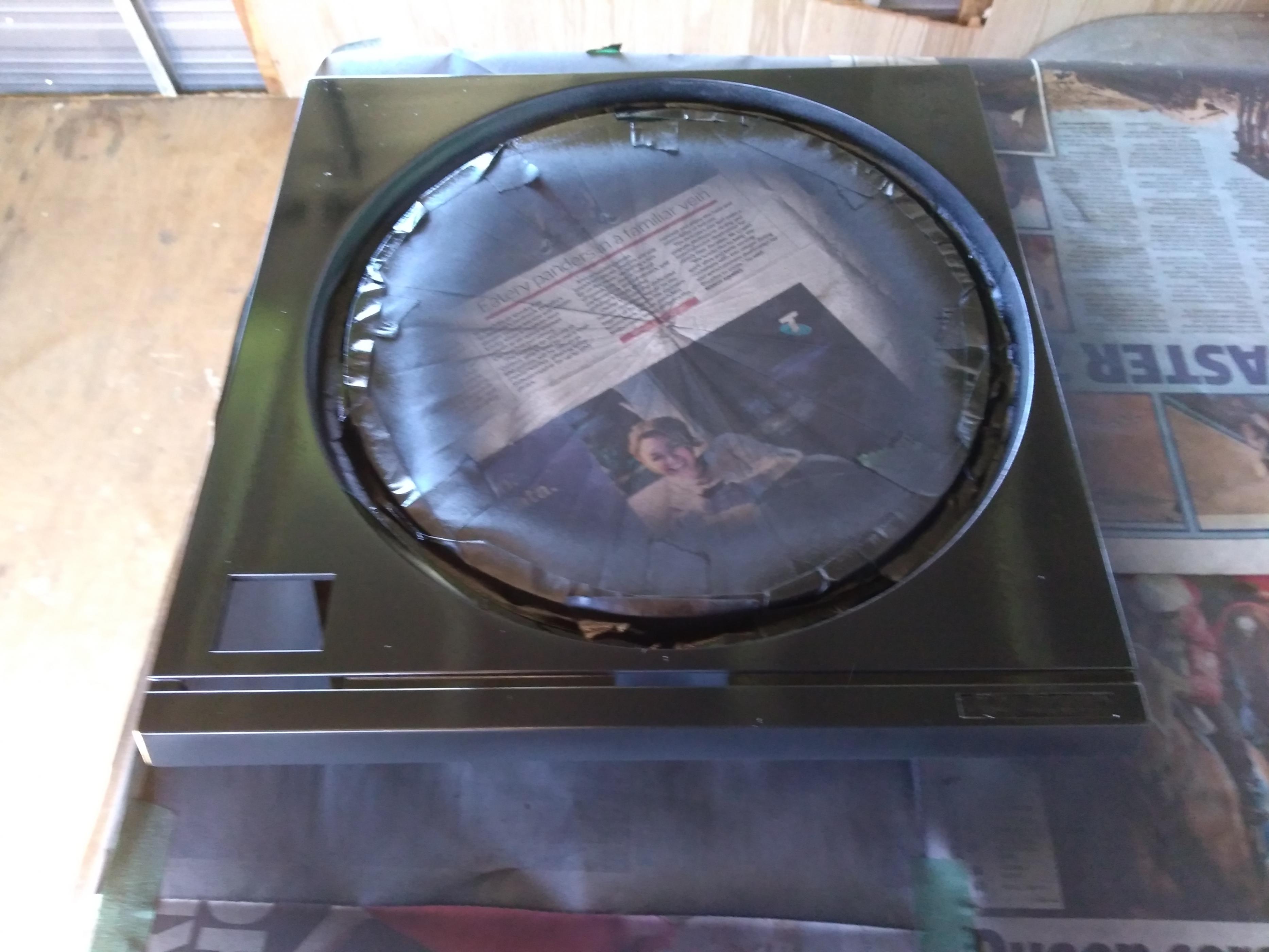

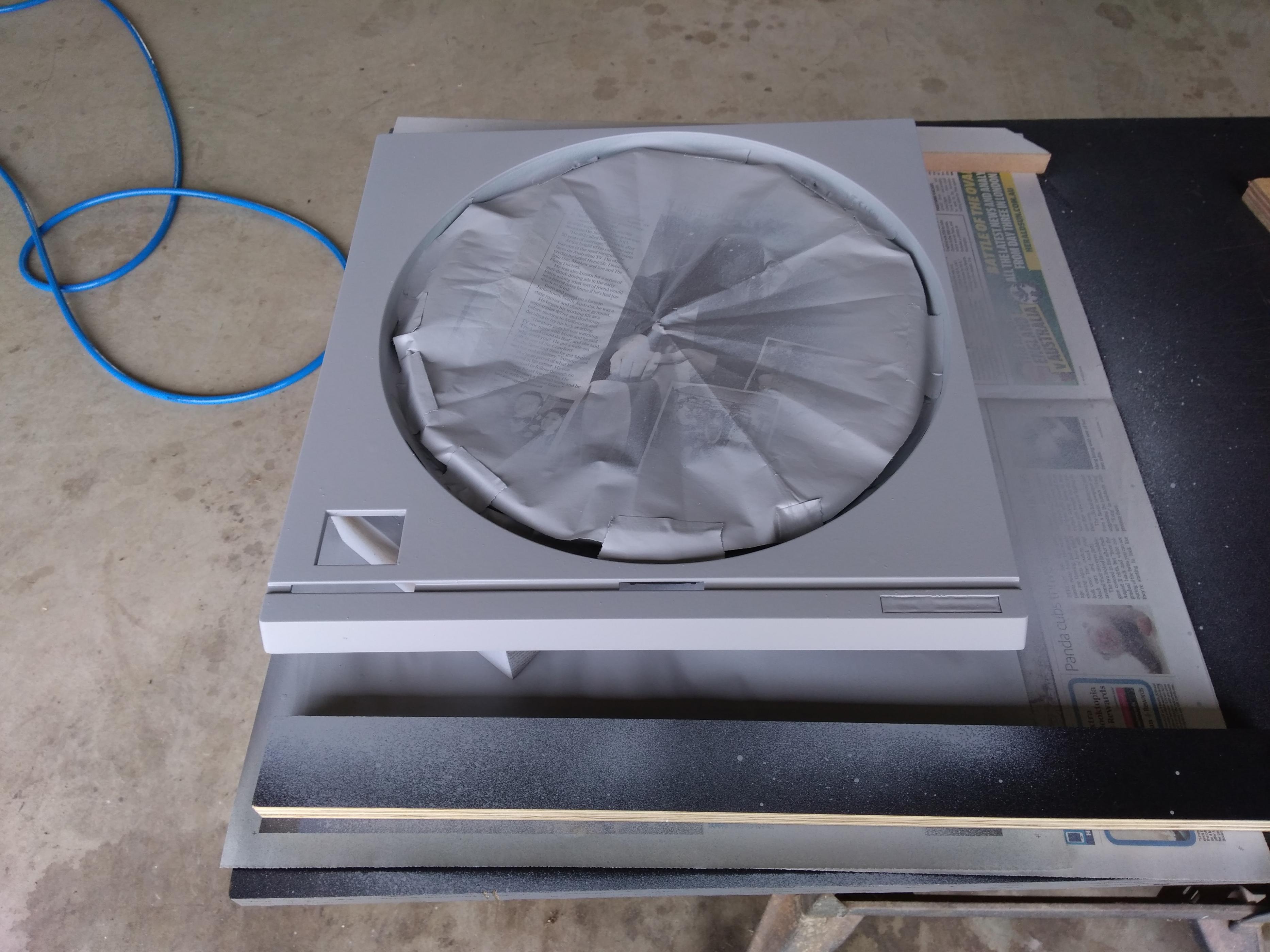

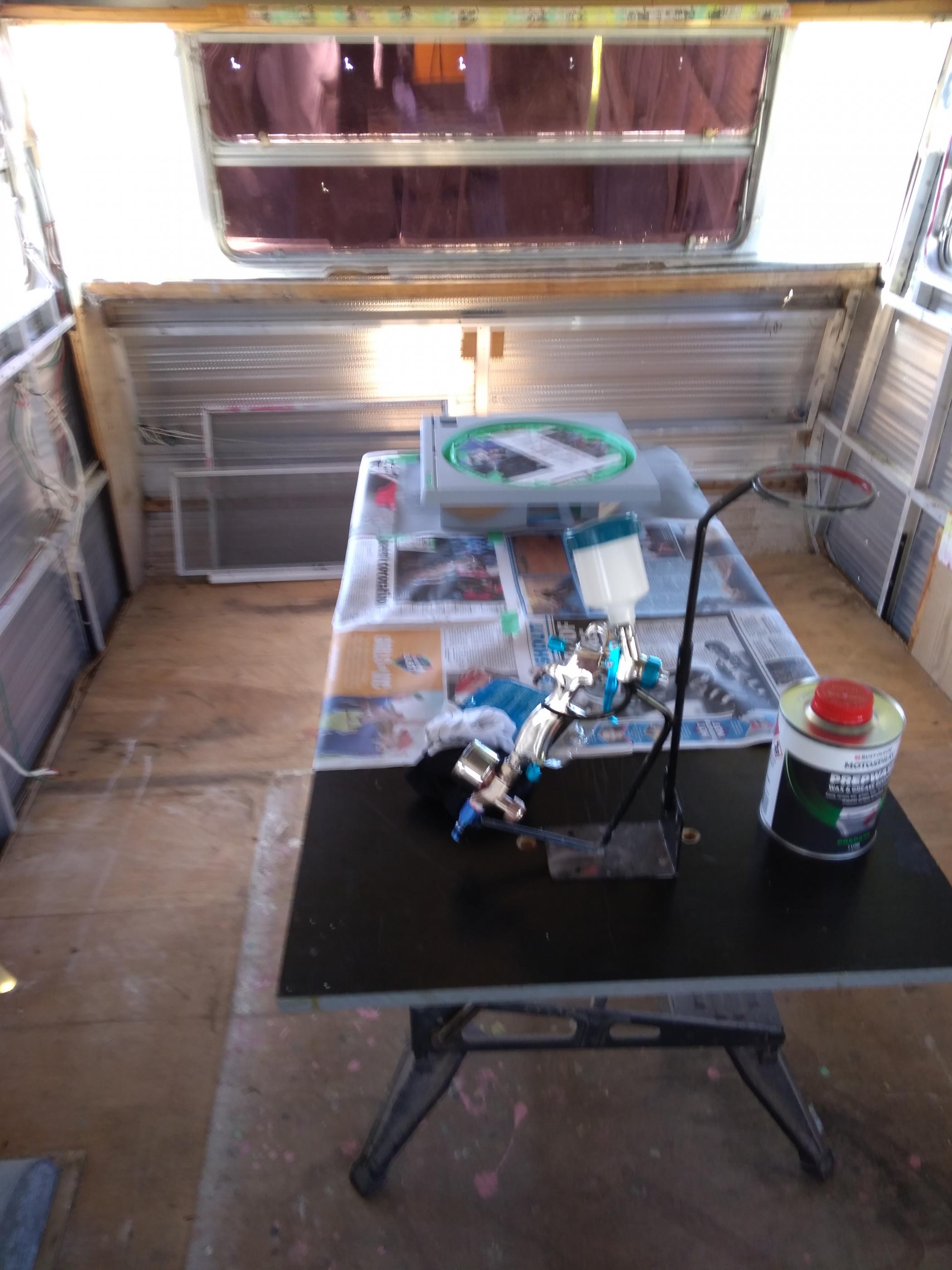

I decided to paint the SP10 black as I have some chassis black left over. I have an old caravan I used for storage which I used as a spray booth. Primer was sprayed with a rattle can and top coat I used the gun. As careful as I was with cleanliness I still got a bit of dust in the top coat.

@warrjon
Nice job, but you could also paint it all over the frame so you didn't waste time covering some parts.
The frame where I have masked is raw and not painted. I didn't paint the whole frame because I did not want paint on the motor mounting surface.
Is there a valid reason to avoid painting? I have always painted the whole chassis above and below.
Will painting the whole chassis make a difference - I do not know.
I wondered why Technics went to the trouble of NOT painting the inner chassis where the motor mounts. In a production environment it would have much easier/cheaper to paint the whole thing.
So I decided to leave the inner chassis raw.
perhaps for the same reason that cars inside the doors or under the covers have little or no color than outside, saving on paint costs.
Where the eye does not see it is not necessary to show an excellent finish.
Yes but there is over spray inside the doors because they do not mask cars. My SP10 had no over spray so it must have been masked with something.
My thoughts were that paint is flexible and may effect the rigid coupling between the motor and chassis. Just a hypothesis so I didn't paint it.
I wouldn't overthink it. As to why Technics did what they did, it would probably make more sense if you saw the manufacturing flow at the time. Also, keep in mind that Japanese concepts of fit and finish are not the same is USA.
Why not make a seal - similar to a speaker driver interface to the speaker cabinet? The practical use of this is that if you use paper of the type children draw on with crayons you will damp some of the motor vibrations from reaching the top-plate. Such paper has been used very successfully as interleaf layers in stacked sheet stacked + bronze plinths.
