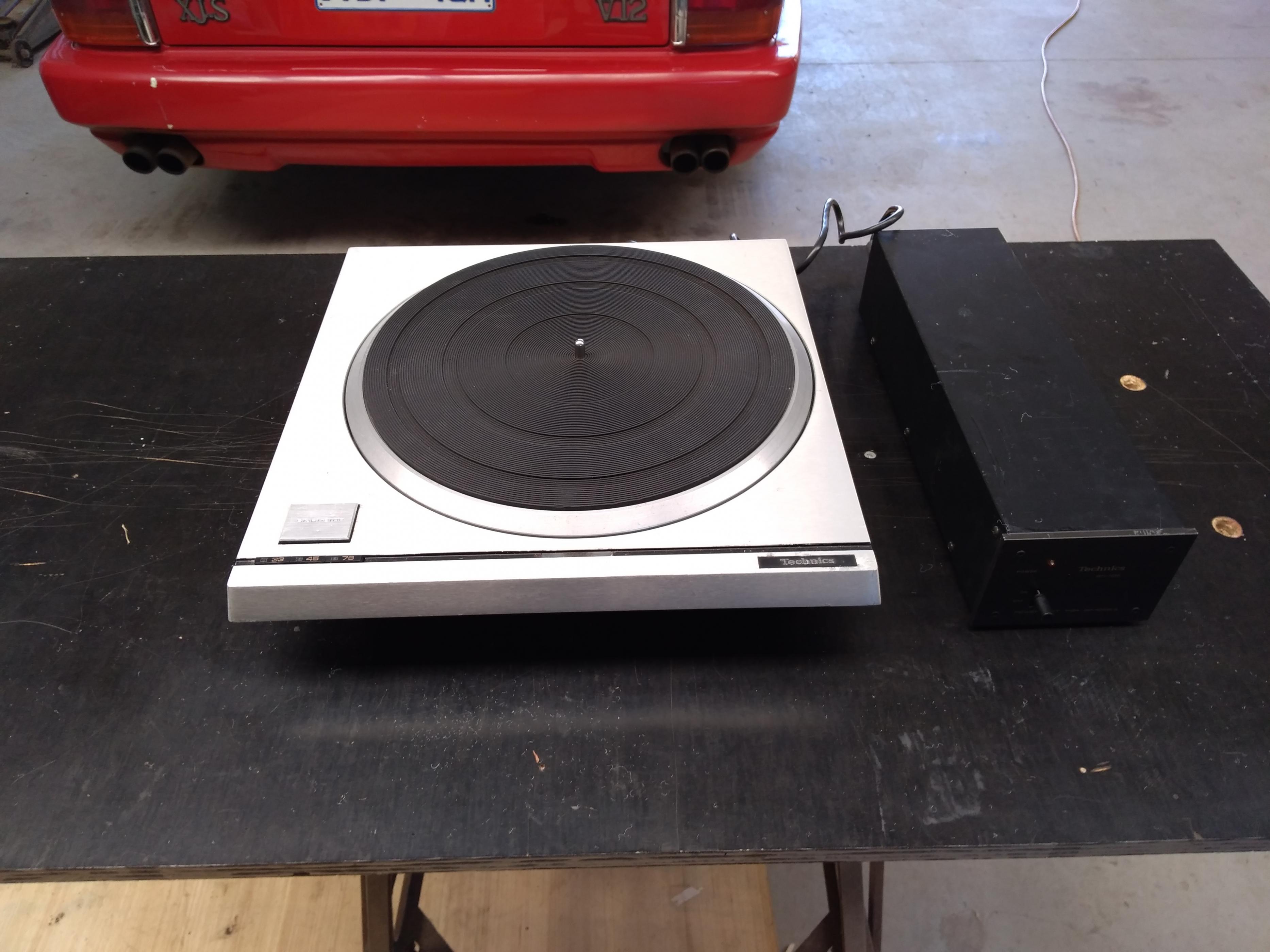

Finally my SP10 arrived.
Set it up and gave it a test. Bearing spins well. I have ordered a new thrust pad, ceramic bearing and oil. I'll pull it down strip it and paint it Black, or maybe gun metal grey........... Time to build a plinth...
I have a few things to fix.
Runs slightly slow. I only have 1 scope probe, I've ordered another so I will adjust the PLL as soon as it arrives

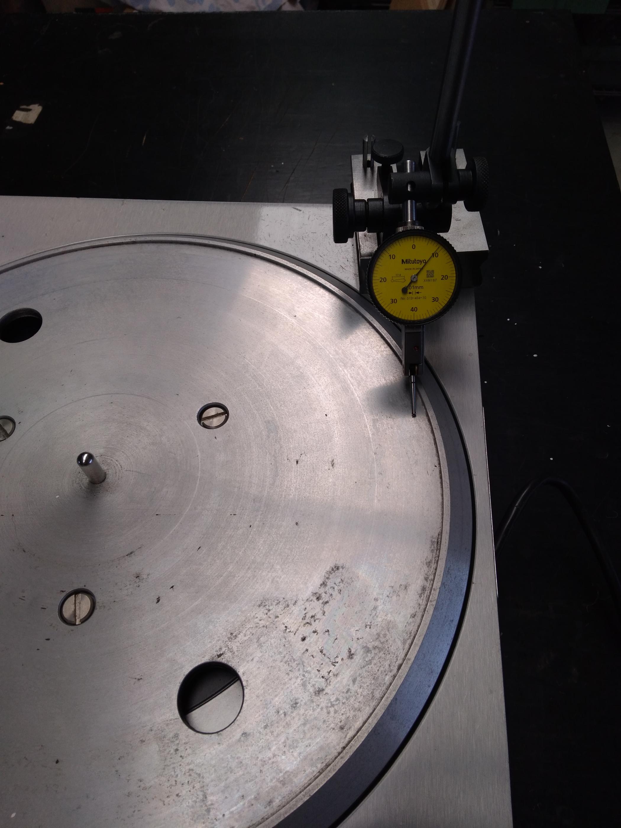

One of the platter mounting screws is stripped in the sub platter. Haven't decided how to repair this yet, I may either drill it out to 8mm and insert a plug then re-tap - or re-drill and tap all 3 M4 and make new mounting screws, jury is out on this one.
Checked platter vertical runout and 0.09mm (0.0035") This maybe due to stripped thread. I'll polish the platter in the lathe then check it again once I have repaired the stripped thread.
I'll re-balance the platter and sub platter once I have repaired and polished it. More work I need to build a balancing rig.

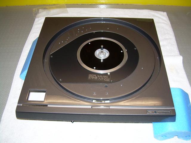

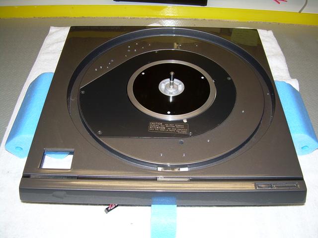

Hi guys I have just finished one of the sp 10 II purchased as part of spare parts after a couple of years of free time work.
There are too many photos to publish, so those interested in going to see the link are here.
Good work. I like the colour you painted it. What is the colour btw.
I hope to have mine operational in a month..... My biggest problem is I live in a rural area so I have order everything online and wait.
color for car body
Standox brand / Fiat car
color code 628 gray slate name
Looks great! Did you clear over the black stripe or did you mask it?

Hi the description explains that the whole frame has been sandblasted, the black strip has been completely redone.
I was undecided whether to make it silver or black, then for aesthetics I preferred to make it black strip.

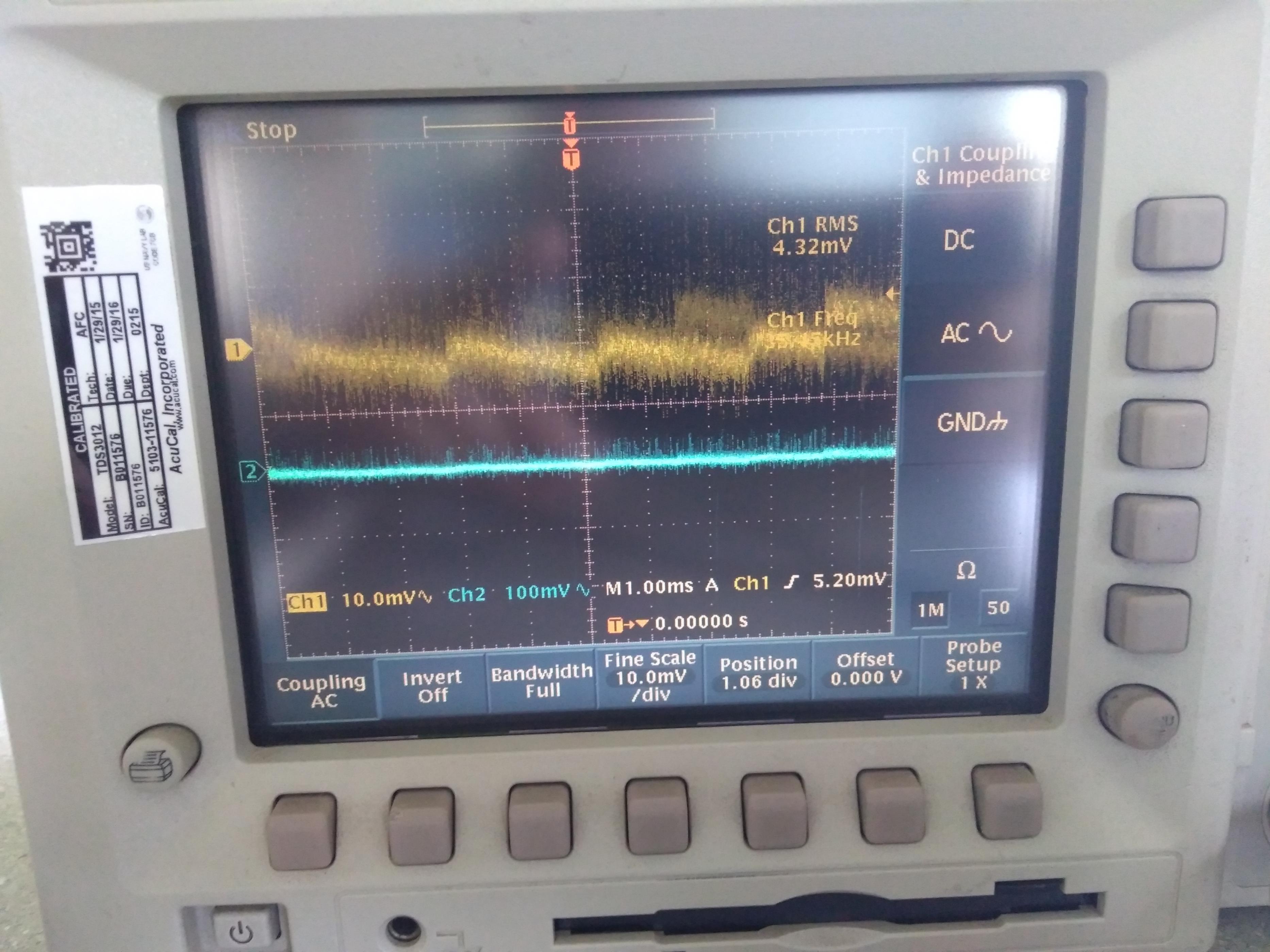

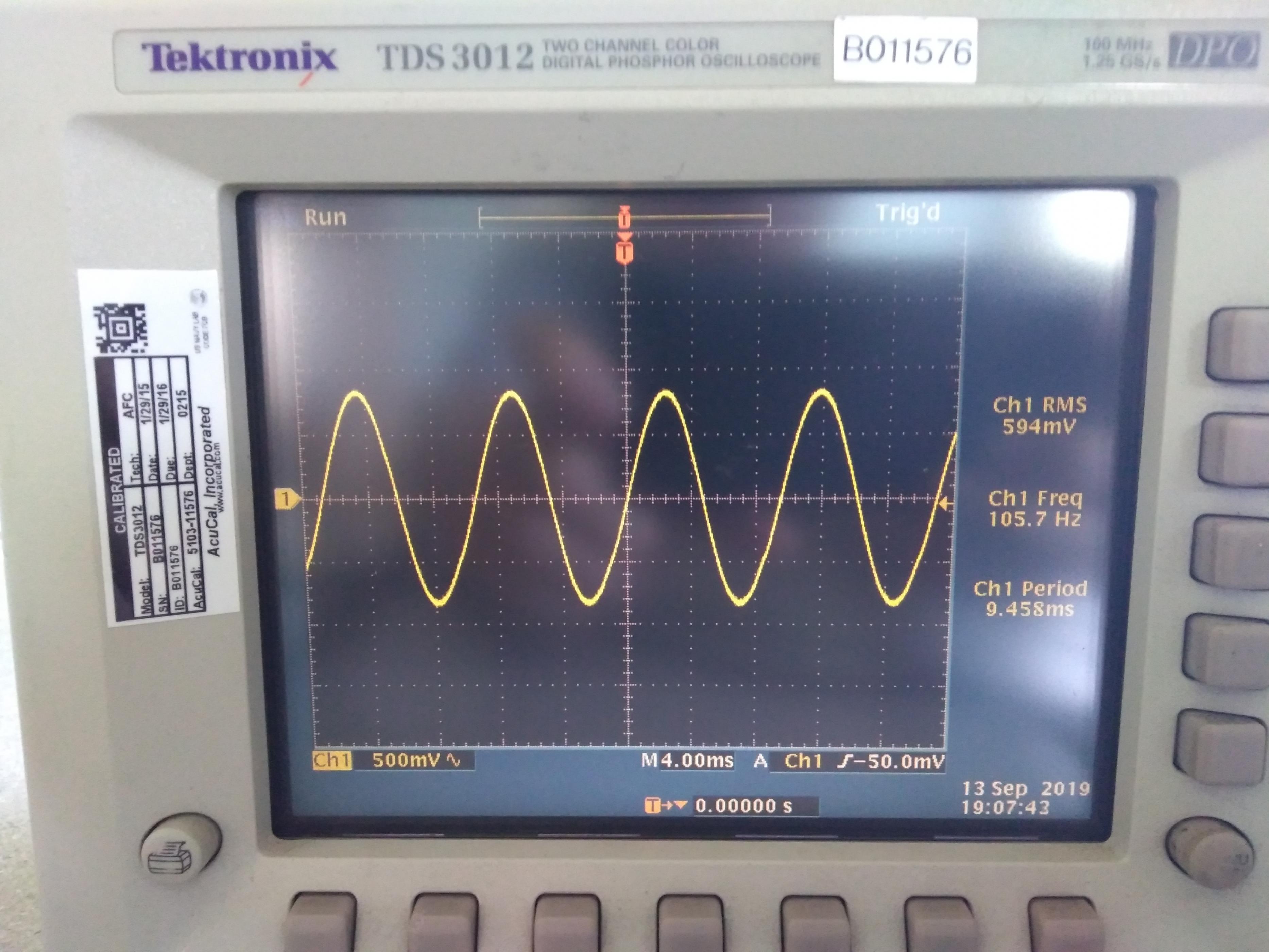

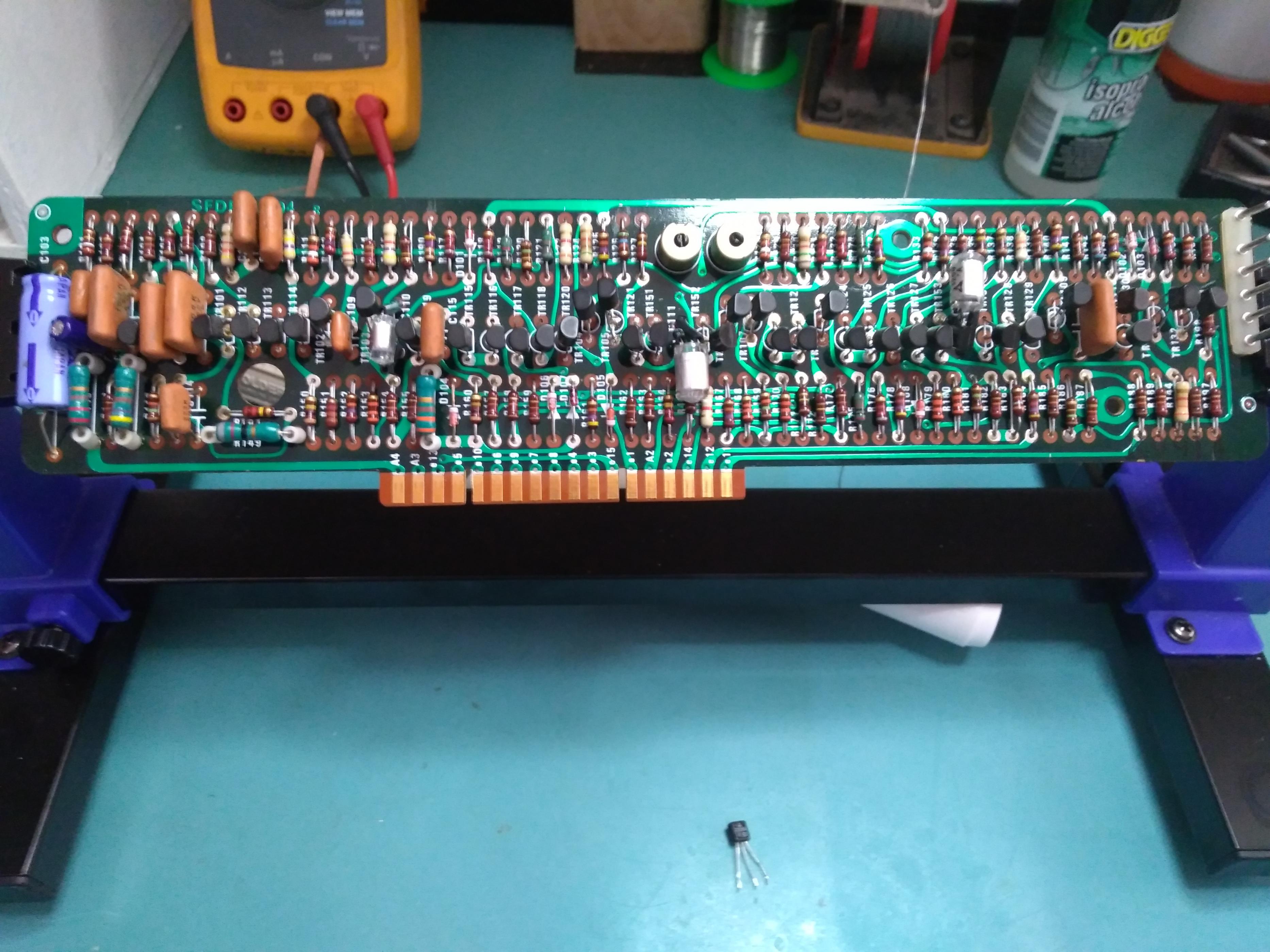

I knew the TT was running fast on 33 and 78 but I got a reasonable deal on it.
I spent a couple hrs today diagnosing the problem which turned out to be a bad transistor TR129 in the Control Circuit board.
First pic is period adjustment waveform pretty yuck, 2nd pic is the input to the CC PCB so the issue is most likely on the CC. The wave on the base of TR109 was good and base of TR129 nothing. These are a 2SC828 and one substitute is KSC1815Y and are available at RS Comp although I had to buy 200, I'm set for life to repair may SP10's.
Check the PS and tweaked the 32.5V checked ripple on both 32.5 and 5V less than 1mV so button it up and leave it.
Next is to repair the stripped thread in the sub platter
