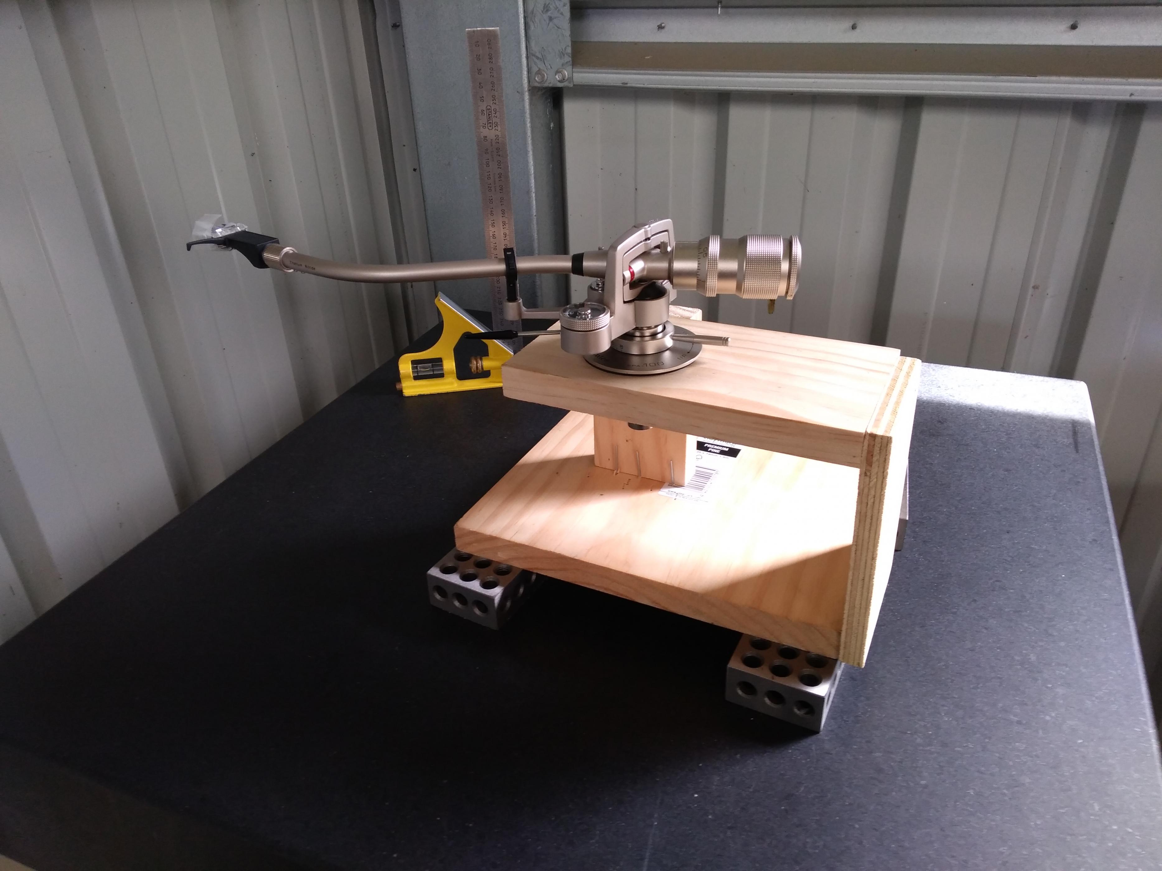

Arm arrived this morning, good on Australia post, the SP10 that is coming from NSW and posted 2 days before the tonearm that came from Japan is still not here yet.....

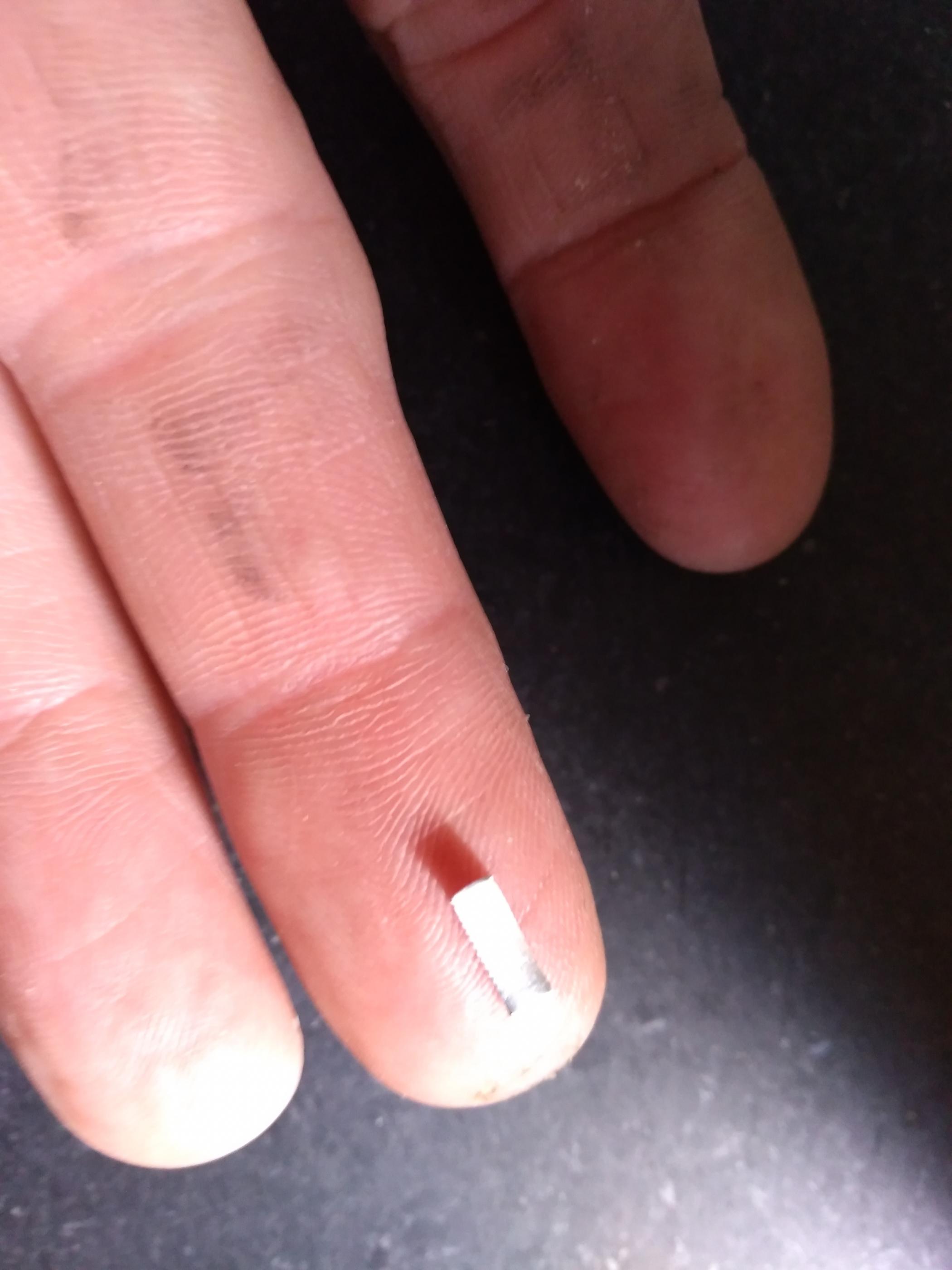

I built a frame to hold the arm while it sits in my lab. I thought I would check the bearing friction. I do not have calibration trim weights or a 1mg balance, so I guestimated 10mg and cut a bit of aluminium flashing to put on the headshell.
The arm looks brand new, even the headshell has not a mark on it. The bearing are in tip top shape, you can see the top horizontal bearing with a loupe and it is pristine. to say I am pleased is an understatement. Can't wait to get the SP10 and the EPA mounted and spin some vinyl.

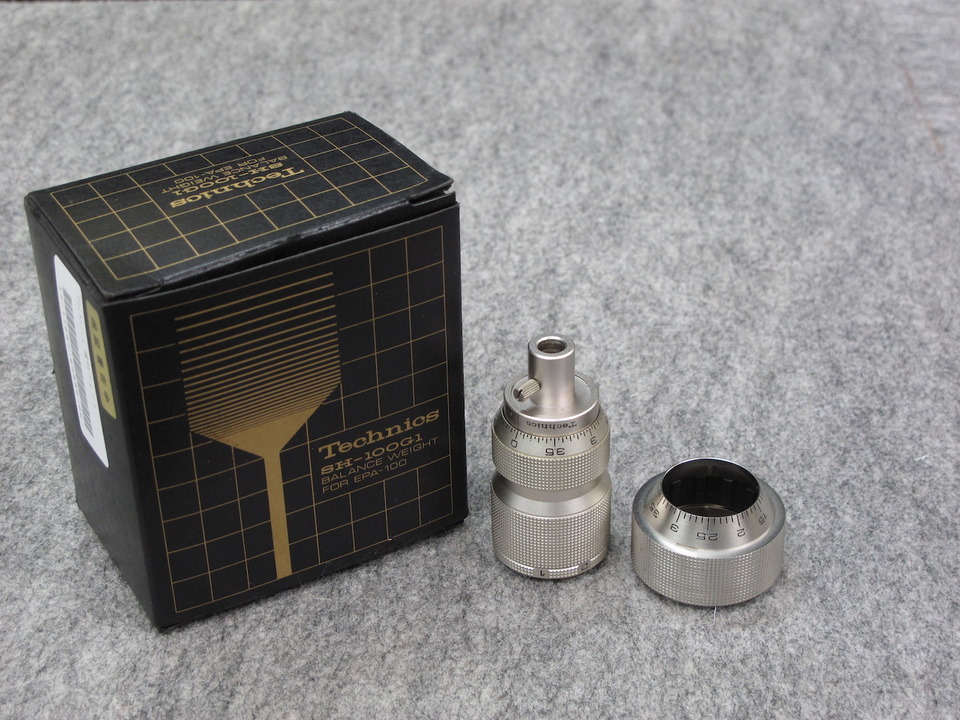

the EPA 100 allows a rather vast choice of heads but like all tonearms it cannot do miracles; for heavy MCs it is necessary to replace the original counterweight by applying the sub conterweight optional.
