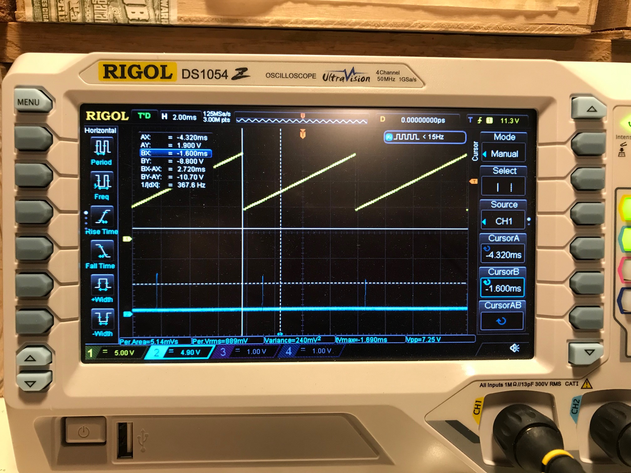

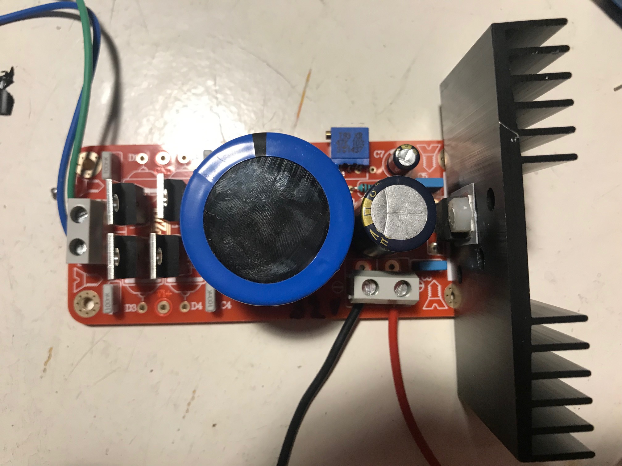

Alright, after being gone for quite a while, I managed to get myself back on the SP10...
Found the problem to be a bad PSU, so I built one based on MPBarney’s blog and 2 cheap PCB’s from eBay.

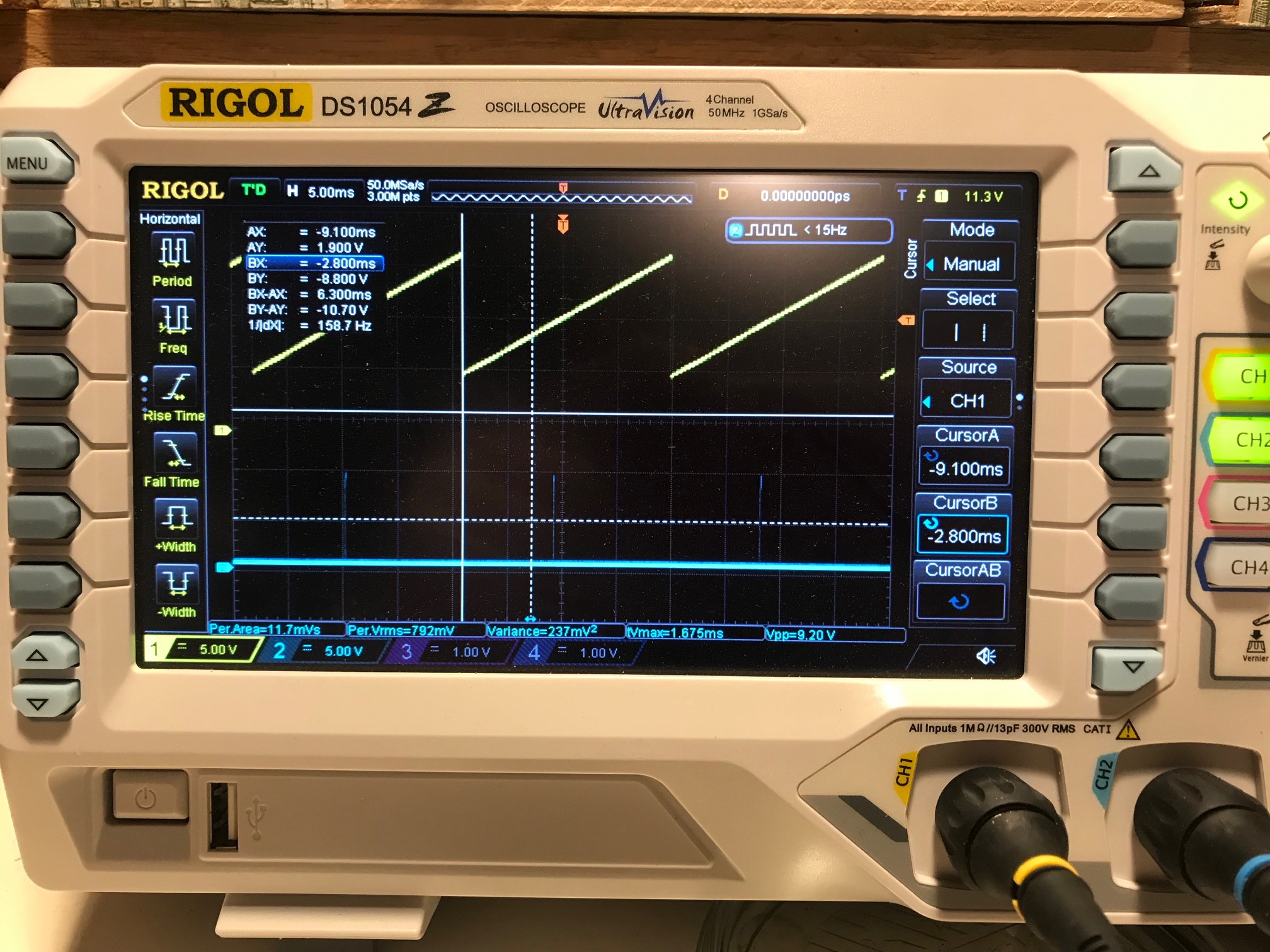

Voltages are correct and stable with the TT connected, so now I’m trying to set the PLL with a Rigol scope I picked up some time ago...
But I ran into a second problem.
I do get the correct waveforms on all three speeds and both channels, although the channel 2 waveform seems to fluctuate overtime (voltage increases/decreases) on all 3 speeds.
Turning trimmer 101 and 102 just adjusts the speed in which they fluctuate. The turntable refuses to lock, so speed isn’t consistent.
Am I still making sense? Anyone suggestions on what to look out for?
Anyway... Will post pictures later, when I get my laptop out of my luggage.
In the attached images, you can see the wave of channel 2 decreasing. It's more obvious in the 78 rpm setting, but happening at the 33rpm as well...
Picture of the 5V PSU board included as well, I use a 10 turn trimmer. I find it helps with precision.

At this point the TT’s start/stop switch started acting up. Switch functions when tested with a DMM. I can select the 3 speeds, and start the SP10, but it won’t stop turning when pushed to stop.
So I started measuring some things following the fault-finding flowchart... Unfortunately it doesn’t really give me answers.
As the speeds are off, I followed point (D): TT rotates abnormally.
Voltage at point e15 = 27,4vdc. 0,4vdc high so I measured TR115~118 and D101, 106 and 107
D101: Anode 27,71
Kathode 27,09
D106: A 6,62
K 5,919
D107: A 0,004
K 5,918
Tr115: E 0,04
C
B 0,778
Tr116: E 0,004
C
B 0,07
Tr117: E 0,004
C
B 0,08
Tr118: E 8,02
C
B 6,62
All of the transistors are way off... didn’t measure the collectors, bit fiddly to reach without a steady hand.
Anyone got any tips as to where to start looking? Would be greatly appreciated.
