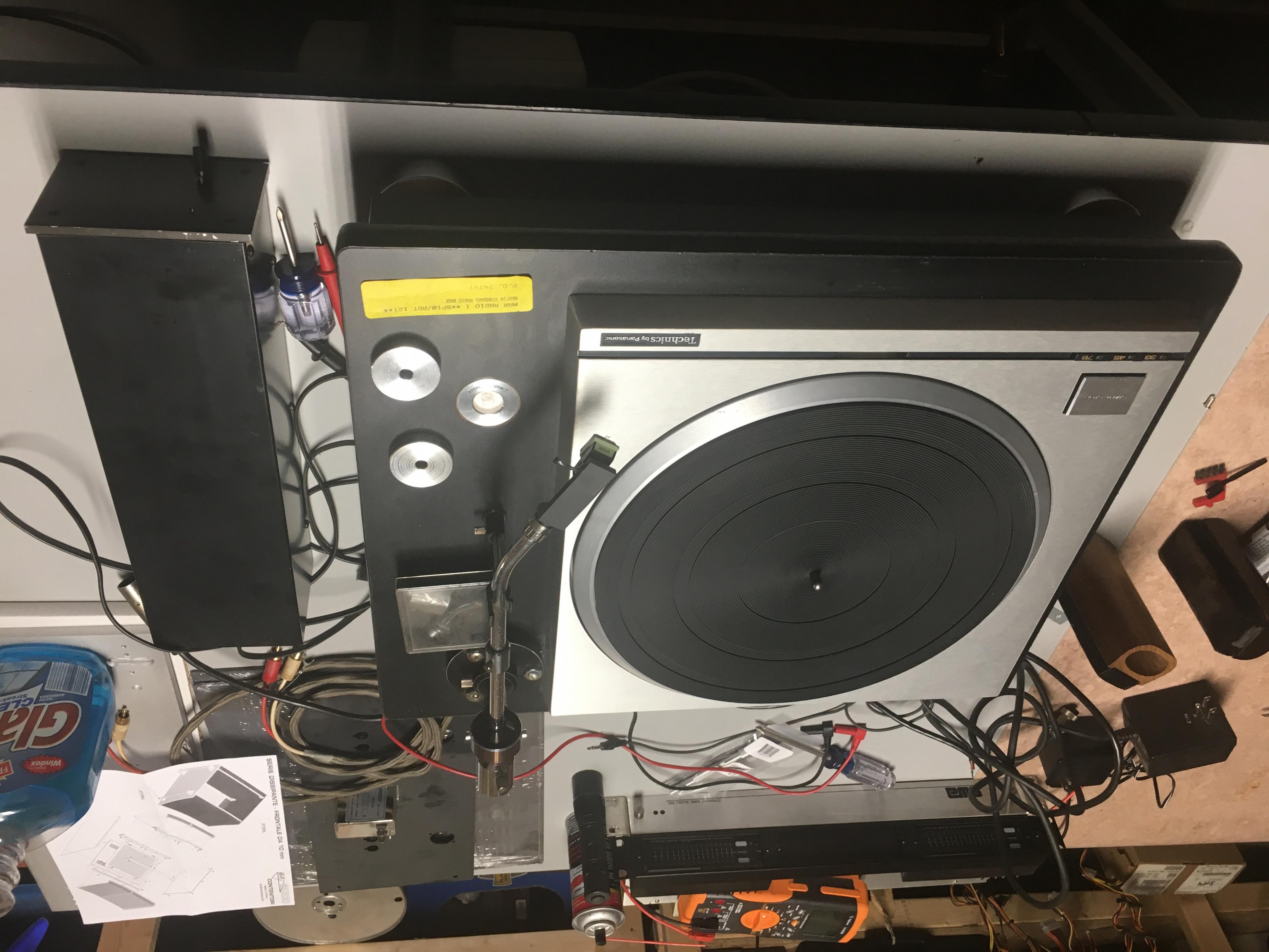

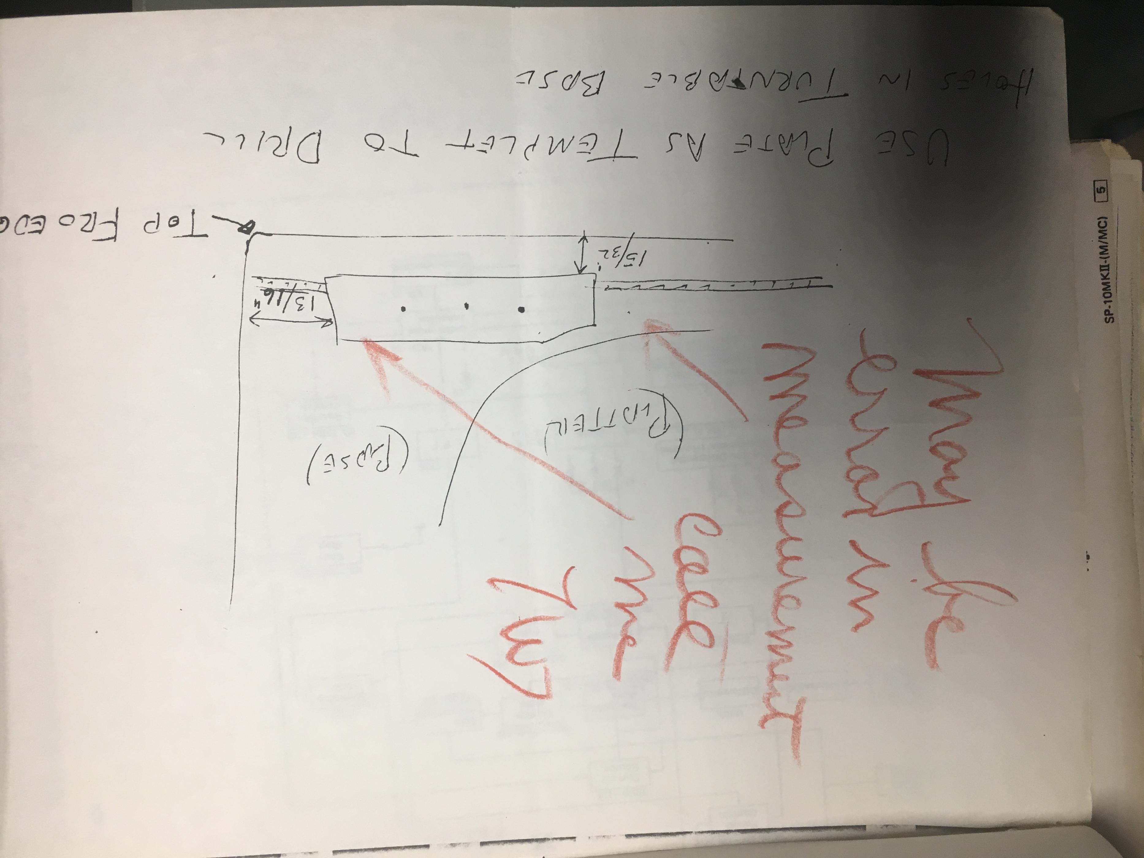

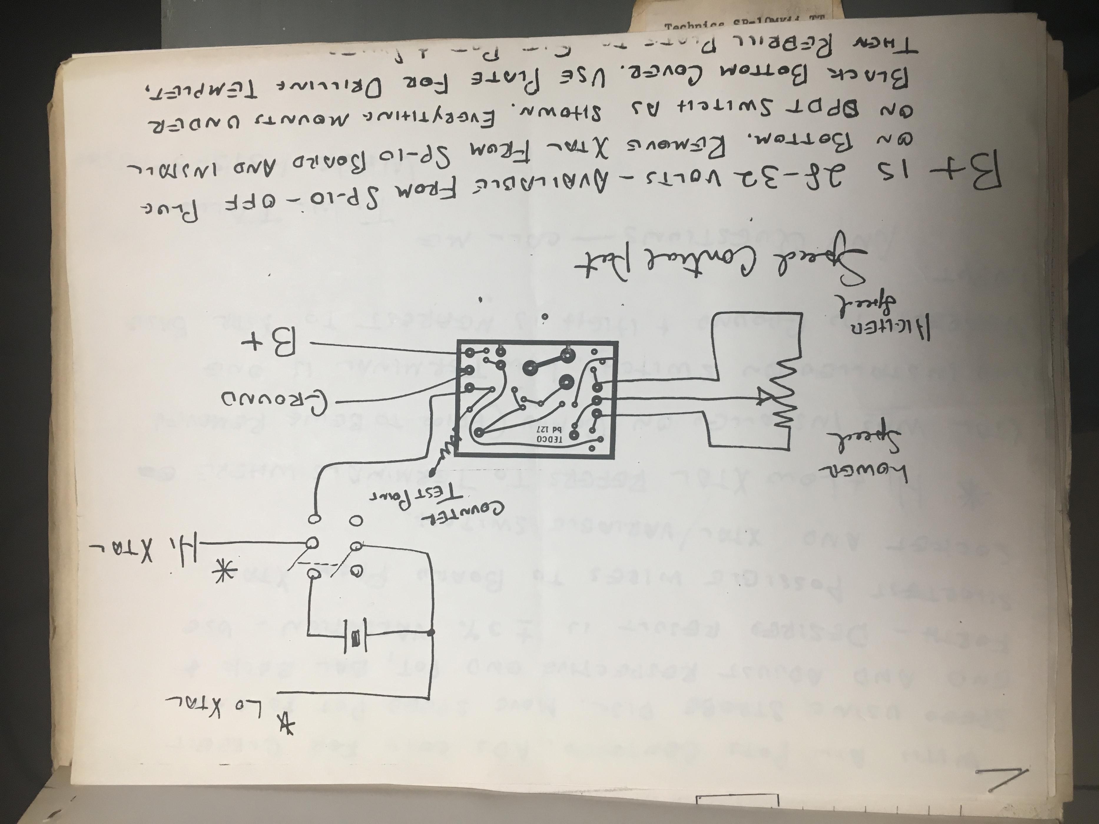

While I may have paid a little over the average for my SP-10MK2, I was able to pick up quite a few extras to go with it. Such as an admittedly ratty looking broadcast plinth and atp-12t tonearm. I also got a Straight Wire Audio rack-mount pre, and a lot of documents and manuals. Once I took into account the extras, I considered it a deal I couldn’t refuse...
This unit has been modified to be controlled from a mixing deck, but the mod looks to be easily reversed. I also have documents about a speed control mod, but thankfully this one never had it installed.
Edit: I apologize for the upside down pictures, stupid cell phone...

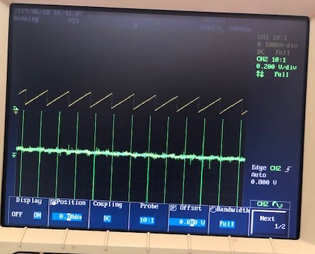

Hi Forks, I need your help.
I have two SP10 MIK2s. Both rotates with some sort of vibration at all speed.
I recaped power supply and changed C2, C4, and C6.
Scope shows wave point S and T are not in sync and T has some noise as well.
Which part should I check?
Any help would be appreciated.

Well...it works!
I made a routered-out temporary (test) plinth from a kitchen worktop off-cut in solid oak and bolted the motor unit into the recess. It has been running for some 6 hours with frequent speed changes along with many stops and start-ups.
Everything works except the strobe (damage to that section of the board). The new lead with all boards in the large PS (ex.BBC) case is beautifully crafted. All el caps are new as are most diodes and quite a few resistors. The case is a little low internally for the original Tx so I may eventually make a really solid replacement for the somewhat nasty original.
