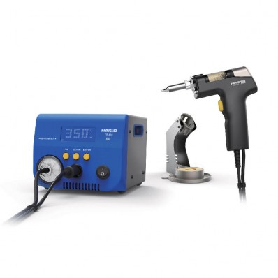

And is a desoldering station recommended, or a manual vacuum pump is OK? There are some cheapies on ebay at <$50. Would those work? I hate to buy specialized equipment that I likely won't use again.
A cheap desolder pump is going to cause headache, heartburn, and more damage. You need a really good desolder station, or a pistol type, depending on which you like holding better. Don't skimp, if you do the cost of the cheap one is just going to get added to the good one.

Well, I did my research and there are much cheaper ones available but the folks here and from the reviews universally suggested splurging on a quality one. Even the $150 ones do not have good reviews, but the Hakko has excellent reviews.

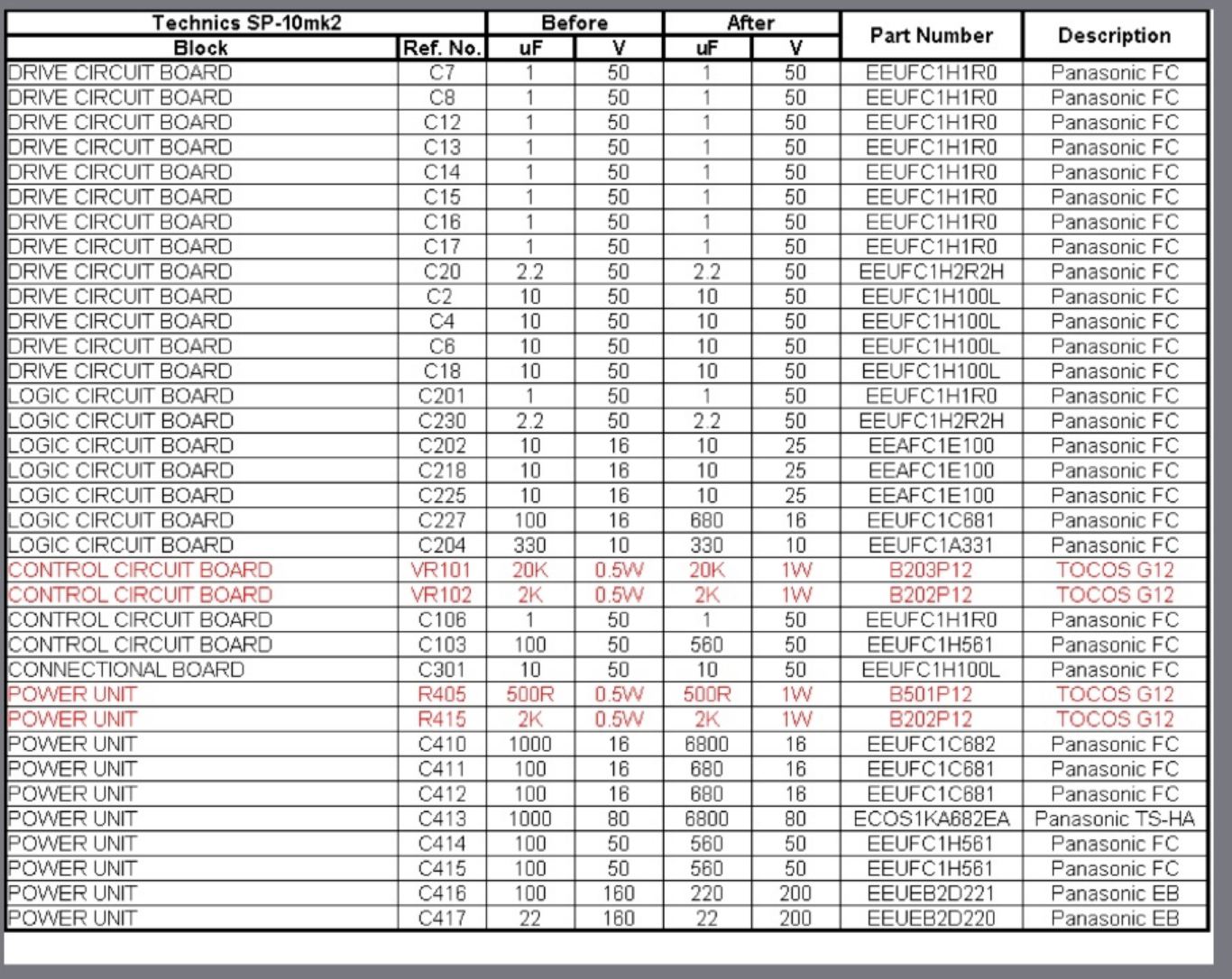

My deck went wrong tonight. Sudden speed wobble and horrible scratchy noise. Strobe all over and speed poor.
I swapped to my spare power supply and all is well (though the strobe light flickers using the spare).
Thankfully this seems to prove it’s the power supply not he motor unit! A further failsafe test was to plug in my spare sp10 and the same happened. Bad noise and speed. Must be the supply!
Guessing the fix is to recap and test the voltage rails?
If so, anyone point me to the list of caps I need? A mate can then order for me from the usual suppliers?
Anything else I’m missing here? I’ll recap both eventually but glad I didn’t sell on my second set quickly!
