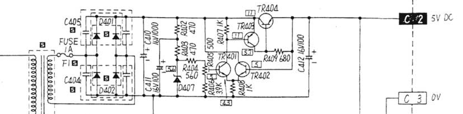

Good point. I'll poke around to see if there are dead critters on the 5V circuit. Any pointers?
5V is sensitive but 50mV low won't matter. That you can't get higher than 50mV is tell-tale of a issue, as is the overheating - seems something is drawing too much current.

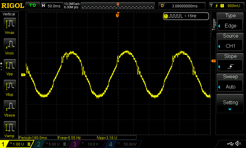

Hi Dave, I checked the waveforms on A1, A2, and A3, and basically they were garbage. It looks like a sine wave, but it is very distorted.
I also checked the 5V with a Fluke DMM, and it was dead on 5V. Earlier I was using a cheapo no-name DMM, but in the past it has read quite close to the Fluke.
Unfortunately, as I was measuring the 5V under the table I shorted between C2 and C4 or something, saw a spark, and now the table won't rotate. One of the fuses was hot and looks almost burnt. Will replace and see if it works. Really bummed I did that.

This is the drive waveform from a healthy 'table.
Were all 3 the same ? Is the PSU now OK ? and under load ?
Dave
All 3 were the same. JP's waveforms give me hope. Mine weren't too dissimilar, but I need to readjust the scope. Although, it is not starting anymore after the short. PS voltages appear to be OK.

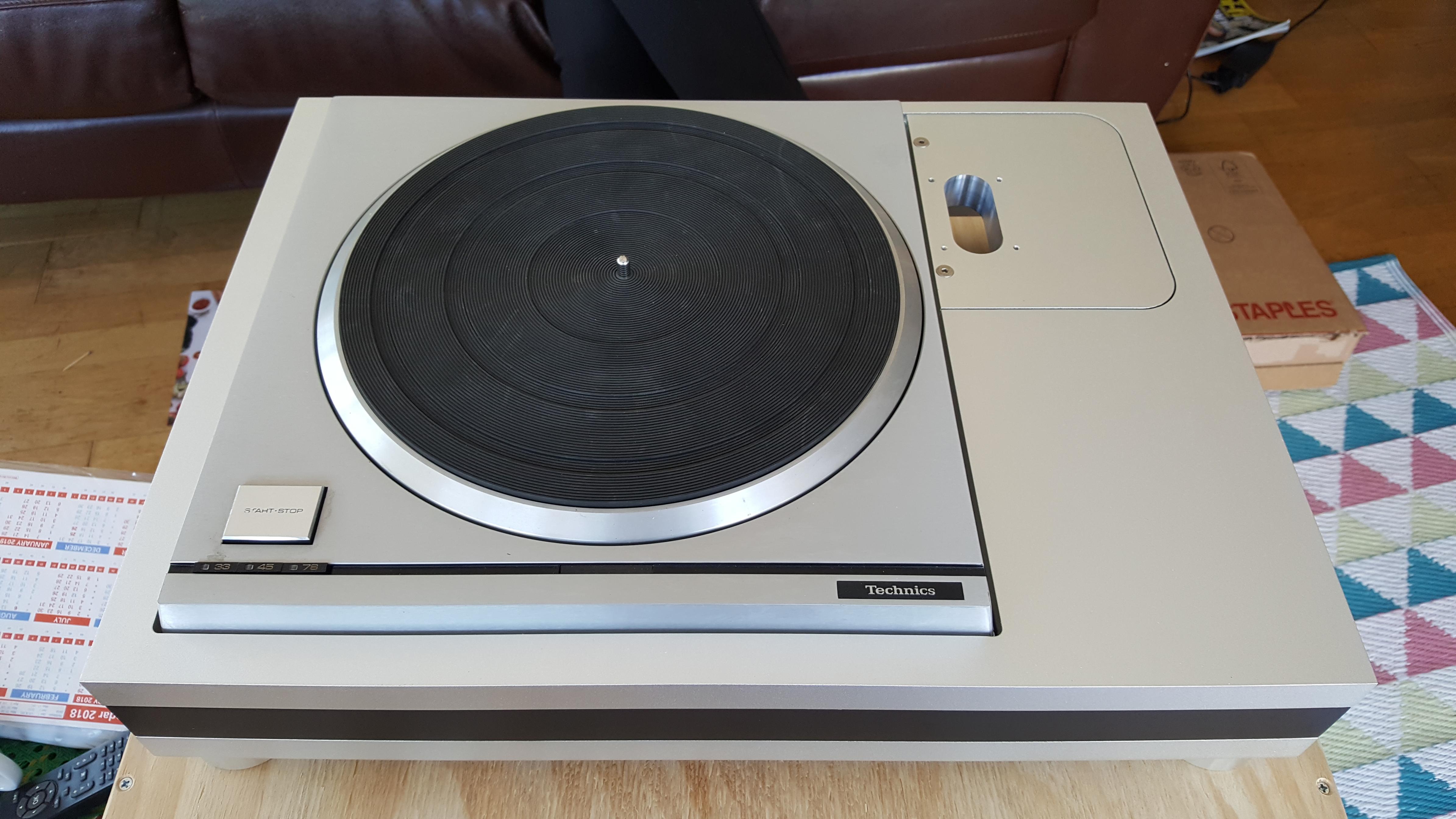

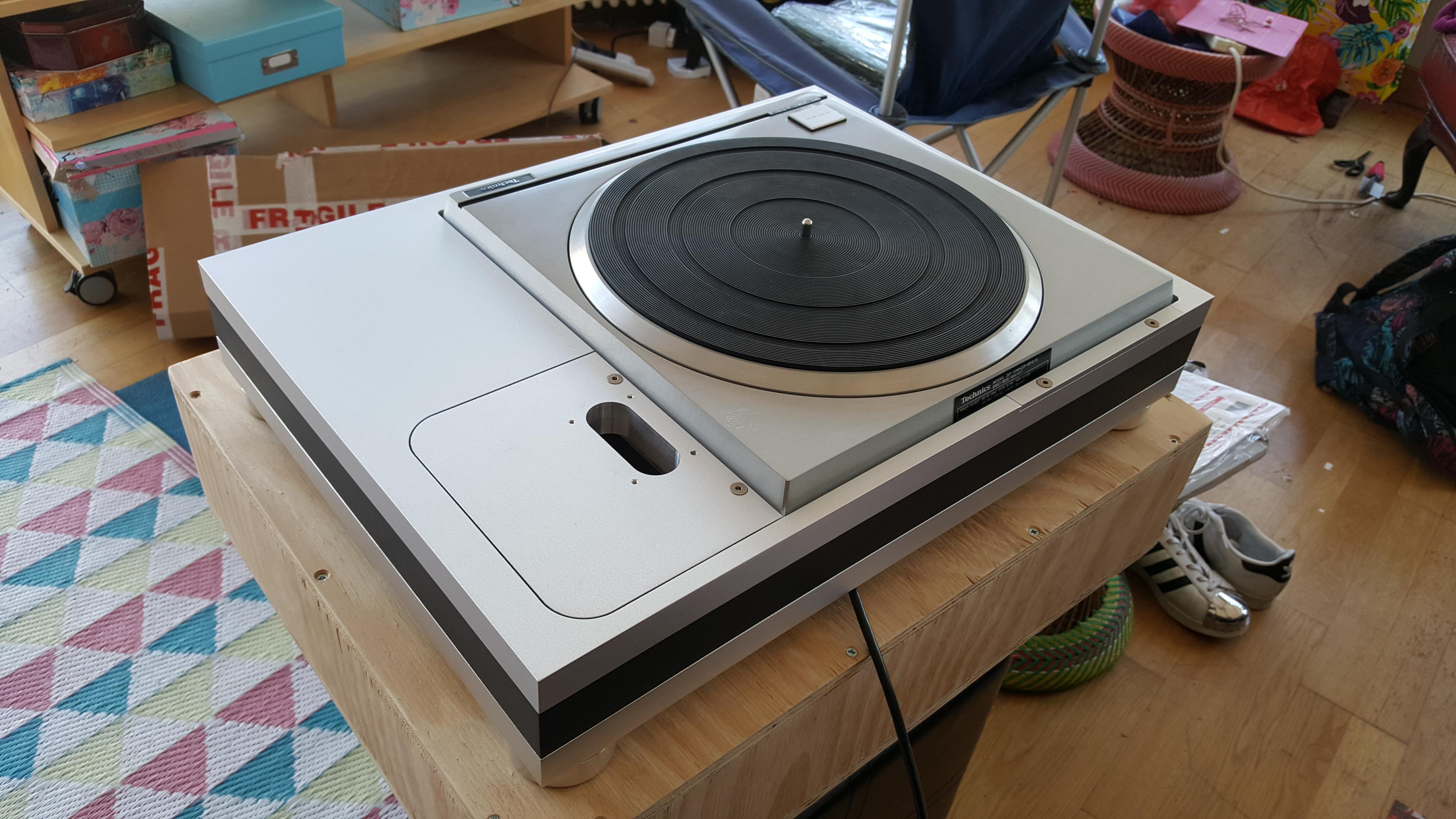

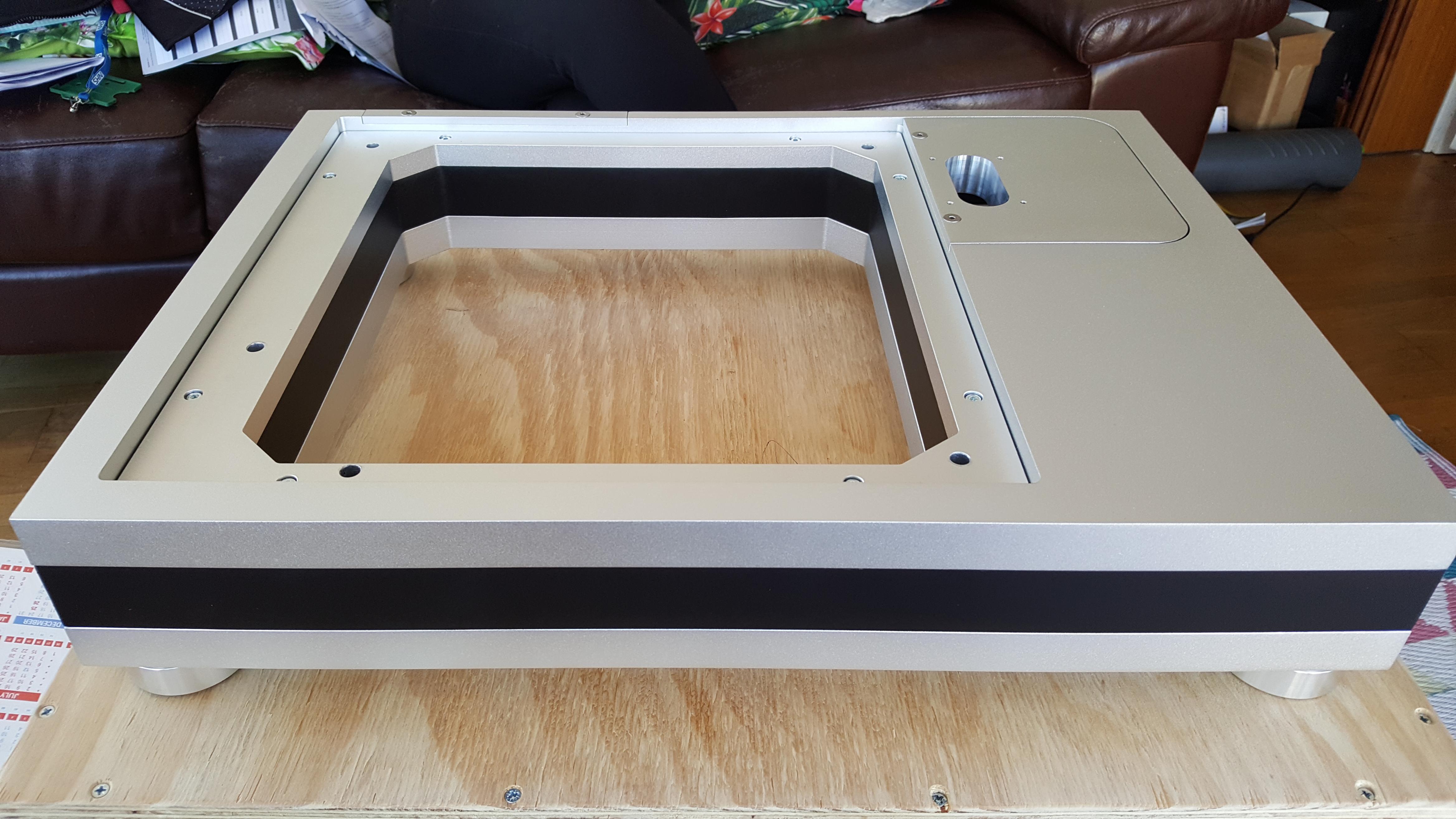

Plinth for the 10
I received a custom made plinth for the Sp-10 today, it makes the same sound as rapping ones knuckles on the armoured hull of a tank. Solid as.
Time to mount the SME V and have a listen.

I am now getting 4.8 something volts on the 5V line. Walking through the PS, all the voltages check out except for TR404, which is the transistor mounted to the sink. There is a replacement available, but I'm thinking of nixing these old boards and building a new PS. Thinking of going with Pete's board and shoving it into the existing PS chassis. I really would like to keep the same chassis, and even reuse the same transformer. I'll see if there is enough space tomorrow.

Aleks, super cool plinth. I like the aesthetics! If I ever get to the plinth, I would like to make something similar, and I would make the top of the SP-10 flush with the rest of the plinth, so that only the platter sticks out.
