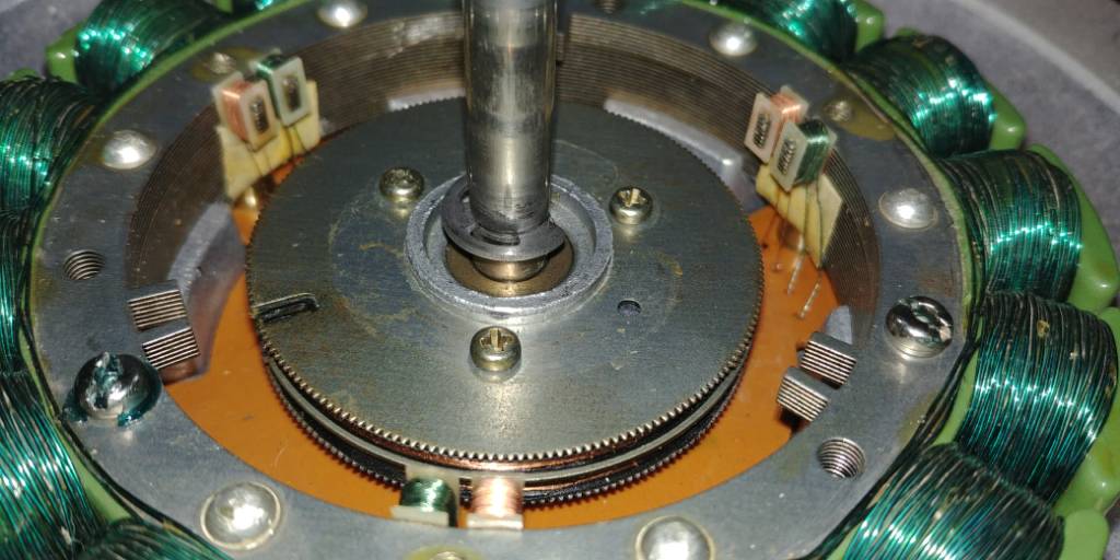

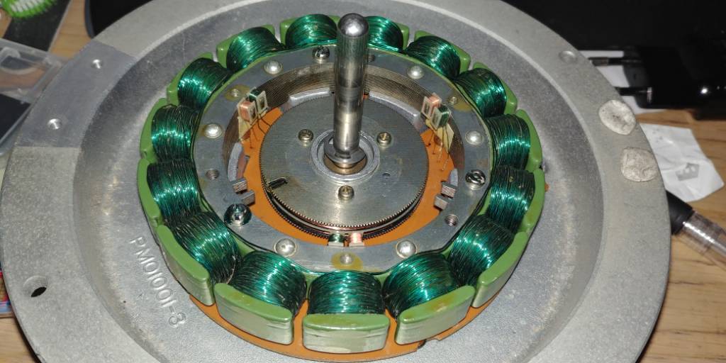

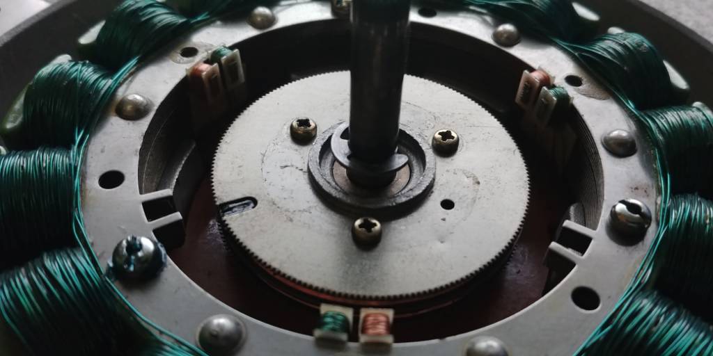

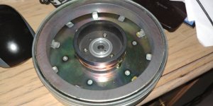

Now, here is the scoop: Shaft looks good and the bottom of the shaft also looks not too worn, just a tiny dimple in the center where it meets the ball bearing. When I drop it in, it traps air and during the period when it is dropping, it revolves really smoothly, but as soon as it drops all the way in, it starts rubbing. The coils look OK to me, and I can't figure out what it is rubbing against. Maybe the top hat rubs against the top of the bore. I suspect the ball has dropped far too low and that causes the rubbing. Curious to hear what others think.

I would have a very careful look for any 'witness marks' relating to the rubbing.

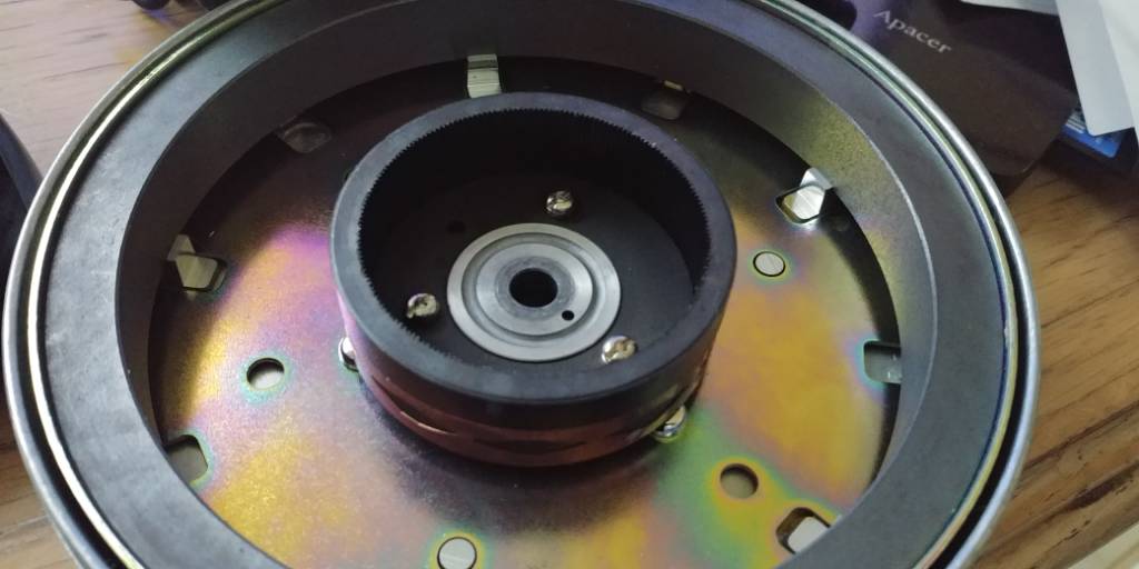

Just as an FYI (not to detract from ra7's woes): If you look carefully at the pics I posted, you will see some witness marks attesting to the fact that this motor had its bearing seized and in fact the bearing itself had been rotating inside the housing. You can see this on the platter just next to the spindle hole.
Thanks for the pics, Shaun! The coils on this motor and more golden in color, whereas yours appear to be more silver in color. Maybe that's just the enamel.
Looking for signs of rubbing, I see marks on the underside of the top of the motor, and some on the bottom face of the central ring with ribbed inside face (last picture in Shaun's post).
The only way the top rubs against the coils is if the shaft is falling far too deep into the bore, which would mean the ball bearing is slipping downward and is not snugly fitting into the bottom of the bore. Does that make sense? As I said before, until it falls all the way, it spins without problem.

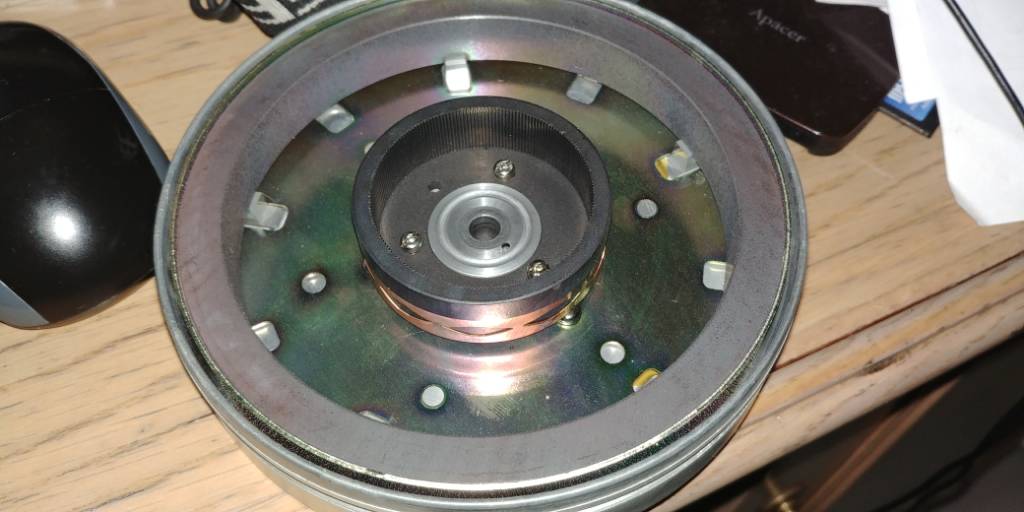

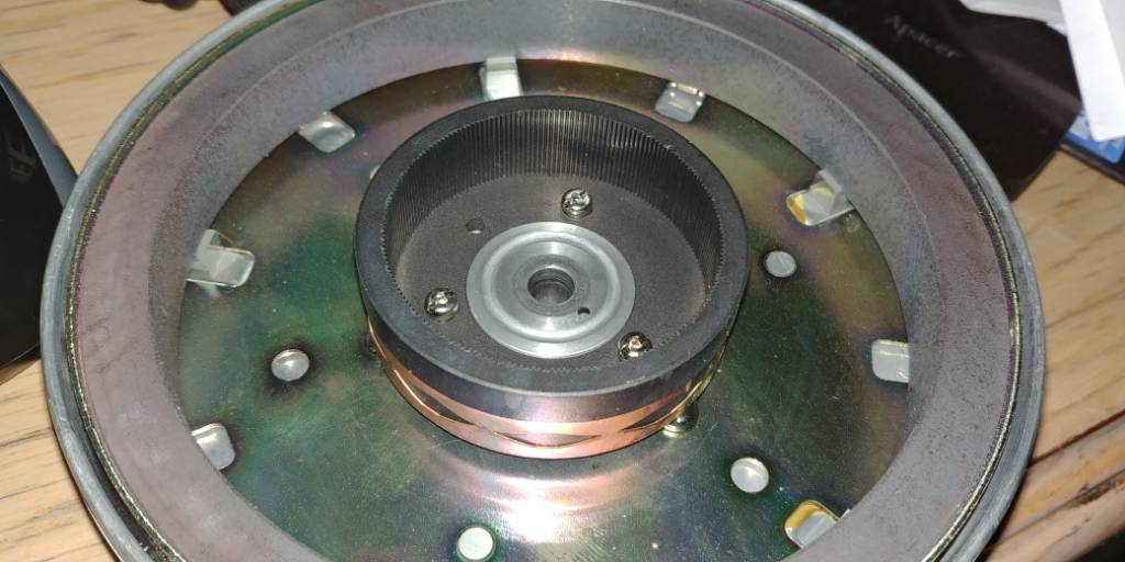

Another thing I noticed was the metal rim on the outside of the circular magnet on the platter was sticking out below the platter rim for about one-half of the circle. You can see this rim in Shaun's 2nd to last picture very clearly. It's the one outside the magnet but inside the platter rim. After I tightened the screws holding the magnet and rim, and pushed the rim down (only somewhat) where it was sticking out, the rubbing seems to have stopped. I did that last night and it wasn't rubbing this morning. But who knows, it may return. Any one else have that experience with the rim sticking out?
