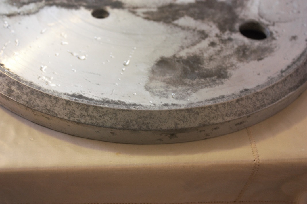

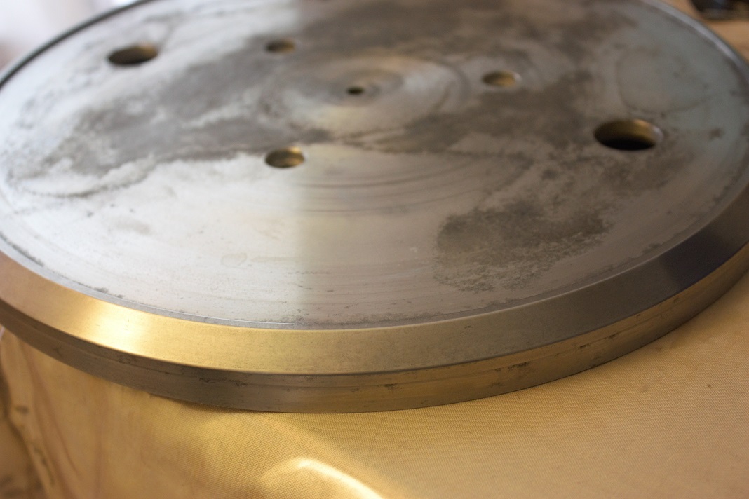

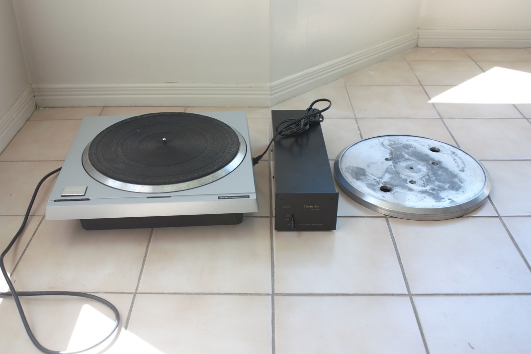

The journey begins...
For a while now I've been intrigued by the classic high torque direct
drive turntable. However, I had never considered putting together
an SP-10 table, believing it to be more complicated than I can
handle.
However, some encouraging words from Rayma ("It's much easier than building an amplifier, and it won't blow up on you")
and 6L6 ("Taking on an SP-10 project is not as difficult as it seems. All the pieces are available, just separately.")
led me to seriously consider this.
Then as luck would have it, I stumbled upon a 'local' SP-10 Mk2 for sale.
After some communication with Jim, I took a leap of faith.
The mat is quite worn and the platter has a fair bit of corrosion. The
seller threw in a spare platter which was in pretty rough shape. However,
after a bit of wet sanding, the edge is looking not too bad and actually
better than the 'good' one.
I think this is going to be a lot of fun.
Dennis
