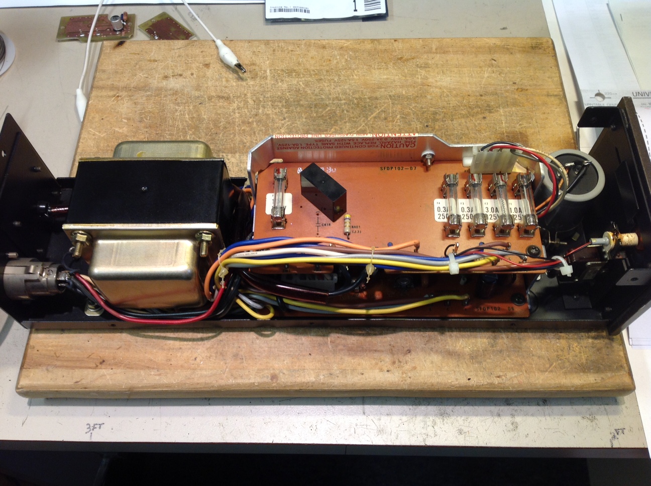

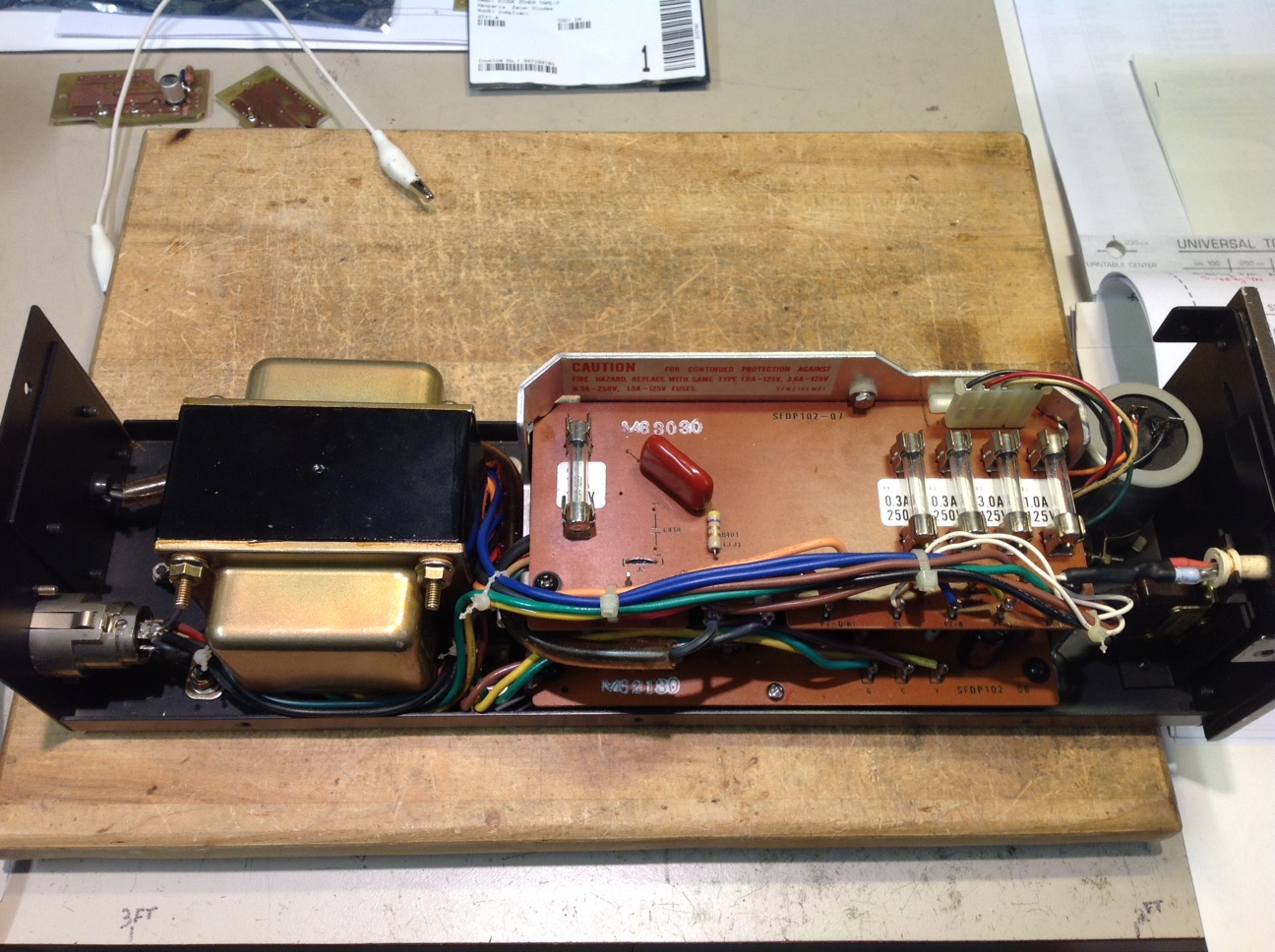

Received my to SP-10 last weeks. One set was ok, the other defective as I was expecting. First I repaired the defective power supply. Two bad caps were causing heavy noise (2V ripple!) on the 32.5V supply line, and one fuse was opened. Replaced both caps and the fuse and the supply was working, except from some little noisier supply compared to my good one. Also the power-on 6V lamp was burned, replaced it with a led. Both supplies are for the rest in perfect condition, with original transistors.
I decided to recap both power supplies. Now both are working just fine.

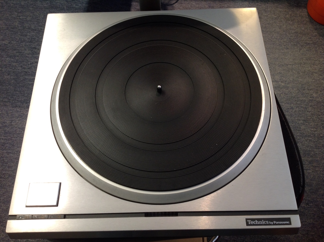

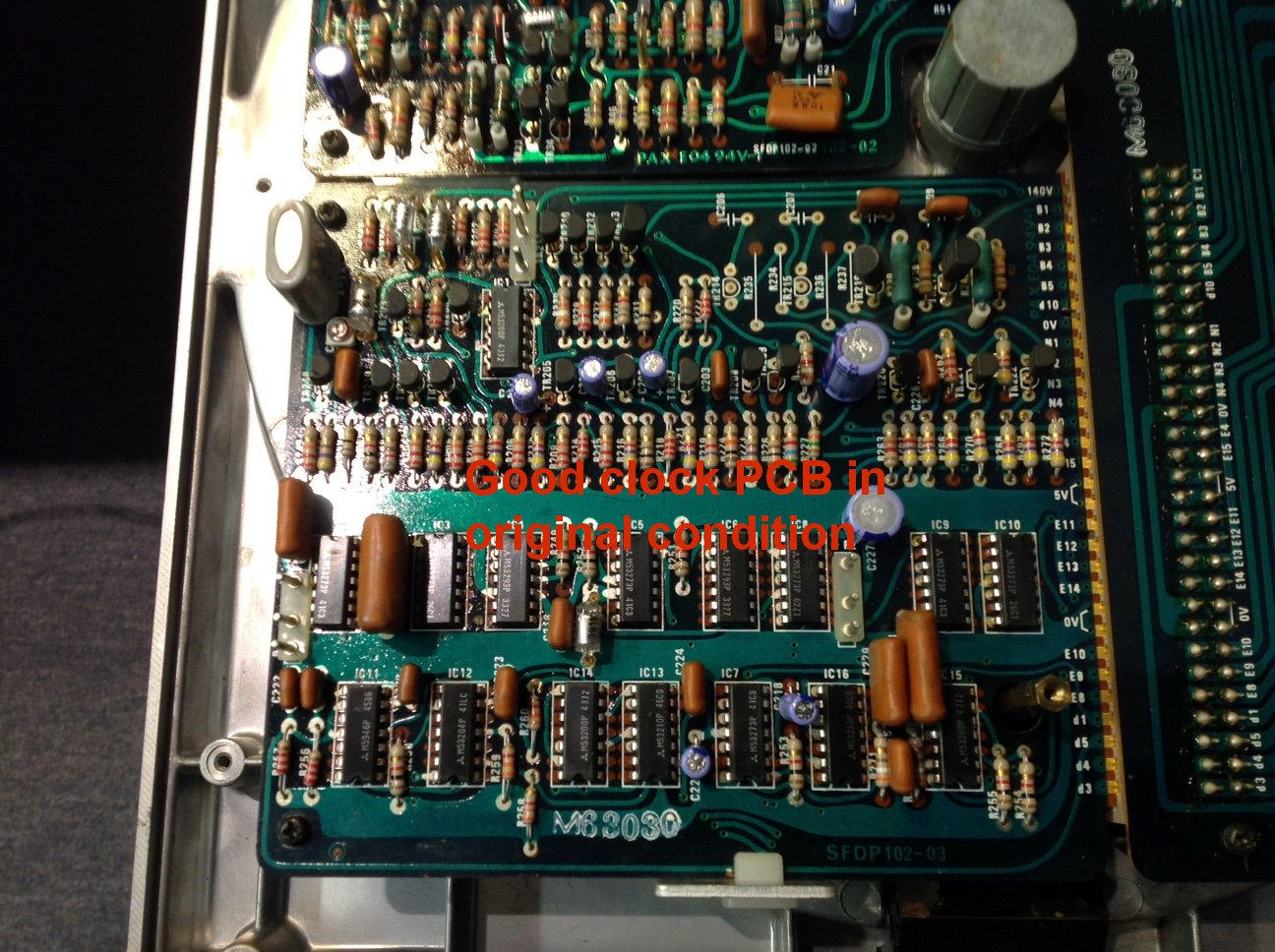

Now the SP-10 itself. All in all both are pretty good physical condition, see example of the good, working one. The perfect one has a burned strobe neon lamp, no problem, I just ordered an original replacement from UK.

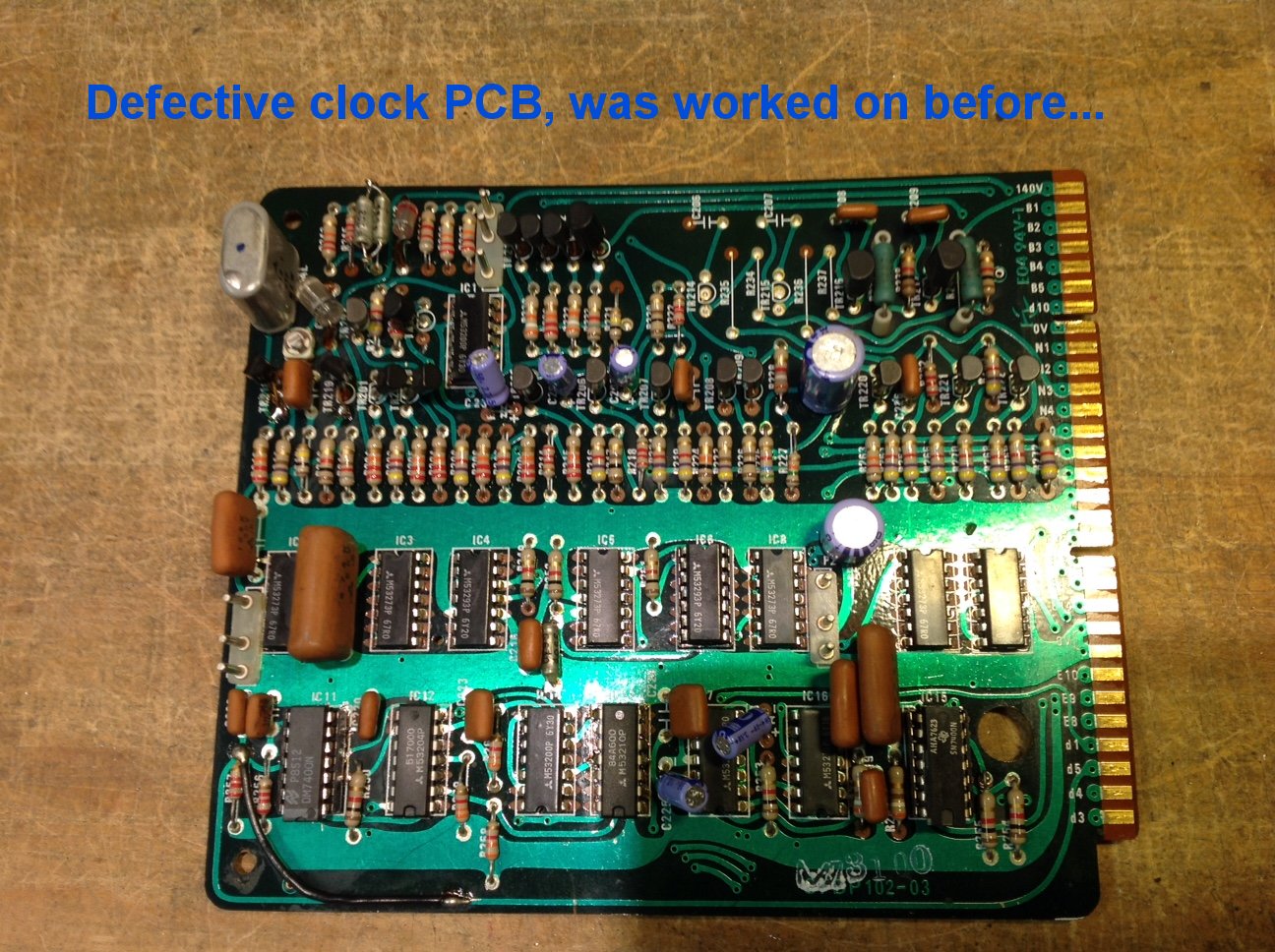

I found the problem of the defective one, if not the solution yet. It is the clock pcb, see picture. It has been repaired, mods previously, and there was damage to the pcb. The first problem is the 3.58Mhz reference oscillator is producing only 1Vp-p instead of the normal 4Vp-p (measured at P1 test point), so the rest of the clock/divider circuit is all stalled, and the two transistors that pulse normally the 140V for the strobe neon lamp are stuck always ON, which apply an heavy load on the 140V supply, that drops at 100V, and their two power resistors overheat, not good...
I tried the good clock pcb from the good turntable into the defective one, and voilà! the turntable was working normally. So it is this board. Good thing to know is that it is not the motor or the drive transistors that are defective. Good...
First I need to have this oscillator up and running. I'll work on the board outside the table using my bench power supply, with only the 5V. I can already see that both oscillator transistors TR201 & TR202 were replaced by unknown type before. That's a start...
Stay tuned😉

Test digital board using only my lab 5V power supply and found that IC2 is defective, very hot and draining the supply. Removed it, installed an IC socket, and ordered the parts on ebay from the US.
Using other transistors from the board (used for switching duties only), I replaced TR218 & TR219 (3.58Mhz osc) with the correct 2SC828A transistors, and clock is now of the correct amplitude at P1 test point. Ordered the correct transistors.
Waiting for the parts to continue...

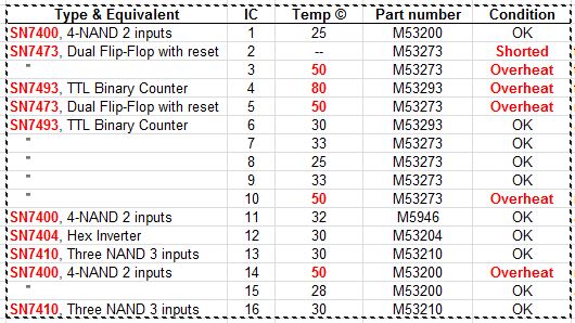

I continue my test of the Digital PCB. First thing I saw after removing the defective IC2 is that the defective PCB 5V current consumption was much higher than the good pcb, 670ma compare to 270ma. I suspect that this table was connected to a defective supply in its past life, and since the 5V regulator is supplied by 12V, a short pass transistor will certainly send higher voltage than 5V to the digital circuit pcb...
I measured all IC temperature and found some really too hot to be in good condition, or soon to fail. I compare to the good PCB and all PCB are within 28-30C, so anything higher than these value is suspect.
I also realized that these M53 chips are in fact TTL chips, so easy to get by. Here the table of my measurements, and TTL part no equivalent. We can see that IC3, 4, 5 10 and 14 are overheating and need to be replaced.
BTW these PCB are very fragile and I delat with this kind of board in my career. By experience the only way to safely removed the defective IC from the board it to first cut all the IC pin legs with a sharp cutter, then to remove gently each pins from the board using a small tip soldering iron. Then you remove the solder from the pads, and install a good quality IC socket. That insure no damage to the board and easy maintenante afterward.
I'll start installing IC sockets shortly.

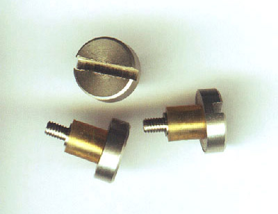

Did you know that the platter screws have a small silicone rubber sleeve over them (see picture), so they fit nicely into the platter holes, I didn't. The bronze color on the screws is not bronze, it is the rubber sleeve...
Found out that I'm missing a few. I measured them to be O.D. 7mm & I.D.5mm. Ordered 1m of silicone rubber tubing from China for a few dollards.

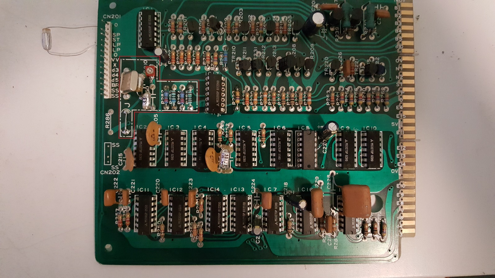

I recently got an Ex BBC Rp2/9 P version of the Sp10.
All I got was the motor unit. It was missing the power supply and control unit. Also none of switches were wired up save the speed indication LEDs. Also the switches are missing.
I managed to source an original PSU fairly cheaply as it was defunct. I recapped this and replaced the diodes. Most of the caps were leaking fluid and some were open circuit. That now works fine.

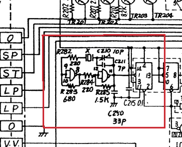

My logic board had no onboard clock source or stop start logic. I've got round this with minimum changes or modifications.
Adding the quartz timing source was simple, all I had to do was fill in the missing components on the logic board and put the redundant half of IC17 into service. See photo I've outlined the area added with a red marker. Also I've marked the circuit diagram up.
This modification is tested and works fine. I can select all three speeds but need to do the VR1 and VR2 cals next as 78rpm is a bit roapy and I can see they are off on my scope.
