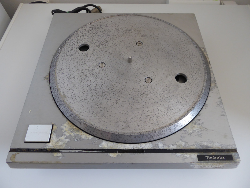

The break belt player is a mild disaster, cosmetically. It looked like it was painted by my dog, blindfolded. My dog is talented, but painting is not her strength. Eating my shoes on the other hand... Here she is, after eating my shoes. No sign of remorse.
And here's a close up of the paint job
After serveral days of soaking in the most eco friendly and ineffective paint remover I could find, I understand why it was painted in the first place.
The oxidation of the aluminum is, as you can see, quite bad. I would like to keep the original finish, but I'm not sure I'll be able to find someone who can replicate the original finish way up north in Norway. Should I just get it powder coated and call it a day, or is there an ultimate trick on how to restore the turntable to its former glory?
Very bad...
you should brush it by hand to bring it back to the origin because the finishing you see in the photo and disappeared, after brushed you need the final finish with the transparent matte varnish as in origin.

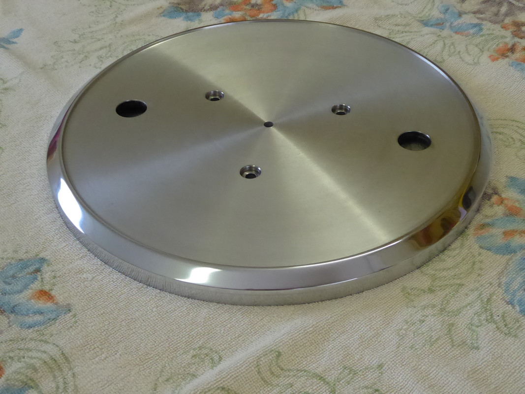

In these days of covid19 having to stay necessarily at home I have also started 2 projects of SP10 II that I want to get the finishing as originally if it where possible.
I would like to get a silver anodization like the new SP 10R but the frame is not pure aluminum but I deduce that it is a composition of several metals called "zamak" and the zamak does not anodize would become all black spots.
the platter I have already refurbished these days
