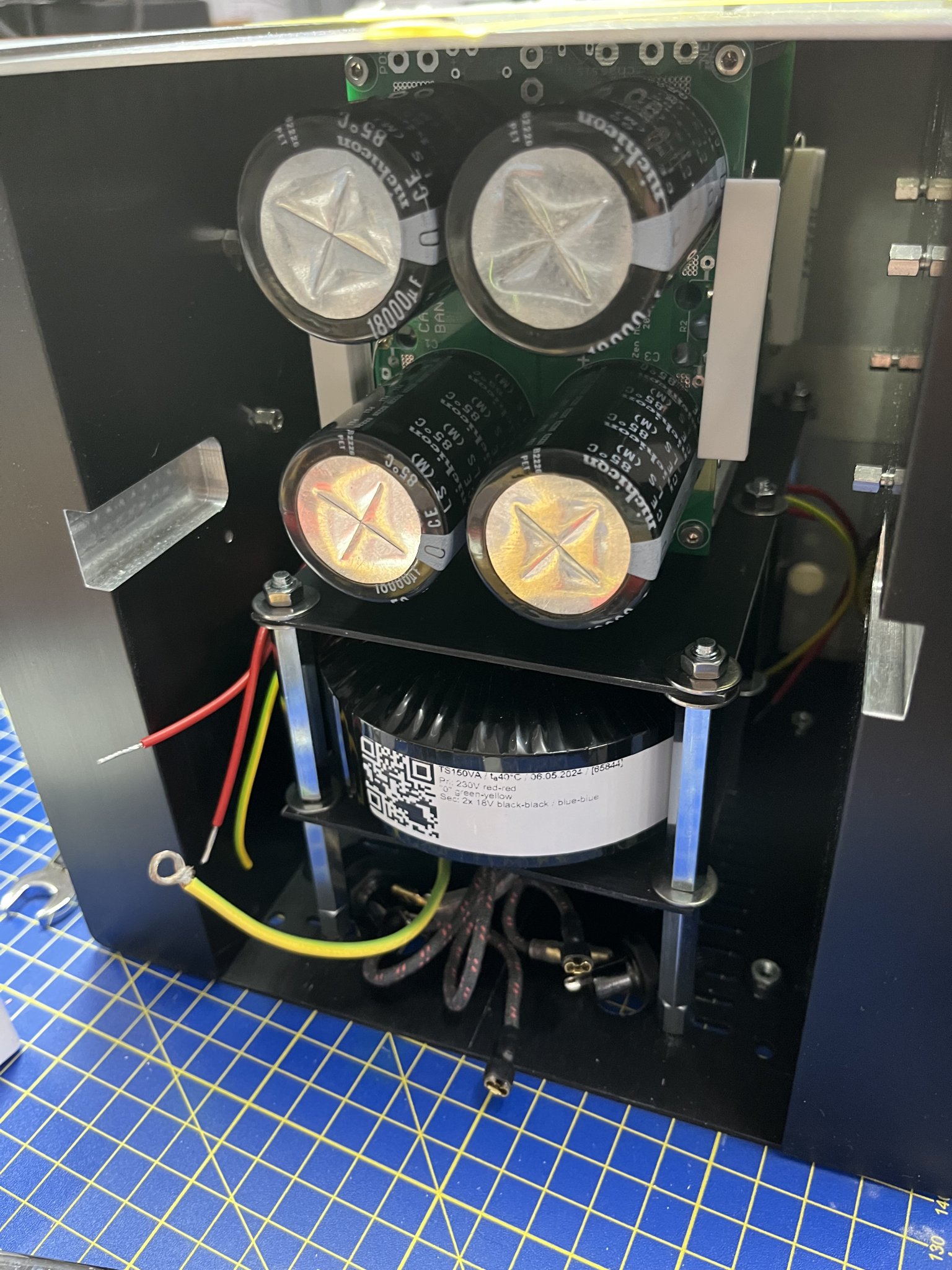

Either mount the toroids vertically at the front, side by side if space allows, or both along the middle axis (one behind the other), place capbanks left/right accordingly, if it doesn’t fit, place them vertically? (Capbank-width < chassis-height?)
For a balanced configuration, each phase sees 1/2 the speaker load and has 1/2 the voltage swing requirement. The current drive requirement remains the same. Thus in order to reduce the heatsink power dissipation you must lower the rail voltages according to your output power goals. For example, a balanced configuration capable of 25W into 8R requires a minimum of +/-10V rails and a bias current of 1.25A (or less for the Holy Grail because of the undegenerated OS).
@myleftear - Interesting... I've never considered mounting the cap banks vertically. Yes, they are < chassis height. I'll take a look and see how that might lay out. Thanks for the idea!

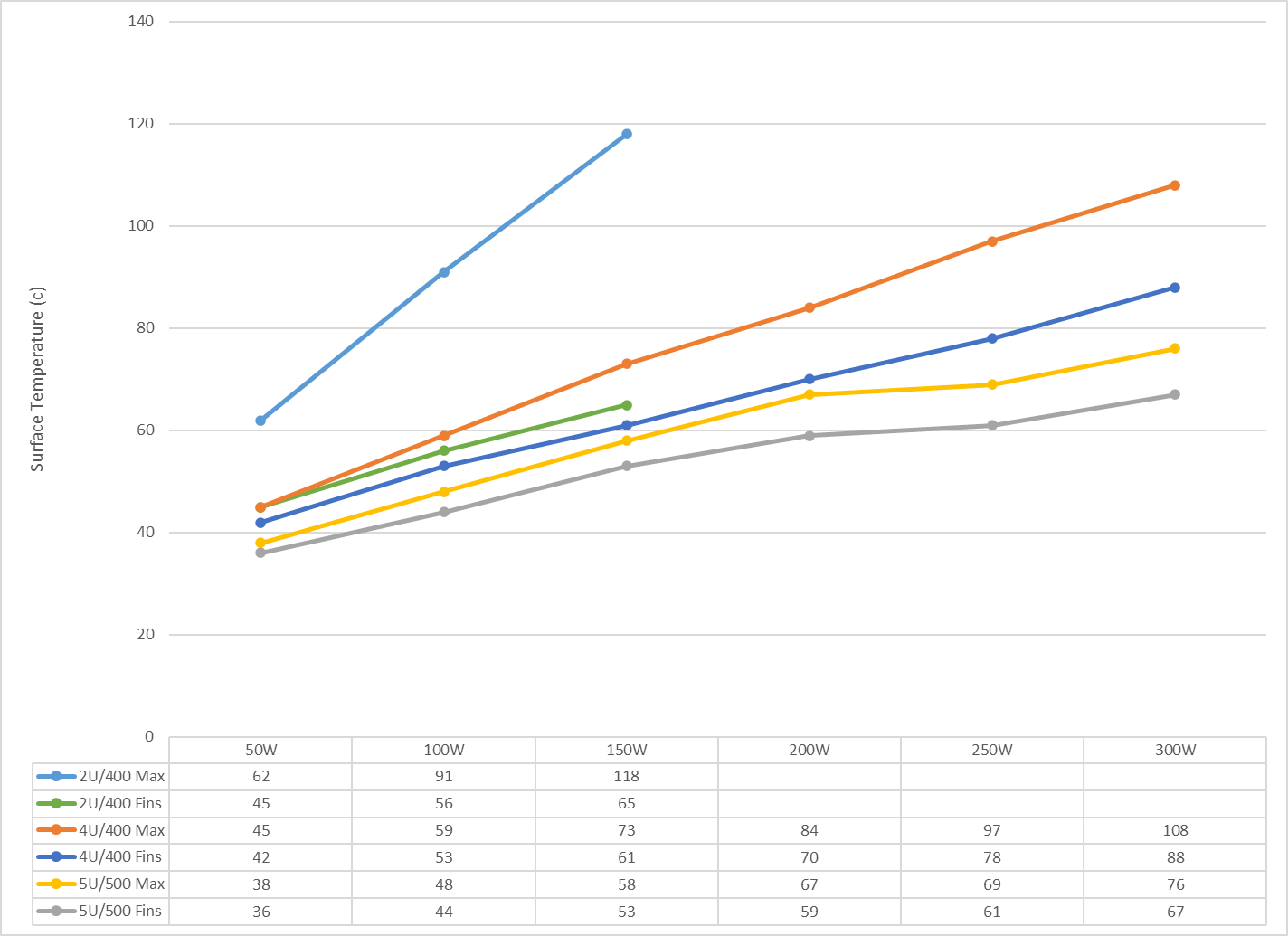

The standard is roughly 60W dissipation per board. 120W on these sinks may be pushing it.
I've run 100W per side on these sinks before with no issues with heat. So... keeping the transformers the same, and not going to any measures to lower the rails, I can adjust the bias current to control the heat.

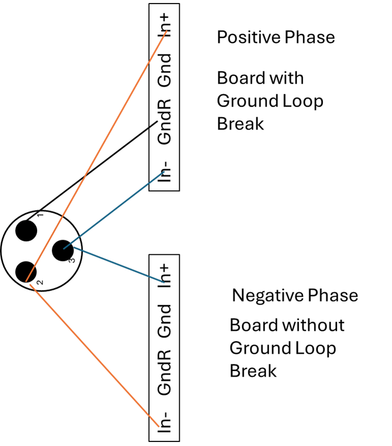

@lhquam - Hi Lynn - I hate to bug you with trivial questions, but my earlier question may have gotten lost in the wall of text. What resistor changes are required? I'm referencing below from post #662 (emphasis added is mine).
Is this proper for wiring? Same for both left and right channels with regard to the ground break?
Once again, I appreciate all the help. I should probably just wire it up and learn, but the entire concept of the ground break on one board has me admittedly baffled, and the chassis portion of this one... has me wanting desperately to get it done properly the first time and leave it alone.
With my thanks!
Edited to remove the photo with the incorrect RCA wiring. I don't intend to use RCA. Grabbed the wrong file, and the wiring was wrong.
The wiring seems intuitive and straight forward. Where I once again need some assistance is with the ground loop breaking amplifier channel(s).With only a few minor resistor and wiring changes
With my thanks!
I have operated the ZD25-Mini with rail voltages between 22V and 29V without resistor changes, other than ones outlined in the Build Guide that "tune" the bias circuit.What resistor changes are required?
^ Wonderful!!!! Thank you. I am almost ready to fire up the additional channels for music testing. Then I can wire them in the balanced configuration.

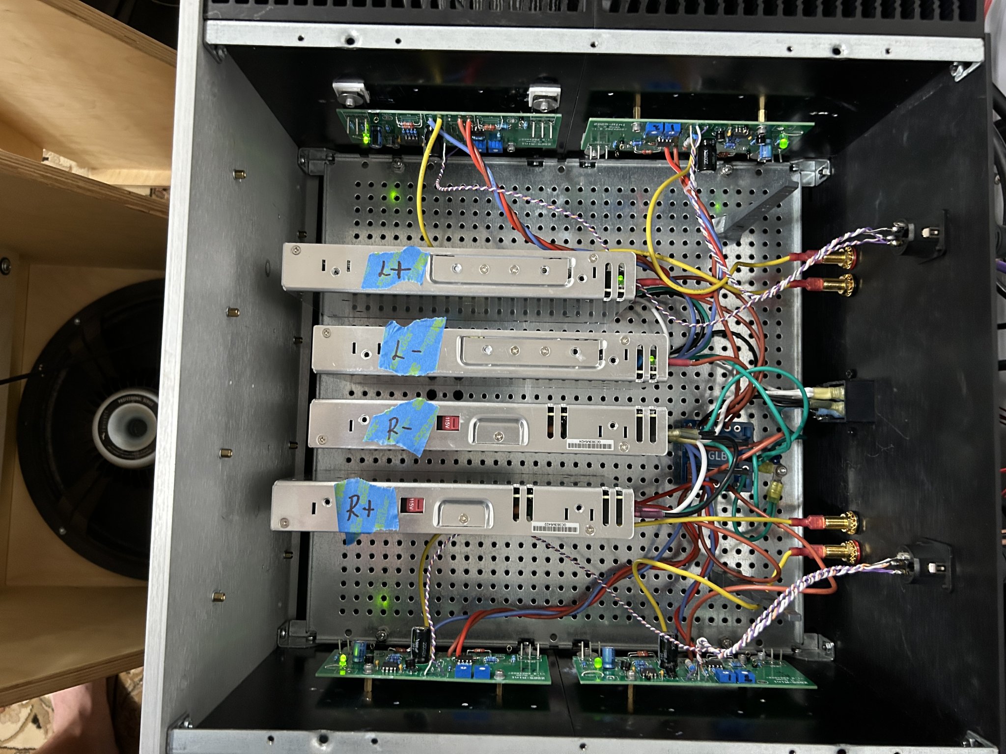

Early success!
PSUs came yesterday. I selectively omitted from my brain that they only count 'business days' for delivery. So, I didn't get a chance to work on it over the weekend.
Initial / crude settings:
~20V8 rails (as low as the PSUs would go)
0V130 across sense resistors => 1A2 Iq
Max offset 'within' board - 1.2mV
Max 'overall offset' at speaker terminals between boards - 2.8mV
Dissipation per side ~ 100W (50 per sink). Based on temps, I'll see where I want to move voltage and/or bias current.
Ignore the spectacular display of wire management... Oddly enough... it's dead quiet though.
I'll get the final settings tweaked and tidy up wiring. Then... it should be in the system for a long time.
I'll attempt some measurements toward the weekend maybe.

Max ~50C on the hottest place on the sinks between the fins and ~40C on the tips of the sinks. Measured with the el-cheapo K-type probes that come with just about every DMM. Also agrees with the fact that they are quite warm, but not "HOT". I could hold onto them all day.
22-23C ambient => 27-28C rise over ambient.
I estimate 0.30C per Watt for my Modushop 5U/400 as a conservative starting point for the hottest point and about 0.20C / W for the fins. I'm usually a tad under that, but I like to err on the side of caution.
I base most of my estimates on a really rough regression I did based on heatsink dimensions and the study that Modushop published on a few of their chassis. I've got a spreadsheet, and I just input the different dimensions ... and it gets me in the right neighborhood. A more simple way (that also works well) is to just know that it will fall somewhere between the published information from the 4U/400 and 5U/500. My chart is below. I pulled the data visually from the study published by Modushop. Their ambient was a touch higher than my typical if I recall... so... YMMV. I'm typically off by a few degrees.
