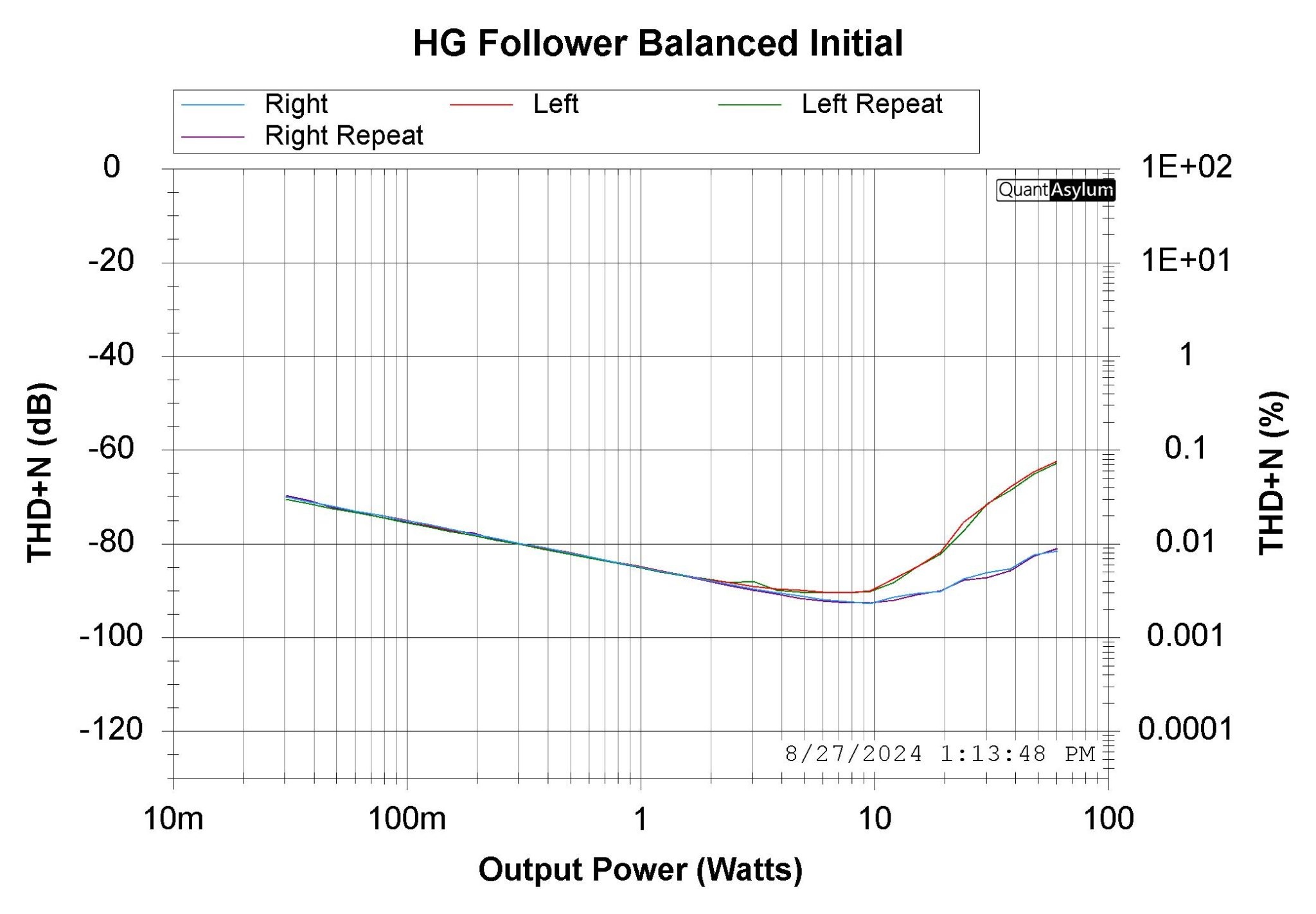

f you compare your measurement results from the balanced and the original configuration with a linear PSU (post #400), you'll notice that in the power range up to 1 W there are no improved THD values. The most performance advantage seems to be in the high power range from 1 W upwards.
Why is that the case, even though the even harmonics cancelation?
I can only take a bit of a guess here. Graphs attached for others below. I am trying to remember to standardize my scaling for easier comparisons, but... I'm not quite there yet with "automated scripts". So, that is my fault. If we compare the output at (for example) 1W into 8R for both, they are relatively close at -85dB. I did not take the SE version down to very low output ranges b/c it was more for performance than for diagnostics. The SE version remains relatively flat throughout the entire output range, while the Balanced version has a decline. My guess is that the decline is due to the 2nd cancellation. We can also see that in the FFTs. I'll post some balanced FFTs when I get the one board properly diagnosed and fixed. Those higher % / dB THD+N could be from noise too. The noise is a very high contributor at those low levels due to my unfinished wiring. We will see, but that's my guess for now.

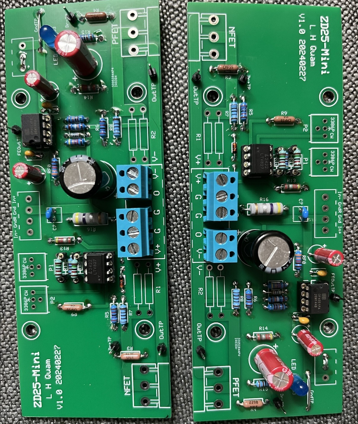

I did some very crude checks. Even though I goofed up a board with bad measurement technique (and worse yet, I know better / it's in my procedure how to do it properly)... it's a good learning. At least I was smart enough to not hook it up to speakers until I completely verify that it's fixed and working properly.
See below:
Voltage across sense resistors (bias current indicator) - 122.5mV
DC offset of sole board (from GND to out of individual board) - 4V1 😱 Previously was below 2mV if I recall. Can't lower to below 3V2 with pot. Clearly one MOSFET isn't "pulling its weight".
For PFET:
GD - 15V6
GS - 4V1
DS - 19V7
For NFET:
GD - 17V4
GS - 4V2
DS - 21V6
It may be clearly obvious to someone that knows ... but I wish I knew exactly what this indicated. Is it wise to put a scope across GND to the source of each output MOSFET to see which one (or both) may be acting up, or is the issue abundantly clear to someone that understands this better than I?
Suggested next steps are appreciated with my gratitude in advance. Blindly replacing parts isn't my idea of how to learn.

For PFET:
GD - 15V6
GS - 4V1
DS - 19V7
For NFET:
GD - 17V4
GS - 4V2
DS - 21V6
Again, I know this isn't a thread to teach Patrick the basics, but ... all help is appreciated.
When in doubt, I look at the schematic and compare to a known-working-good board.
For a known good board -
For PFET
GD - 16V6
GS - 4V1
DS - 20V7
For NFET:
GD - 16V2
GS - 4V3
DS - 20V5
The good board and the bad board share the same PSU / same rails.
Edited for clarity - These two boards are on the same channel. The "bad" board is set up for positive phase amplification, and the "good" board is set up for negative / inverted phase amplification.
Try swapping the FETs between boards. (Easy is the FETs are socketed, but harder if soldered).
I like that approach... I was going to do it, and I'm willing to do it, but it's going to tell me one of two things...
1) Issue is MOSFETs (problem moves with MOSFETs).
2) Issue is something else (problem stays with board).
If it's #2... further diagnosis will be in order.
I was hoping to narrow it down before taking two boards out of commission. (They're not socketed, but I'm handy with a de-soldering gun).
Off to the bench.
Ad. 2) Check the offset at FEOut
Will do.
Suspect board has already been removed from chassis / PSU. Removed MOSFETs from board. Checked with the El-cheapo Mega tester along with a quick resistance check against known good MOSFETs. They seem to be in range with no obvious damage.
I'll install them on the other known-good board. If problem follows the MOSFETs, then I'll replace the MOSFETs.
If problem doesn't follow the MOSFETs, then next step will be to check above on the "bad" board. I'll install the board on a test bed with PSU / heatsinks and do further checks.
Have to pause for the day, but I'll be back at it tomorrow.
Thanks to you, Lynn, and to all the others that offer their expert advice. I'll get it back up and running properly. It's become a challenge now...plus it sounded mighty fine before I messed it up.

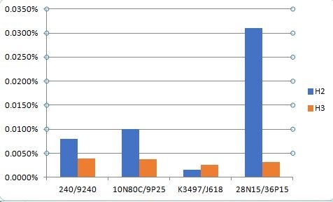

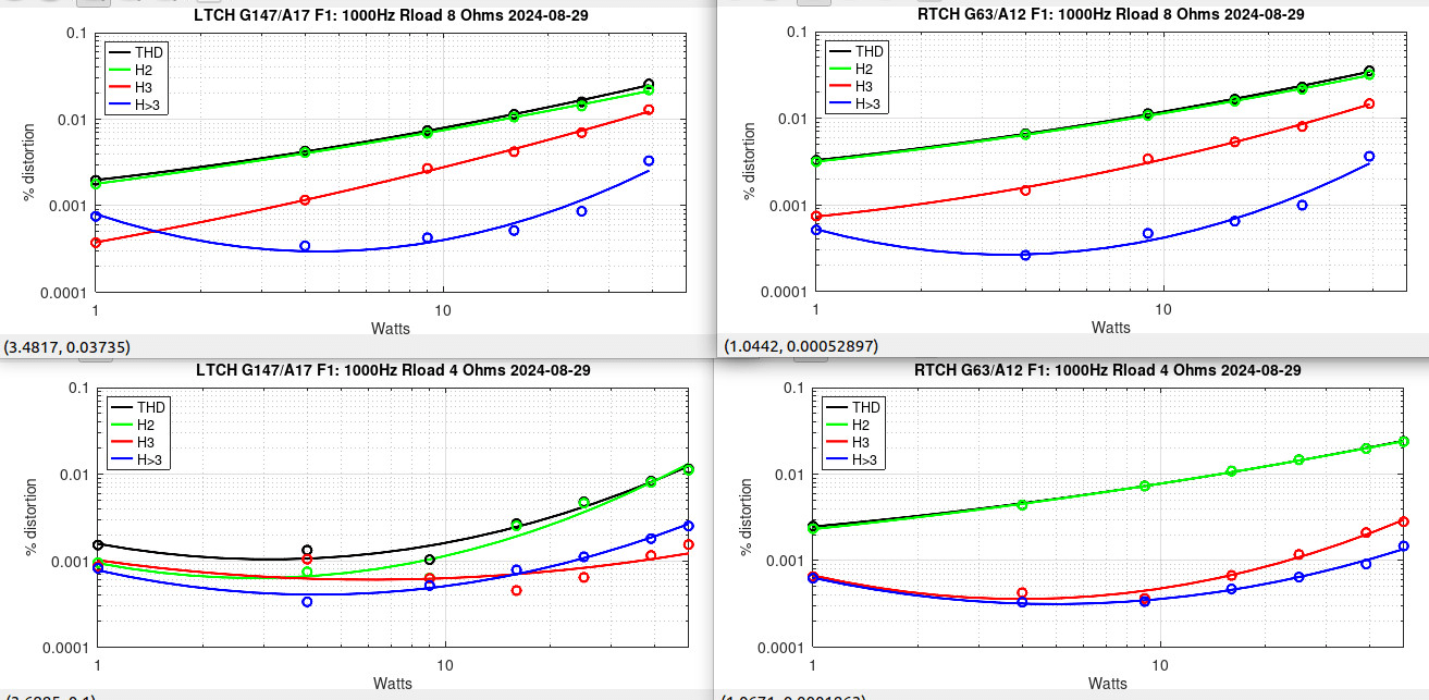

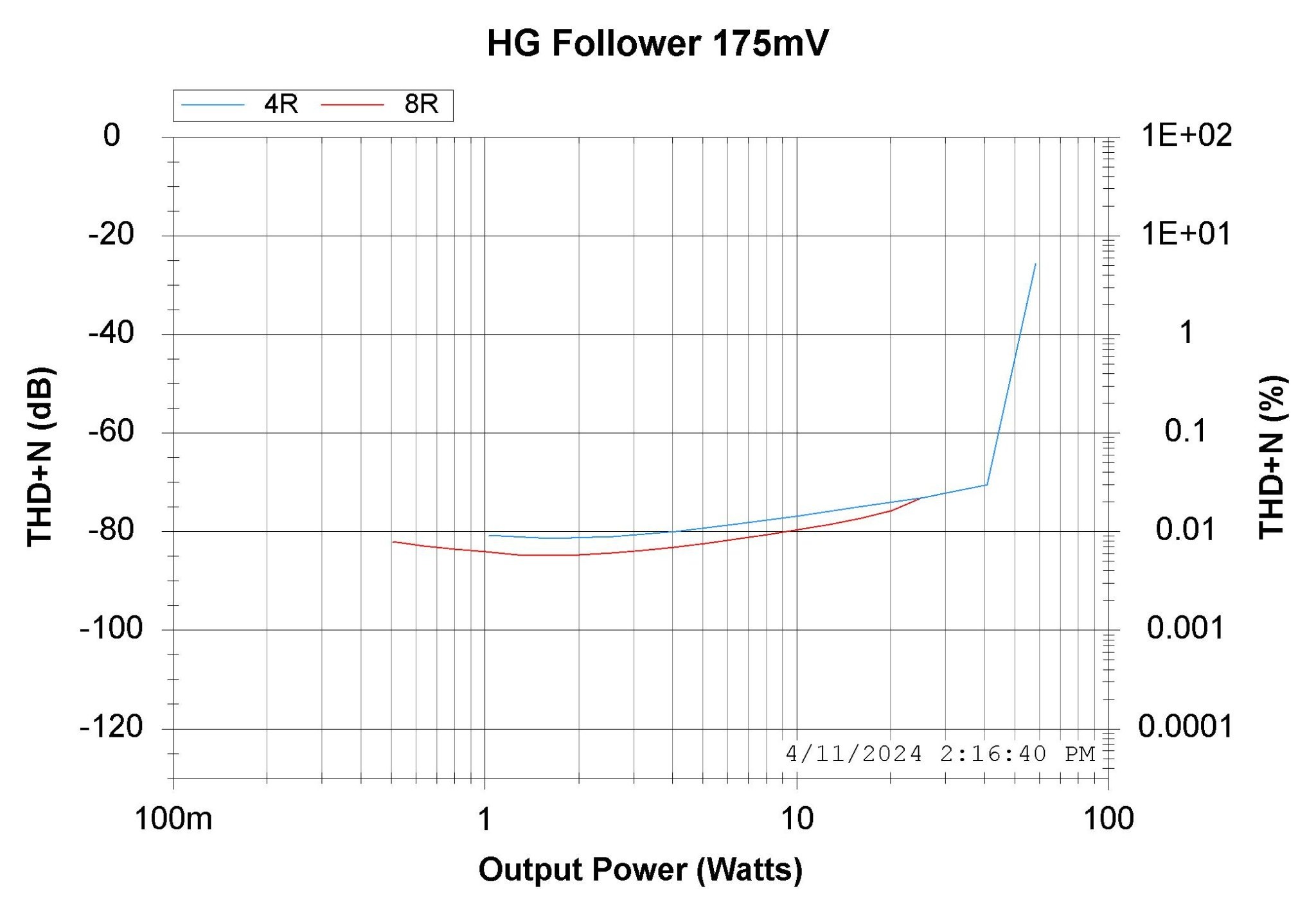

I ran some new spectral measurements using FQA28N15 paired with IXTQ36P15P FETs. Both of these FETs are currently available at Mouser.com (1000s available). The HGF was configured at 28V rails, 1.3A bias, 12dB global feedback.
The IXTQ36P15P appears to nearly identical to the FQA36P15 which is not available.
Here are some distortion vs. watts sweeps for the left and right channels for 8R and 4R loads:

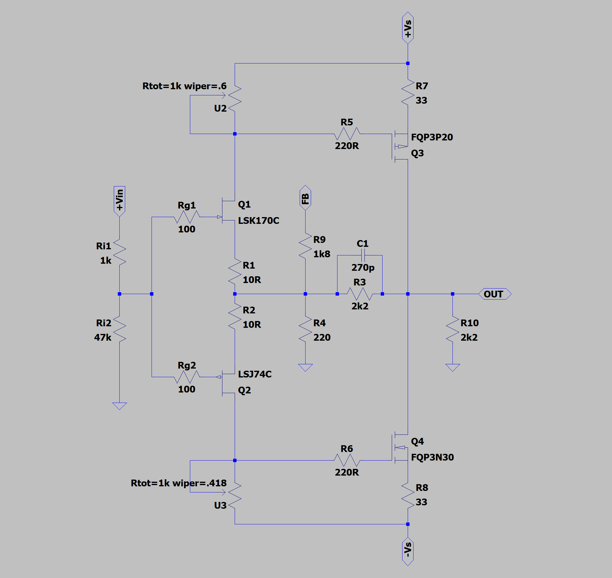

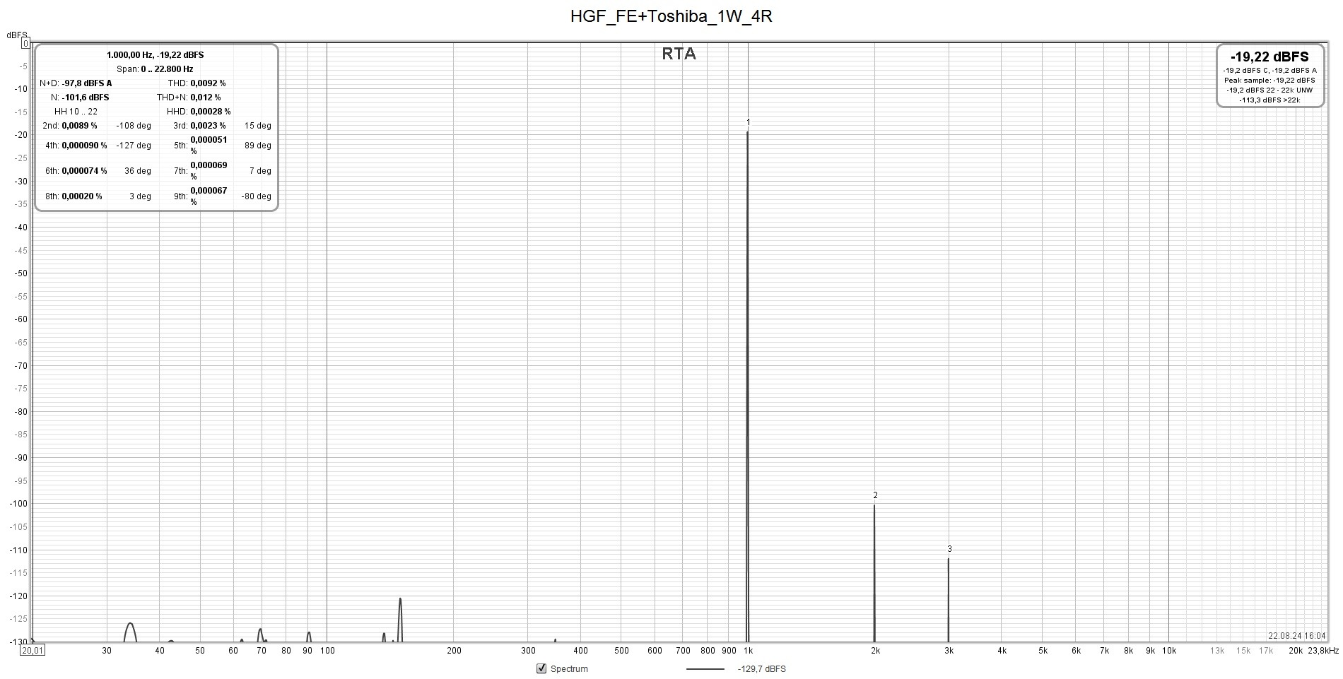

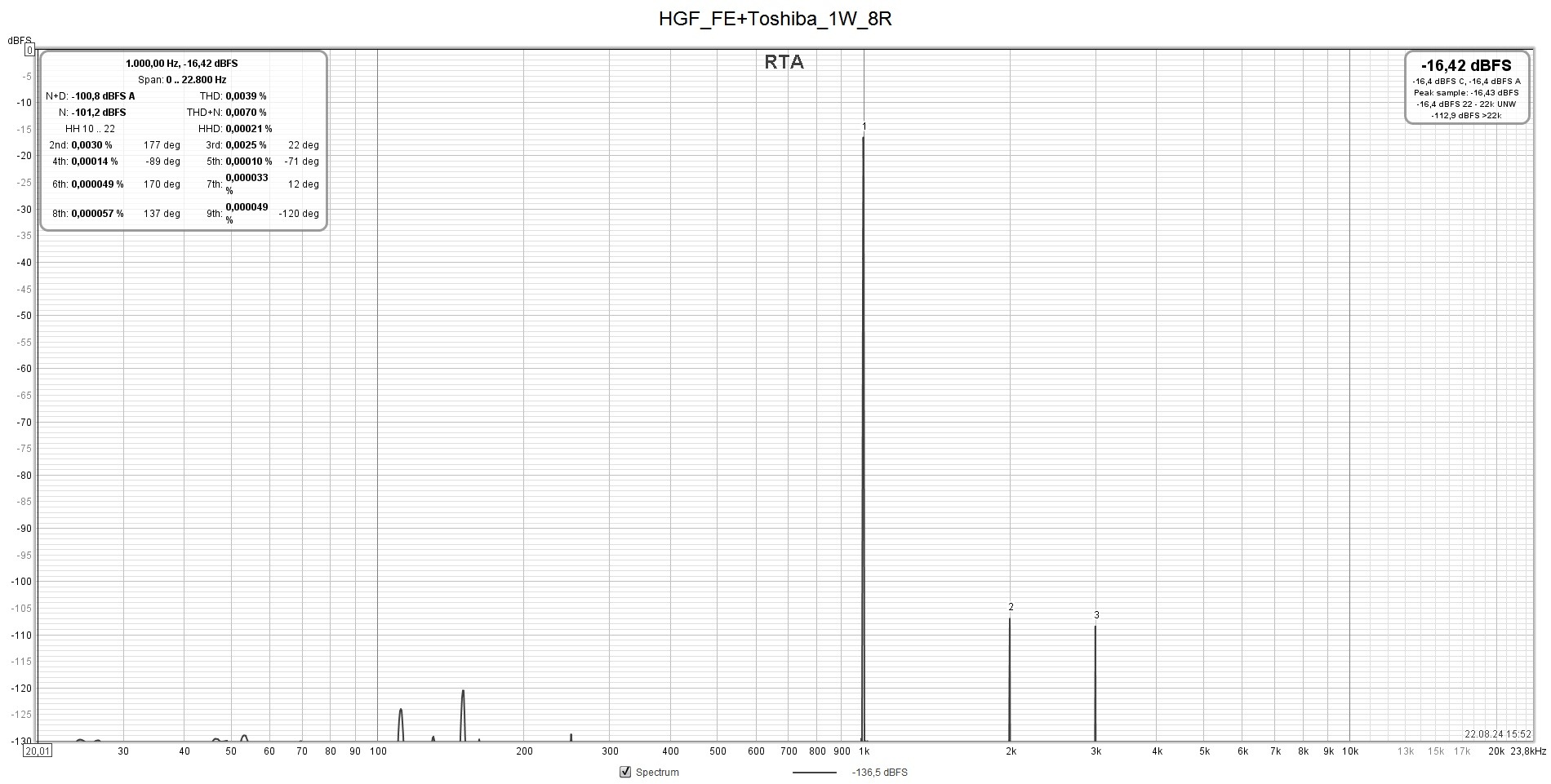

When I had my new FE on the workbench, I immediately had the opportunity to test the Toshiba power MOSFETs 2SK3497/2SJ618, which were actually intended for the M2OPS. So far there has been no answer as to how they will behave in HGF.
Fortunately, I was able to determine that the bias remains very stable. Adjusting went without any problems. The bias circuit resistors were the same as with Fairchild parts.
It is very interesting that with this FE and an NFB of only 25 dB the DF is at 350. Looks promising...
