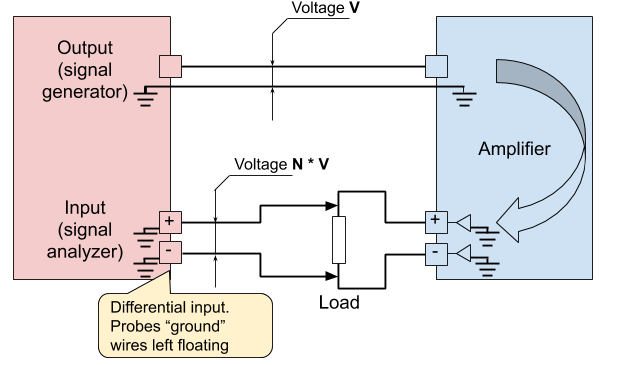

I took some time this morning to attempt measurements. Complete SNAFU.
Quick summary... DODO move on my part. Used the wrong measurement jig / technique.
Longer version - I have my own measurement "jigs" for my QA. I used the wrong wiring harness. I used the 'non-bridged' / 'standard' harness. So... after the experienced readers have cleaned their screens, I'll explain what I've done and potential consequences, so that those less experienced may not suffer the same gut punch. I've read similar before, and it doesn't necessarily need repeating, but if it saves even one person from smoking an amp or even some inconvenience, it'll be worth it.

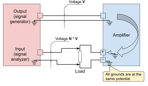

For standard (non-bridged) amplifiers one side of the speaker / load is at ground potential as reference / return and the other is generally considered the "output".
So, a simple diagram may be something like this.
For balanced / bridged amplifiers, both outputs 'float' and are at equal and opposite potential with no ground reference / return. A diagram may look something like this.
All graphics shamelessly borrowed from the link below... which conveniently is also in my own QA measurement procedure notes... which I did not review b/c I am a total dodo, and thought "I know what I'm doing".
https://melp242.blogspot.com/2019/05/measuring-bridged-and-balanced.html
What I have yet to understand is why using my standard harness caused what I can only assume is oscillation. When I turned on the signal, I immediately smelled something "hot" and I could actually hear a ringing / tone. Fortunately I shut the amp down immediately.
I'll further assess any damage tomorrow. For the moment... I shouldn't be allowed anywhere near electronics. I hope all that's damaged is my ego.

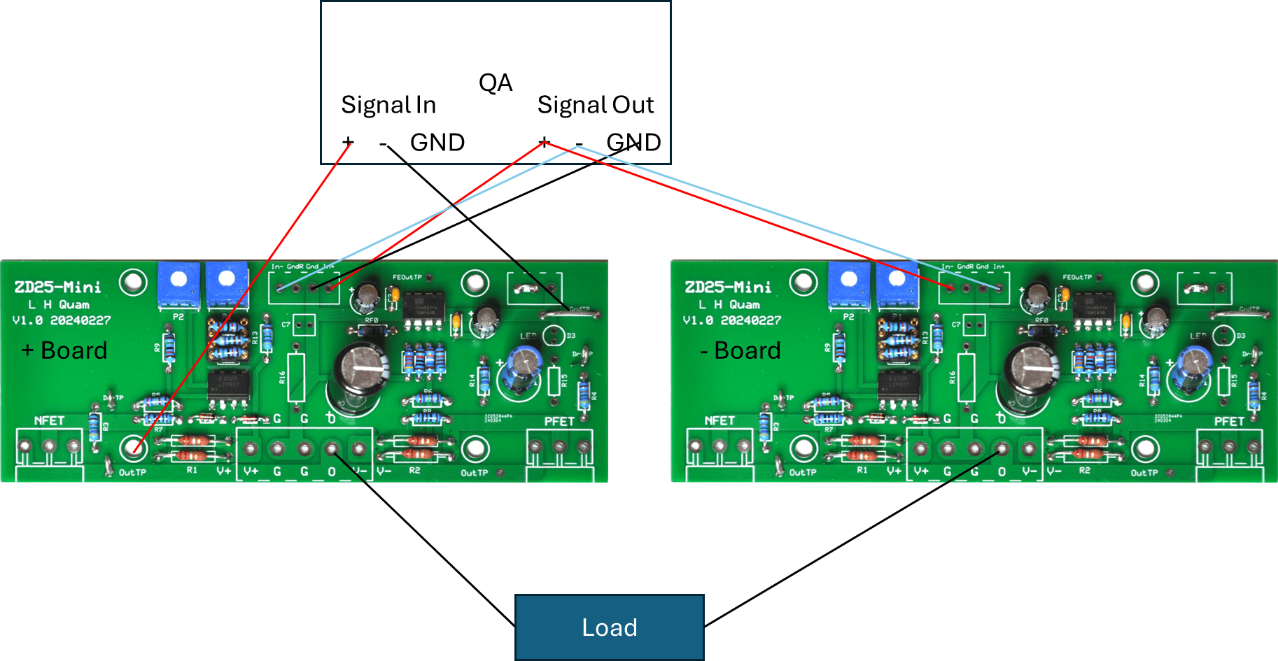

Well, I've either damaged something and/or something is just not quite correct with the left channel. See below.
In order to diagnose further, what I want do do is narrow it down to one or both of the boards (positive or inverted phase) within the left channel.
I've read more and more, but I got completely wound around the axle, and I wonder (again) whether I'll do further/potential damage with floating outputs and not yet completely grasping how to measure properly.
My idea is to measure each of the boards independently while still wired in their current configuration. Specifically, I was going to measure the output of each board with GND as the reference vs. differential to the other board.
The source signal would still enter per norm, and the input wiring separates the phases; + to "Board 1" and - to "Board 2".
If I measure the output of each board using the differential input of the QA, I should be fine, I think. I'd connect probes to the output test point and GND on each board vs. across the binding posts.
My silly question is ... if the load is connected across both boards, what load does each board "see"? Is there any issue with my lame-brained idea to narrow this down?
Crude diagram below. I'd do the output for both boards separately. Below shows output from + phase board to input of the QA.
After two measurements (+ board and - board separately); I should have the amplified output of the positive and inverted waveforms referenced to GND, correct?
Edited to show proper connection to from the QA input to the amp board GND (jumper wire) in the crude diagram.
Reactions: birdbox
For those playing the home game... I don't mind sharing when I don't know something / or when I goof up. Maybe someone will learn from my error.

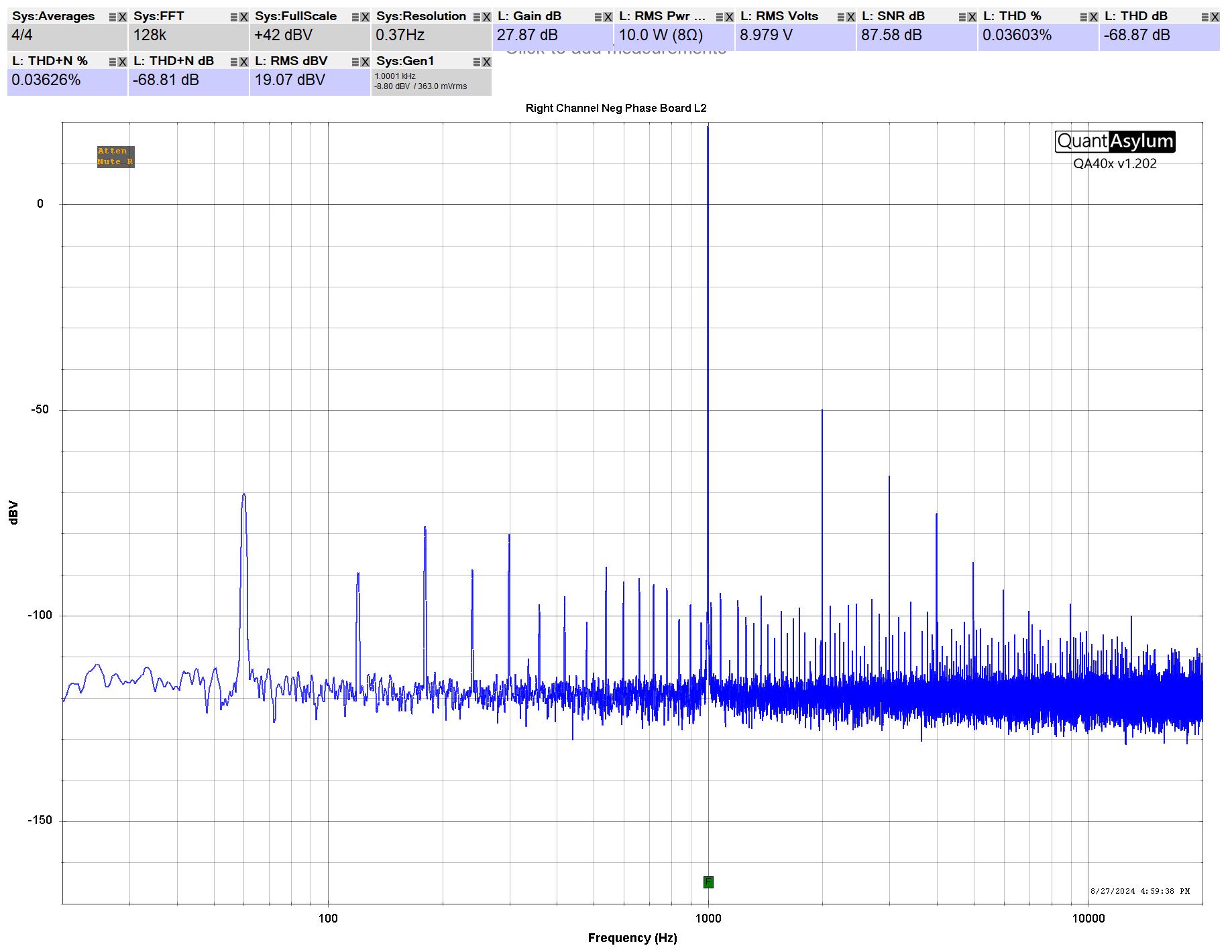

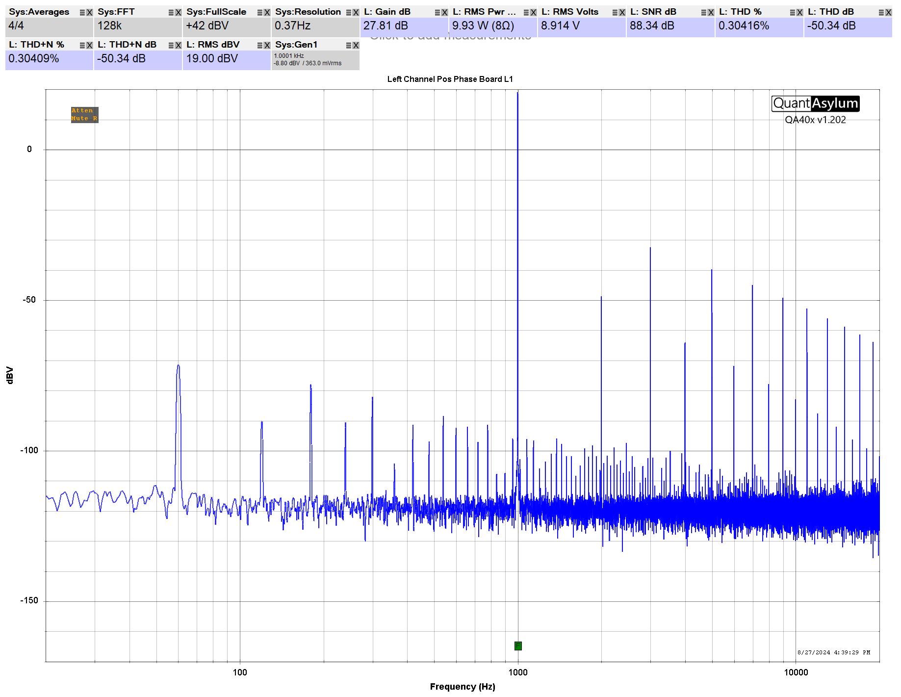

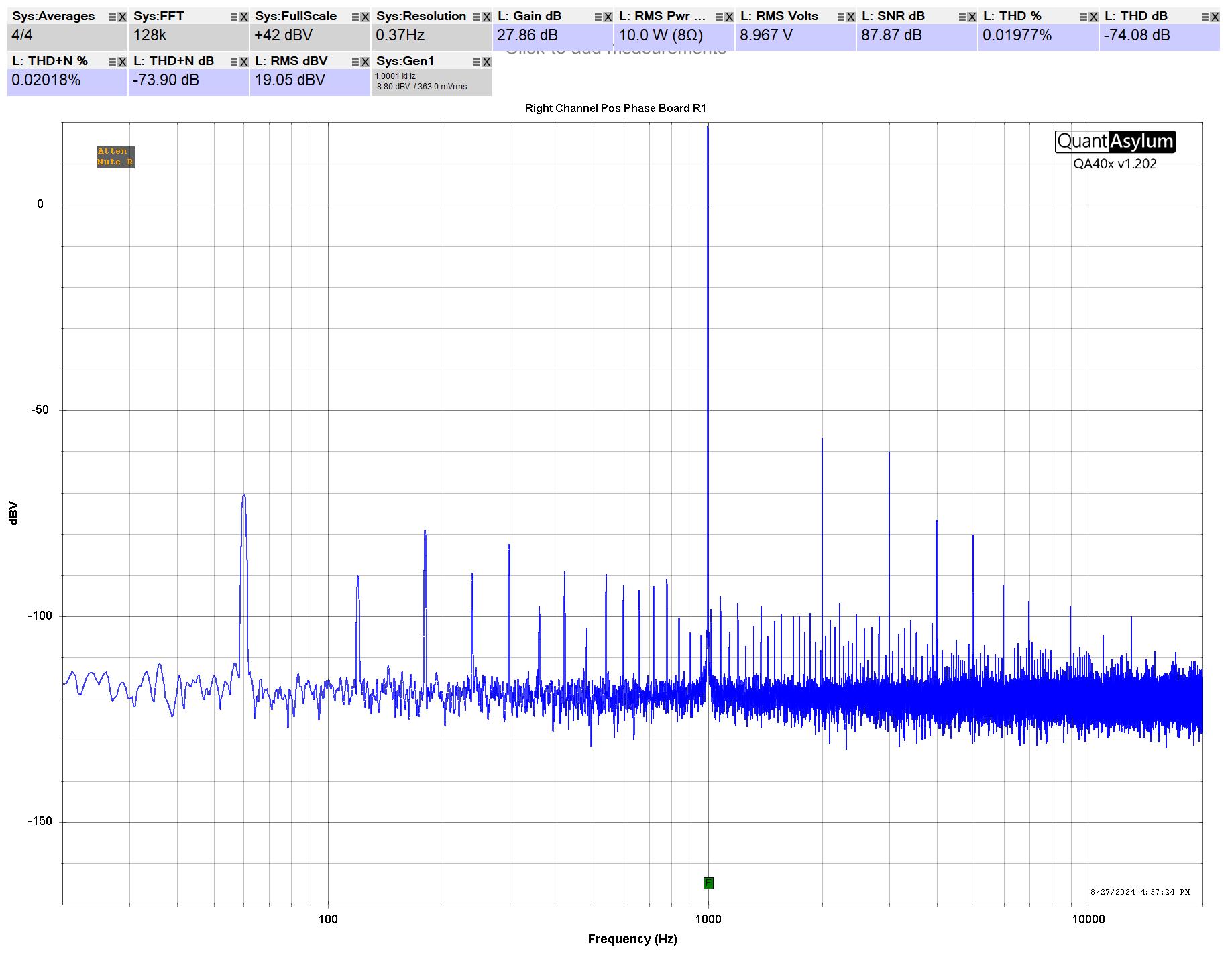

A kind-hearted soul pointed out my error above - the measured signal from the single amp board should be directly connected to the GND at the QA vs. measured as a differential to GND. I still am not completely 100% clear re: why, but I think I'm 90% there. Simple wiring change to get the measurements done properly for troubleshooting each board. They also explained why one specific board may have oscillated when I used the incorrect wiring for measuring the output. I am 99% sure I understood that.
Either way (ignoring all the mains grass / noise) - It should be pretty clear which board was heating up a tad / created the "warm" smell from the FFTs below. Without measurement gear... would I have noticed? Who knows?
I'll pop that board out and go over it. The kind soul said to first possibly just replace the op-amp. However, if anyone has any other ways to determine what other parts may have been damaged, I'd be thrilled to know. There's no visible damage to any parts.
With the exception of the output devices, I have all the parts in-house... and... since I have been known to make an error or two occasionally, I'm quite adept at part replacement.
Cheers! What an incredible community.

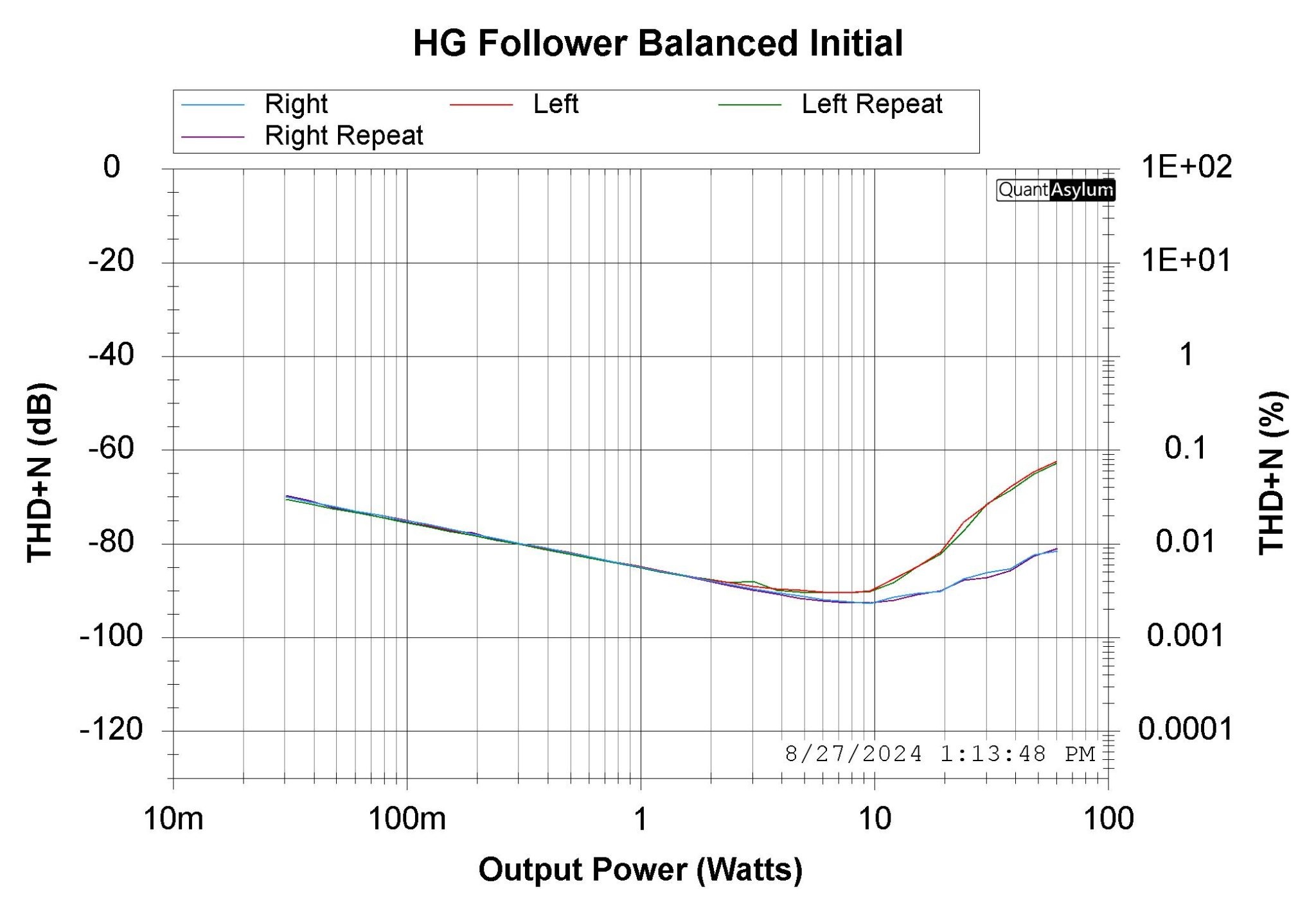

Looking at your performance measurements of THD another question comes to my mind.
If you compare your measurement results from the balanced and the original configuration with a linear PSU (post #400), you'll notice that in the power range up to 1 W there are no improved THD values. The most performance advantage seems to be in the high power range from 1 W upwards.
Why is that the case, even though the even harmonics cancelation?
